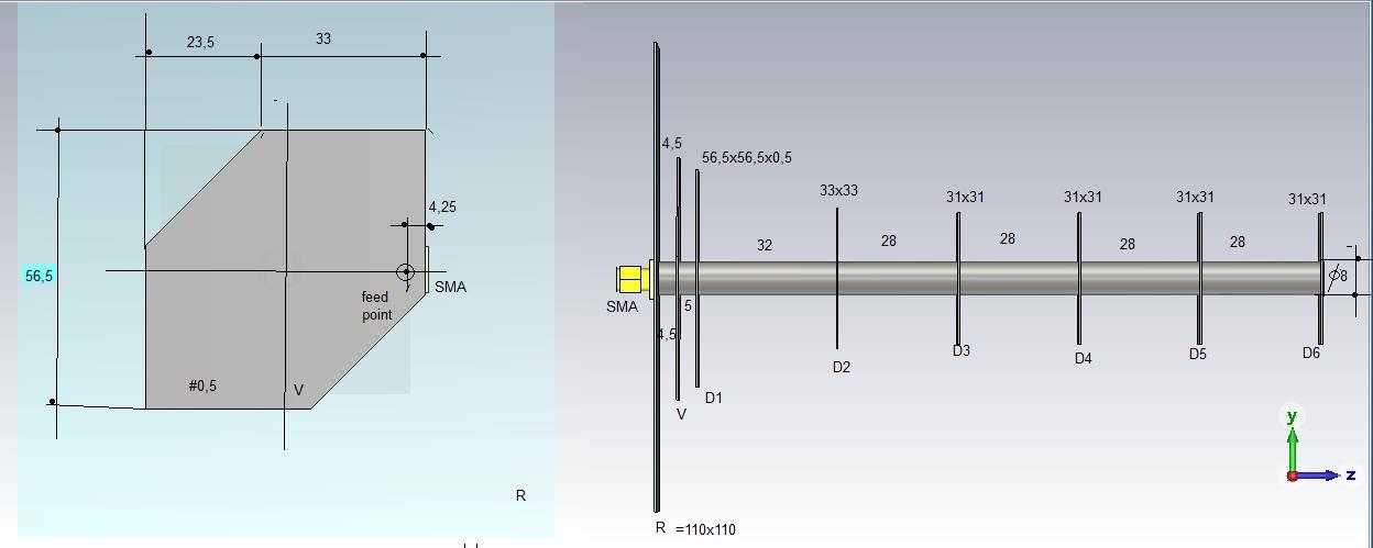

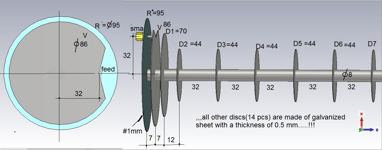

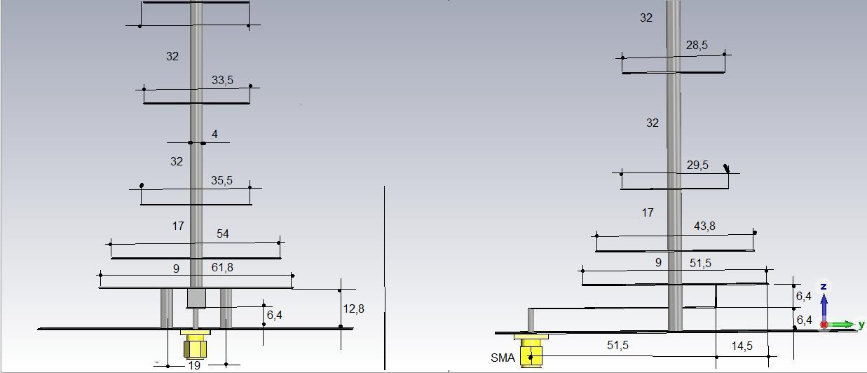

,,, another form of vibrator for Bester antenna that is better suited for MIMO...

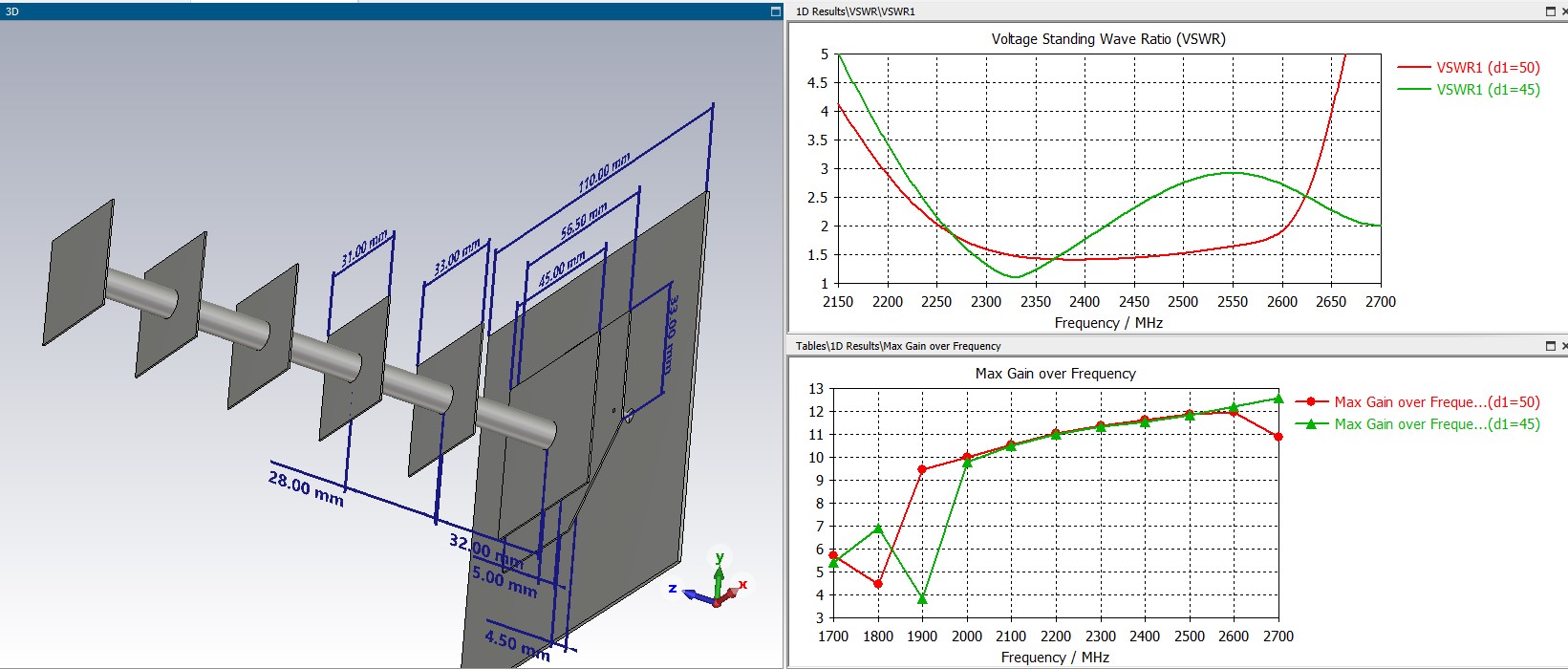

On 29.05.2022 at 11:07 AM, Admin said:
D1=45x45mm
I don't get the specs for that size.
I checked a V-shaped vibrator and it seems to give good results, the MIMO version remains to be tried...!!!
This ensures uniformity of impedance over a large frequency band.
,,,another form of Bester antenna...
,,,what does this man say...??!!

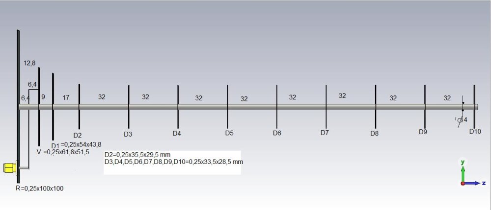

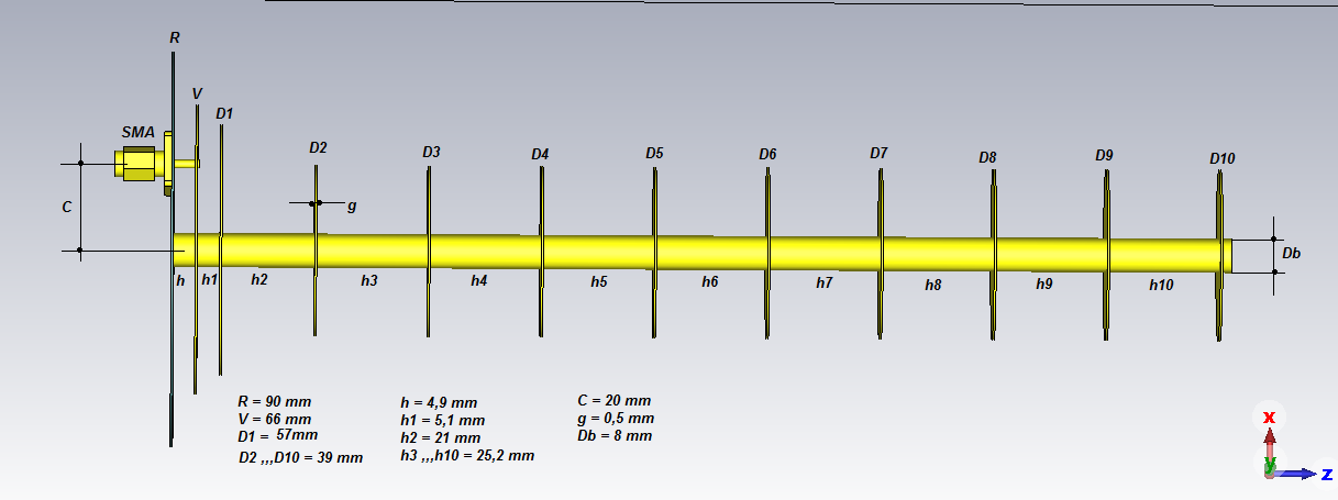

,,,how to build a Bester antenna....

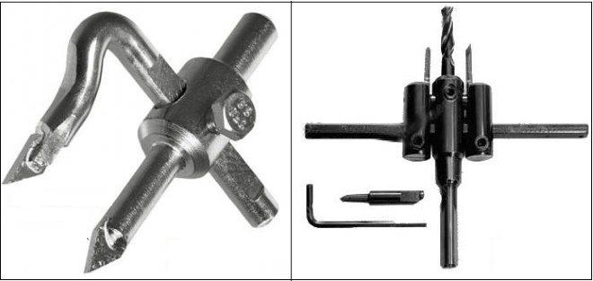

,,,you can also use something like this,for cutting patches...!!!
balerinka-po-kafelyu-otlichaetsya-ot-nasadki-prednaznachennoj-dlya-sverleniya-otverstij.jpg
18 hours ago, miloudsatdz said:
What is the tool used for cutting?
Use ordinary metal shears for cutting. use a drawing compass for marking.
what was recommended to you by the message above applies to cutting ceramic tiles or plastic. when cutting metal with such a tool of metal sheets, very serious injuries can occur. do not use such cutters!

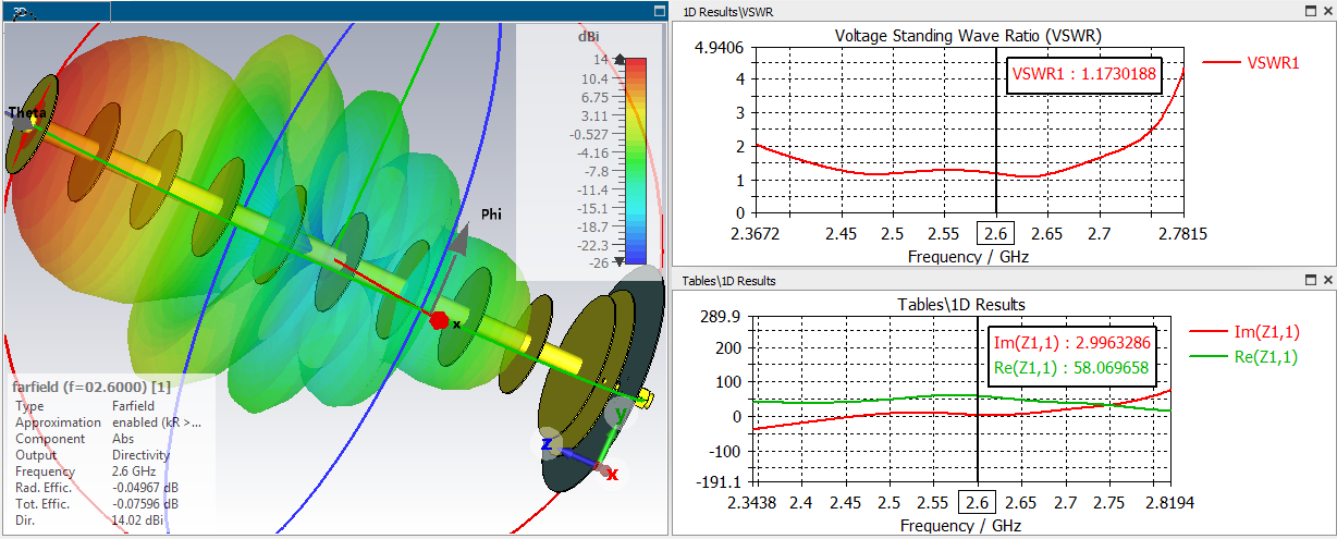

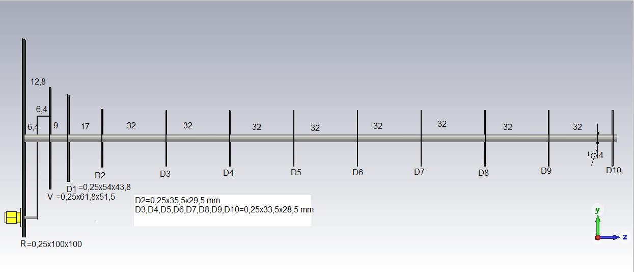

Bester optimized...ensures impedance uniformity over the entire frequency band...!!!!
I think that of all those who tried to adapt this antenna, few succeeded...!!!
VERY DANGEROUS WAY,   BE CAREFUL ...!!!

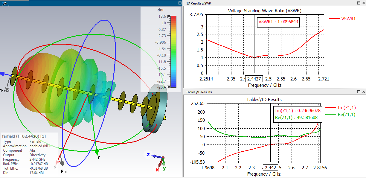

14 dbi - very well?

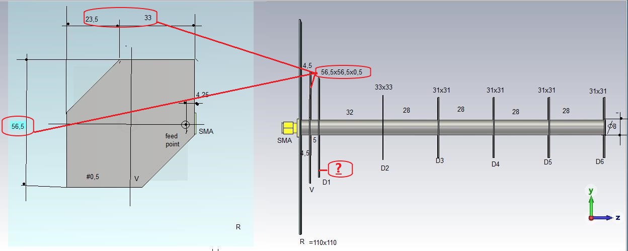

,,,an best Bester...

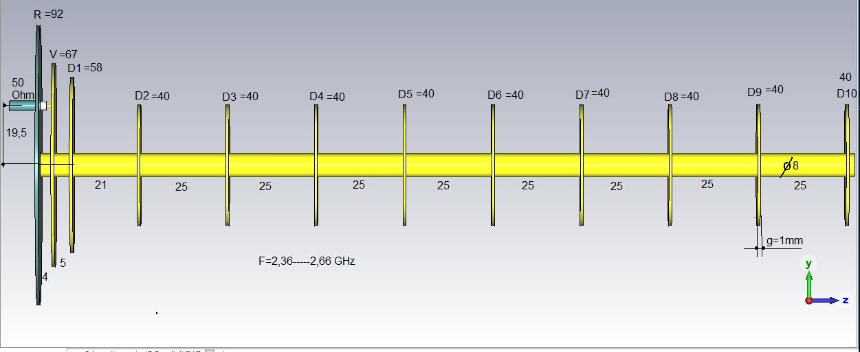

the 8mm diameter can be changed to 3/8 inchs for the 25mm spacers? thats what i can get locally.
