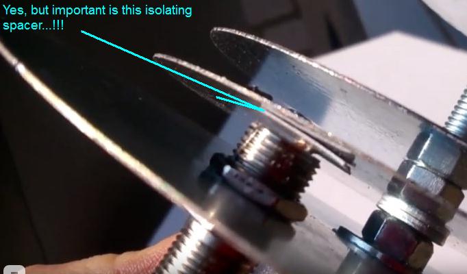

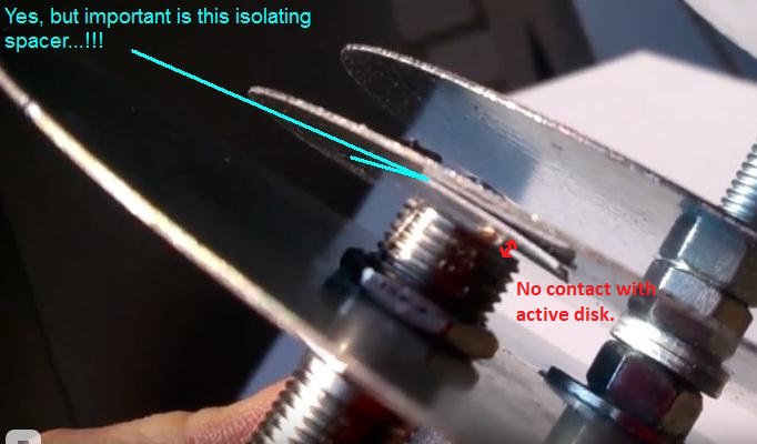

What does it isolate? I see the free space between the active disk and the reflector. Give a link to the video.
1800-2100 MHz? What does it mean? Dual band (4g + 3g)? LOL! This is not an antenna, it is piece of... metal. Made very poor quality.

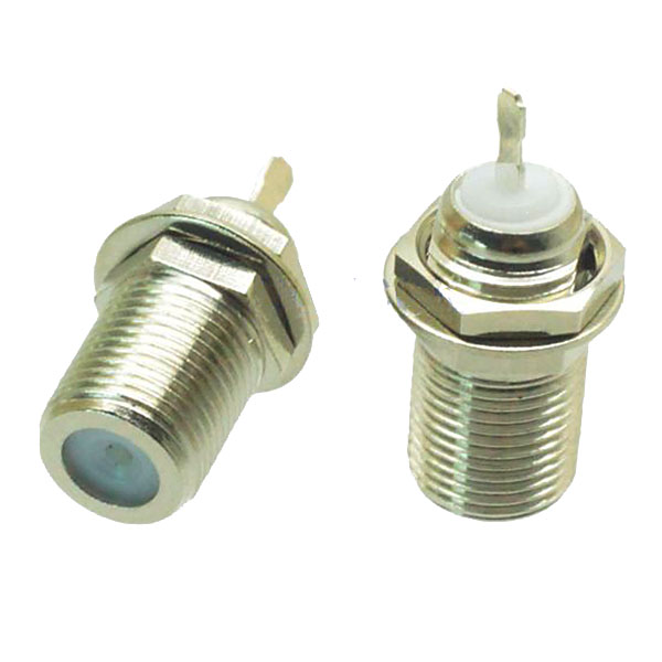

If you use direct cable entry without a connector (or a connector with a solder connection as in the photo), then a spacer is not needed.

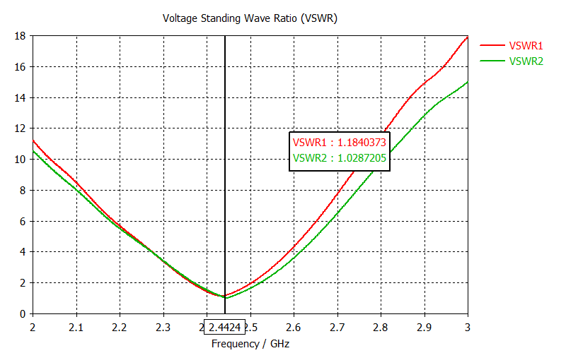

What is the polarization of this antenna? Linear? Where are the other graphs (vswr, gain)?

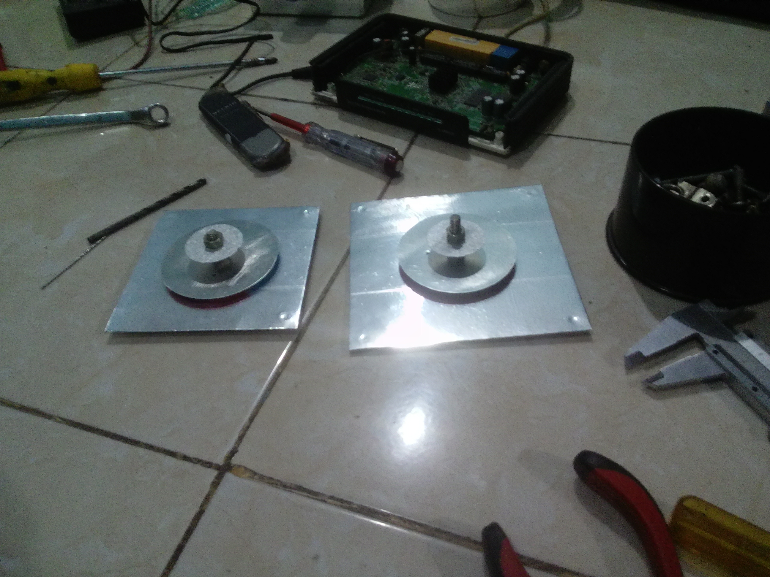

my bester antenna

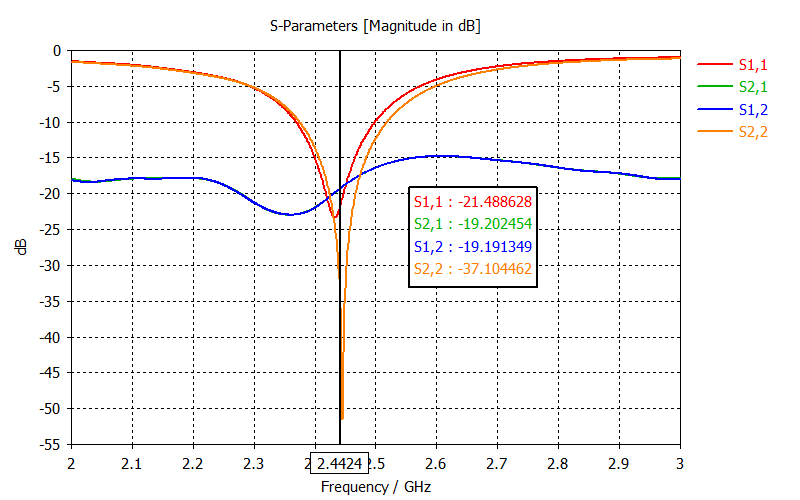

,,s21,s12 it"s not good,", for this antenna is not recommended...!!!
,,,read this..http://www.antenna-theory.com/definitions/sparameters.php
The port-to-port isolation is defined as the ratio between the power fed into one port of the antenna to the power received at the other port. It is therefore an important parameter to consider if the antenna is to be used with a transmitter that makes use of MIMO. Ideally one would like the two ports to be completely independent (infinite isolation) because then what ever signal is transmitted from one port will not interfere with the signal transmitted from the other port. The lower the isolation, the more interference there will be between the two transmitted signals.

,,,the truth is that for this type of antenna also called 'gun', the insulation between the ports is not good , so the antenna is not good for MiMo....!!!
Isolation between ports,i don't get it , do you mean isolation between director and central metal rod/screw ?
I recently build one and work well, just is a sensitive to polarization.

,,,no, the isolation is a measure of how well the two ports are separated from each other in terms of unwanted signal coupling. 30dB isolation is in most cases considered 'high isolation'(s21. s12 =aprox.30dB)
The port-to-port isolation is defined as the ratio between the power fed into one port of the antenna and received at the other port. Ideally one would like the two ports to be completely independent (infinite isolation) because the signal transmitted from one port will not interfere with the signal transmitted from the other port. The lower the isolation, the more interference there will be between the two transmitted signals.

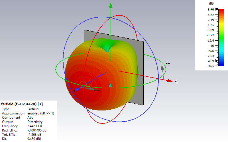

Construction practice of MIMO antennas Bester...
