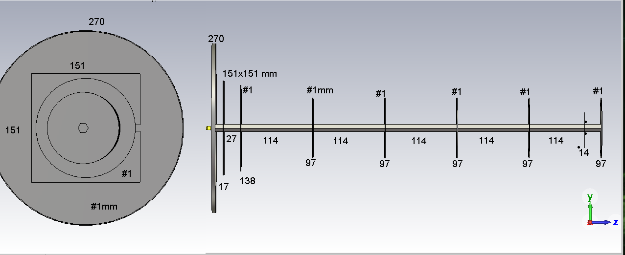

Antenna frequency 2100?
I think the antenna for this frequency will be a bit big.(270x750mm)
30 minutes ago, DavidER said:
Antenna dimensions?

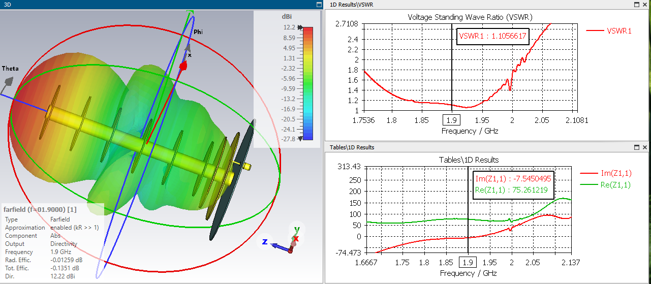

Did you manage to simulate the desktop antenna 1800, 2100 by 75 Ohms?
I'll try...!!!!

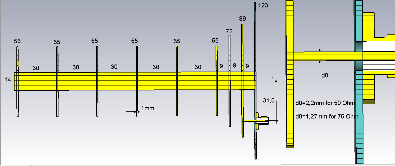

,,,,next 75 Ohm
,,,technical details...
,,,to change the impedance the power pin diameter(d0) must be changed...!!!
The SMA plug remains the same, 50 Ohm impedance, only the coaxial cable is 75 Ohm.

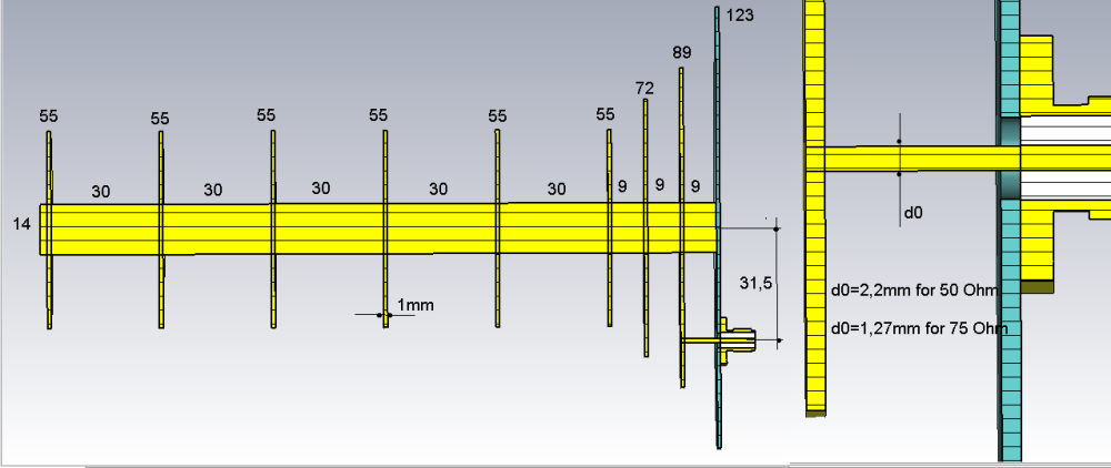

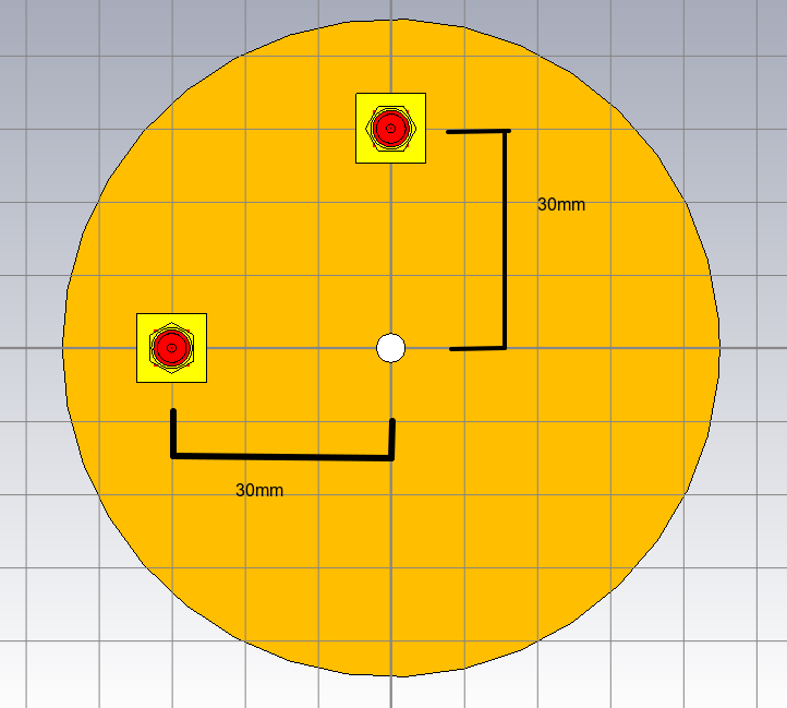

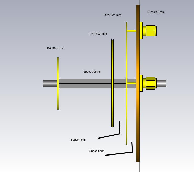

Based on pre-cuted brass disks by Aliexpress (also there are copper disks):
(https://www.aliexpress.com/item/1005008356725365.html?spm=a2g0o.cart.0.0.341d38daIYDifj&mp=1&pdp_npi=5%40dis!EUR!EUR 3.35!EUR 3.08!!EUR 2.92!!!%40211b876717506983783034052ec3c6!12000044708261645!ct!GR!169332860!!1!0

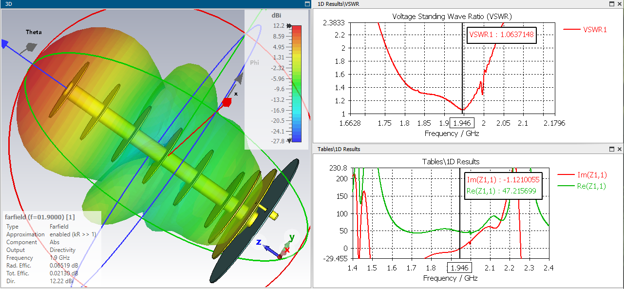

I made the attached antenna based on standard dimensions so that can be easy constructed. I think the results are good enough, but I don't like the farfields output, anybody to check and suggest corrections on it but without changing disk sizes, maybe distances? Hexagonal spacers 6mm, 2XSMA/90 degrees and 30mm from center.
BesterTEST.cst
