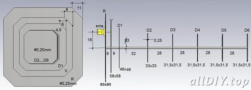

Okay, but what's interesting is that this antenna has elements made of PCB....!!!
the ONLY advantage of Dielectrics...is SIZE reduction...and looks...ALL metal is the best option...
Yes, but it seems that many people still buy it....
I wonder if the antenna elements have concentric copper circles on PCB...???

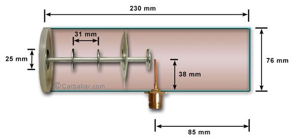

I'll see this weekend what can i do...(i don't like Yagis tho) Gain without LENGTH is not Achievable...or a 4 element ARRAY (short) feeding network should be hard to build...Did you EVER try a disk Yagi inside a TUBE...?
If I remember correctly, I tried something like this...
but I'll try this square bester too, inside of beercan...
kreslennya-rebristo-sterzhnevoi-wi-fi-an
Nice PARASITIC YAGI
