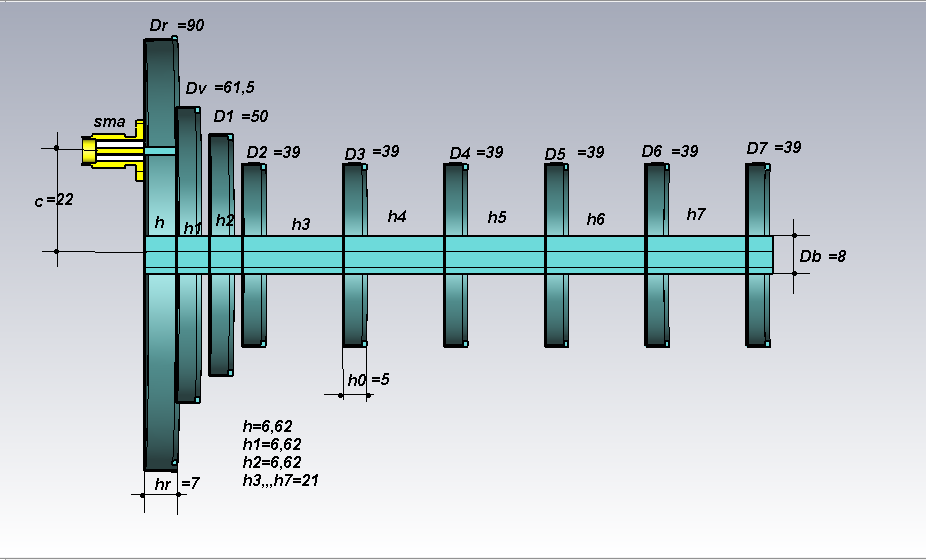

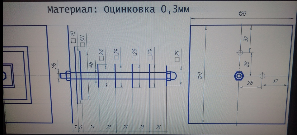

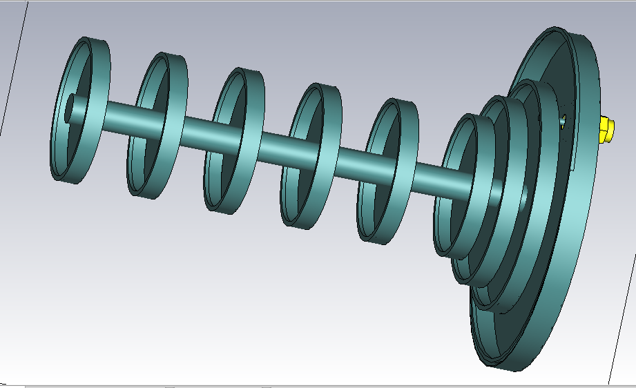

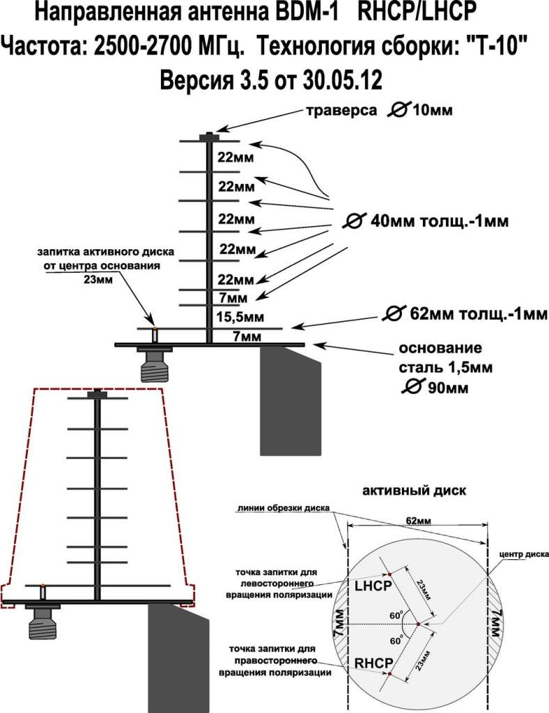

,,,yes, I received this drawing from Egor on VK...
,,,and yet, this antenna is not very good...

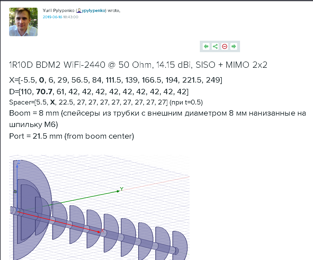

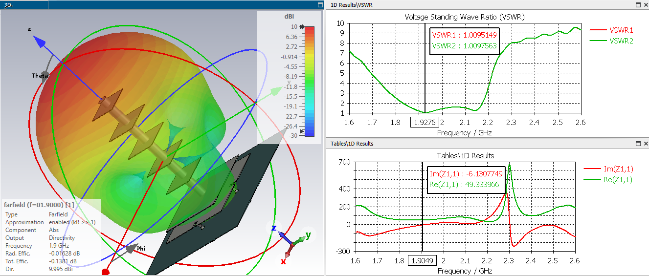

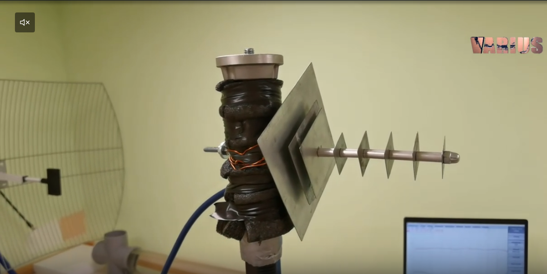

I think this antenna with rectangular elements is from VARIUS.

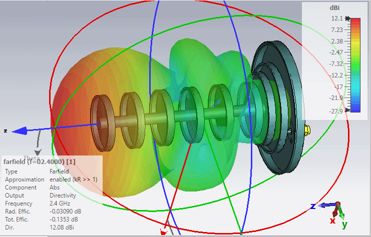

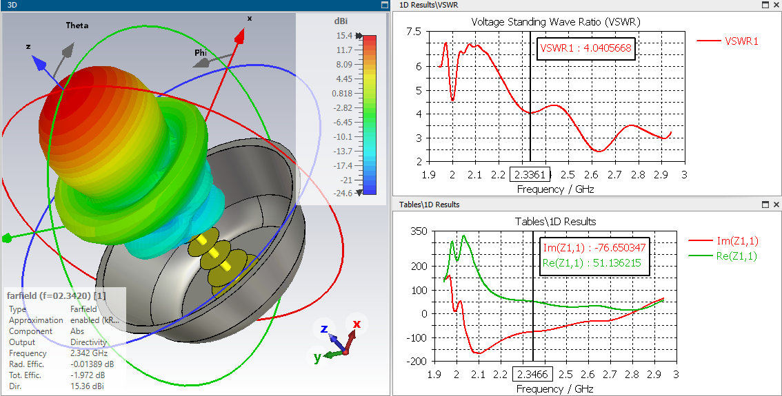

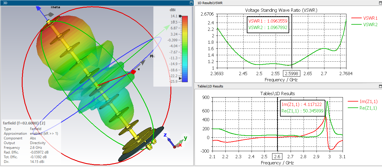

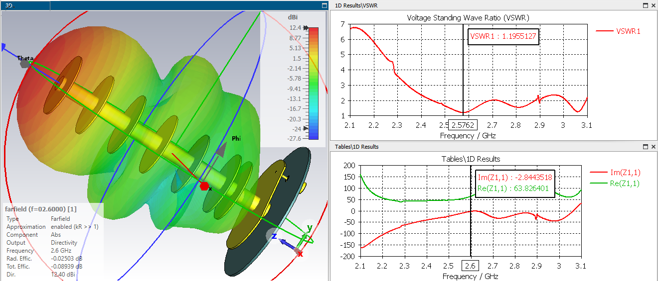

And this is mine...

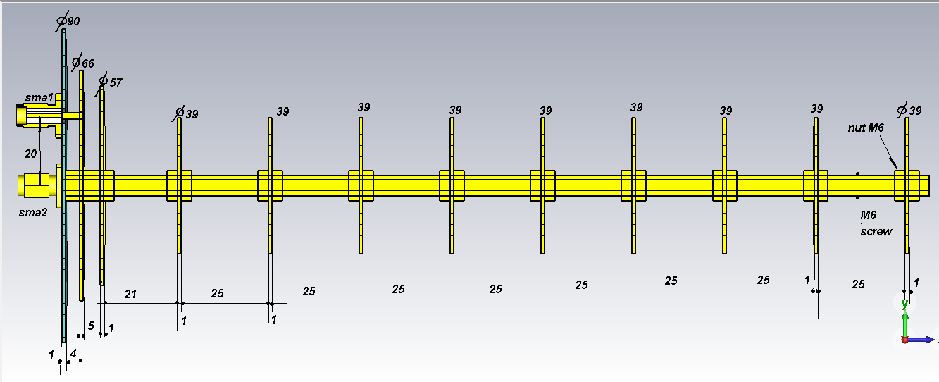

Bester BDM 2600 MIMO RHCP+LHCP 4G+Antenna System
,,,distance between Bester antennas=164mm
,,,for 2600 MHz,it seems that with these dimensions the Bester antenna is better...a greater width of the frequency band is ensured and the impedance is more uniform over the entire frequency range...

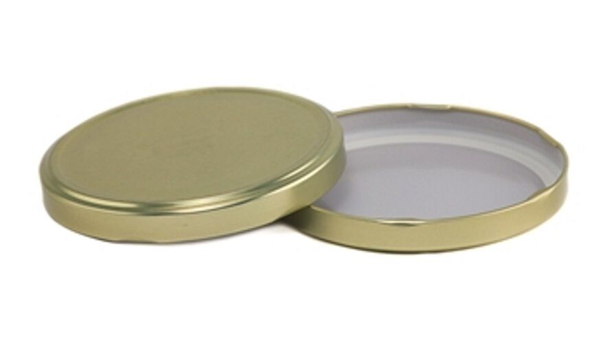

,,,and a Bester antenna made only of metal lids for glass jars....
11 minutes ago, DavidER said:
solid lids? Shouldn't they be cut?
,,,why work so much...???
,,,there's no point..!!!

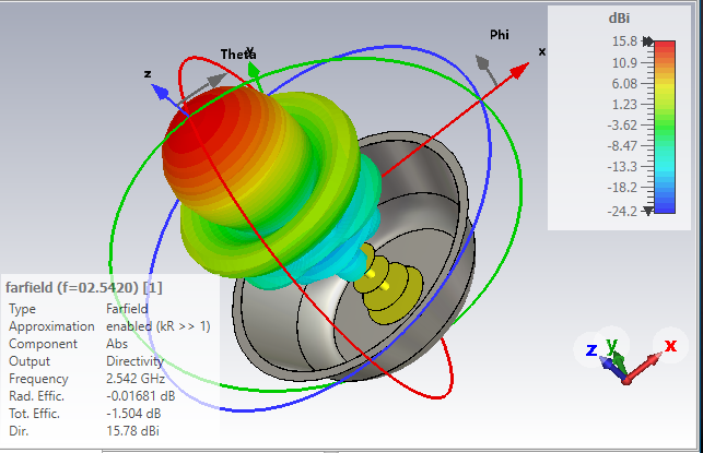

What is the cup for? What does it give?

Bester BDM 2600 MIMO RHCP+LHCP 4G+Антенная система
,,,расстояние между антеннами Бестера=164мм
Is the distance 164mm between the reflectors?
,,,more gain>>>
9 minutes ago, Admin said:
,,,больше выигрыша>>>
What do you mean, more signal? Show with an example.

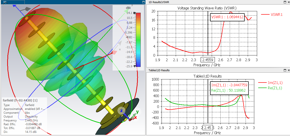

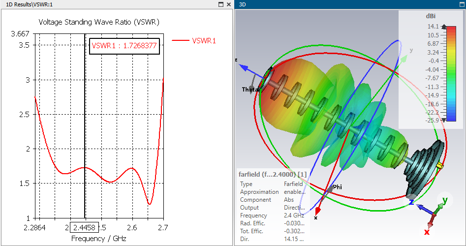

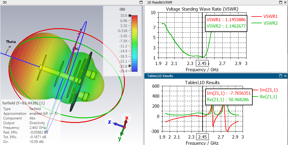

I will try to resume this simulation...
,,,e.g...

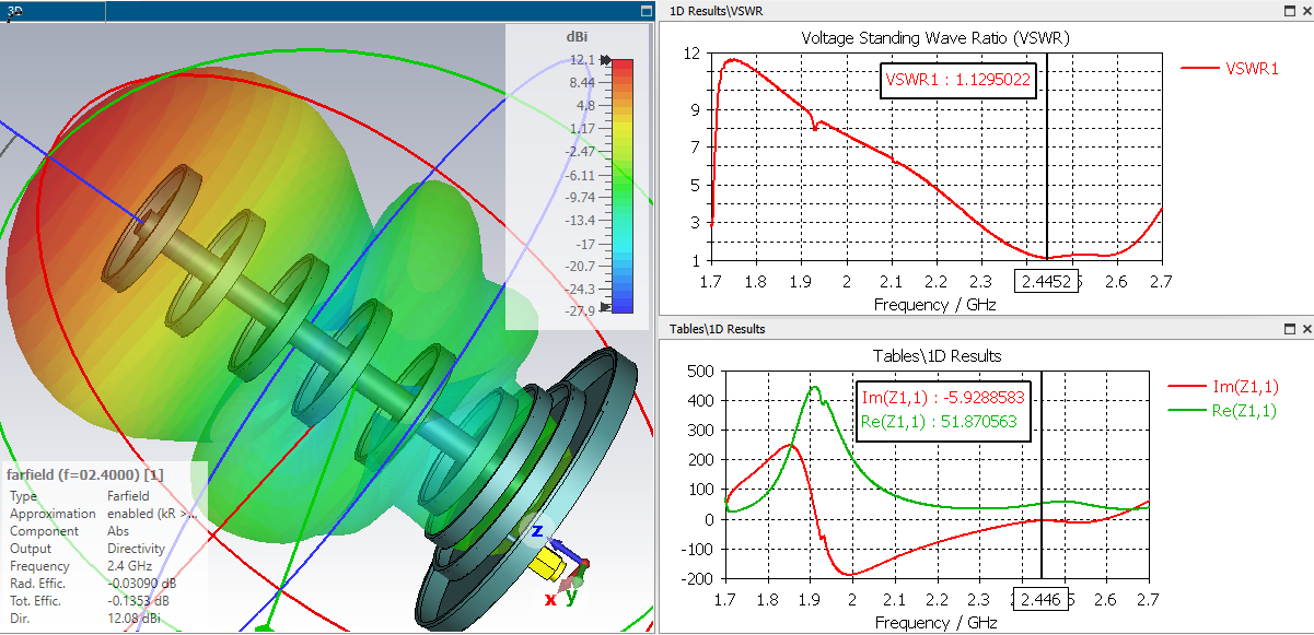

On 23.09.2023 at 20:14, Admin said:
,,,антенна Бестера других размеров...
Бестер2442.cst

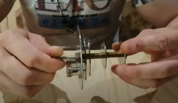

,,,и практическая реализация Егора-Свободного Вождения...

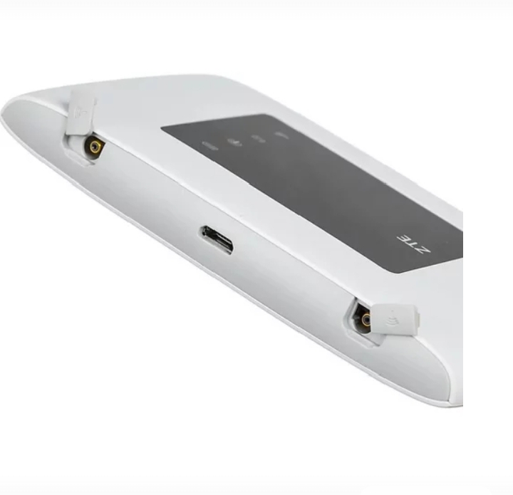

Suitable for modem router zte mf920vs?
,,yes,ZTE MF920VS, Frequency 2.4 GHz, Supports Bluetooth 802.11b, 2.4 GHz Radio Frequency
,,,but where does this modem have the connectors for the external antenna...???
1 час назад, Админ сказал:
,,да,ZTE MF920VS, частота 2,4 ГГц, поддержка Bluetooth 802.11b, радиочастота 2,4 ГГц
,,,а где у этого модема разъемы для внешних антенн...???

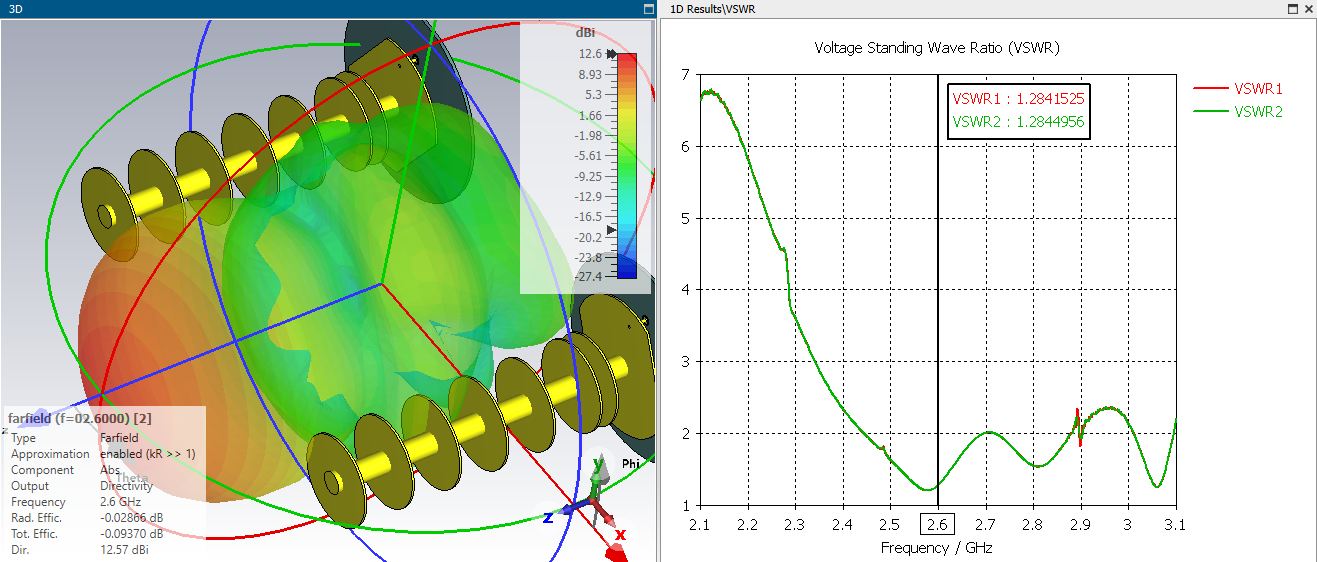

,,,another variant of Bester antenna with 5 elements by Alexander Bars author....
,,,by...
On 23.06.2022 at 10:07, Admin said:
Я проверил V-образный вибратор, и, похоже, он дает хорошие результаты, осталось опробовать версию MIMO...!!!
Это обеспечивает однородность импеданса в широком диапазоне частот.
