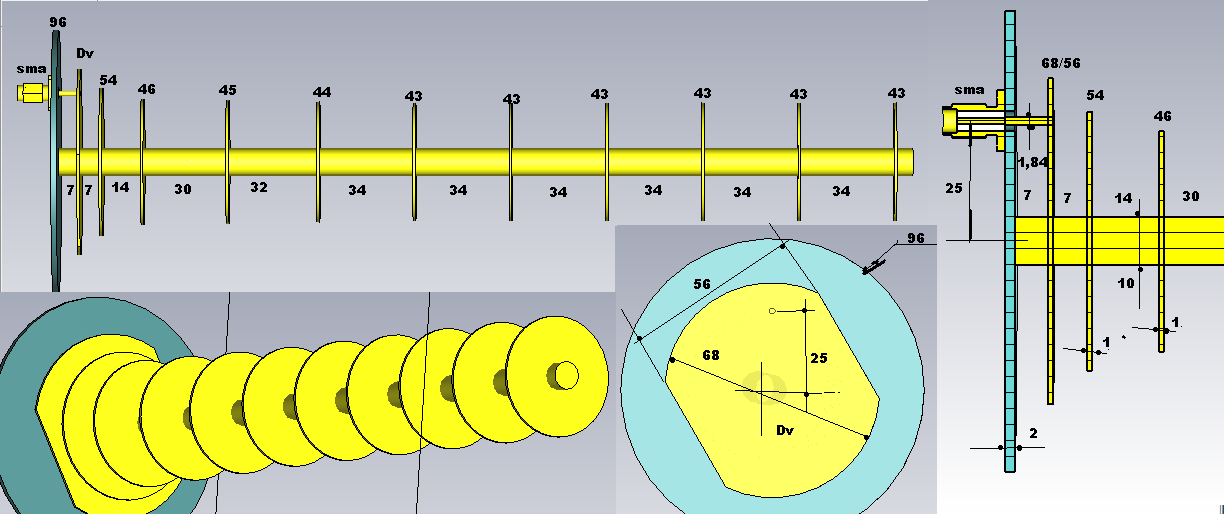

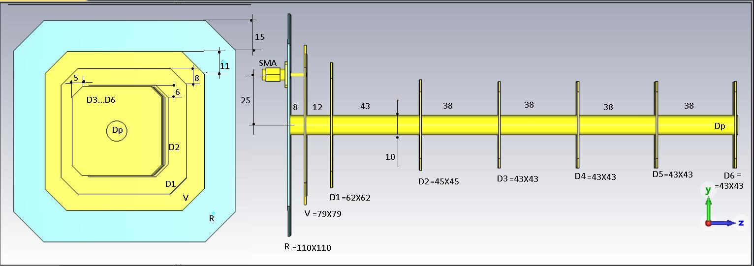

,,, yes it is possible with 9.525 diameter spacer pipes...!!!

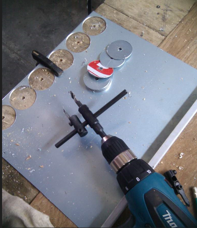

This was very fascinating, and I appreciate the sharing of the knowledge. I might have to give this one a try someday. It is very agreeable with the tinkering that I like to do, but cutting aluminum spacers would be very tedious regardless of how such a task is accomplished. I would take a polishing wheel to the edges to ensure you keep all your fingers, just in case.

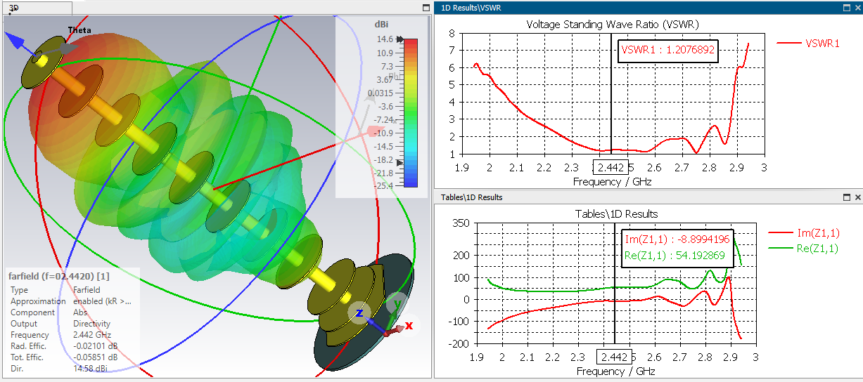

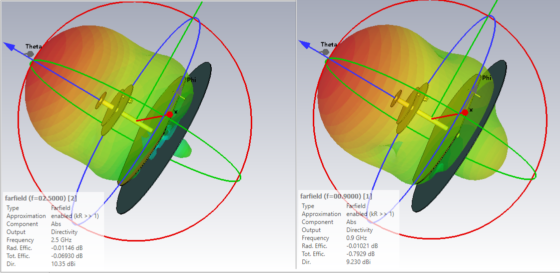

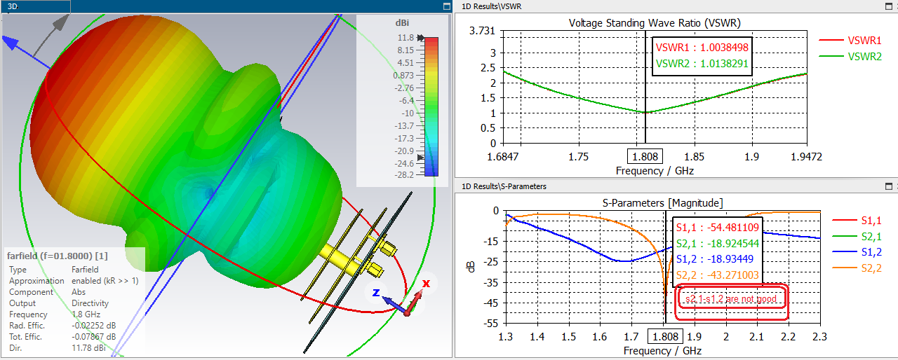

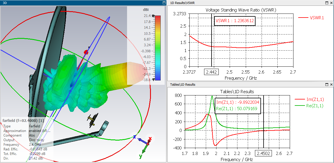

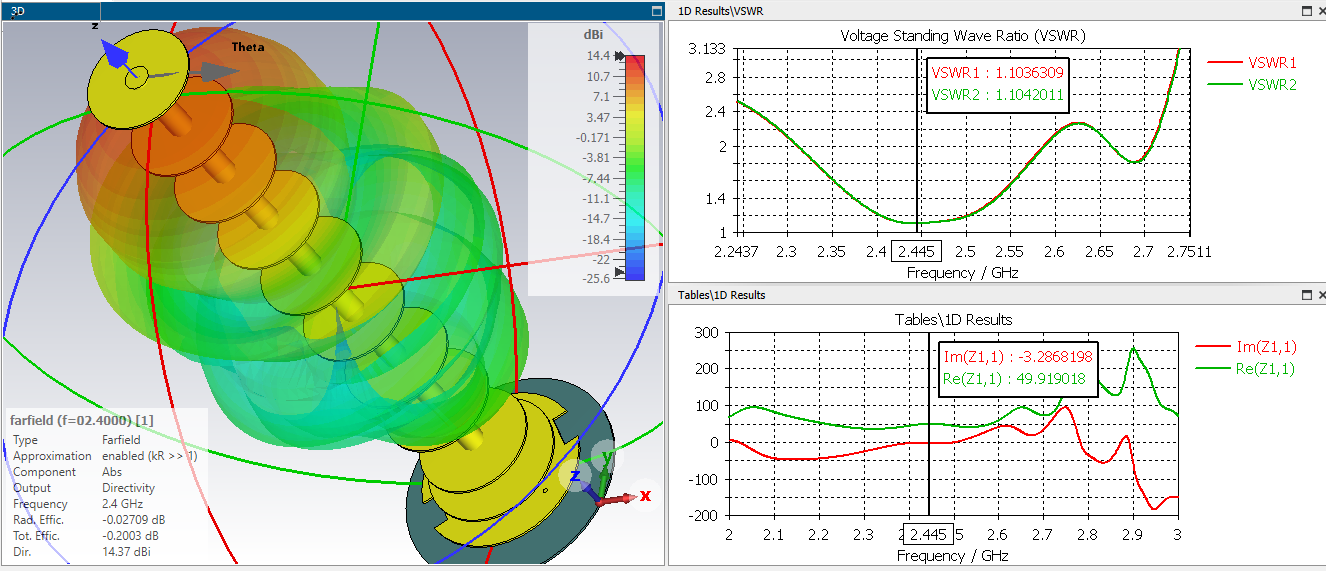

In my understanding of MIMO, these antennas transmit separate signals, +45 and -45degr, in the simulation should be considered separately and not together. Gain will be 6dBi, not 9dBi.
,,,how to make the antenna...
,It may be possible, but for isolation between ports, another configuration of the vibrator disk should be...!!!

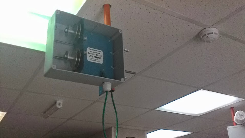

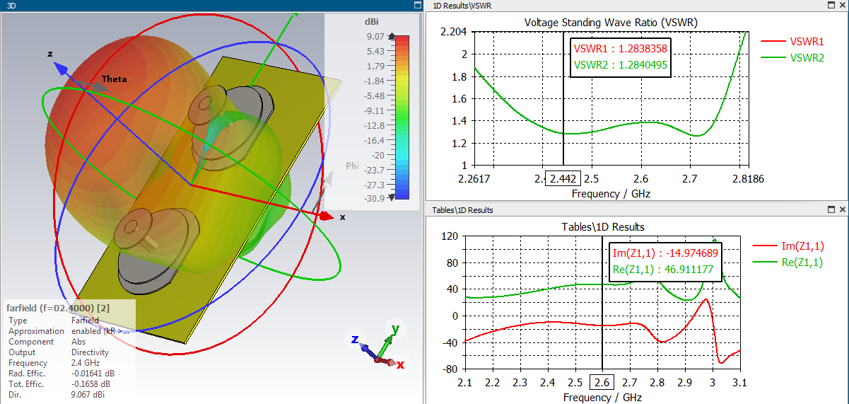

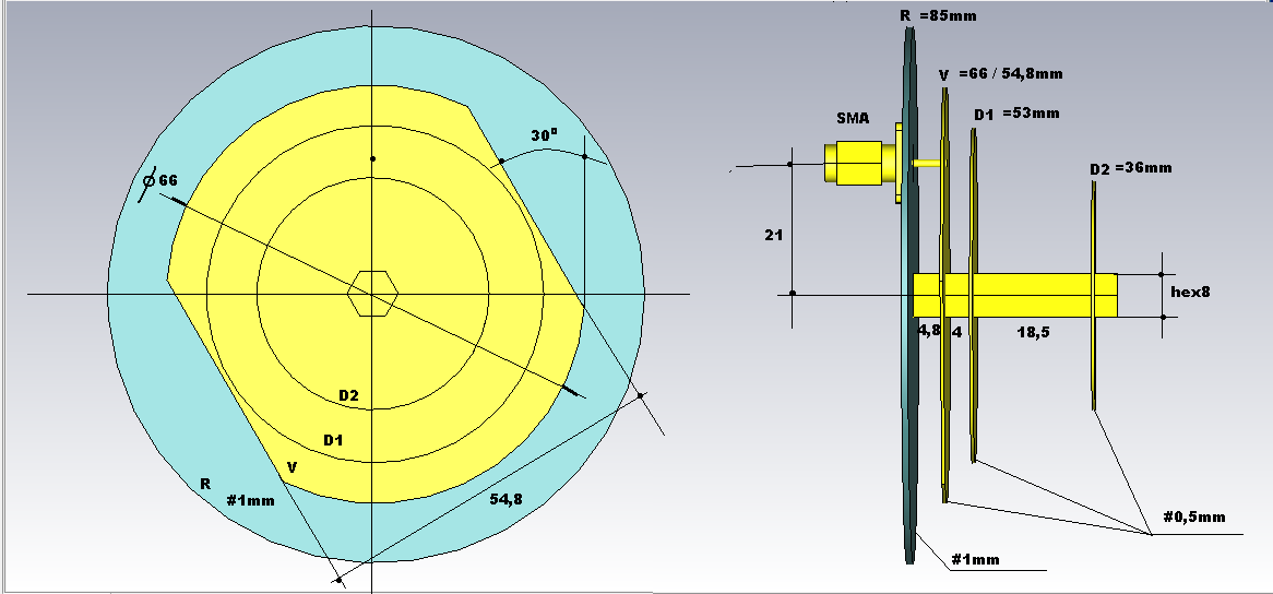

Do you offer to make this antenna model for MIMO option?

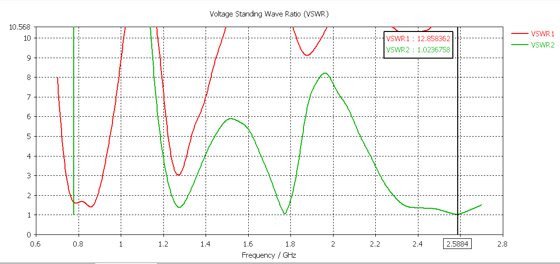

,,,but with MiMo,isolation between ports...

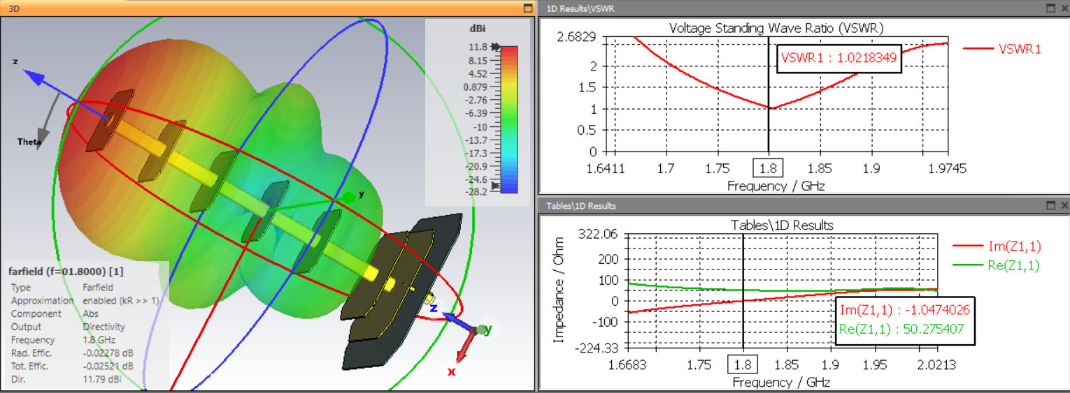

Must be at least 800-2700+ to cover full band of 4G  !!!
Edited by jbckdsav
,,, yes, it could be that way(two in one)...!!!

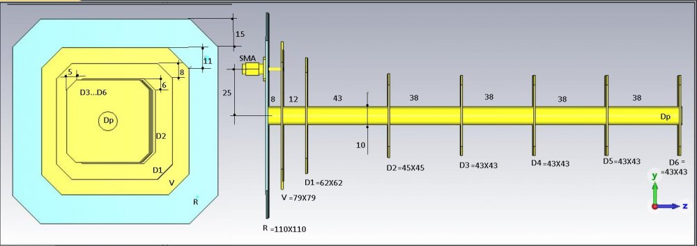

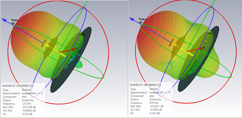

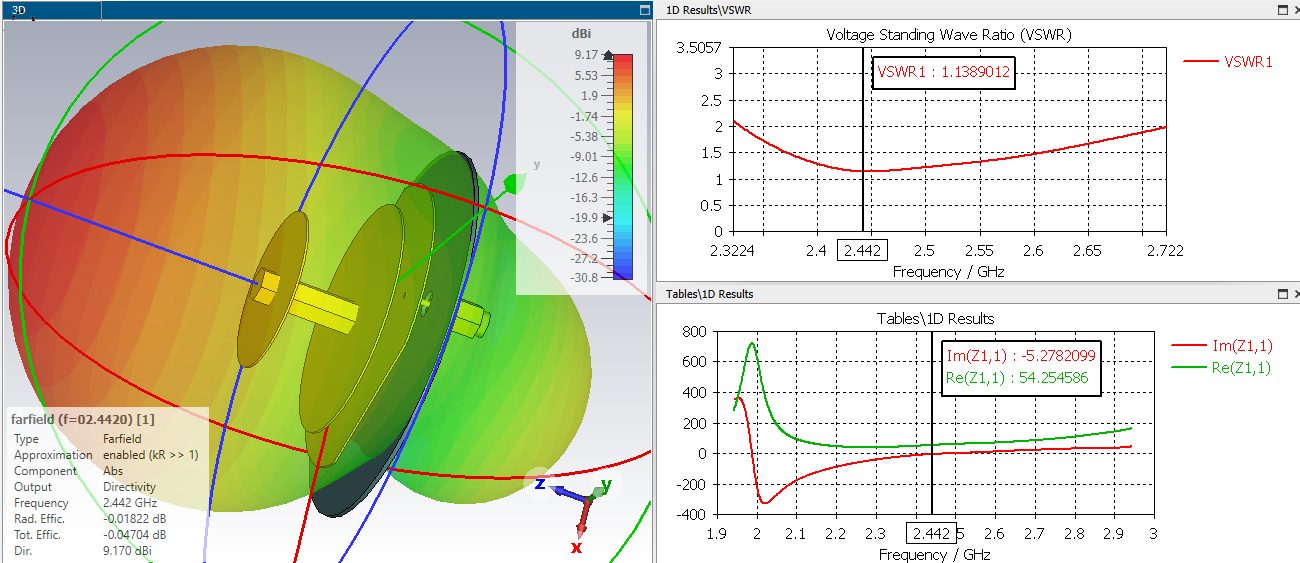

,,,a Bester antenna with other dimensions...
Bester2442.cst

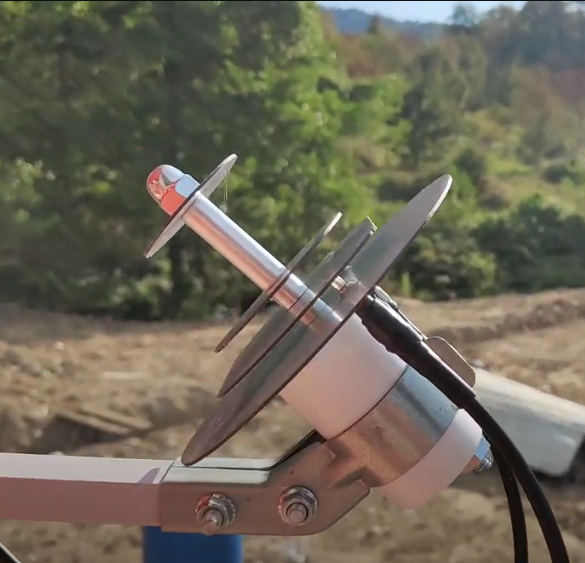

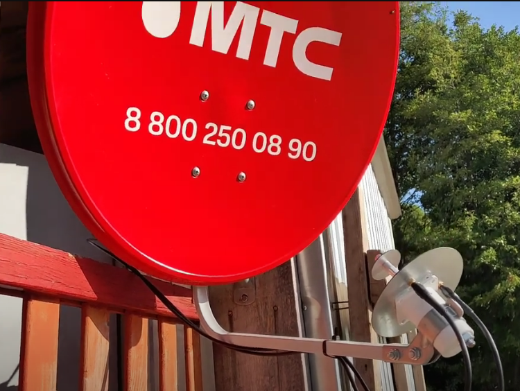

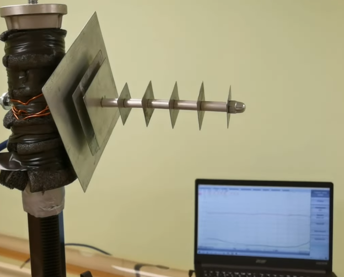

,,,and the practical realization of Egor- Free Wardriving...
,,,it is also possible with slots in the active disk ....!!!
