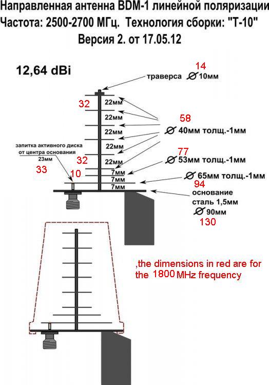

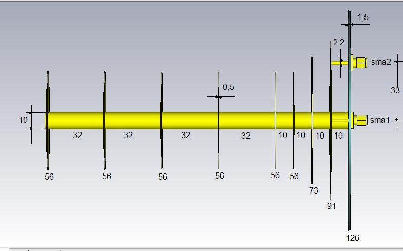

The sizes are such to the antenna 1800?  32, 22, 22, 22, 32, 10, 10, 10
On 23.01.2025 at 09:52, Admin said:
В любом случае, эти размеры, которые я вам дал, должны быть проверены с помощью моделирования.

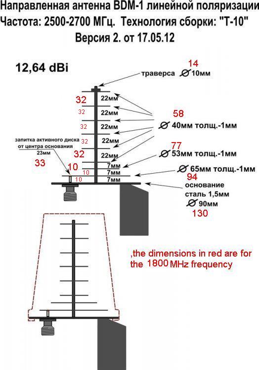

The distance between the discs 32, 22, 22, 22, 32, 10, 10, 10?
And I have already done this size, only in the last two, 7 mm. The antenna worked.
It's still simple, I don't know why you don't understand...!!!???

Will 75 ohms work?
,,,no..,need other sizes...!!!

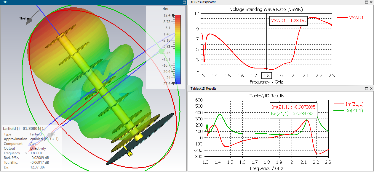

Can be simulated?
15 minutes ago, Admin said:
,,for 1800 MHz...???

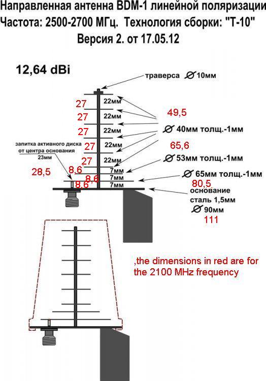

1800, 2100 MHz

Already modeled the antenna 75 om?

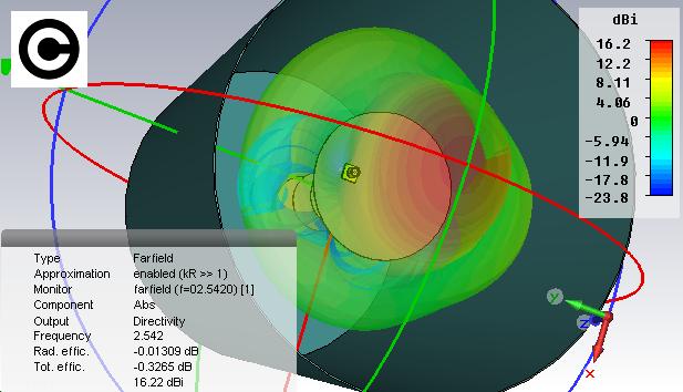

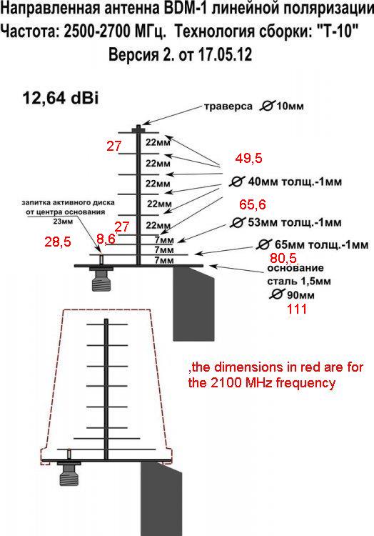

On 23.01.2025 at 09:32, Admin said:
...первое изображение для (центральной) частоты 2600 МГц (красное), а второе для (центральной) частоты 2100 МГц
BDM_1_2600_T_10_v2.thumb.jpg.8fbb2cf1bd3bad79bf8aa3be3c9a6d8b.jpg.b2549800371fdf5929149a717be080f6.jpg
Is this antenna 2600 working? The sizes are correct?
