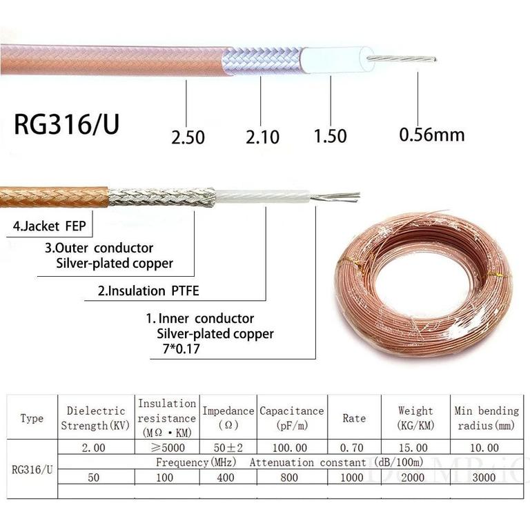

Suitable except for cable 50 ohm 5d-fb, cable rg-316,174?
,,,preferably RG-316...
Posted (edited)
And how many meters? 3,5,10?
Edited by DavidER
,,,length=multiples of 58.45 mm...!!!
