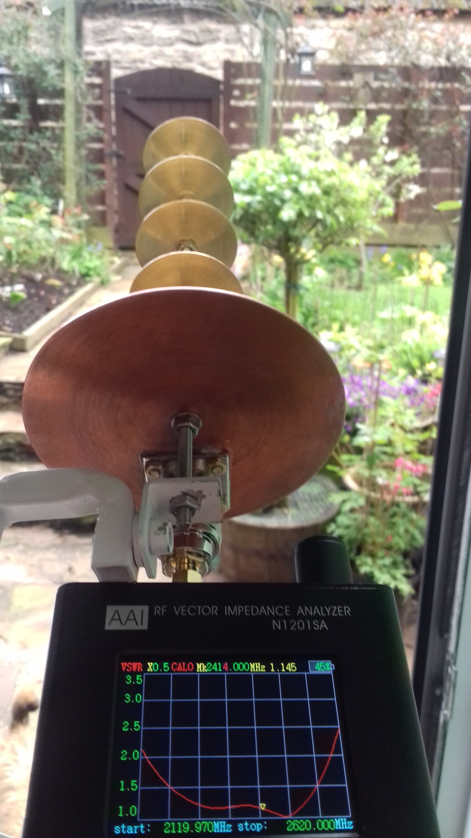

I recently copied this antenna design from the internet and although I'm pleased with its performance, i have my doubts about the original configuration so i have made a change to the driven element.
The driven element on the original design appears to be coupled to the rest of the elements - surely this creates a short  circuit? so what i have done is isolated the driven element from the boom.
what do you think?
cheers.

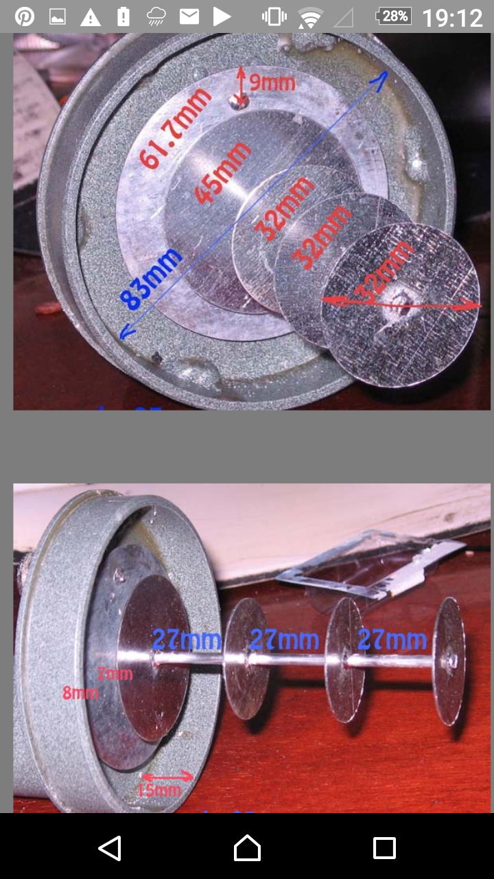

Rob, please, if you can, post YouTube video by Andrew Mc Neil and the sizes of your antenna!!
Hi admin, I'll post my antenna measurements later on.

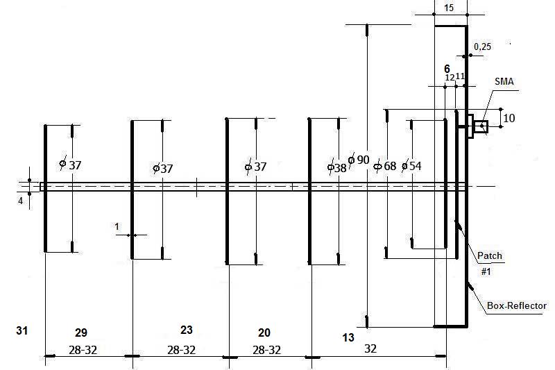

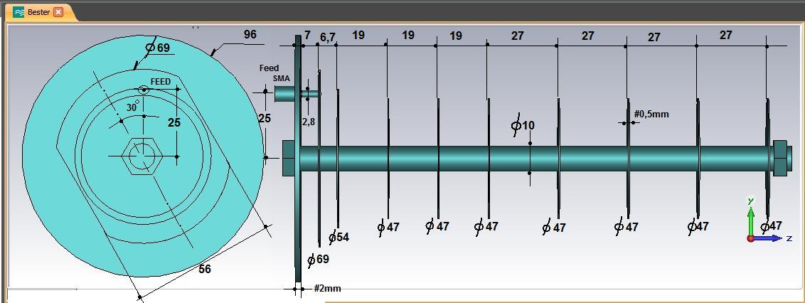

Admin, this is the design I have followed.
The measurements are the same apart from the boom which is 6mm dia, and I haven't included the 83mm lipped rear reflector.
Cheers

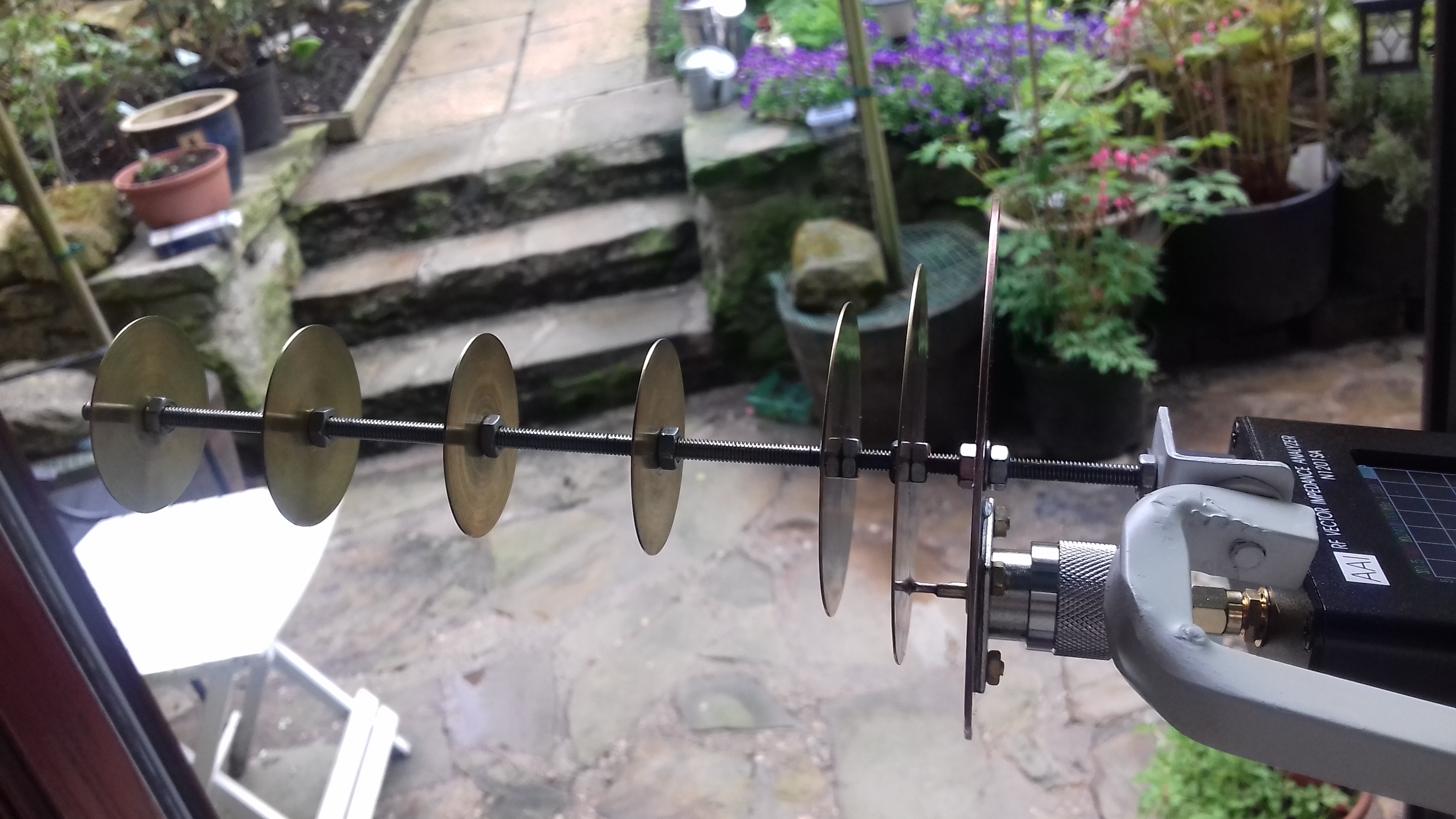

Here's my completed antenna coupled  to my new toy!
Edited by rob

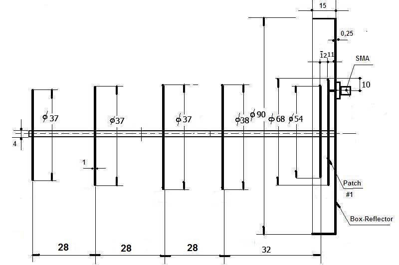

Yes it's good, but why 2.6GHz...!!??
This is the execution drawing...???
Hi Admin,  yes thats the design, however I omitted the 15mm lip from around the reflector.

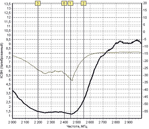

I'm happy with the vswr at 2.414 ghz as that's where I want to be.
The 2.6Ghz reference shown is just how I set up the analyzer stop point.
I did however try to re tune to the lowest dip point to 2.414 but had no luck.
I guess I need to move the driven element closer to the reflector to achieve this?

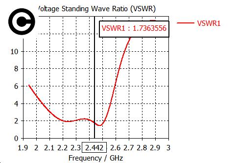

Good design and it appears to work well.
How does one tune this type of antenna?

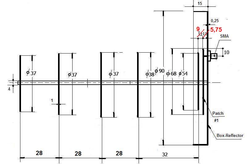

 ,,,, these might be the best sizes, I do not know, it should be tried....
Impedance adaptation still needs to be done...
Yes ,this is it,this is the correct sizing...!!!
5 people like this

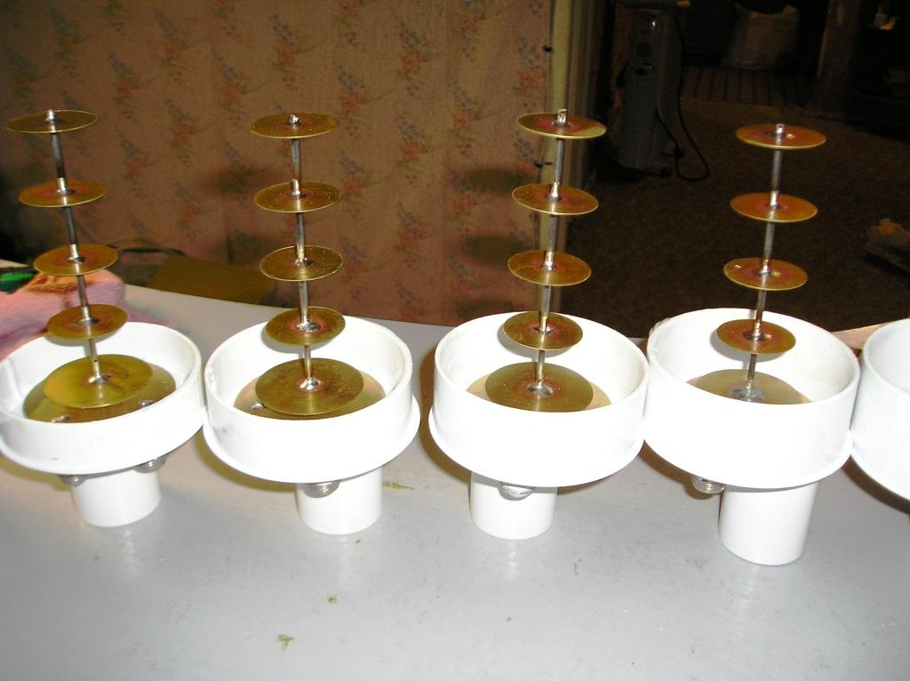

This is the original antenna...
But anyway, Ivan is smart .. !!!

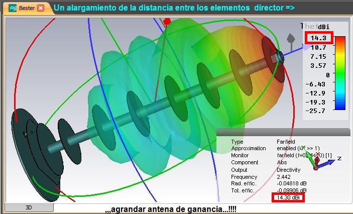

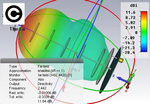

Increasing the gain in directivity of the antenna...
