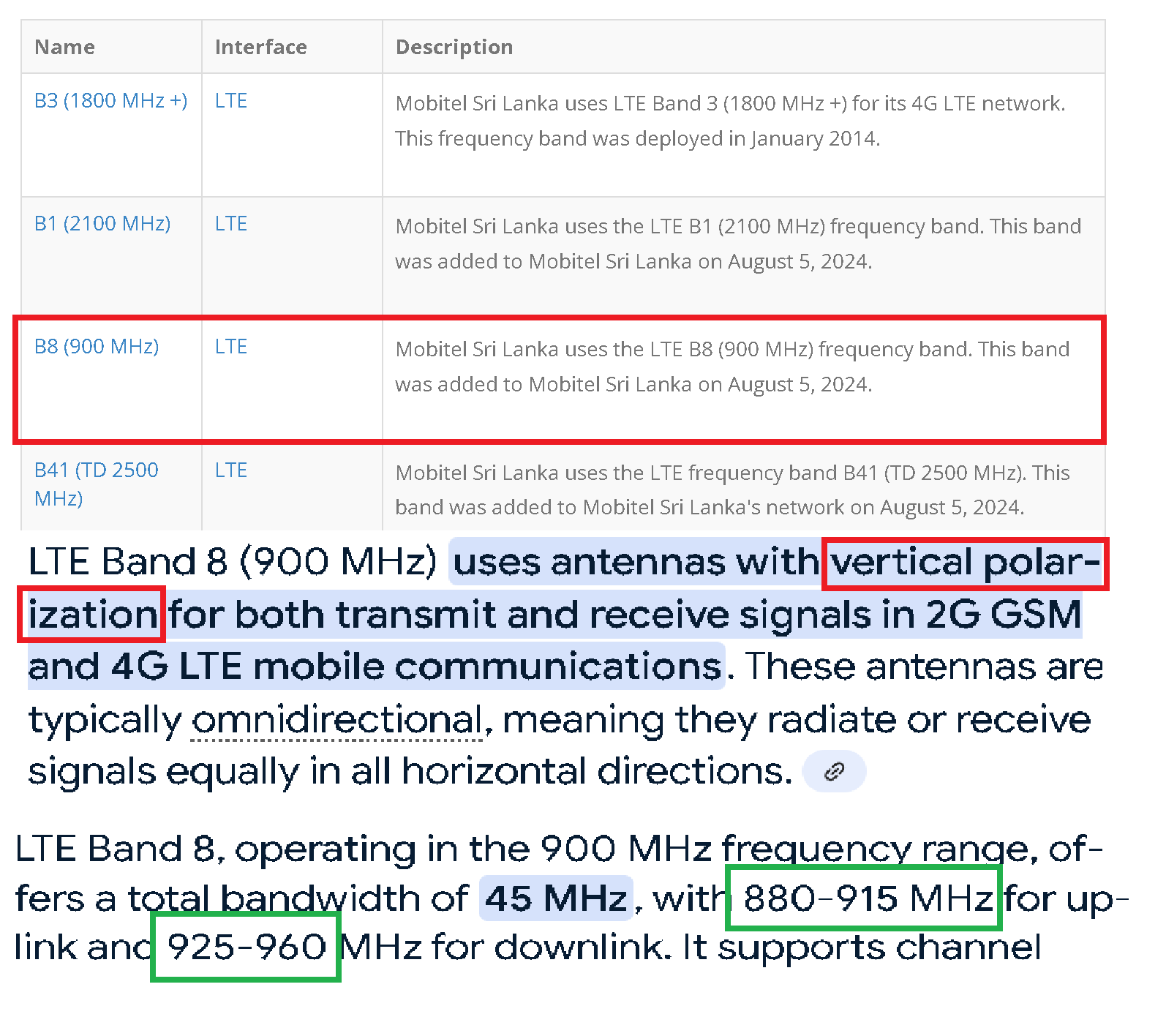

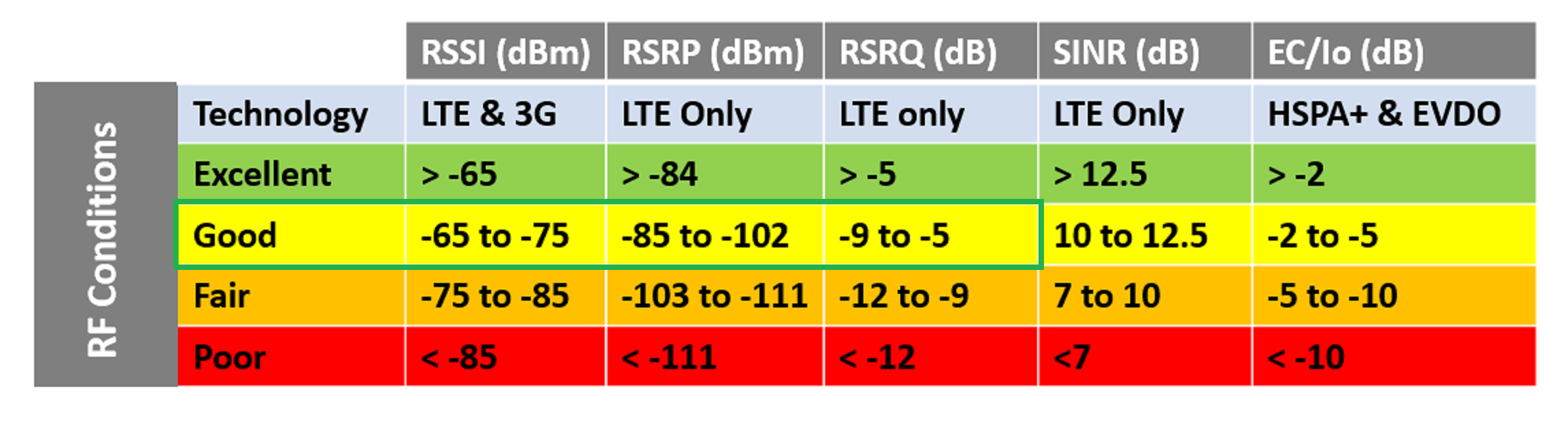

I tried my anttenna and this is the results. My signal tower is 8km far from me. Can you give me another anntenna for bad 5 (850mhz) 15dBi for try
RSSI (signal and Quality (packets received transmited) are too low...you need over 15 dbi at least ...try to make a big reflector (wire mesh , chicken coup wire...at least 1 m , put it in the back of your antenna) Router (waterproof) close by the antenna (losing signal on cables)
You are using a Circular polarized antenna and tryin to receive a VERTICAL polarized signal...NO GOOD...and  shifted band frequency too...
YOUR antenna should provide Vertical polarization and be centered at 920 MHZ with a Bandwidth of 80 MHZ (880-960) Yagi Vertical polarized...

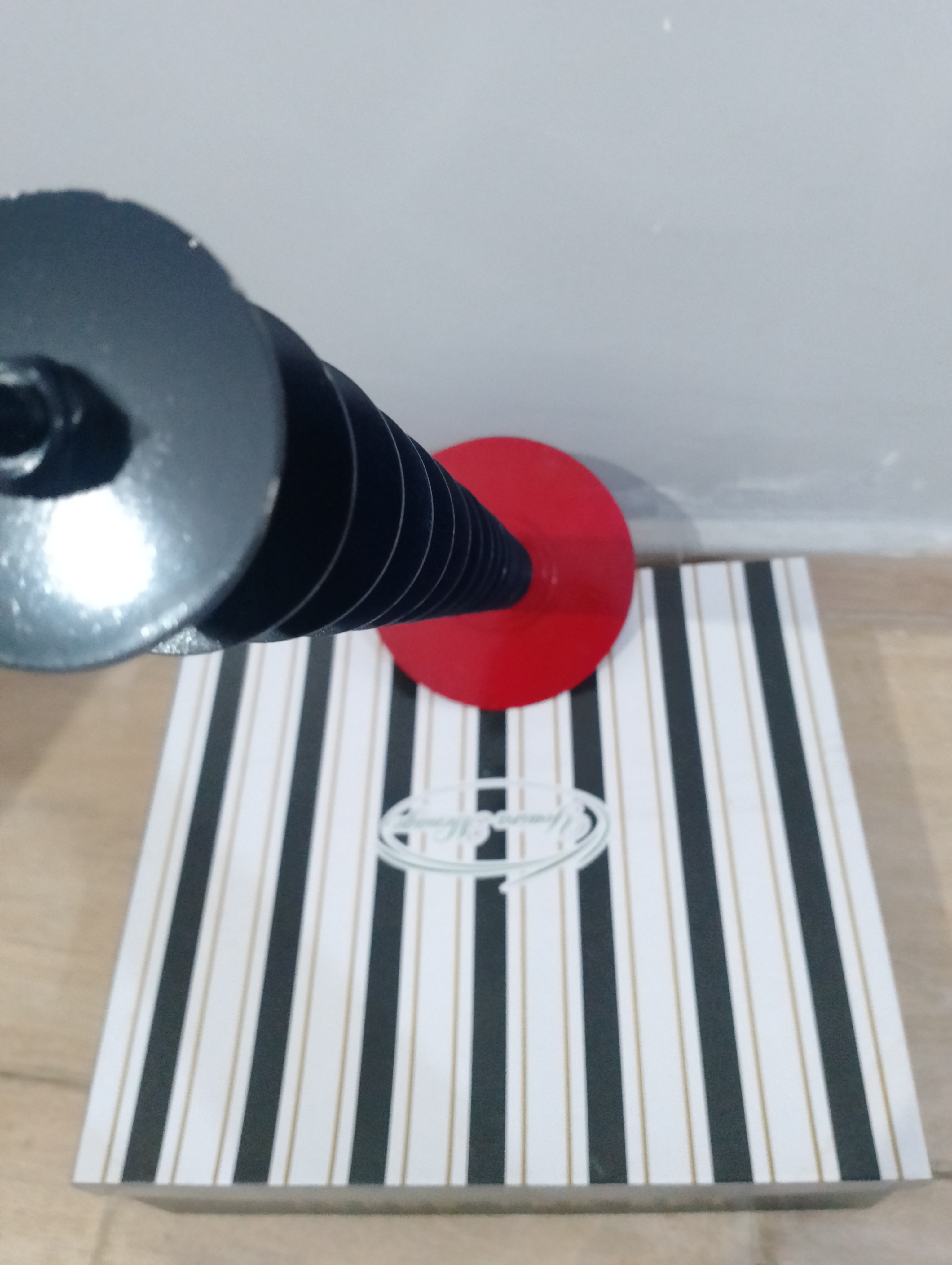

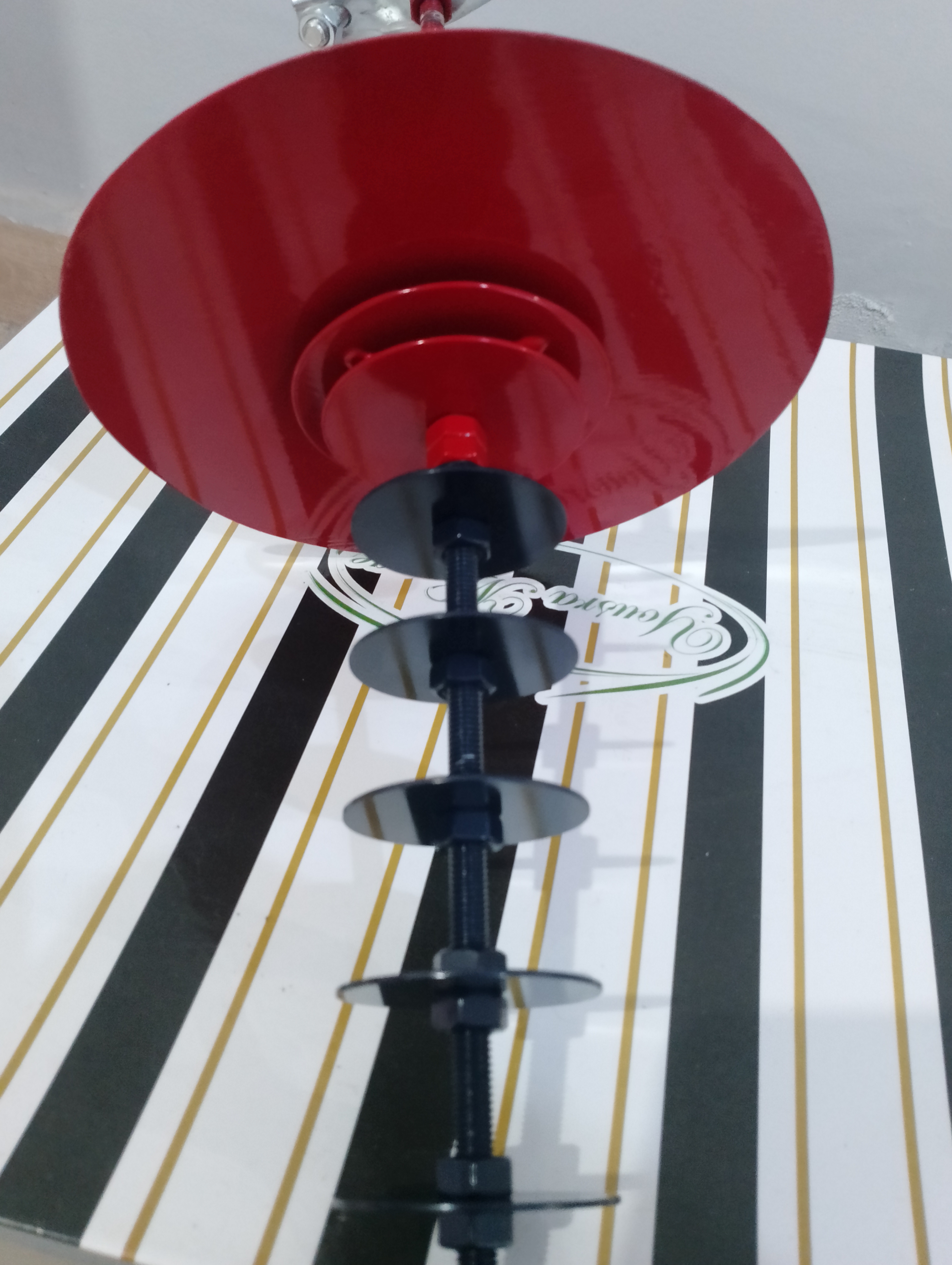

Me gustaría dentro de sus posibilidades este plano para la frecuencia de 2100mhz y como se desempeña con solo 10 discos en vez de 20 si no le es molestia es que no dispongo del equipo y me gustan las publicaciones detalladas que pone sobre cada antena
I would like, within your possibilities, this plan for the 2100MHz frequency and how it works with only 10 discs instead of 20. If it is not a problem for you, it is because I do not have the equipment and I like the detailed publications that you put on each antenna.
I will try to satisfy your desire.....!!!

Aquí en Cuba la conexión es pésima y gracias a sus aportes hacemos las antenas de discos conectando a un dipolo base por inducción porque el otro tema es la falta de electricidad y en michas ocasiones un repetidor no sirve en esos casos
