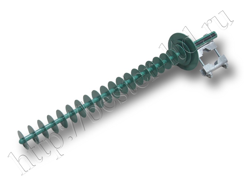

Antenna BDM-2 is designed for outdoor use, although often applied in residential/non-residential premises.
Experts recommend the use of antenna BDM-2, as a client equipment in all cases, build wireless networks of small and medium-range.

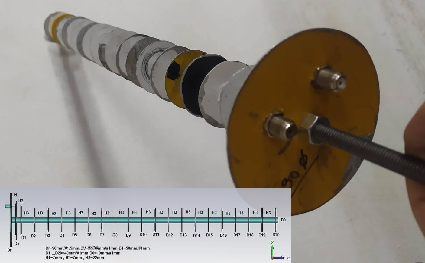

The original of the antenna is with a 64mm diameter cylindrical vibrator
,,, beautiful work, congratulations .... !!!

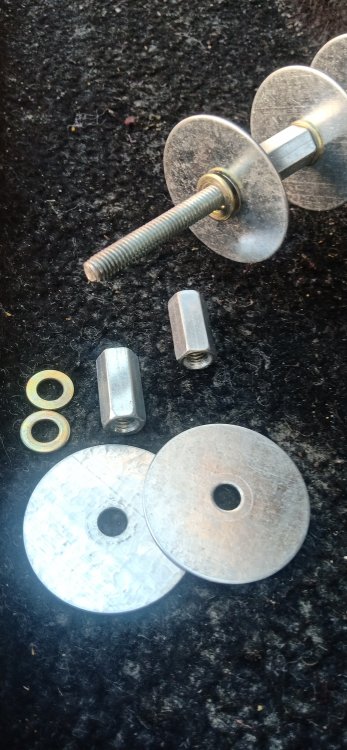

,,,how you made the connection between the elements...???

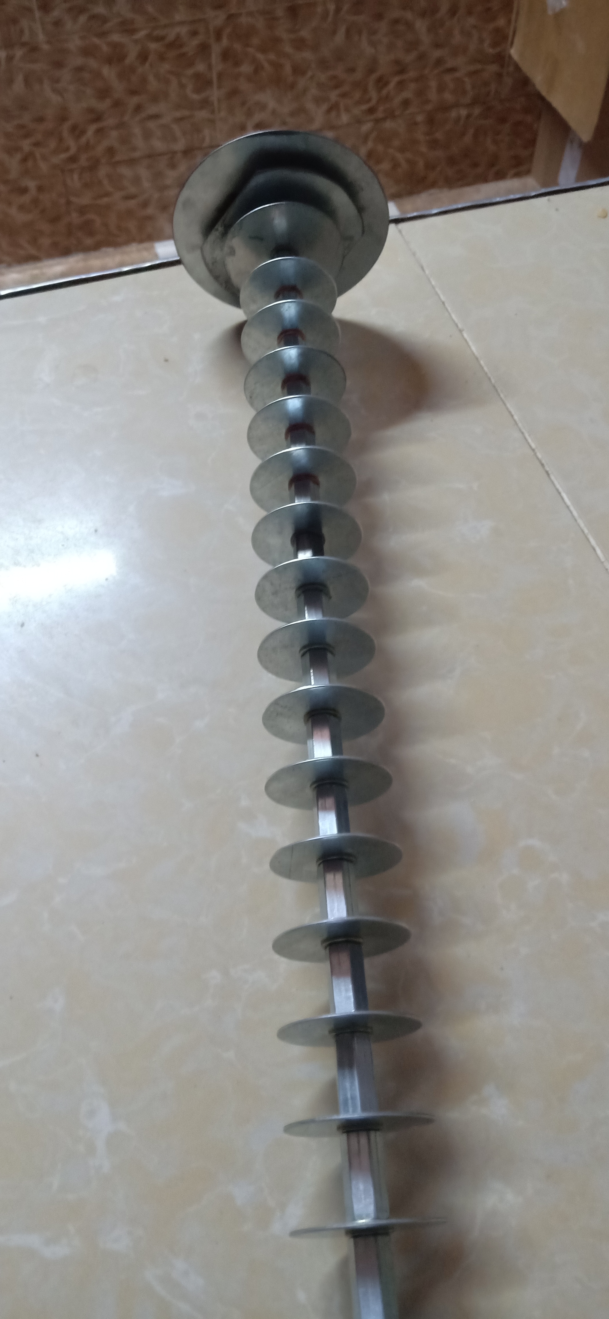

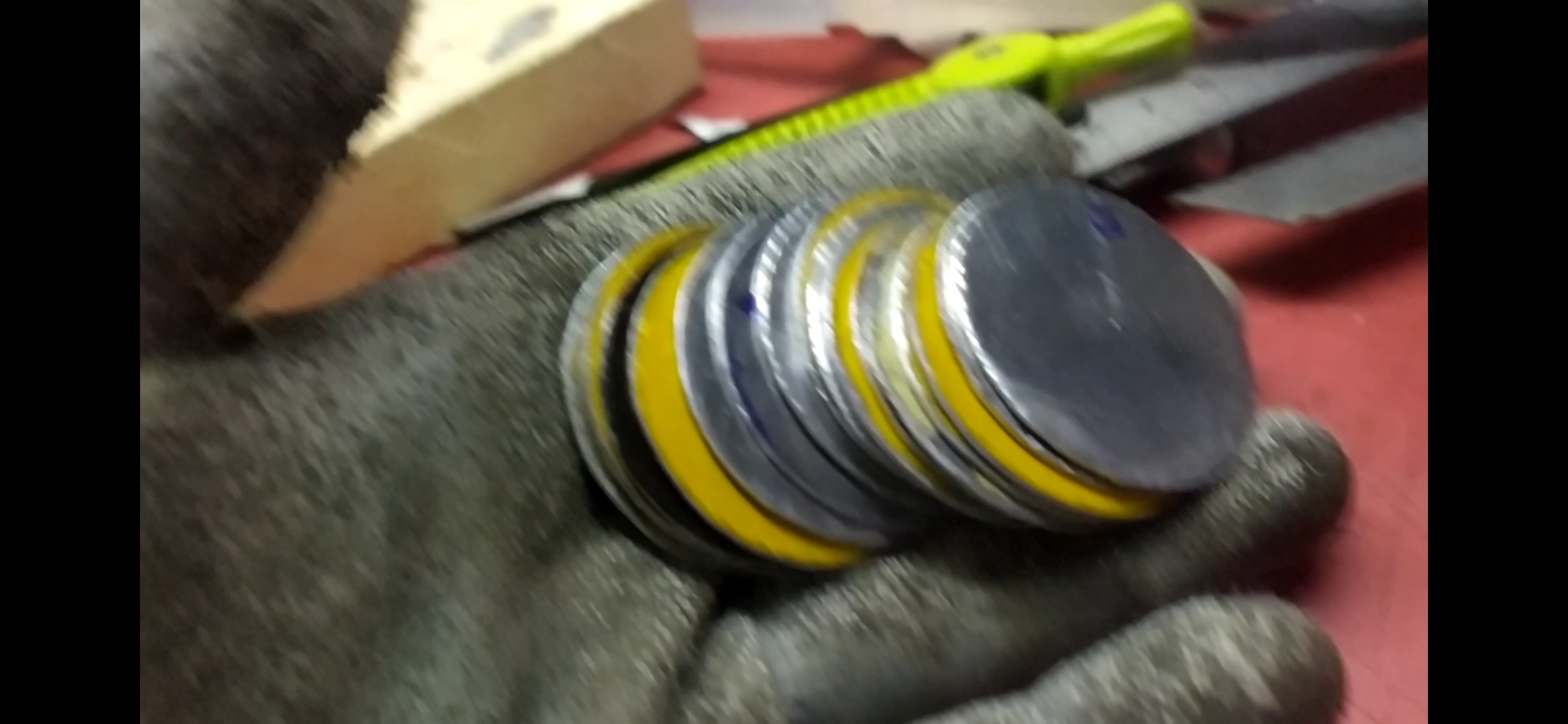

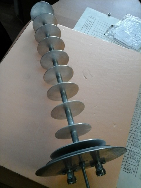

Long threated shaft.   + Many  screw hex ( diameter 10 mm)

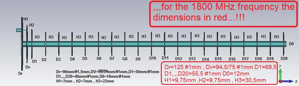

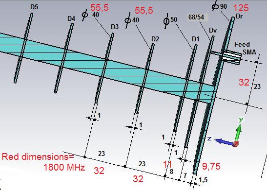

It work in band 1800 mhz ???
Samone try it abd tell it work perfectly in 4g lte band 1800 mhz
This ture ??

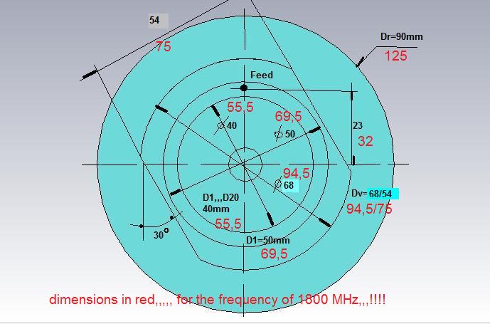

,,, for the 1.8 GHz band, other dimensions are needed...!!!

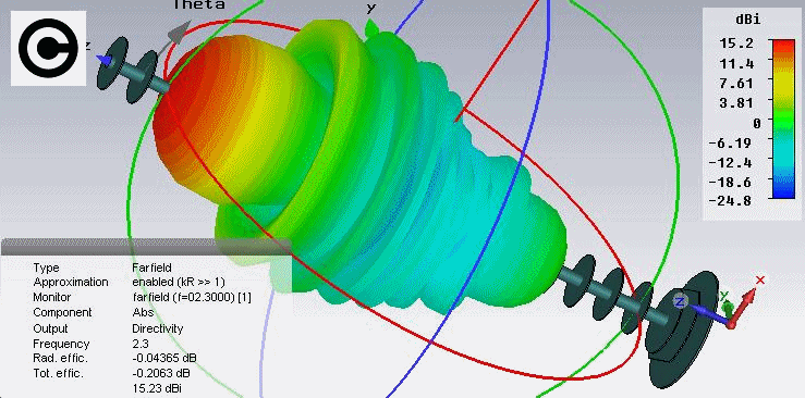

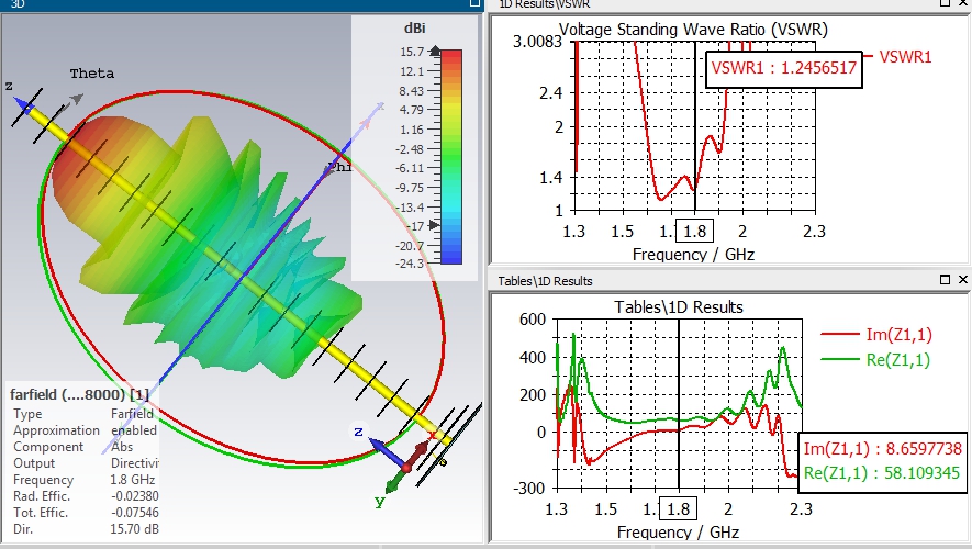

,,, but I think you should wait until I do a simulation with these dimensions ... some small changes may occur...!!!

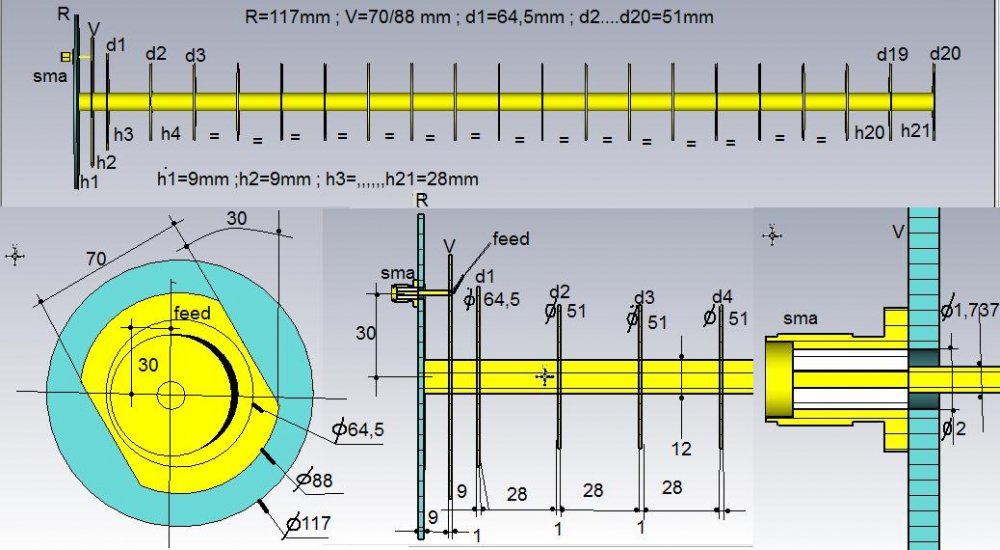

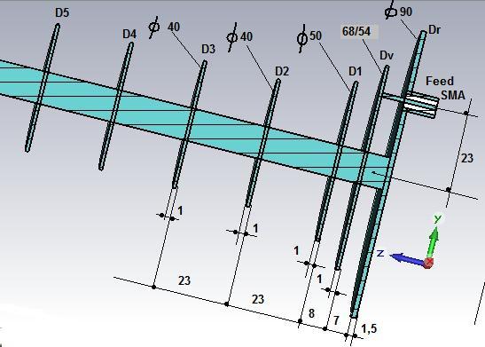

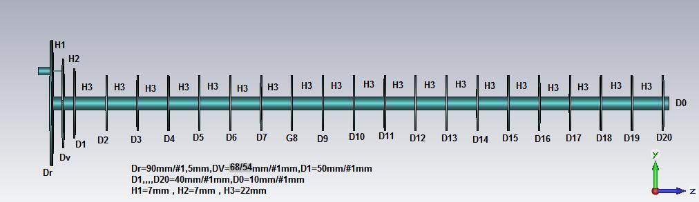

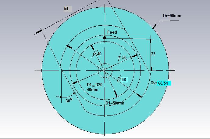

,,, yah, with my resizing it looks like this...
,,,but it seems that it still needs to be resized by shrinking ... !!!
This is the better Jomy :
135,95,82,56,56,56,56,56......it's about 14/15 Dbi
7,8,39,37,37,37,37,37,37....with 10 directors ...it's already shared by you in this forum. I had made it and I got excellent results

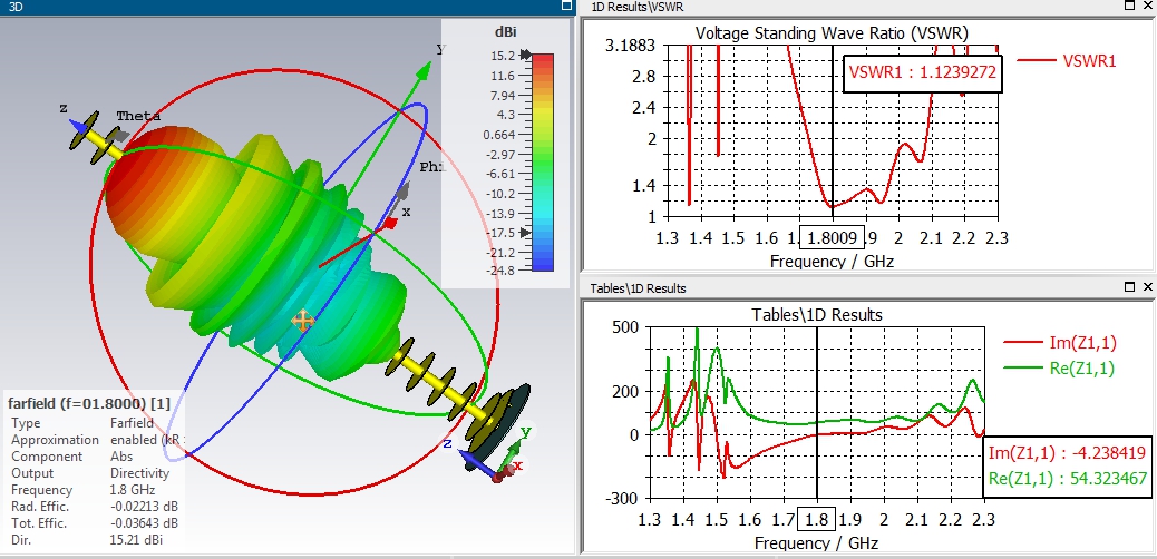

,,, yes, I think this it is the reality....

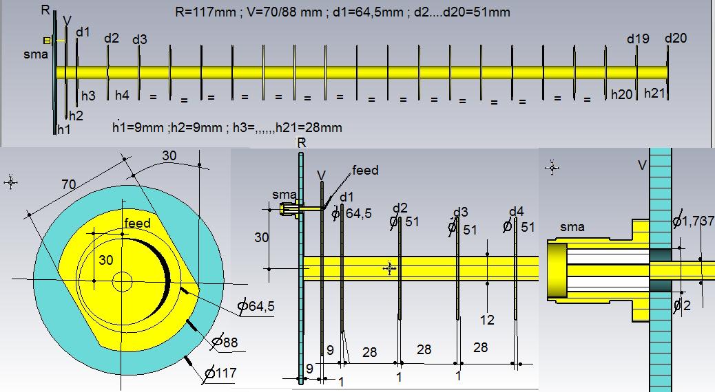

,,,and  here are the dimensions ...!!!

,,, try the dimensions from the first post ... !!!

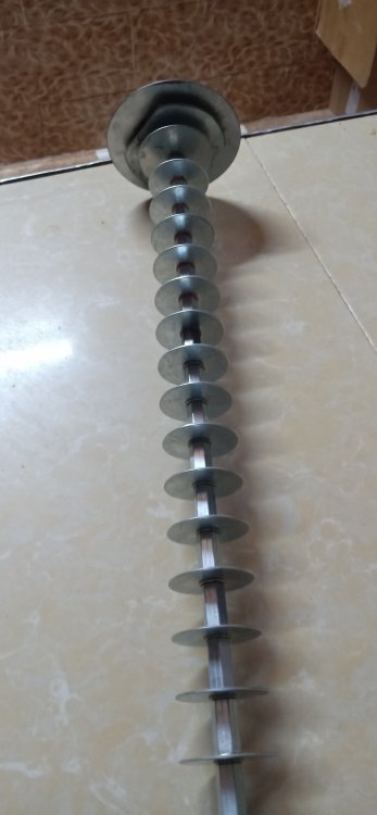

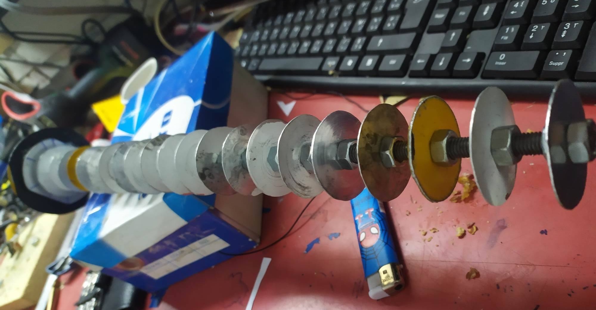

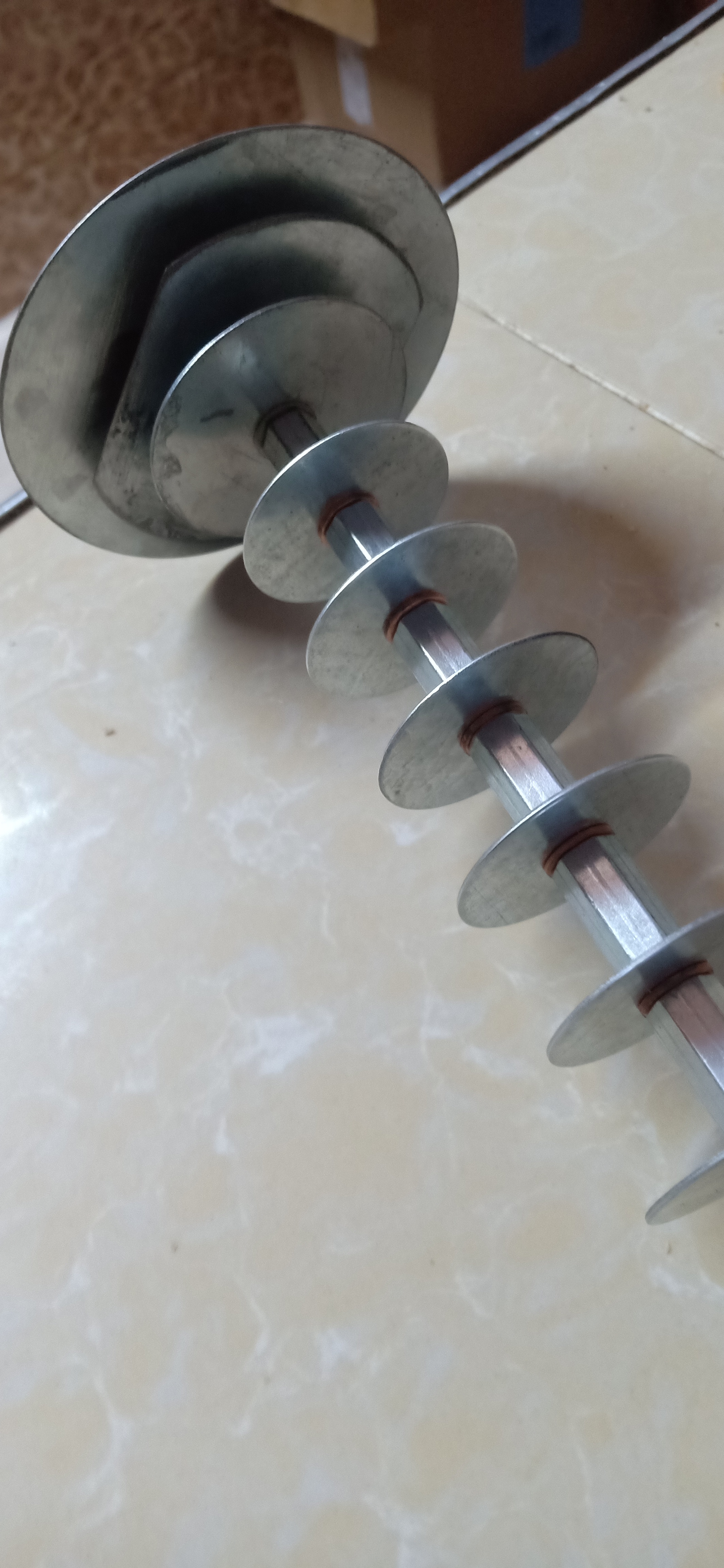

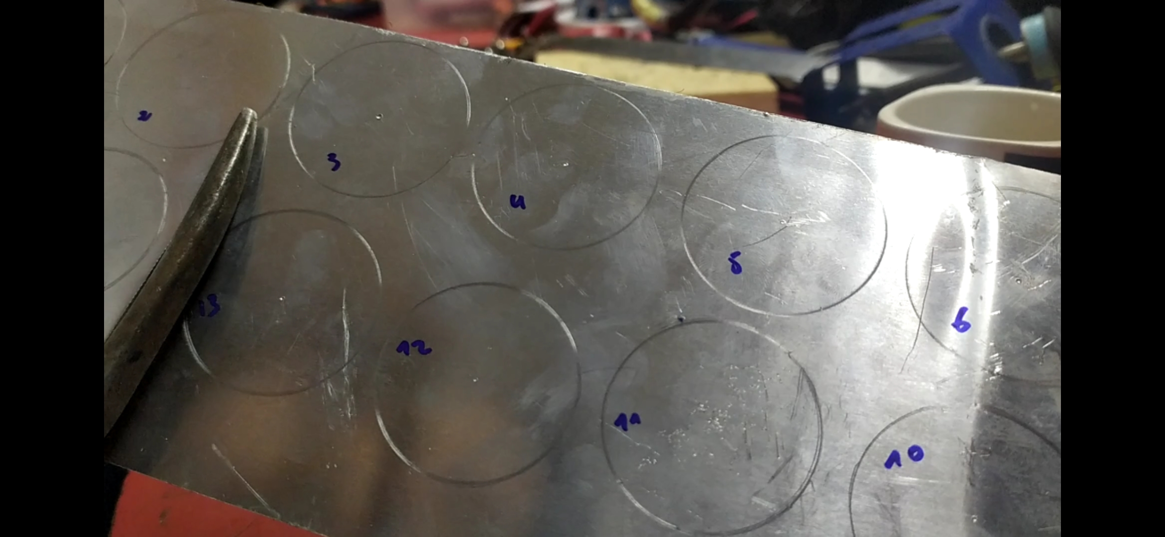

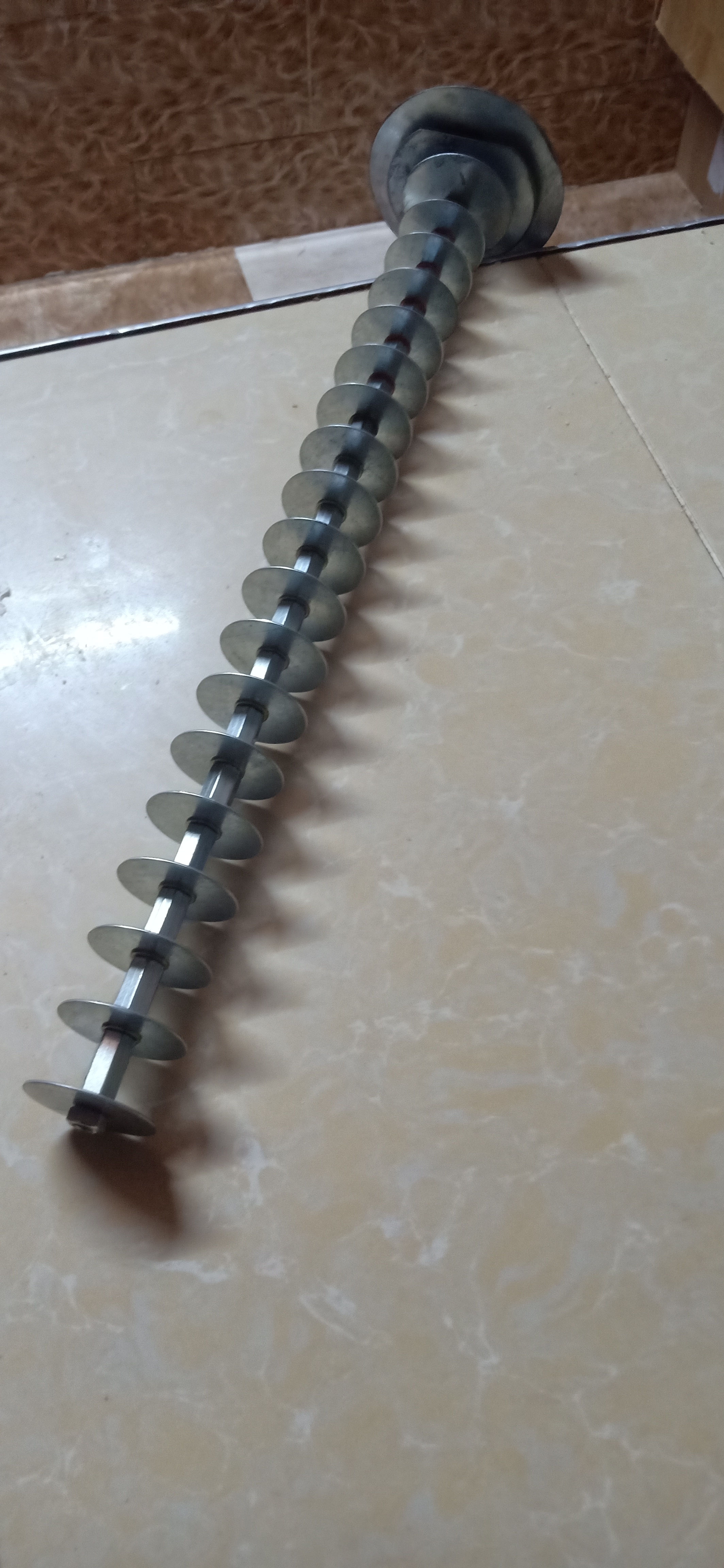

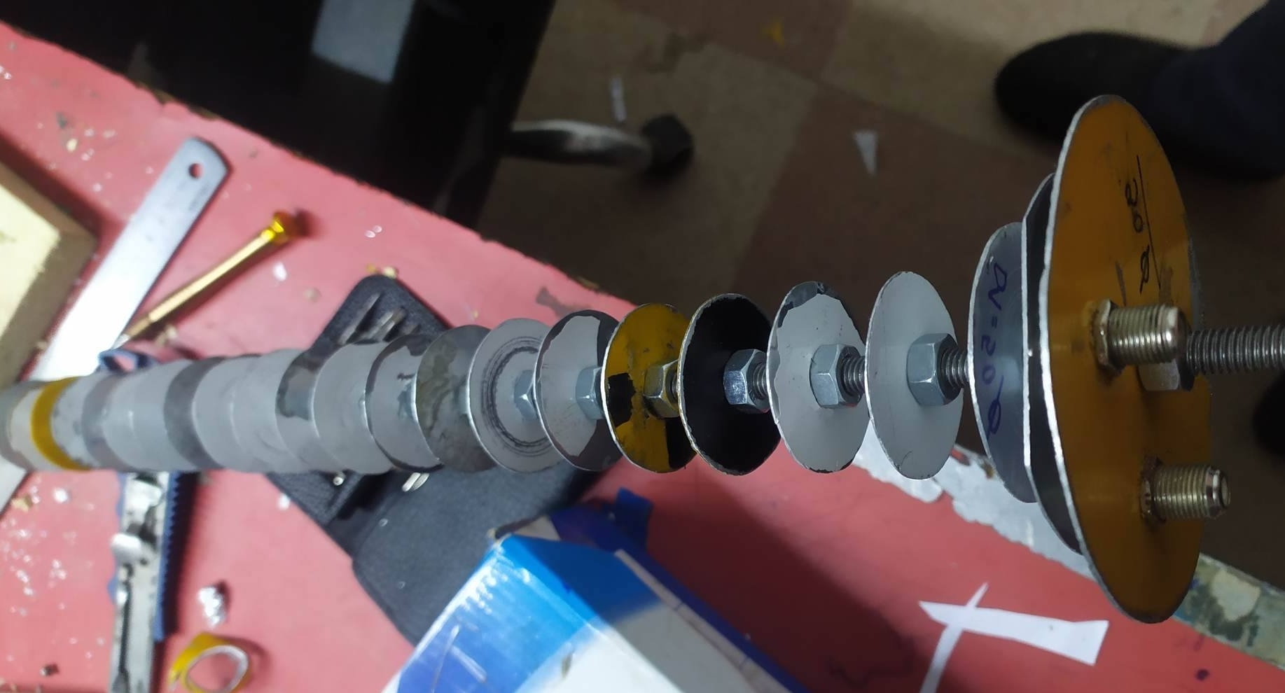

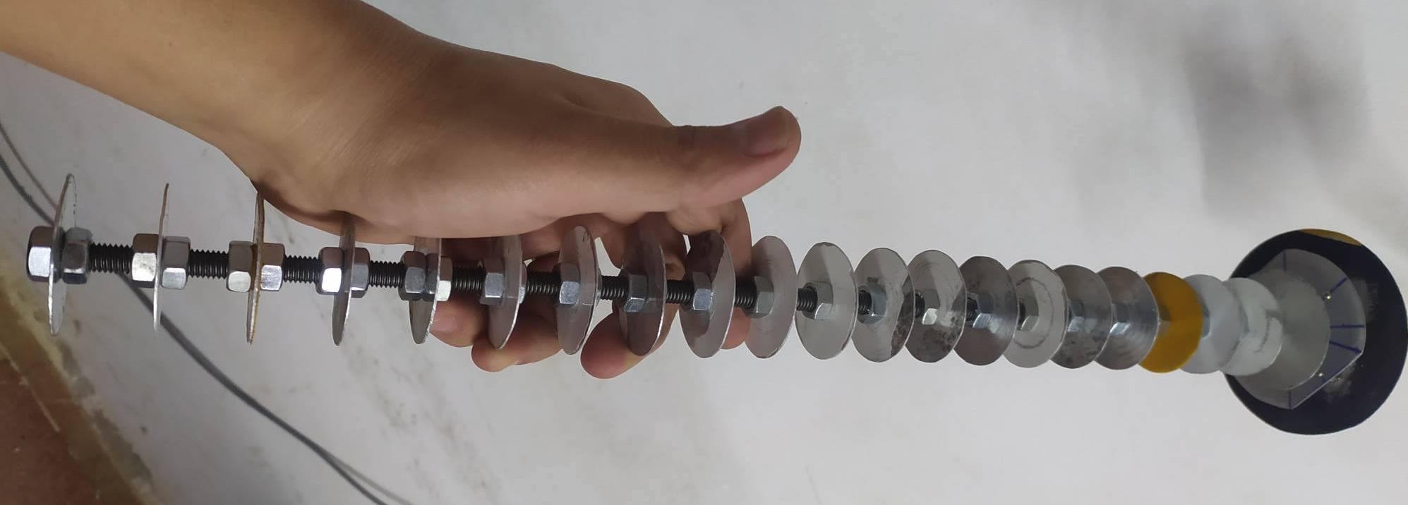

I finished making the antenna from the first post and I will try it later  When I have time (in chaa allah)
There is a question on my mind9_9
Is it necessary to isolate DV or is it normal? -_-
,,,no, it's not really necessary...!!!
