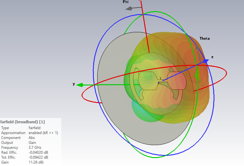

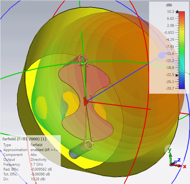

Rond Batwing

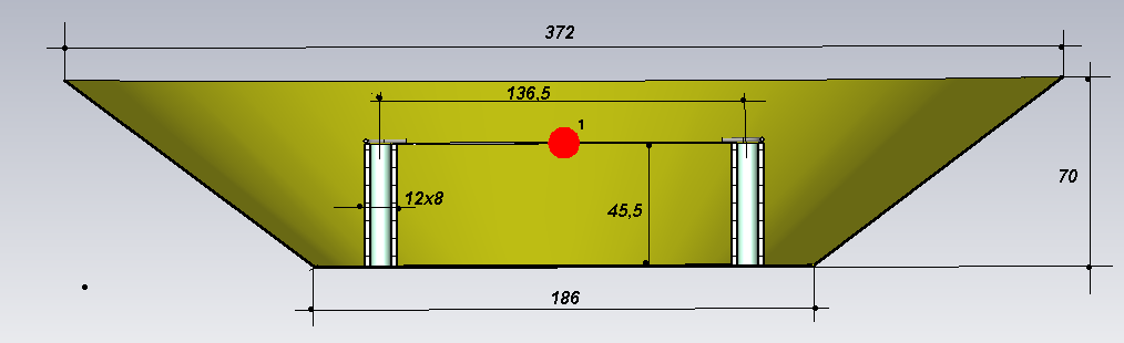

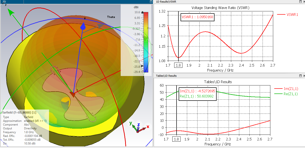

Thank you. I opened the batwing rond.dxf you sent me and it looks like this on the 2nd page.
The graph doesn't look very good at 1800MHz. Is it different?
The diameter of the antenna in "batwing rond.dxf" is 103mm. What is the diameter of the reflector? And what is the distance, 35mm?
Thank you for updating the post above with the images.
I think the 186mm is the diameter of the cone base. What is the height of the cone and the outside diameter?
Perhaps someone will help the room version of the batwing antenna implementation...
,,,,almost perfect...!!!!

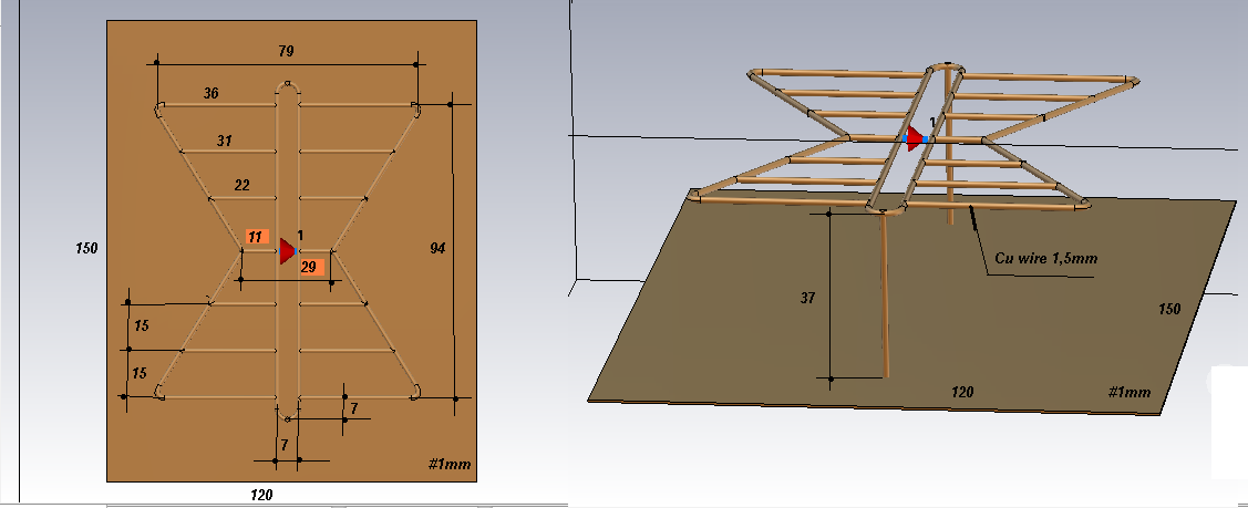

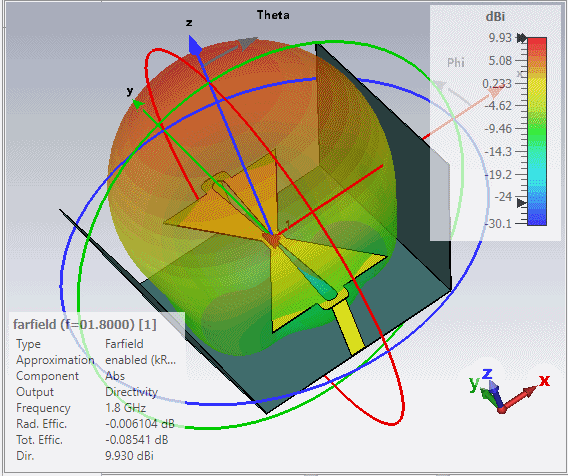

,,,I considered it sensible to resume Aurel's idea from the beginning and to present a version of the Batwing wire antenna...
Or something like this, Petra 10 analog.
Can be done in MIMO?
,,,maybe...I will try to do it...!!!

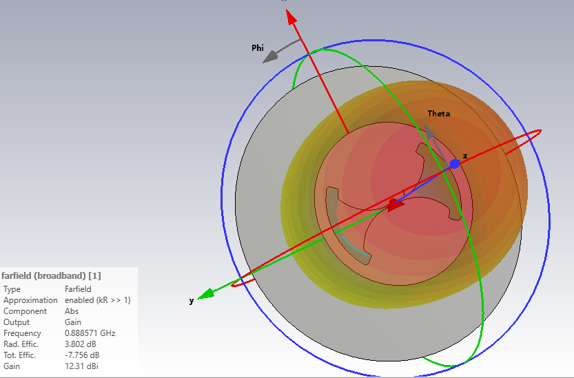

interesting antenna on the 0.88G. Share antenna sizes? Or project if modeling in CST Studio
Edited by Aksonx2
On 8/3/2023 at 9:34 AM, Admin said:
,,,see that in this topic there is something like that...!!!
try post cst file!!!
I don't think I have this file anymore...!!!
On 11/25/2023 at 7:25 AM, Admin said:
,,,r=8mm,you want round batwing for the frequency of 1800 MHz...??
share cst file!!!
I don't have the file anymore, but there are drawings on this post...!!!

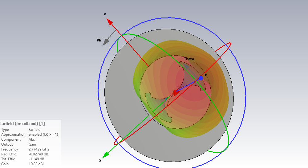

On 8/26/2020 at 10:00 PM, Admin said:
Covid-20
Can this design be extended? (700-900) - (1700-2700) - (3330-3800)
Edited by fjaxo
,,, yes, the frequency band can be extended, but it's extra work...!!!

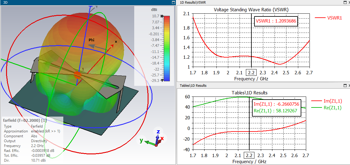

,,,another form of the Batwing antenna with good results...!!!
