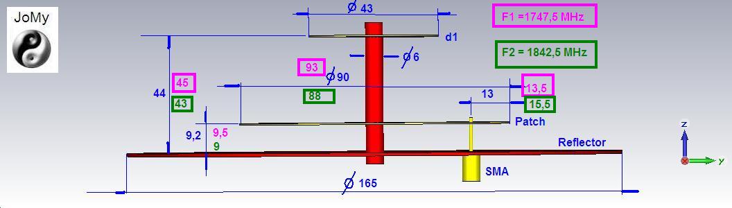

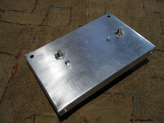

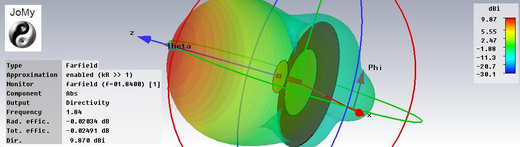

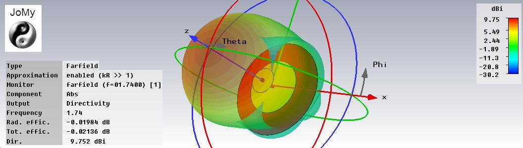

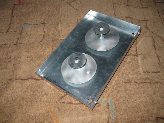

LTE 1800 network (1710-1785MHz transmission, 1805-1880MHz reception)
The design consists of 2 antennas that operate one for reception, the other for transmission.
2 hours ago, Admin said:
Мне любопытно, каковы результаты ... !!! ???
The antenna works, I liked it, you can repeat.
please can i have the diemension for this anntenna
Can I add more reflecters to get more gain ...?
,,,not...!!!
