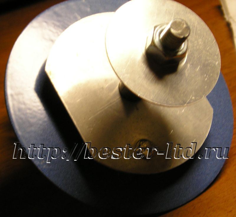

Is a Russian patch-antenna for its positioning in the focus of a parabola offset...
Antenna is broadband (2.3-2.7GHz)
Bester Antenna on the offset dish
It has a circular polarization antenna.

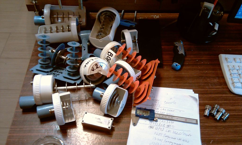

Construction practice of MIMO antennas Bester...
5 people like this

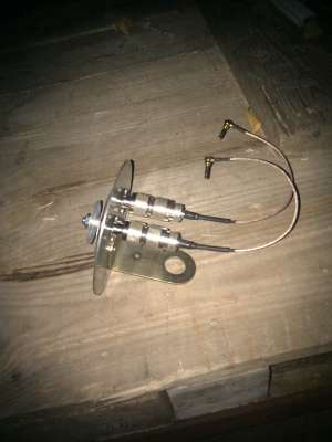

 A 3G antenna Bester in the focus of a parabola offset...

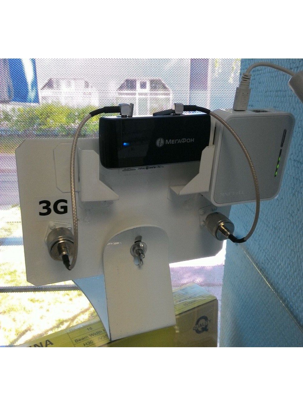

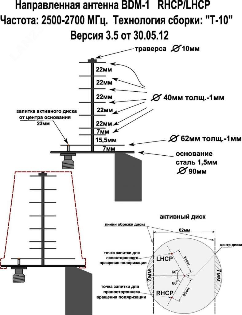

Directional antenna BDM-1

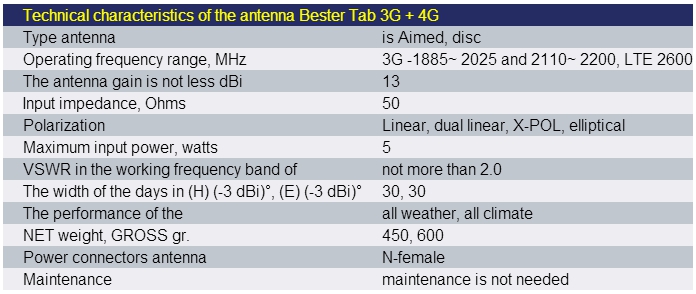

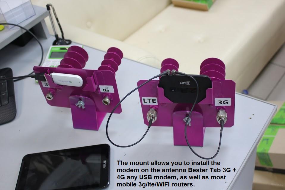

BESTER TAB 3G+4G ANTENNA, 3G/4G/LTE, 13 DB
Antenna Bester Tab 3G + 4G is designed to increase the speed and stability of connection mobile Internet in 2 modes:
3G transmission frequencies modem 1885 MHz to 2025 MHz and of the radio reception with the tower operator 2110 MHz — 2200 MHz
4G/LTE 2600 MHz band
The antenna can be operated in a network of any  operator and connects to any USB 3G/4G modem (router) with connectors for external antennas.
Weatherproof shockproof design, low weight and versatile mounting allow to recommend the use of this antenna in the car, at the cottage, hikes and walks. The antenna can be easily positioned on any horizontal and uneven surfaces, and if desired, it is easy to fix on the wall structure or outer slope of the window, standing next to the tree.
The mount allows you to install the modem on the antenna Bester Tab 3G + 4G any USB modem, as well as most mobile 3g/lte/WIFI routers.

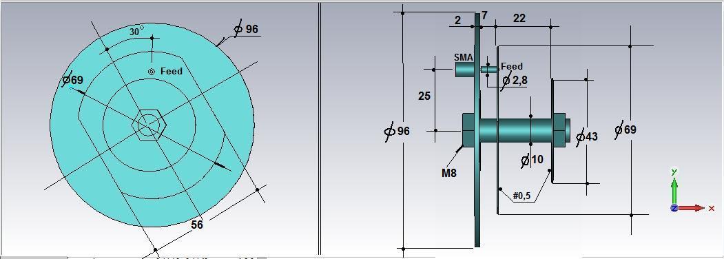

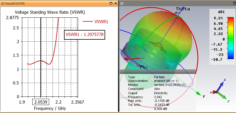

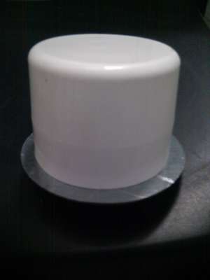

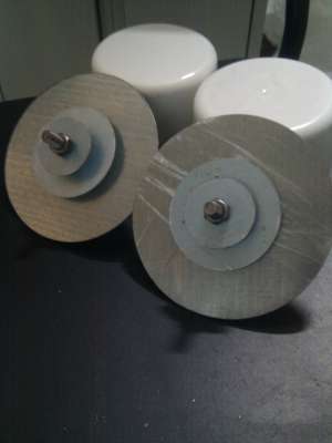

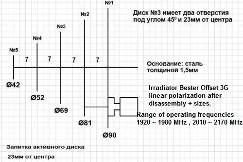

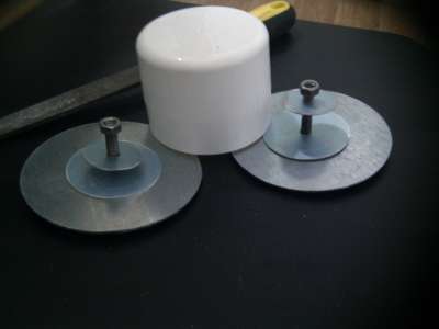

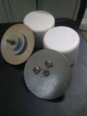

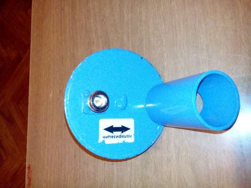

Irradiator Bester Offset 1900-2200 GHz 3G
Range of operating frequencies    1900 - 2000 MHz 2100 - 2200 MHz
Gain    9 dB
CWS    1,5
Polarization    Linear is selected when installing
Impedance    50 Ohm
Connector    N-female

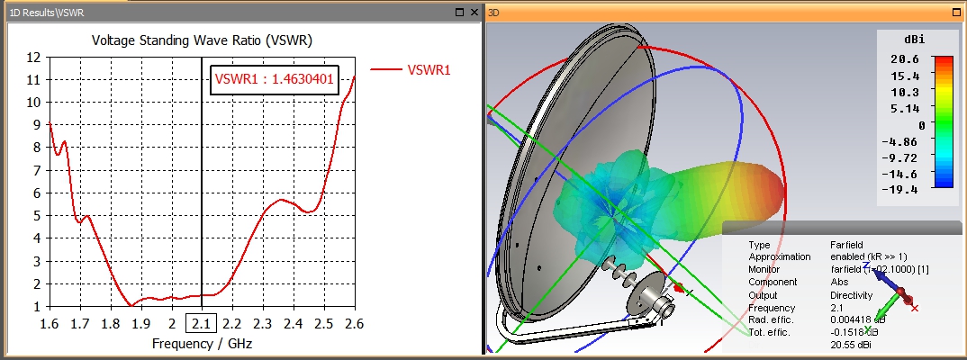

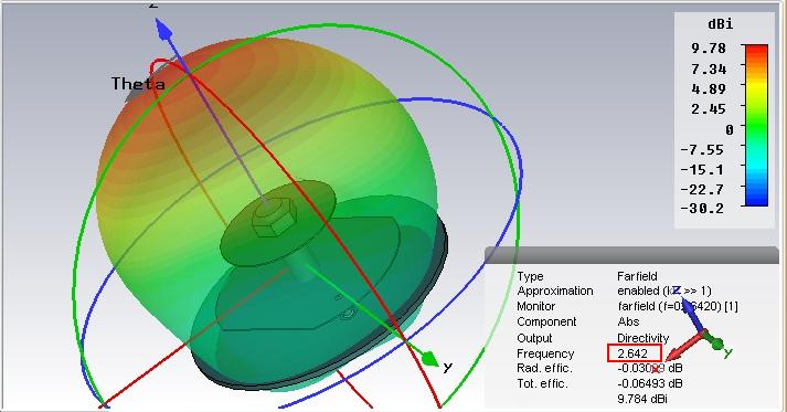

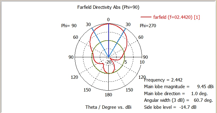

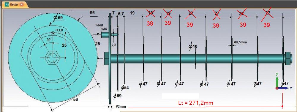

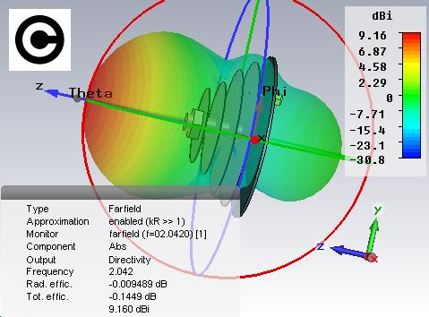

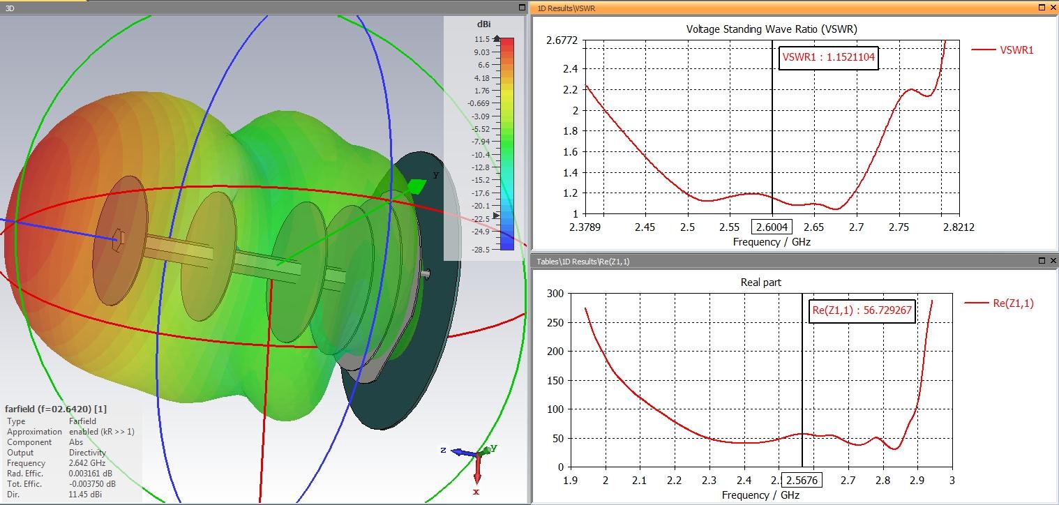

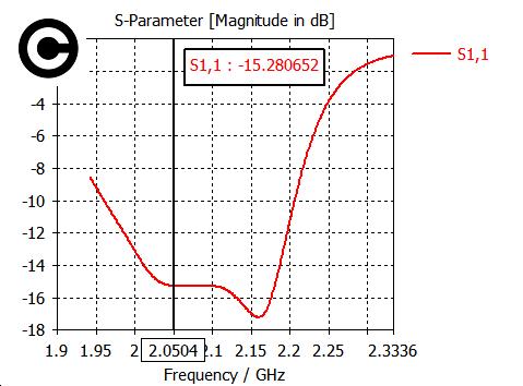

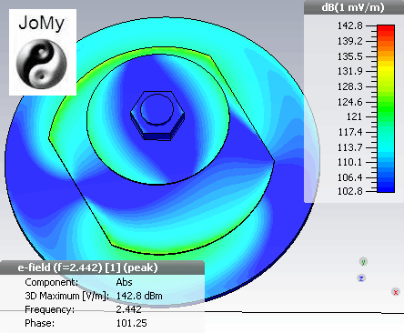

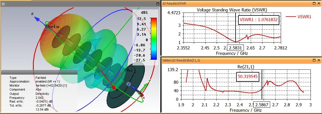

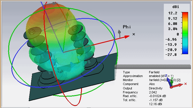

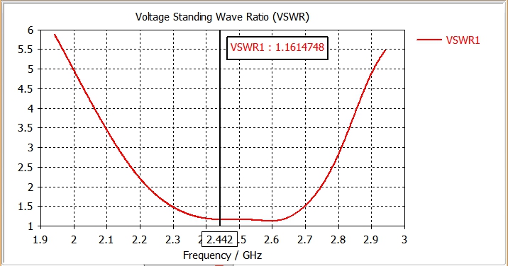

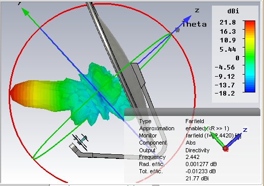

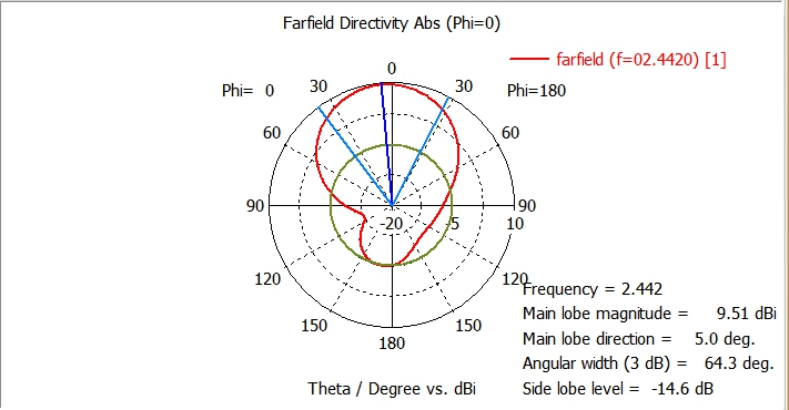

,,,and the reality of simulation...
,,,,good, a more constructive, more special ...

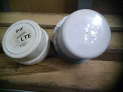

 LTE 2600 MHz band.
4G antenna-LTE  is a subscriber device for improve signal reception operators for wireless data transmission working in 4G (LTE 2500-2700 MHz).

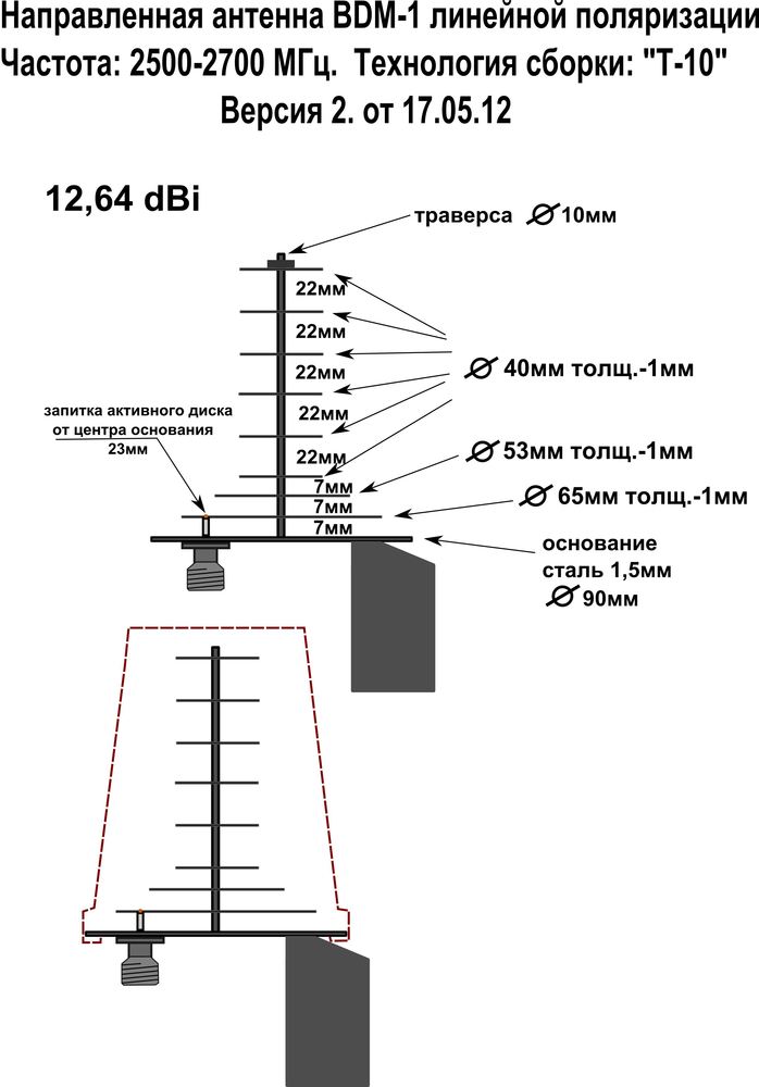

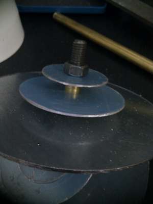

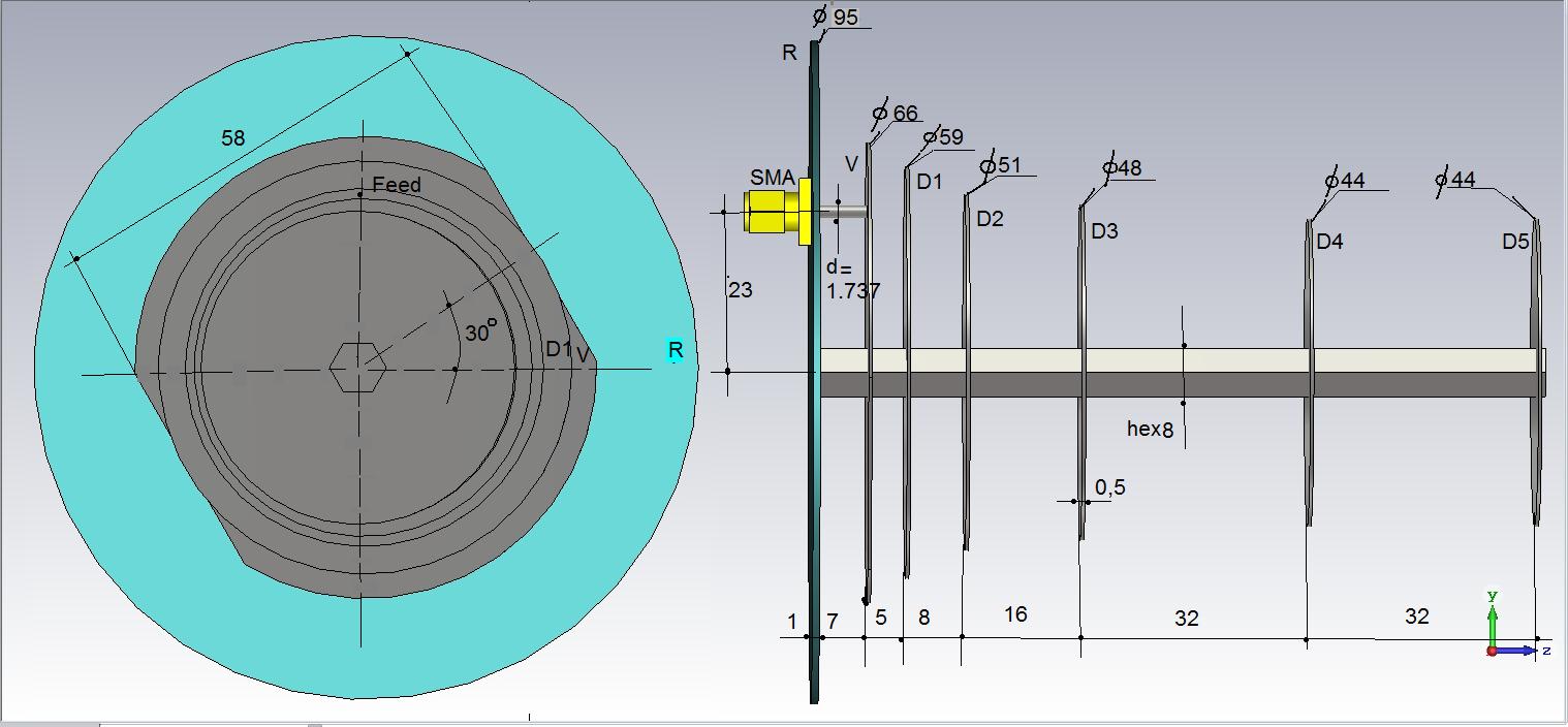

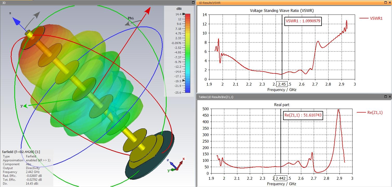

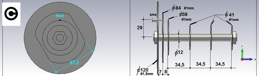

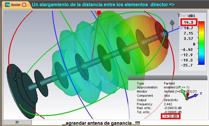

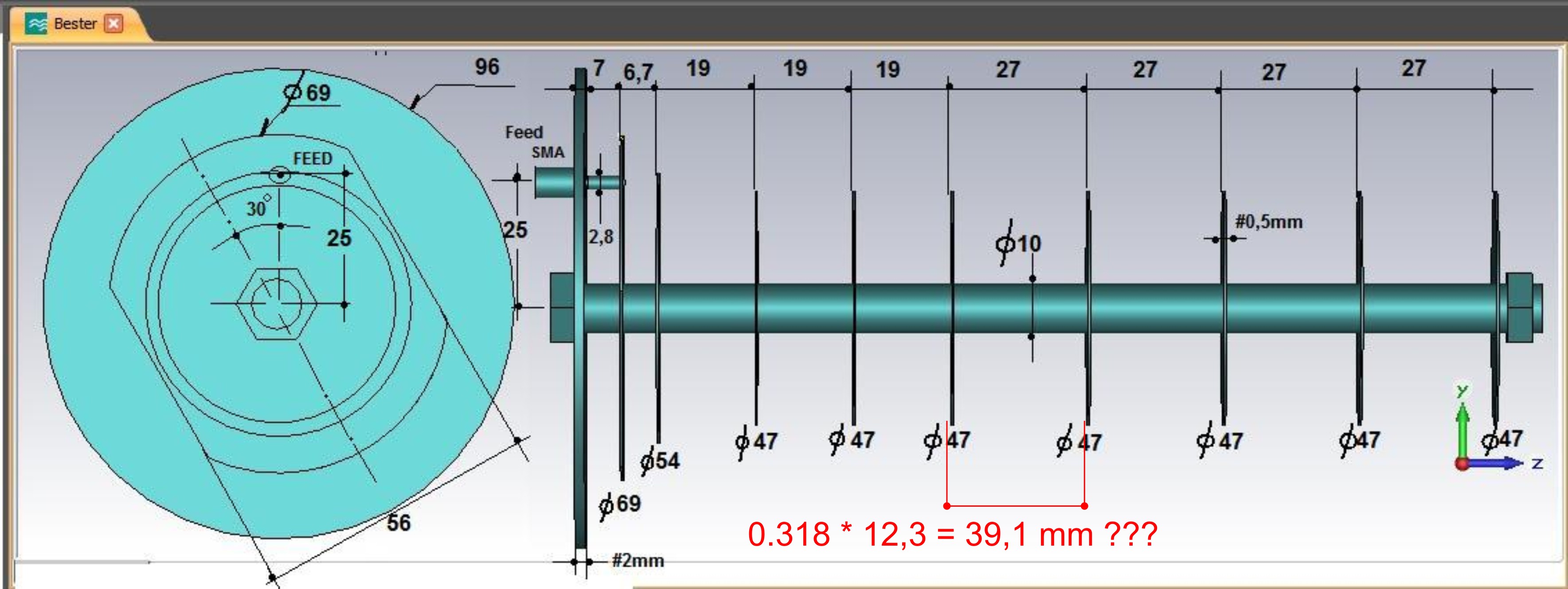

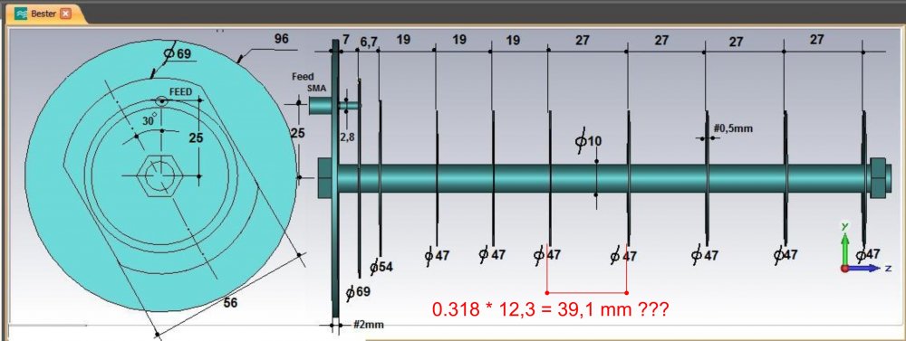

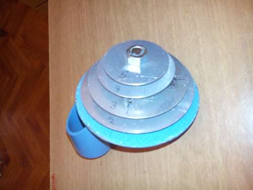

,,,for this antenna, if there is put two directors again, you get a good one...!!!

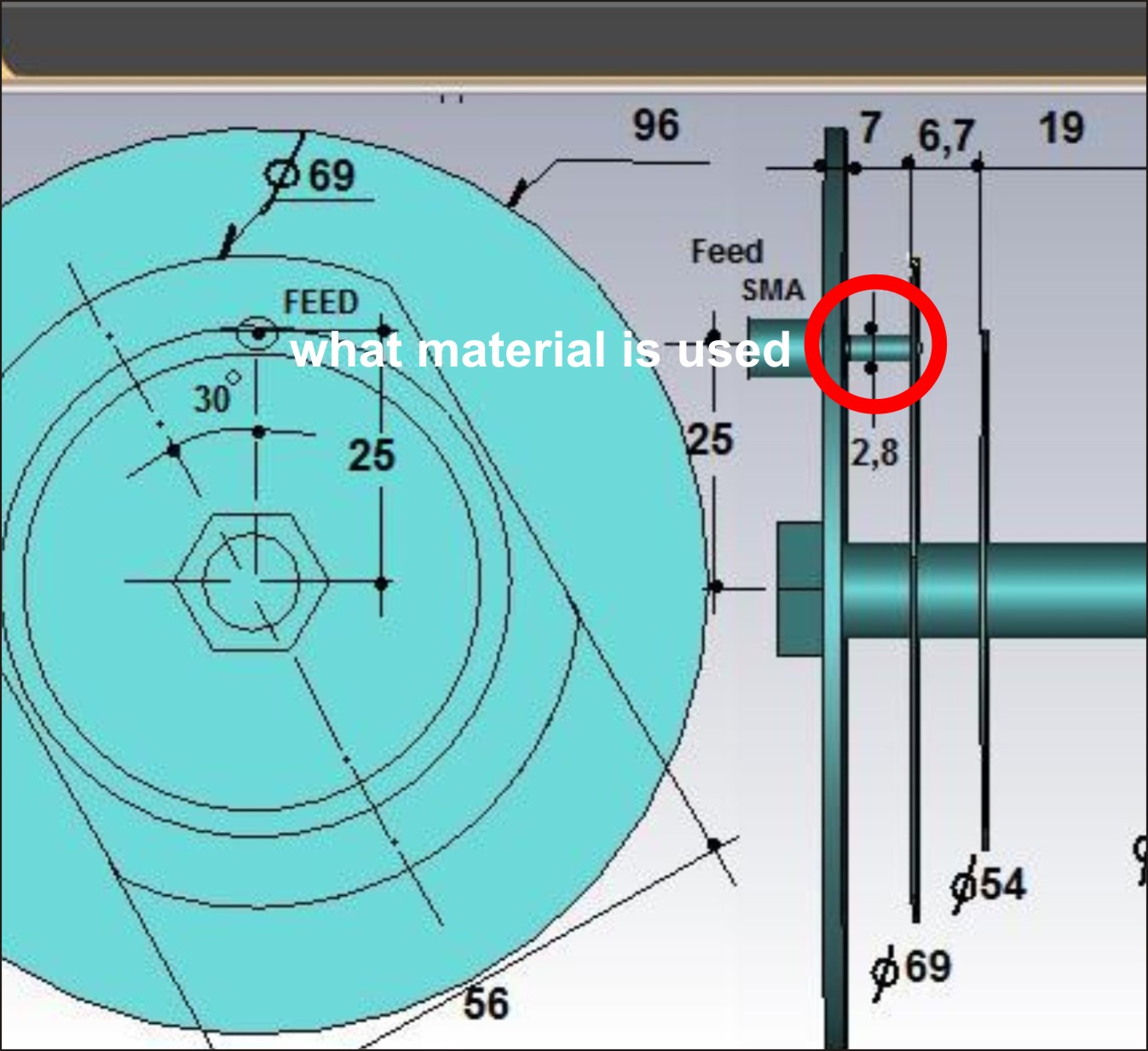

On 11/1/2016 at 8:18 PM, Admin said:

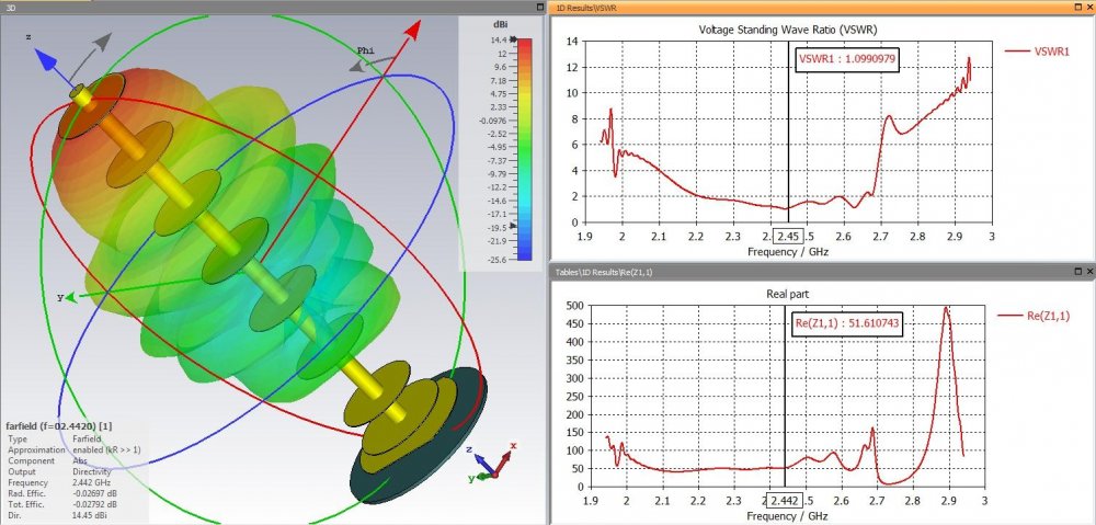

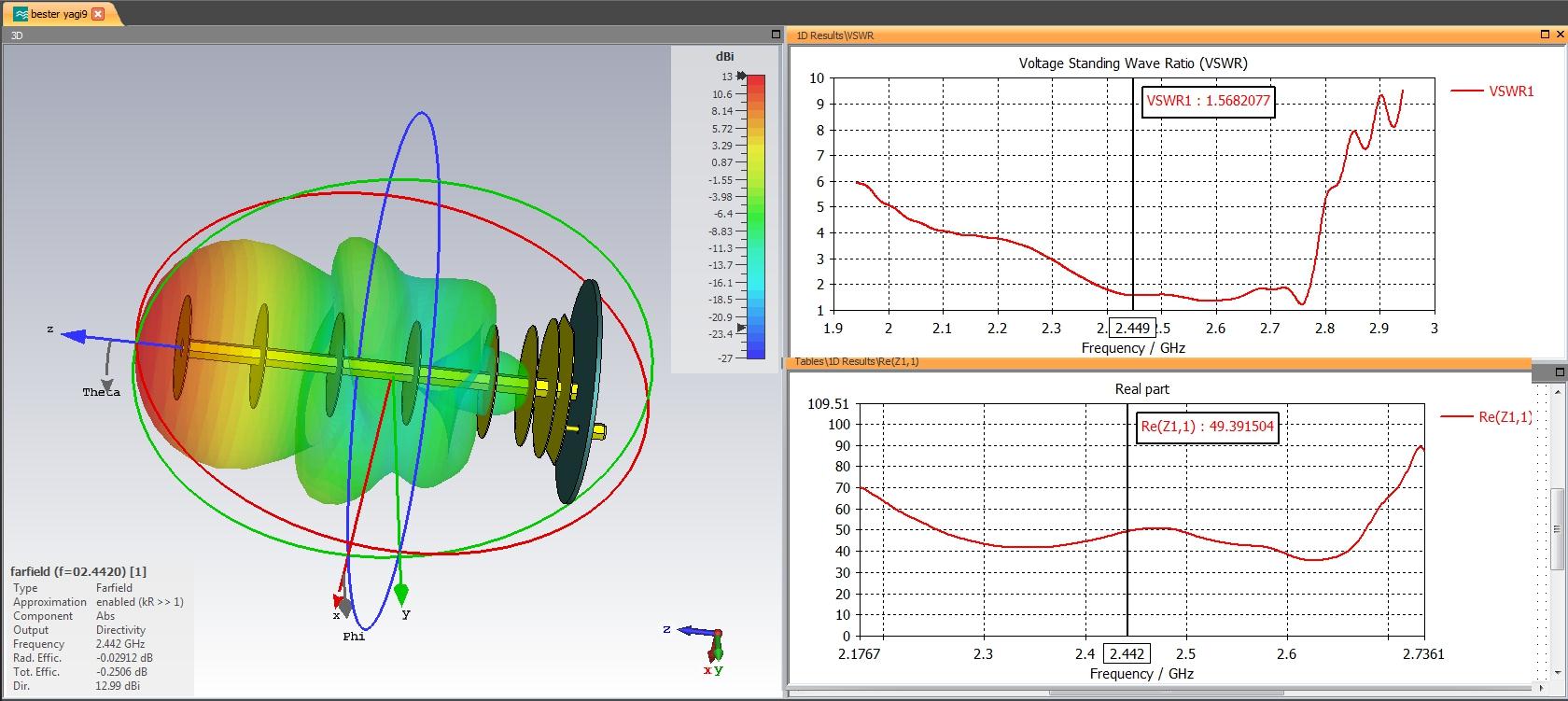

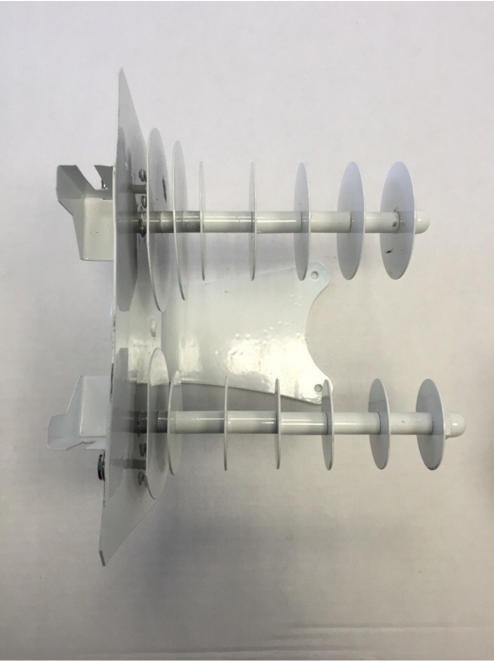

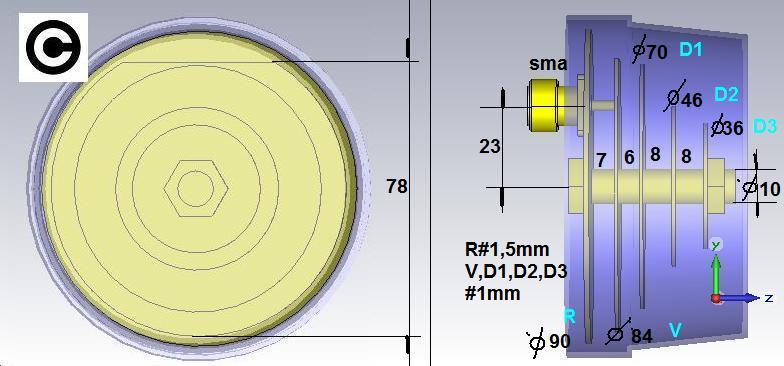

it is real have a gain 14dBi?? for 2.4ghz??
,,,yes, it's true, the distance between directors  it would be best, I  think it is Lambda / Pi = 0,318*Lambda...!!!
More gain;
Improved radiation pattern;
More stable operating parameters;
Greater reliability;
Superior mechanical characteristics.
Is miniaturized.

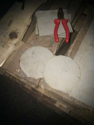

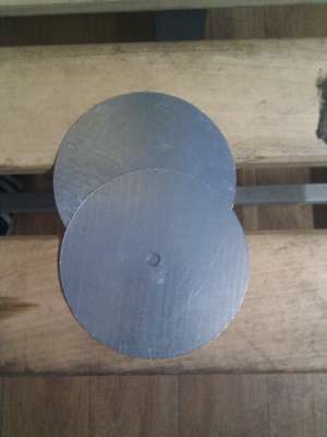

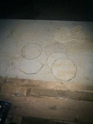

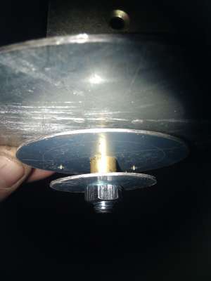

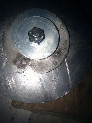

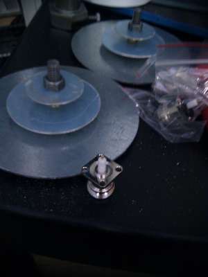

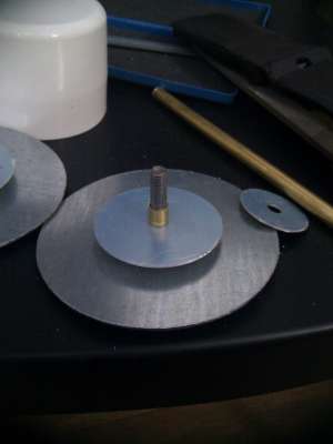

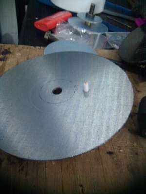

,,,material that can be tinning....!!!
ok thanks, i will try to make it soon
On 15.05.2019 at 4:44 PM, Admin said:
More gain;
Is miniaturized.

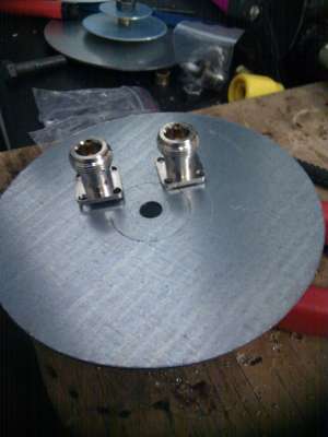

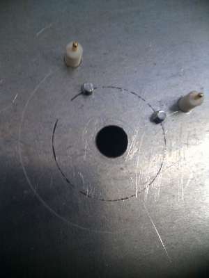

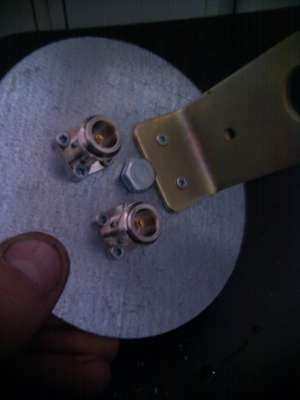

Can you make a 75 Ohm version of this antenna?
Or this: https://ypylypenko.livejournal.com/75267.html (yurik82 couldn't do at 75 Ohm, as "the displacement of the pin increases strongly negative reactivity (i.e. shifting the resonance), most likely it is necessary to recalculate the sizes of the active and associated with the first disk").

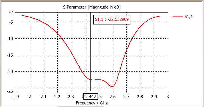

,,,yah...!!!

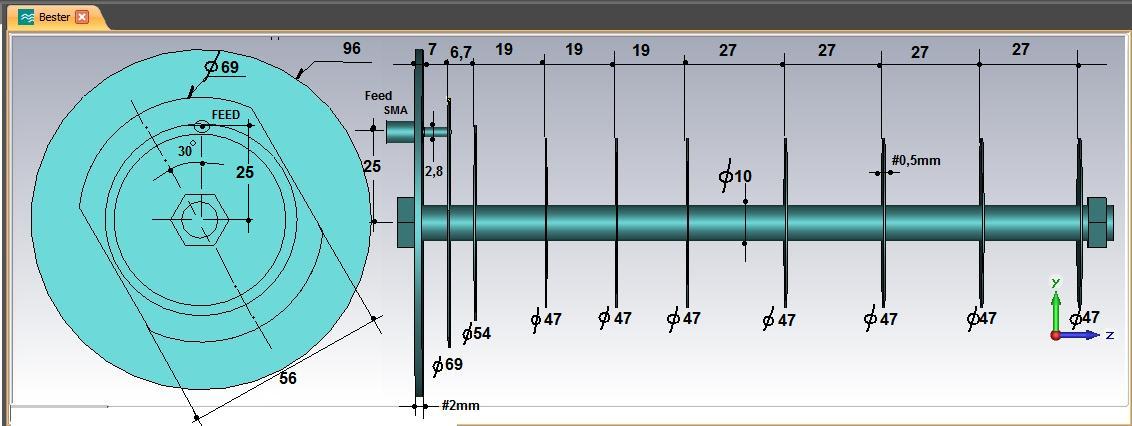

,,,for 2442 MHz ..??
,, you can do that ...???

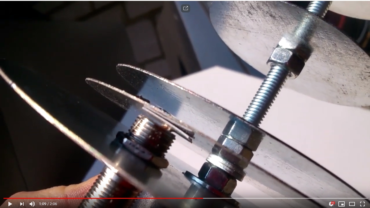

,,,with this...
