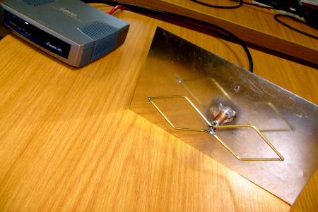

This page details the construction of a biquad antenna. The biquad antenna is easy to build, and provides a reliable 11dBi gain, with a fairly wide beamwidth.

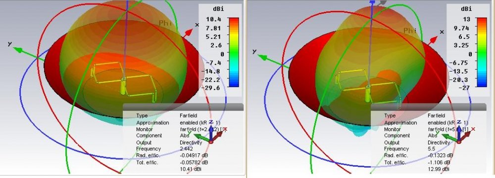

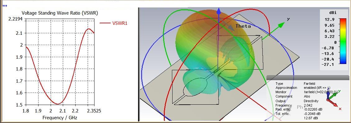

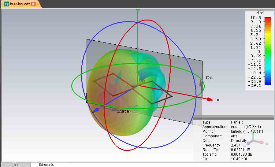

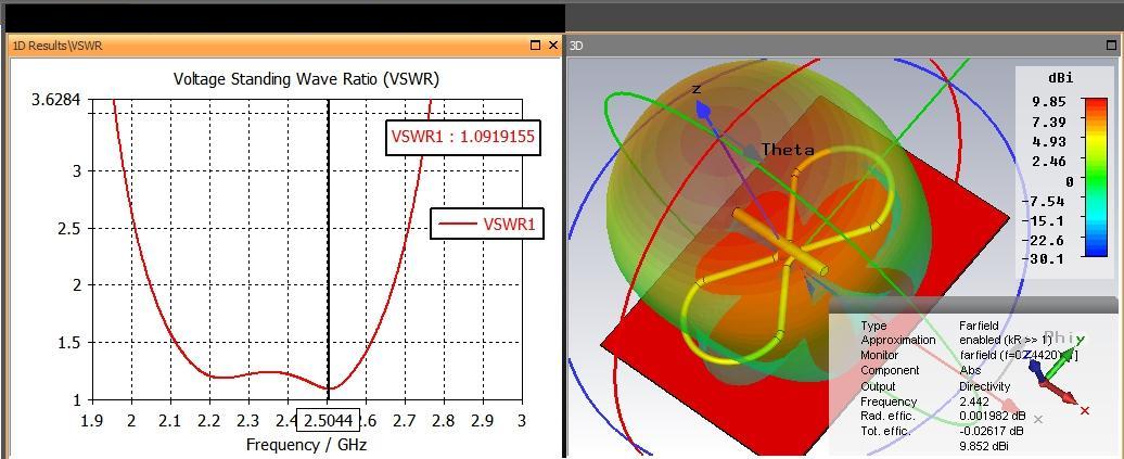

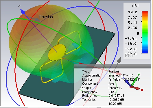

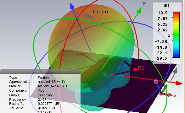

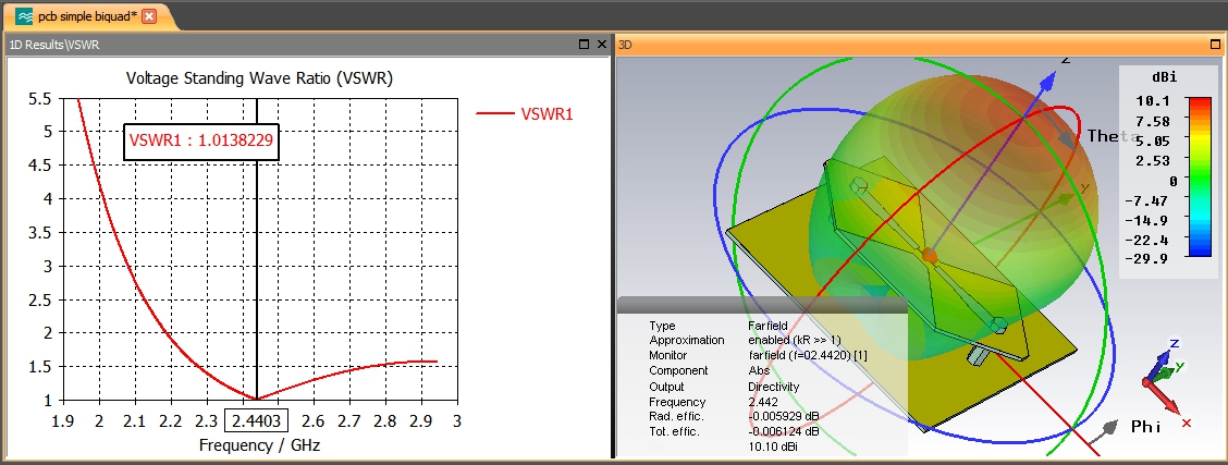

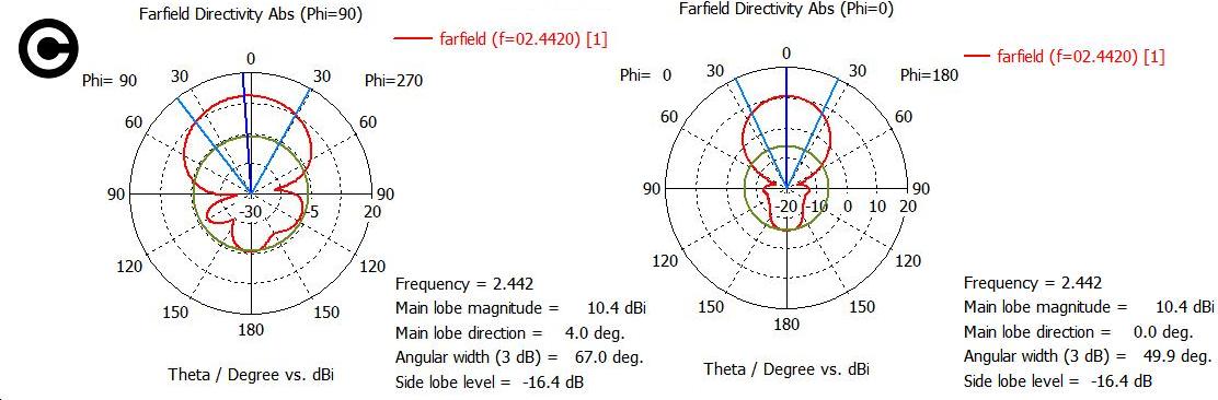

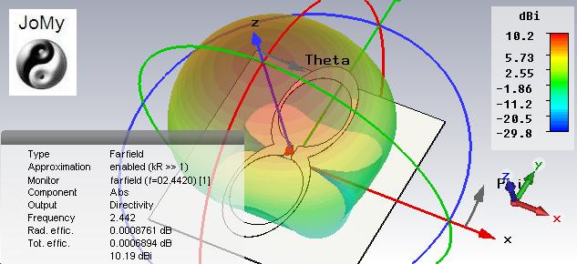

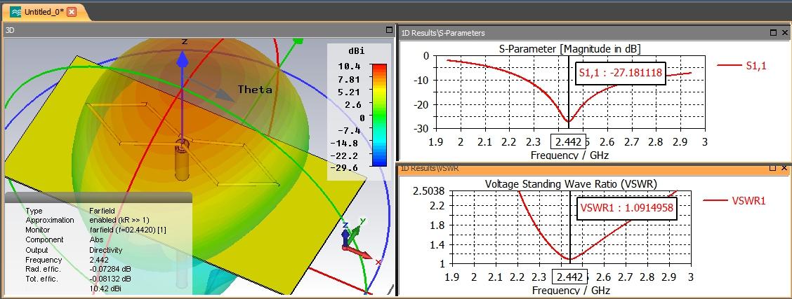

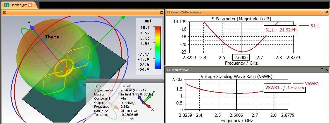

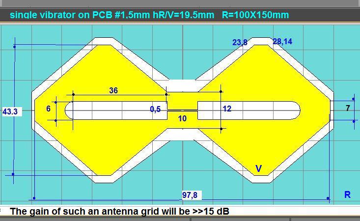

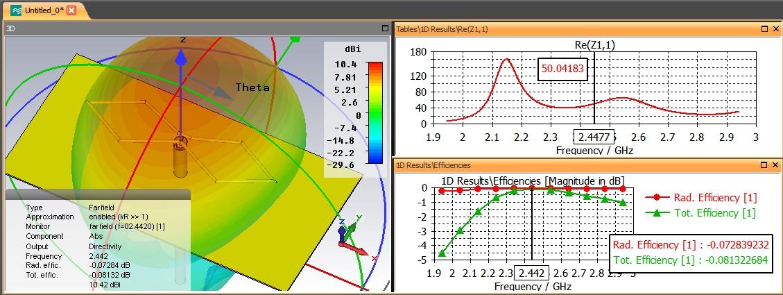

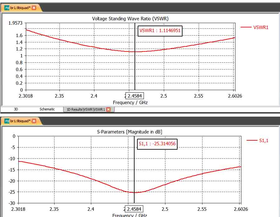

an antenna geometry of ideal biquad...

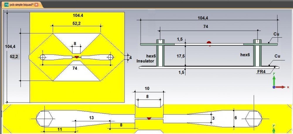

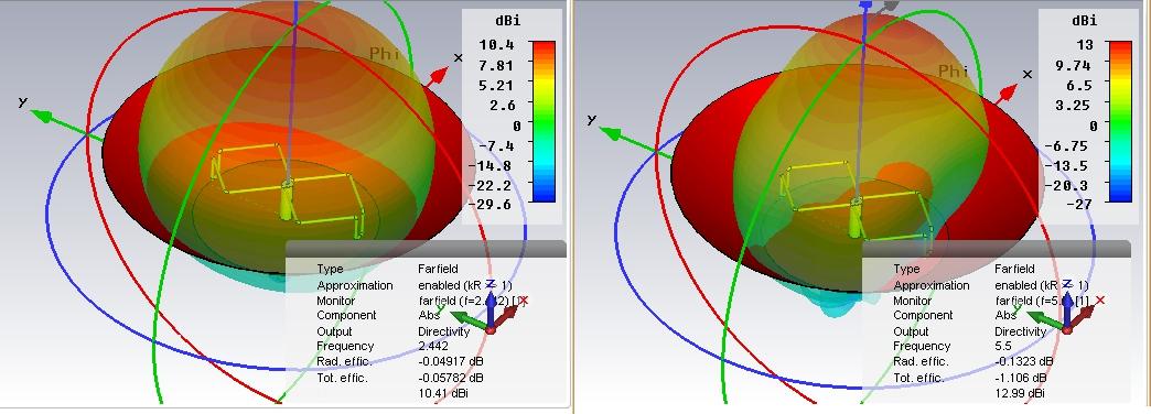

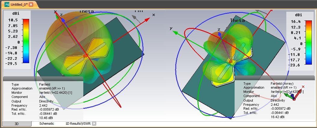

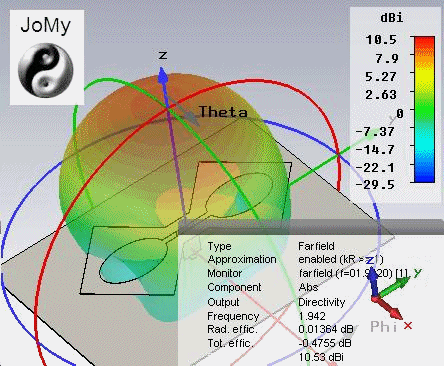

,,,a biquad antenna on PCB(10,5dBi) and panel antenna with 4biquad(16.5dBi)...
The Best ....!!!
Should be tried,,,on PCB,,,
The Best ....!!!
what are you getting 16.4dbi from?

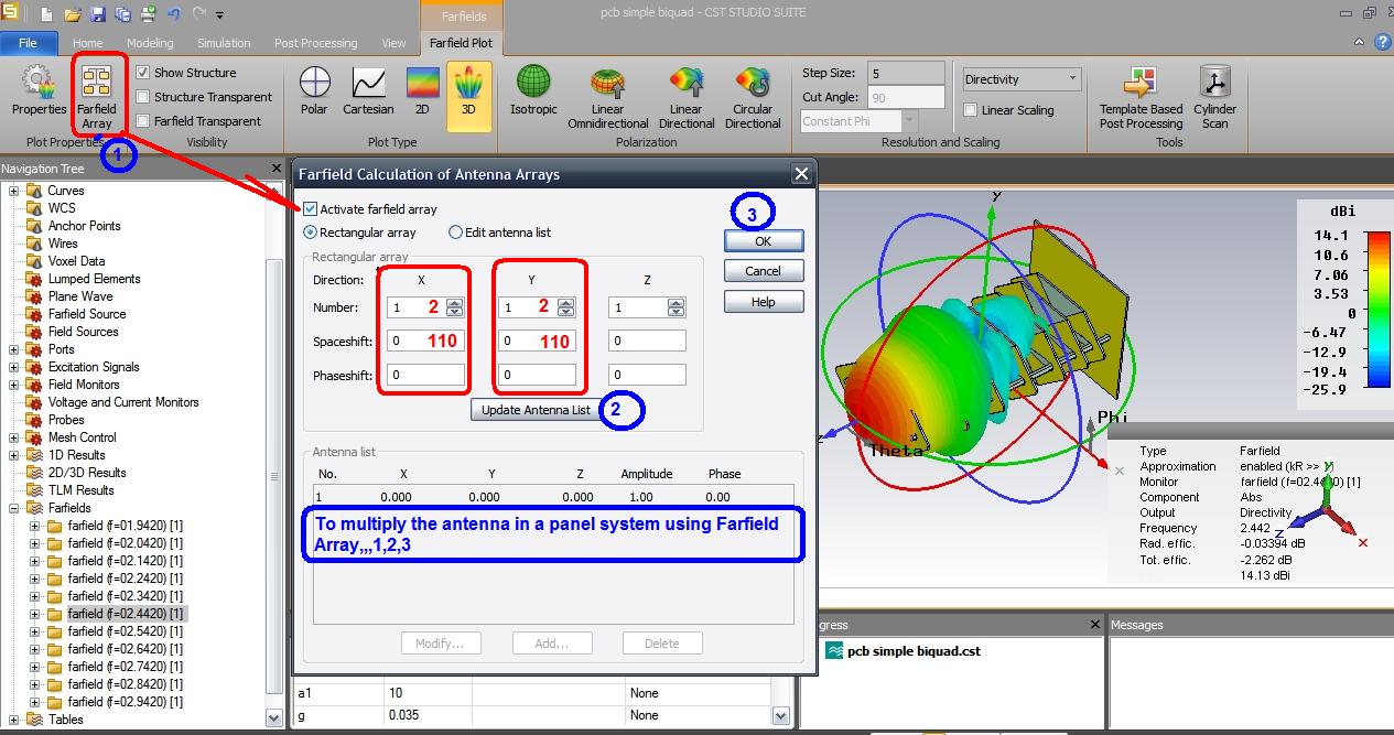

can you post the CST files for this?
Edited by toobefree
How to simulate 2x2 array antenna
Toobefree, you got those dimensions from Antenna Magus ... ??!!!

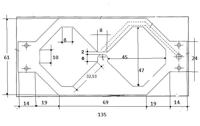

An antenna with 4 panels is quite large.

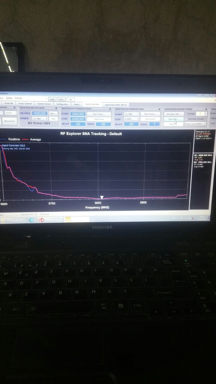

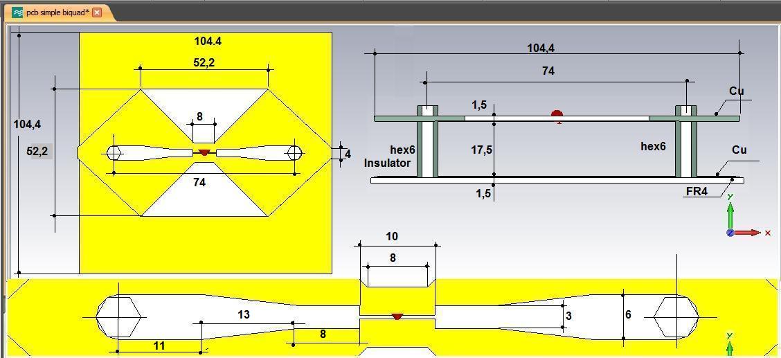

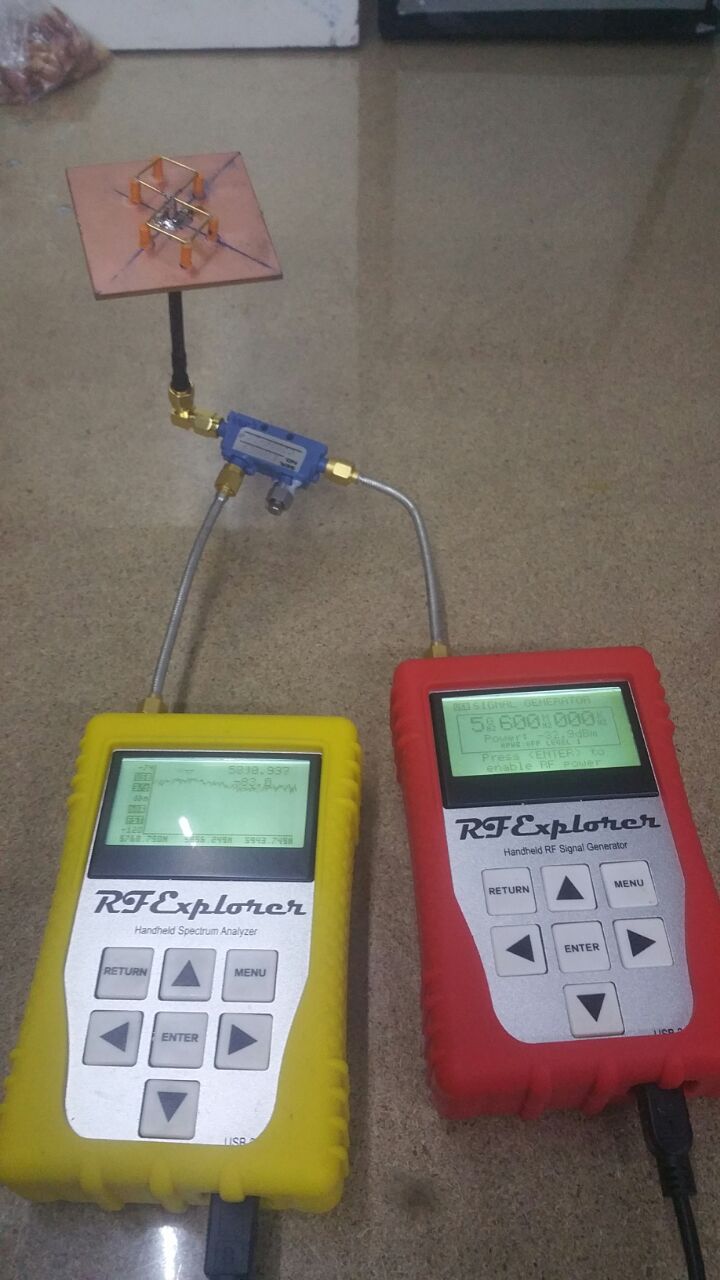

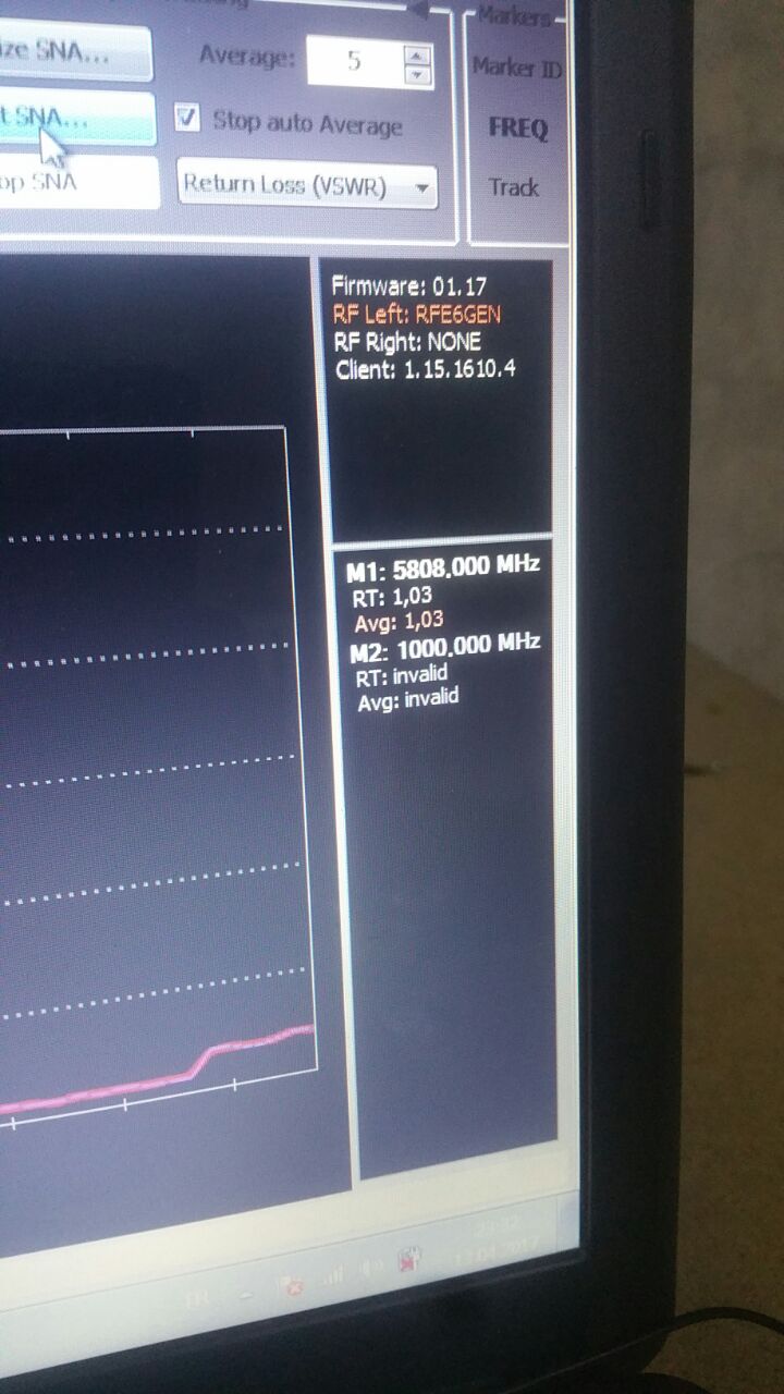

I have built various pcb baklava with theoretical calculations for 5800 MHz.
But I could not catch the right frequency.

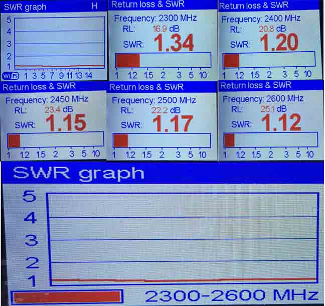

For example, the pcb in this picture was measured as baklava 5560 MHz frekanssta 1.03 vswr
I like your design so much but very much.
This design works.
I use RF Explorer Analyzer to measure antennas.
If the design in this picture works, I would definitely like to build and test it at 5800 MHz frekans

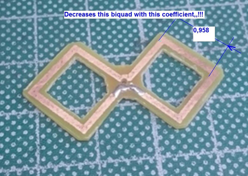

The dielectric coefficient of the PCB must be taken into account
What PCB do you have?
frekans =frequency,,,,???

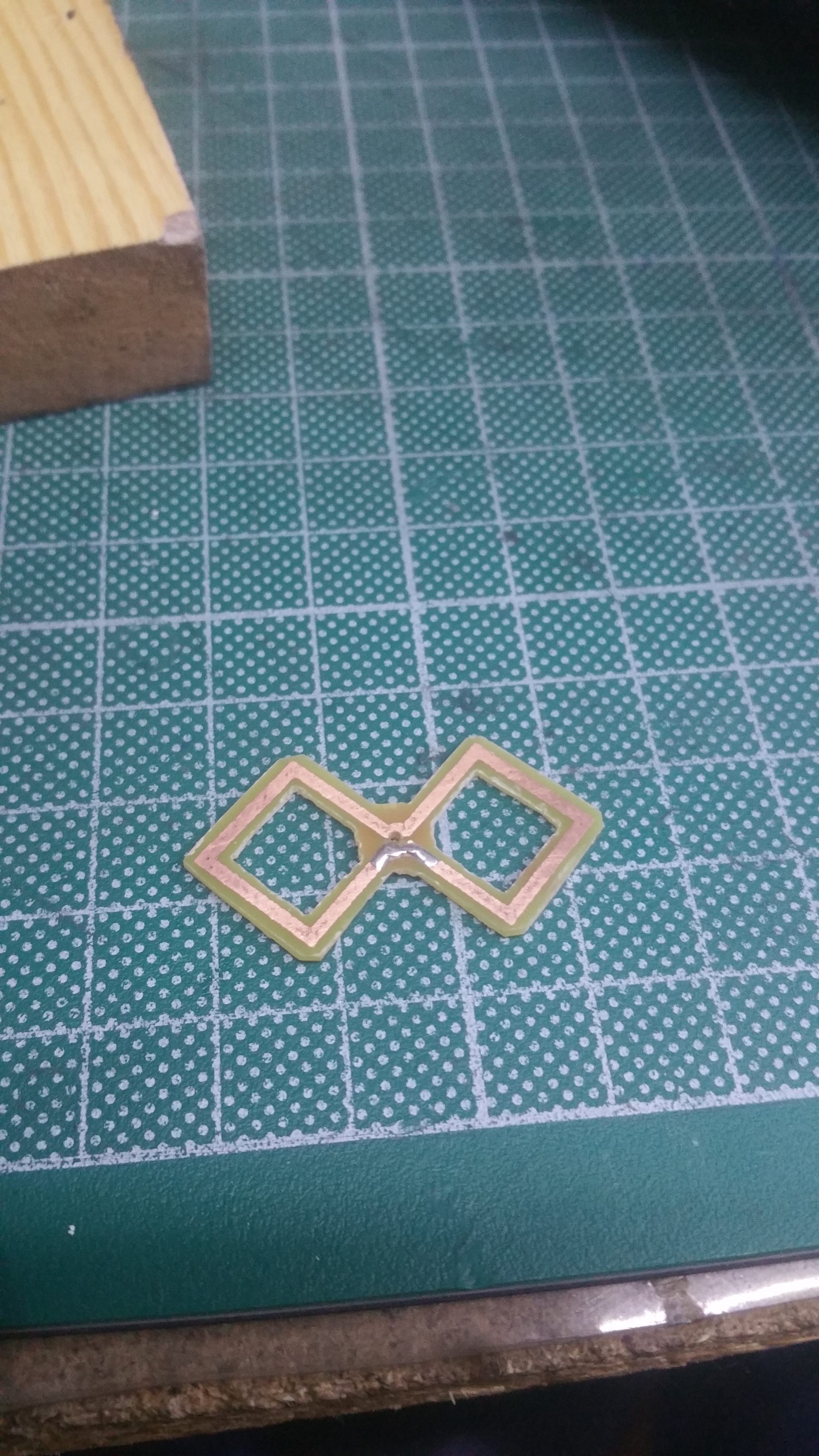

On 6/13/2017 at 9:29 AM, Admin said:
,,, sadece 100x100mm !!!
100x100 mm becomes a very large antenna.
I'm trying to make a bi-quad with 50x50mm panel size.
You can look at the pictures of the sample work I've done.
My handheld antennas were quite successful. But it takes a lot of time. I also have to do more than one experiment to get the right frequency and vswr value.
FR41mm pcb.
Frequency = 5800 MHz
