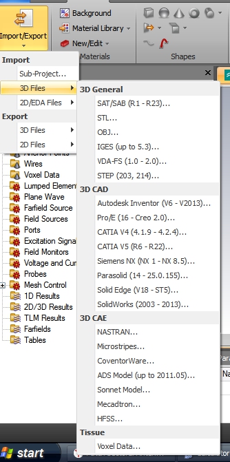

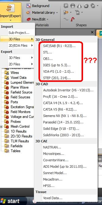

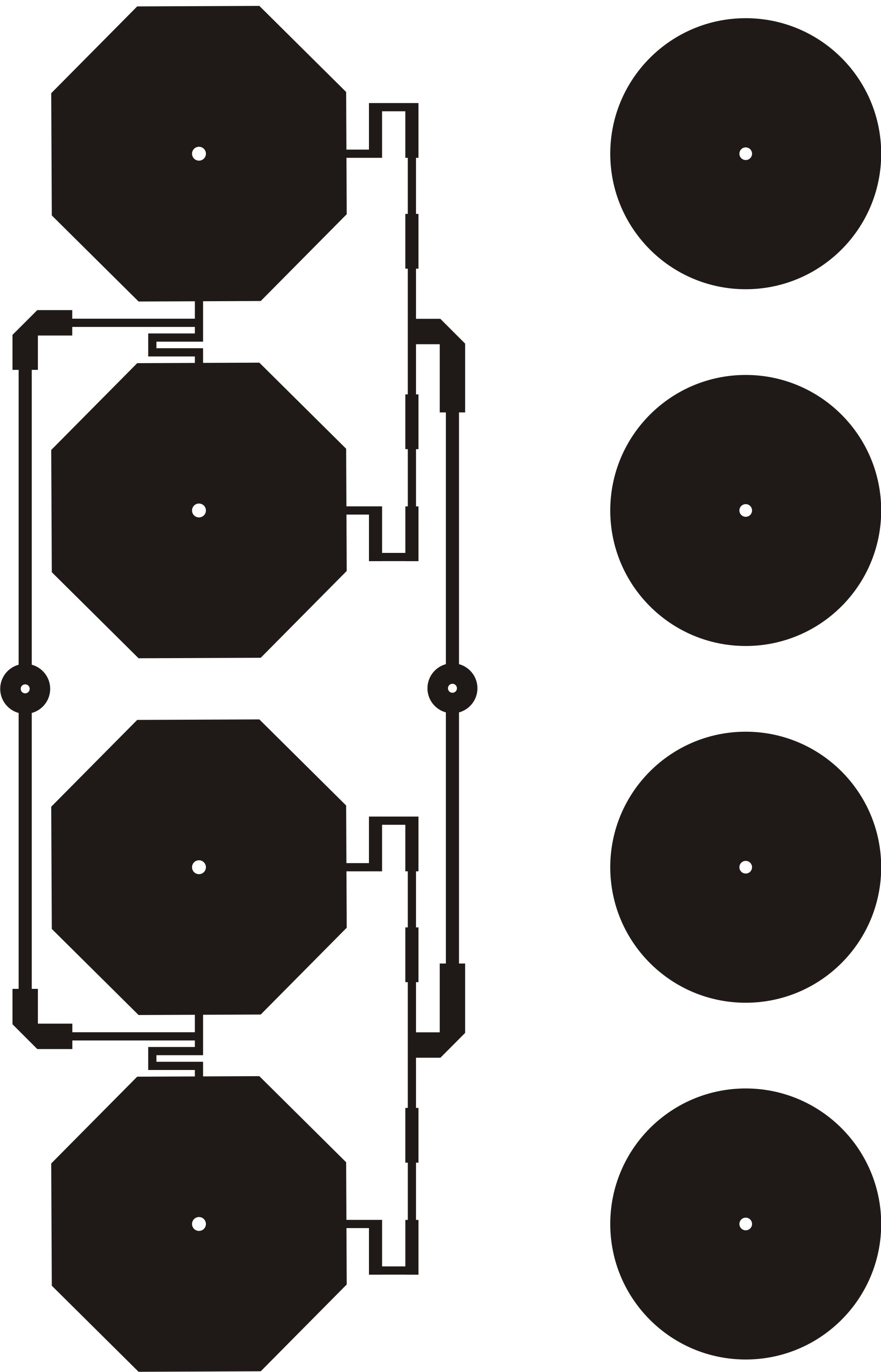

Buddy, I can not open your files, can you send another file format?
,,,these are the files that can be imported...
,,,for measurements try  using Corel Draw X4 Portable

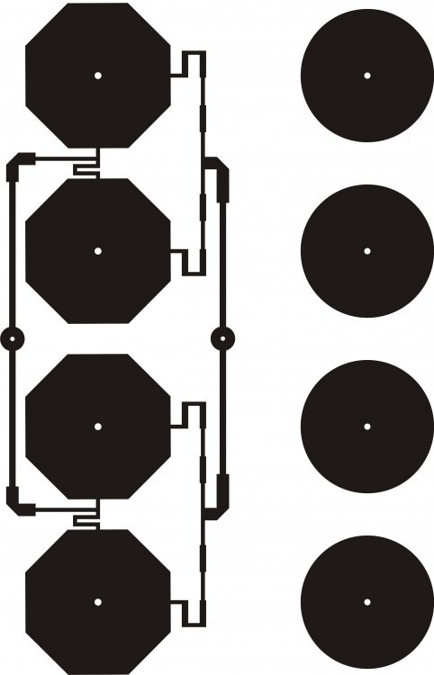

,,,the distance between patches=73mm
Thank You. Linear dimensions are clear from the picture with cells. The patch axis size is not clear. 5-6-7...mm? The material found. Aluminum 0.5 mm. I will cut on the CNC machine. The result will show.

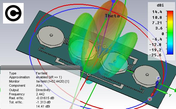

If you do not use PCB substrate, the dimensions are different...!!!
 Homemade product. Box 900mm to 900mm. Screen ArtCAM knowingly shown above.
"if you want, I can make an antenna simulation without using PCB Substrate,in the air and with other dimensions...!!!
"this would adapt to cutting with the CNC Machine...!!!
It's gonna be really good. If IT's not hard. Thank You. On the top photo of the theme is not clear. There's a reflector in there. It's not shown at all. Its size??? I... the distance between the reflector, resonator, and Director. (weird translation of some) I Hope everything is clear. Thank You.
>>>>more than that can"t be...!!!
Thank You. But it's hard to understand the design. (Can we infringe copyright?) There is a reflector, vibrator, Director. What is the distance between them? The size of the reflector what? Antenna interesting for me accuracy a repeat of. This will allow my CNC. You can just hand cut out of aluminium, but the accuracy will be less. Thanks again.
hRV=5mm,hVD=5mm ,R=1x130x320mm

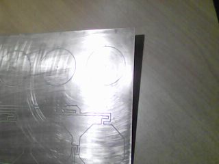

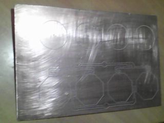

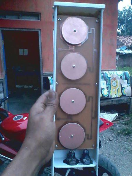

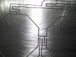

Small report. With 0.5 mm aluminum it is a problem to cut by mill. Take 1mm or double-sided tape to attach to the plane. Was reserval foil glass fiber. It worked out. Some photos.
,,,the same as in the original...!!!1
