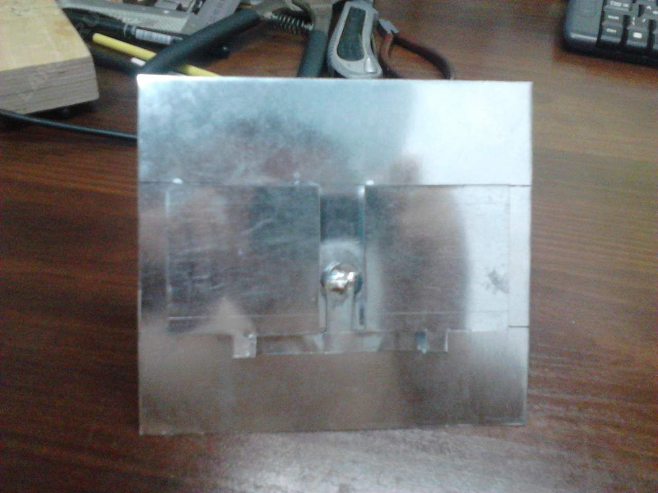

No, I will try to make for you such an antenna in the air of copper wire and galvanized sheet.
I think using PCB, can lead to a worsening of the antenna performance...!!!
That's what it looks like...

2 hours ago, pragata.my.id said:
use copper wire?
,,,yes...!!!
Cu Wire 1,5mm diameter

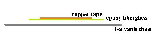

which better with this one..
,,,,one is one, another is another ...!!!!
"yes it can ... !!!
,,,but the dielectric characteristic of the  epoxy figerglass is to be known...!!!
as i known epoxy fiber glass same with FR4 material but without copper
or maybe epoxy fiberglass changed with PTFE sheet, but problem is can not stiff and not cheap
and why i am using cooper tape, because i can cutting it into small line with paper cutter
