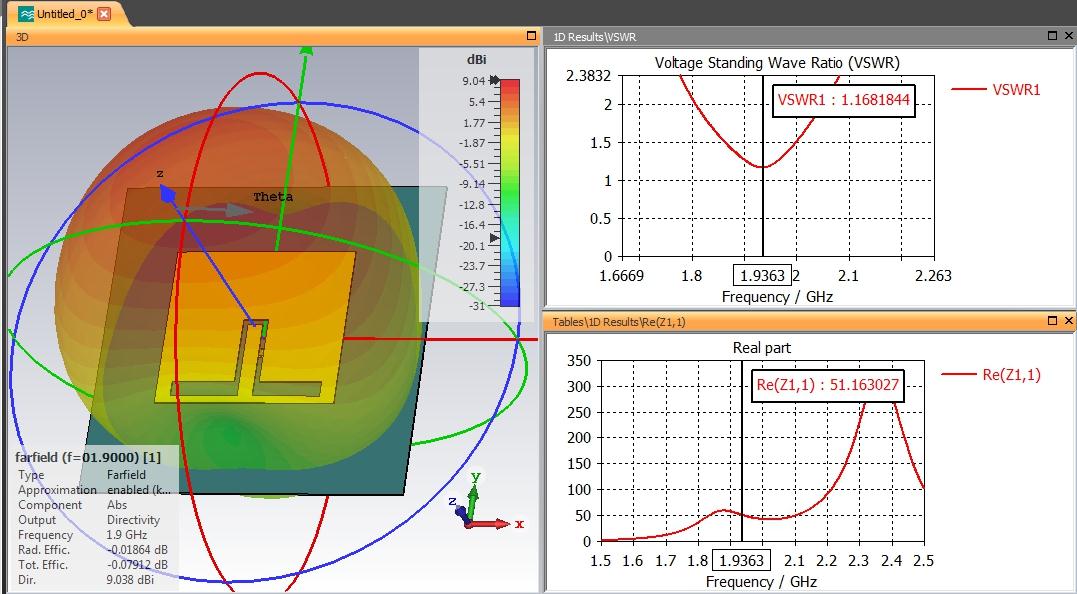

Thank you so much sir.

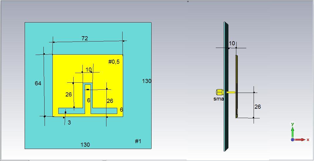

On 7/17/2025 at 6:56 PM, clanon said:
