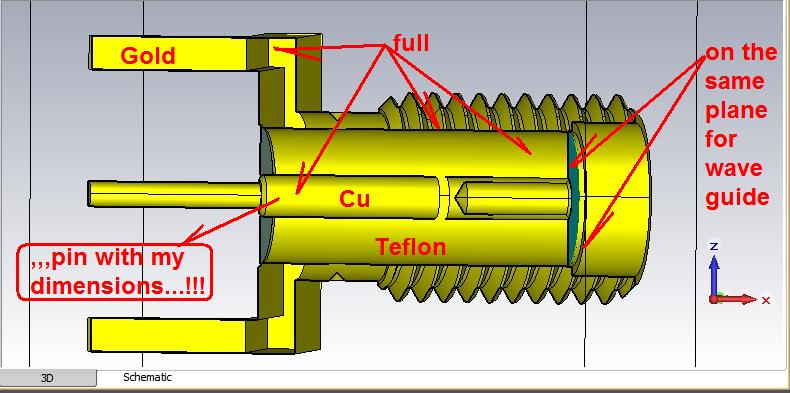

Jomy can you do me a favour. can you design an SMA connector in hfss that can be used for any antenna?
,,,for microstrip planar antenna...??  with 1.5mm  PCB thickness...??
yes. for 1.6mm board thickness

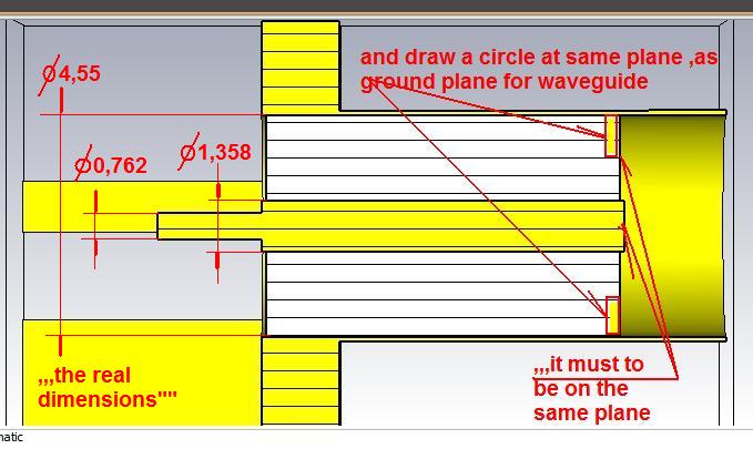

Good my friend, but you made this socket is very good, only be filled walls and is respected dimensions of pin that which I gave them.
also be made in the same plane waveguide port...
give me only gold threaded body without Teflon
jomy i have that file with me... i  need the sma connector u have designed in either CST or HFSS
Ok, but not now, I gotta go...!!!!

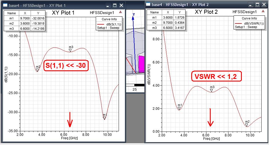

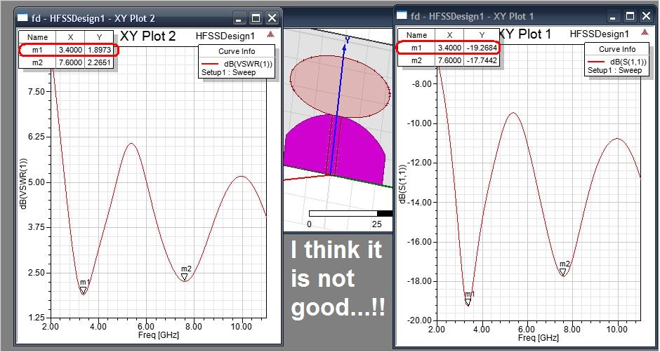

We got return loss below -10db in almost entire band... I think a small band is not useful. We can obtain by changing port dimension and airbox

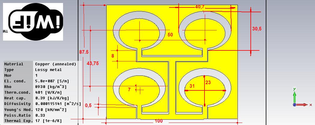

,,,you can try, but me I would be interested array antenna ////
Ok... Can you post a simple array antenna structure . I will try.
