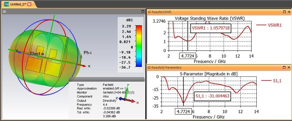

 And they may be lines for adjusting the impedance to four patches..
I will design array antenna today itself. thank ypu for the files

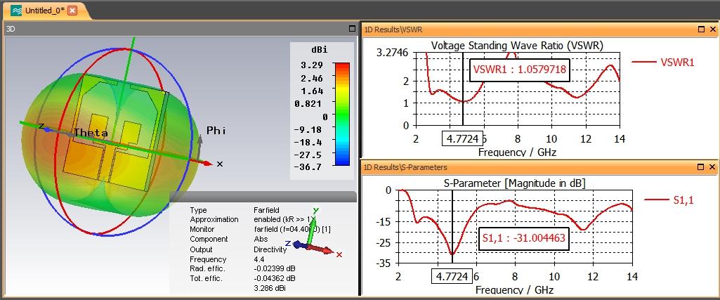

HI jomy, This is array antenna i have modelled i tried a lot to obtain the results but couldnot get it. please have a look at it.

HFSS,,, go hard, try to double the thickness of the PCB

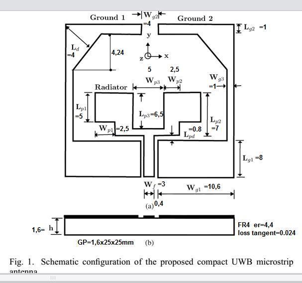

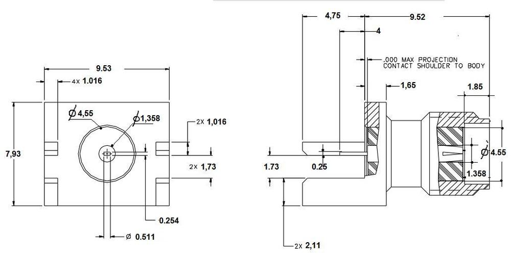

san, I believe this drawing is quite good for a port sma...

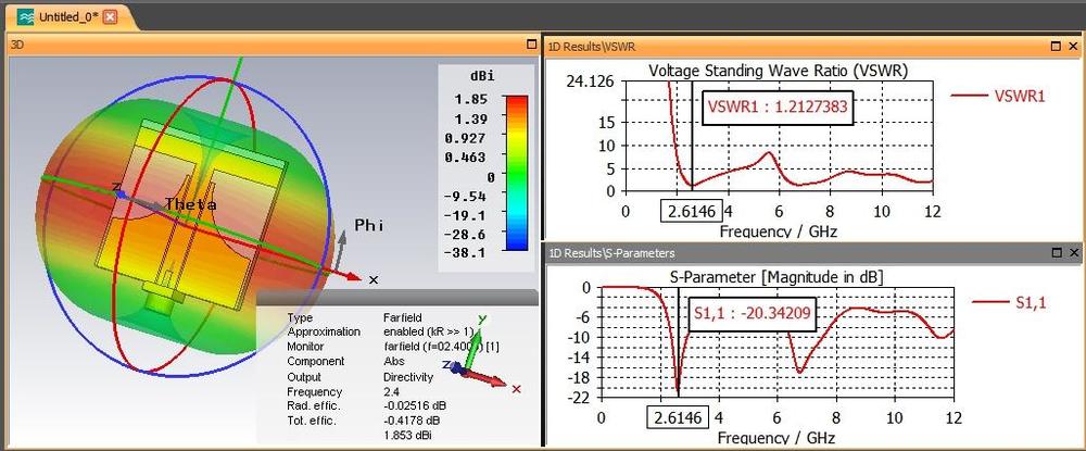

Hello, Last time u attached a SMA connector for me. i used that connector to excite the antenna in HFSS ..please give comments on that.

,,, san, please post a * cst,,file...!!!!

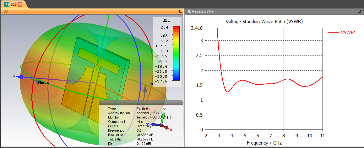

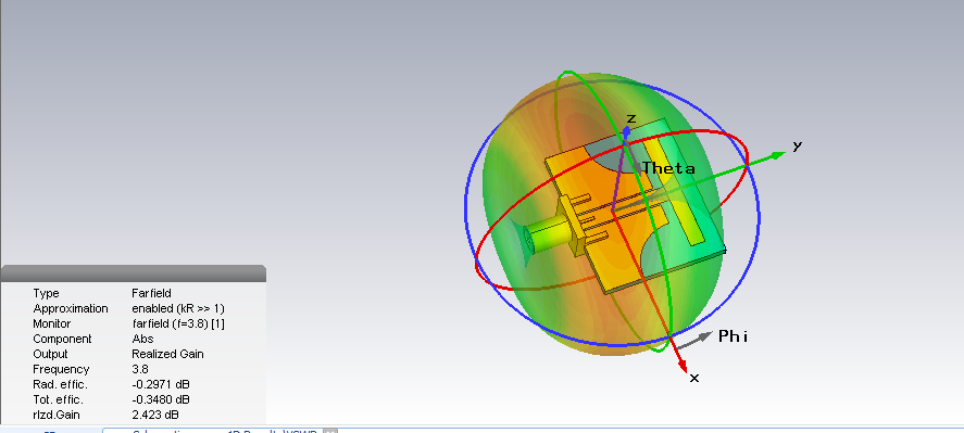

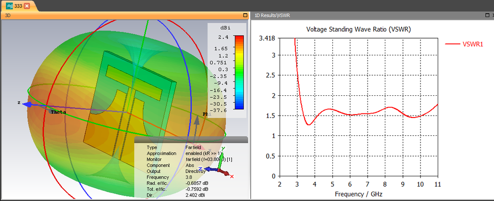

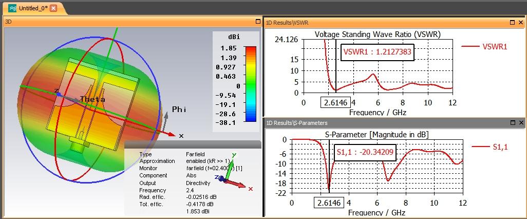

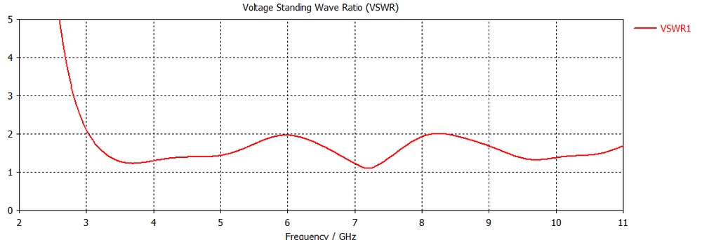

please check the below file, i have designed the sma connector based on the above dimensions
333.cst

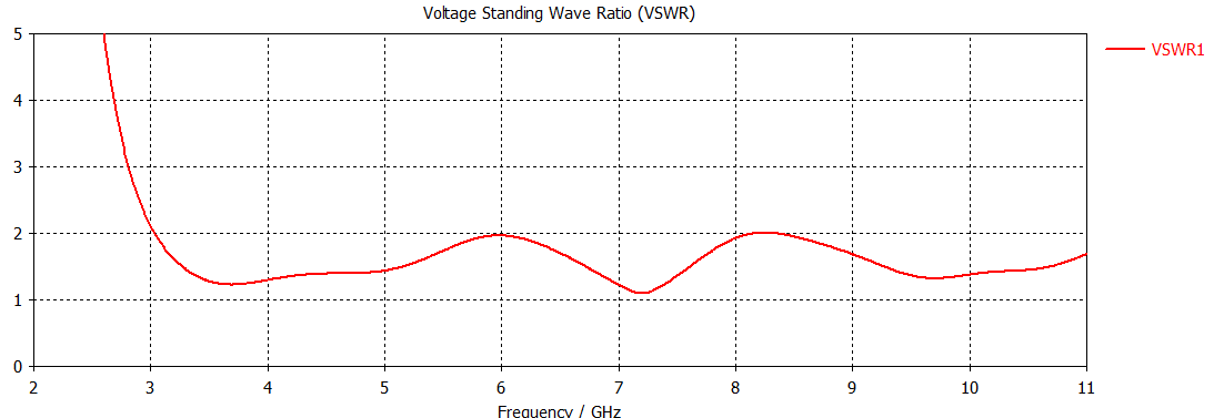

,,, looks pretty good this antenna...!!!
,,,but sma port have not worked on it...!!!
,,,at 6GHz and 8,2GHZ it is not good VSWR ...!!1

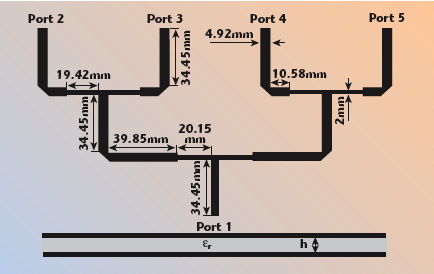

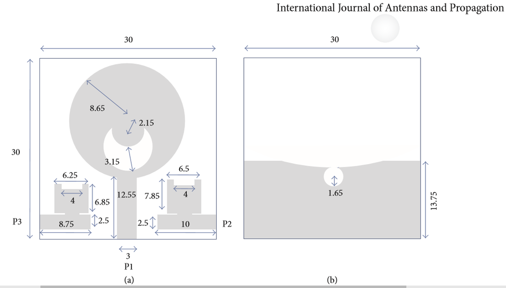

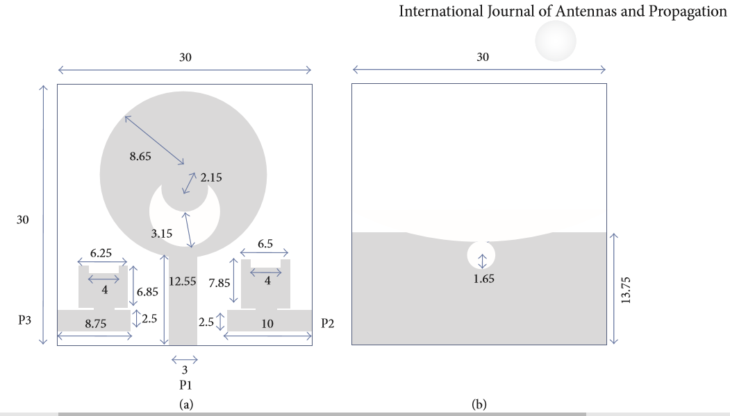

jomy could you implement the below cognitive radio antenna
2829357 (2).pdf
,,,ok,I will try it...!!!
and with 3 sma ports...???
thank you jomy.... can u guide to design the same antenna in hfss. i have problem in making  one  antenna as receiver antenna and other as transmitter antenna.
