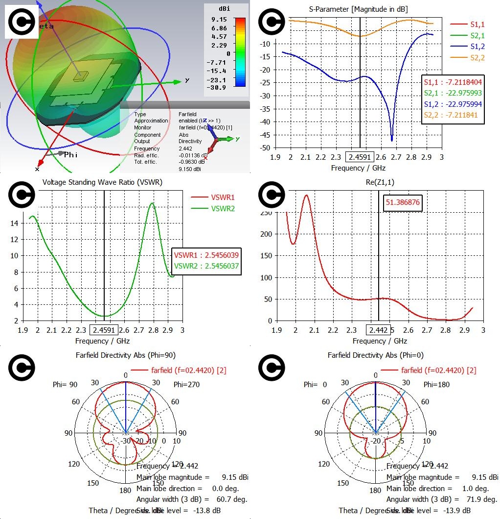

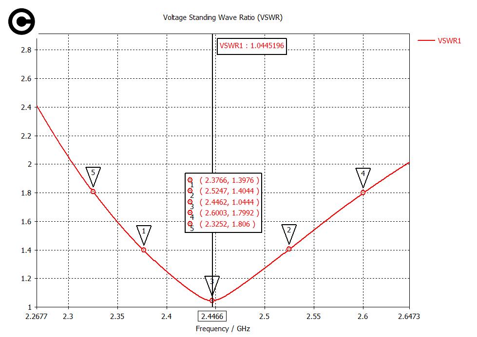

the design is definitely bad.
3 hours ago, Admin said:
Edited by pragata.my.id

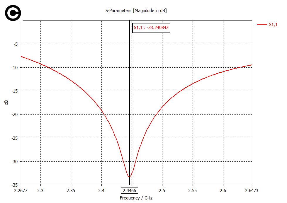

,,,yes, the VSWR it"s bad...!!!!
,,, but isolation between ports and impedances is good !!! !!!
do you think it is worth using or not?

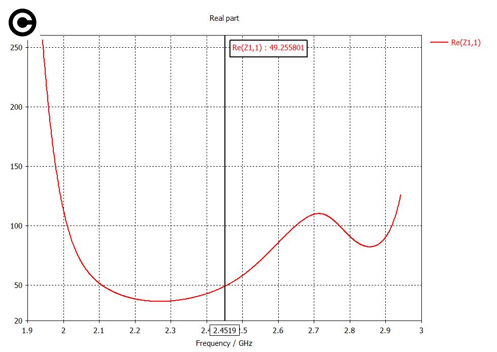

the antenna geometry must be chosen with vswr <1.5
what do you say it is ...?

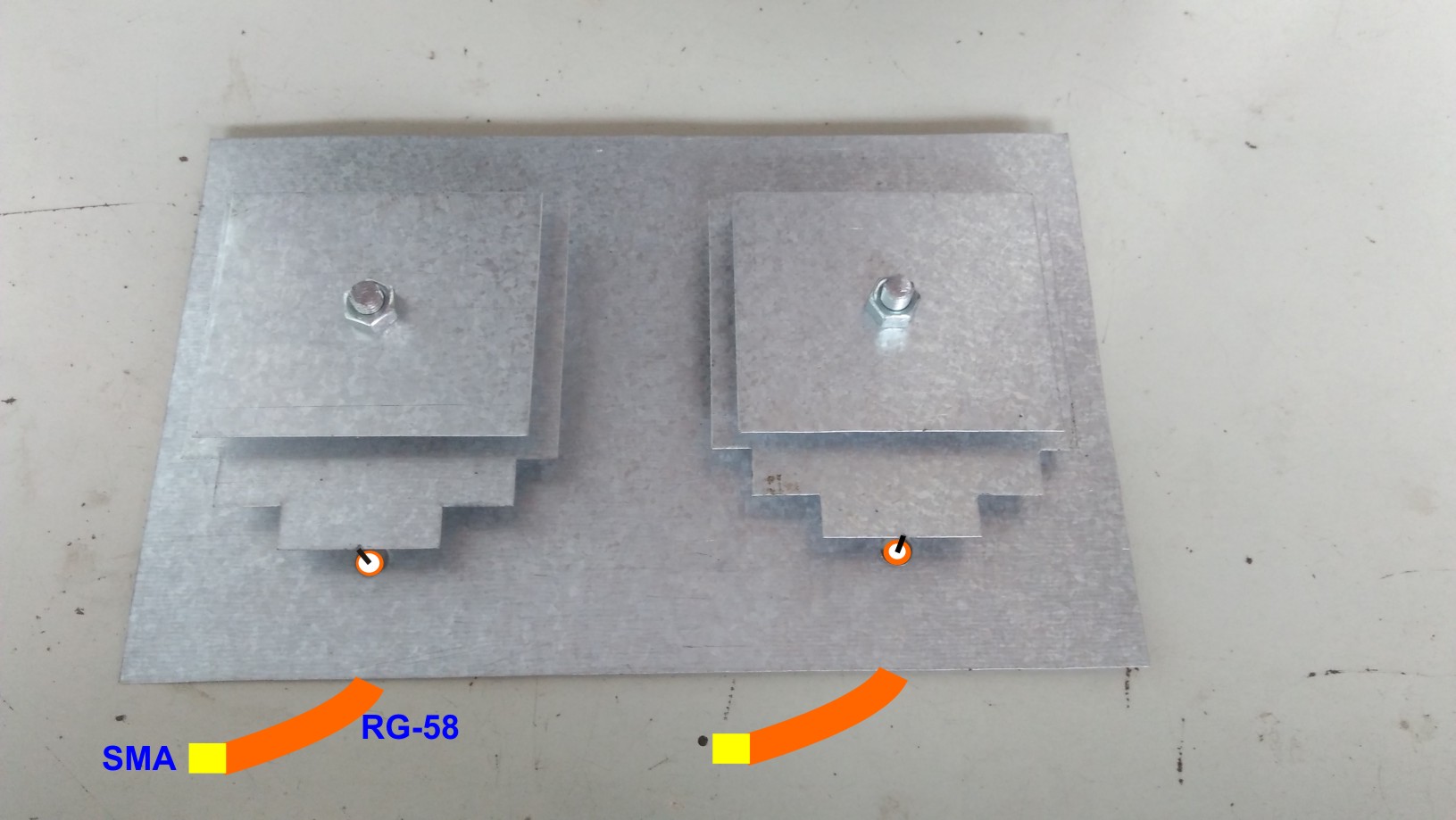

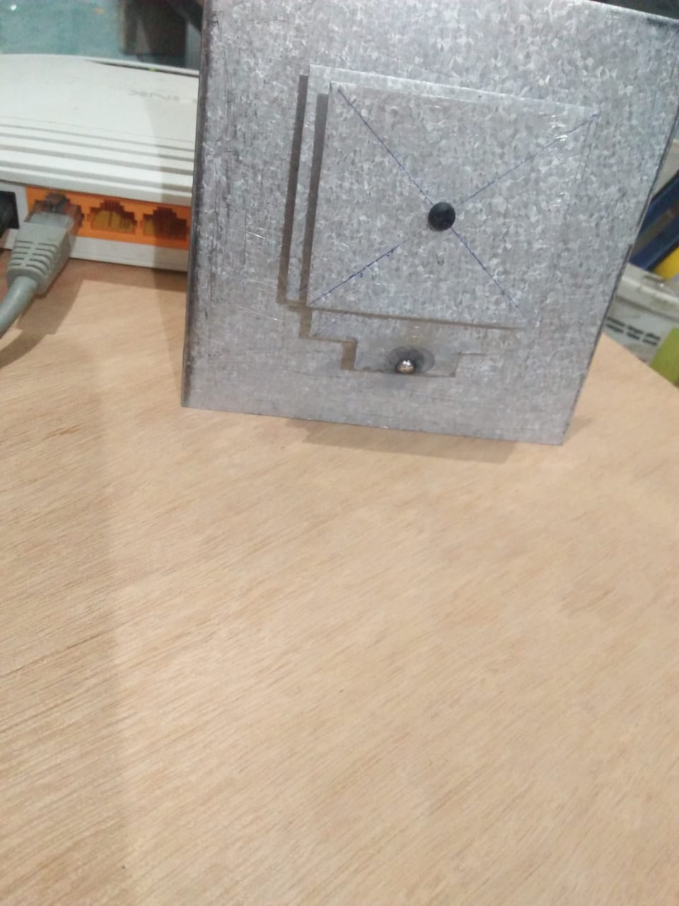

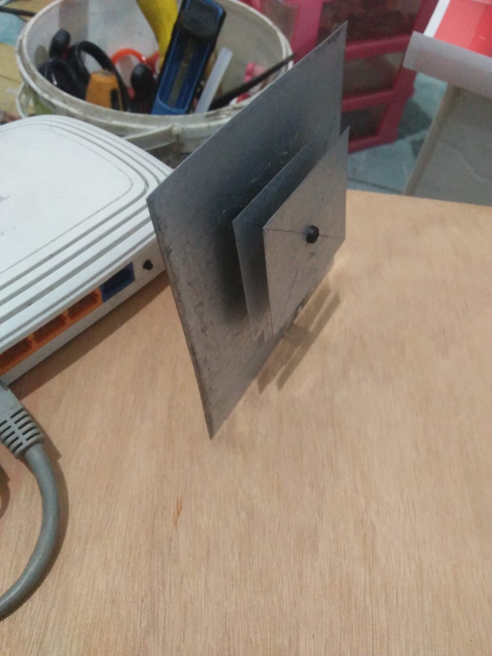

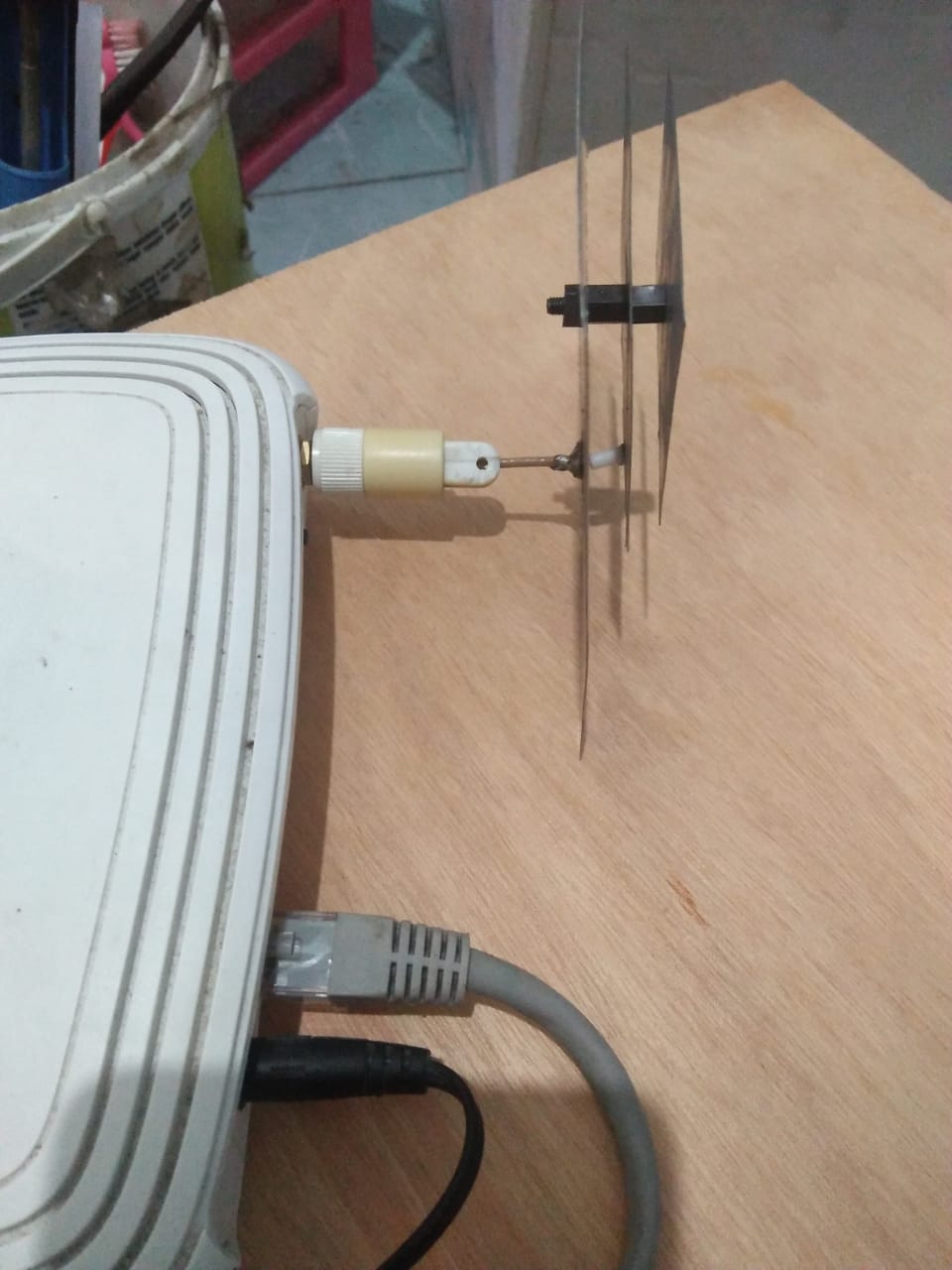

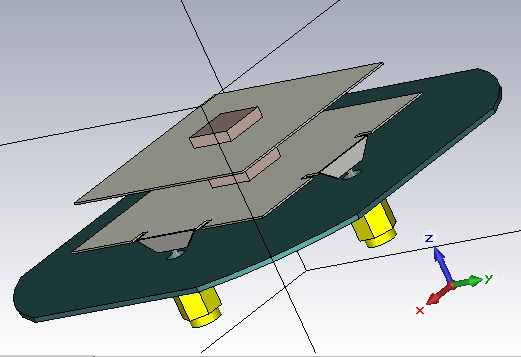

This patch antenna are cheap in cost, having low profile, and easy to fabricate. Patch antenna have three parts−patch, director and ground.for which it covers the entire frequency range for 2.4GHz
good,,, is very good.. how about beamwidth for this antenna

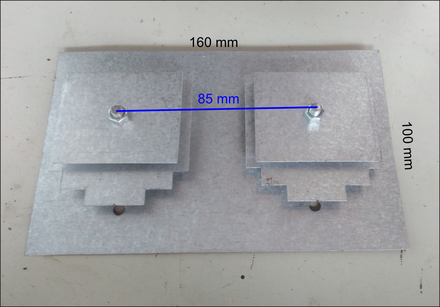

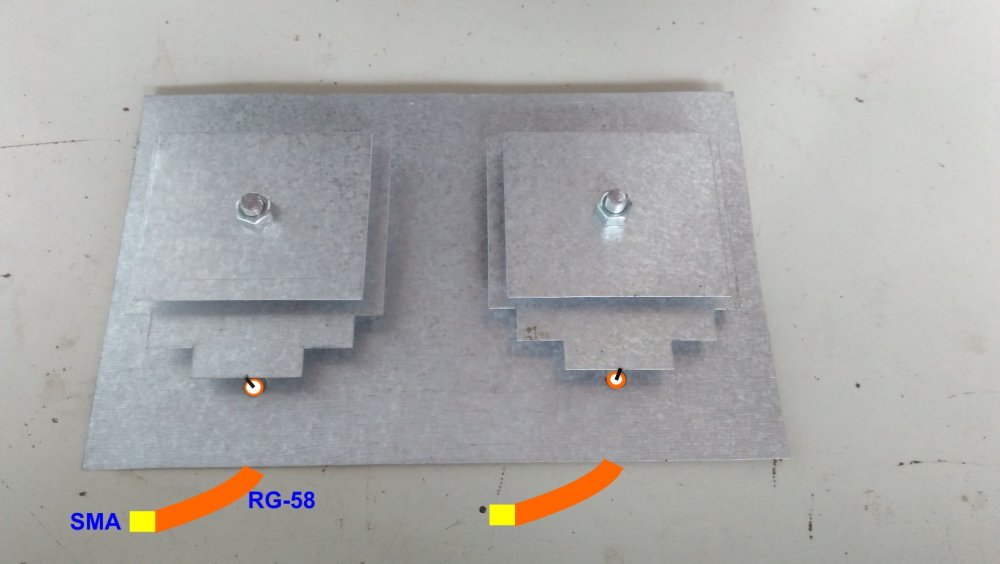

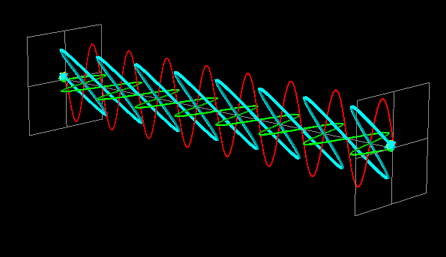

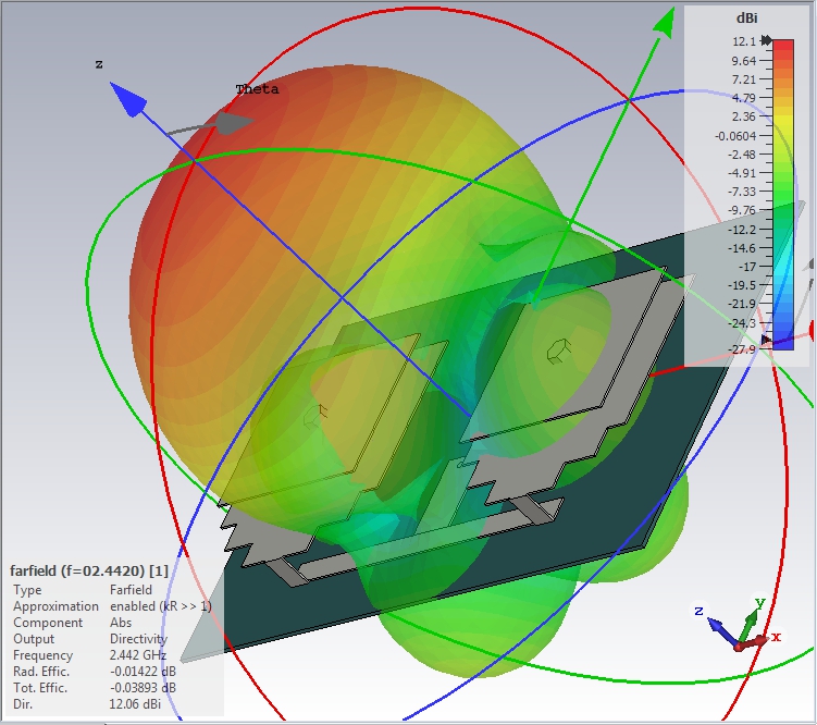

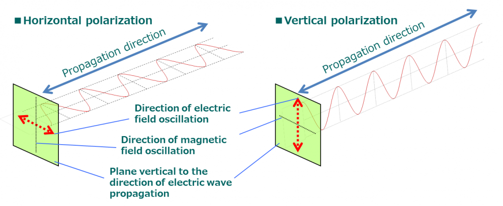

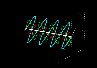

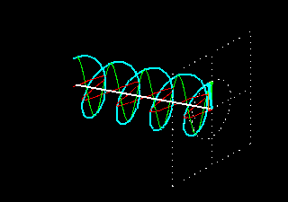

 xDxD no, i mean beamwidth degree and what polarization for this antenna
i change plastic bolt with metal bolt, it can increase the signal, good...
,,,horizontal polarization...!!!
,,,it's good that you changed the insulating spacers...!!!

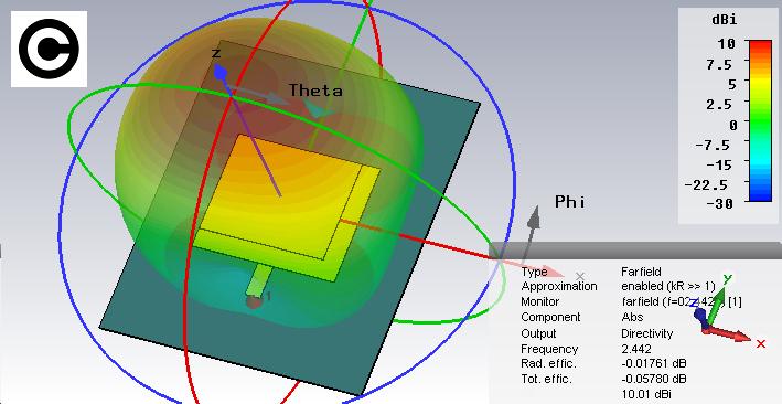

,,,I will soon present beamwidth degree...!!!

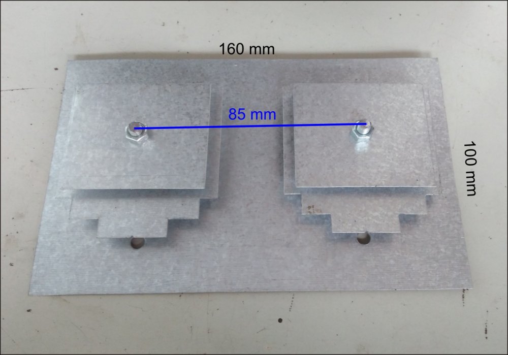

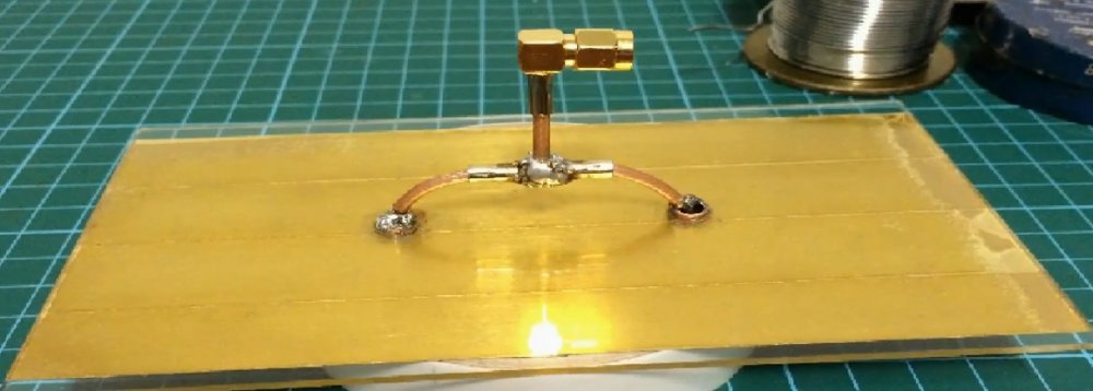

with 2 patch??... it is possible??
Edited by bejonet

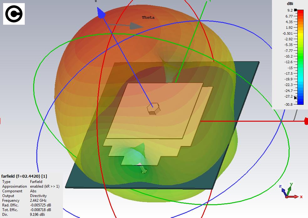

"Yes, it can, but a simulation needs to be done .with an impedance adjustment line..!!!

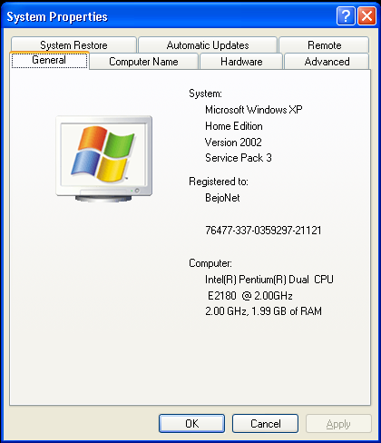

ok,, waiting for simulation please,,,, i can not do it because not have in my old computer and not know how to working with simulation program,,
,,,what kind of computer do you have...???
,,,if you want I can teach you how to work with the antenna simulation program...!!!
yes,, i want to learn how to work with antenna simulation program, please,,,
but this is my computer...
"Yes, the computer is pretty good ... !!!
"why do not you try to look at this forum about the CST program...!!!
,,, something like that ... !?
Yes, only if you can do this...
