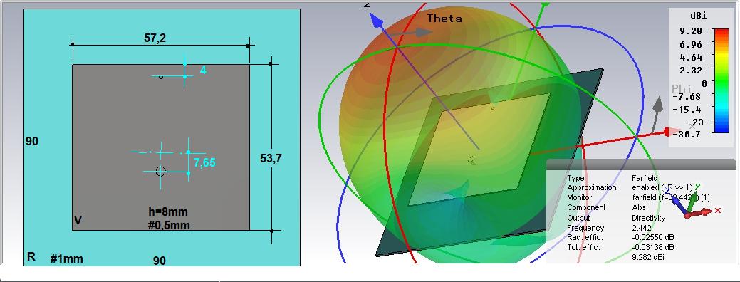

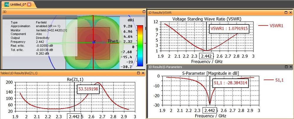

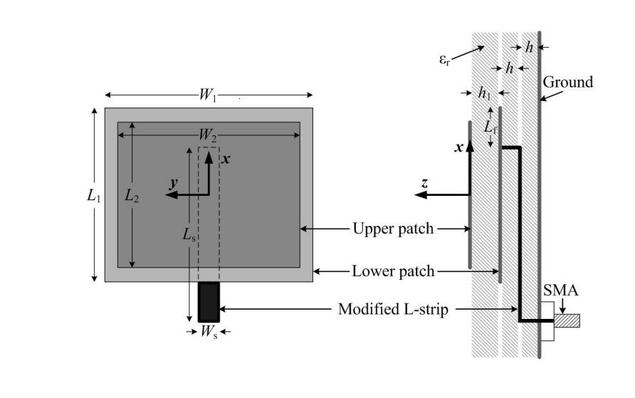

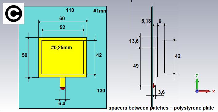

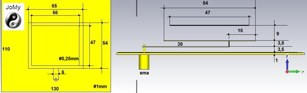

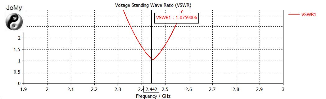

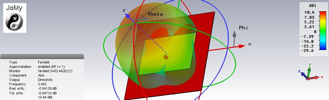

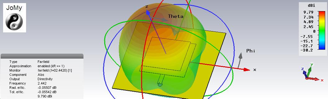

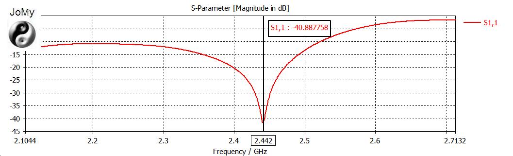

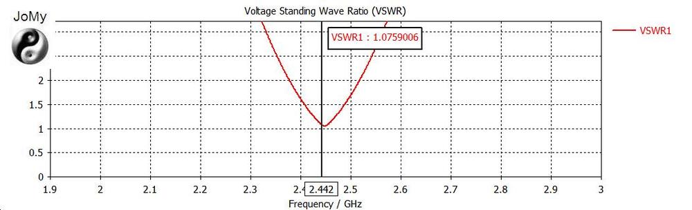

This is the theoretical constructive patch antenna broadband...

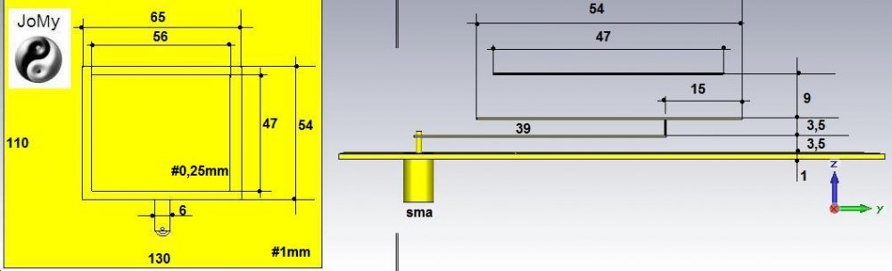

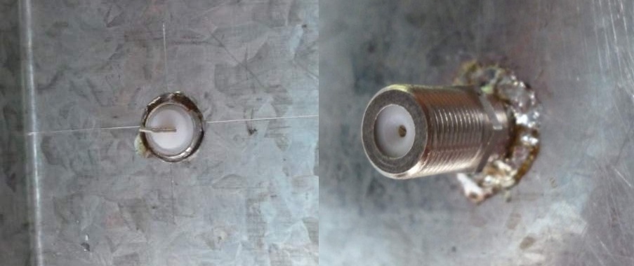

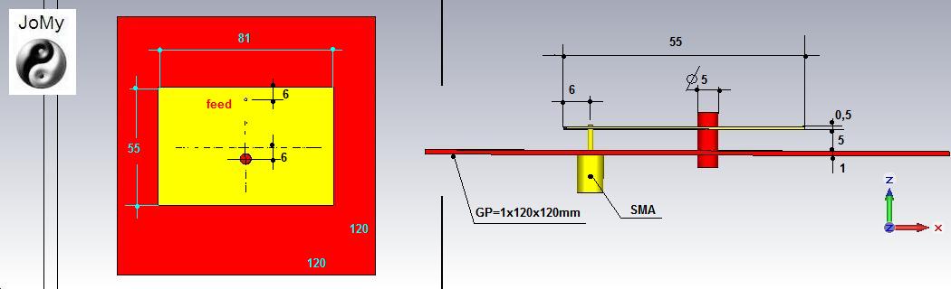

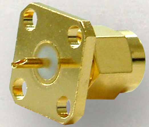

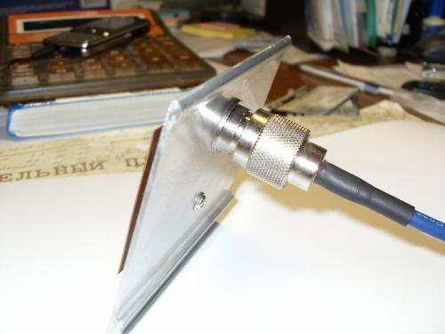

This is the SMA Conector for patch antenna broadband...

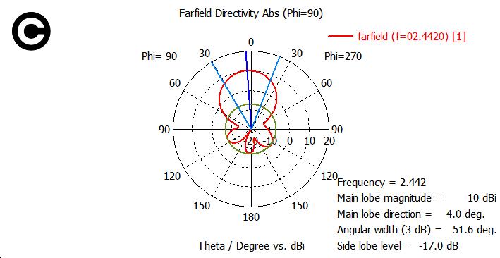

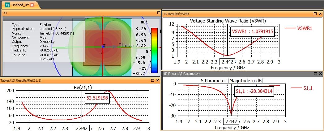

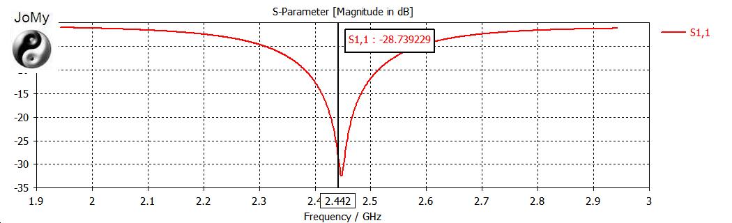

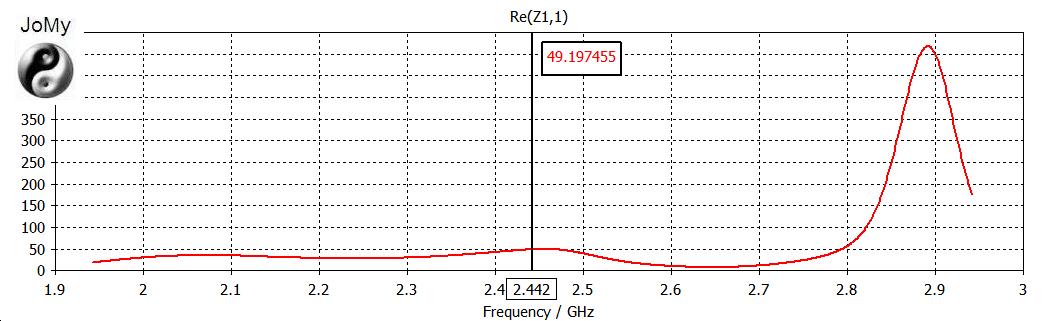

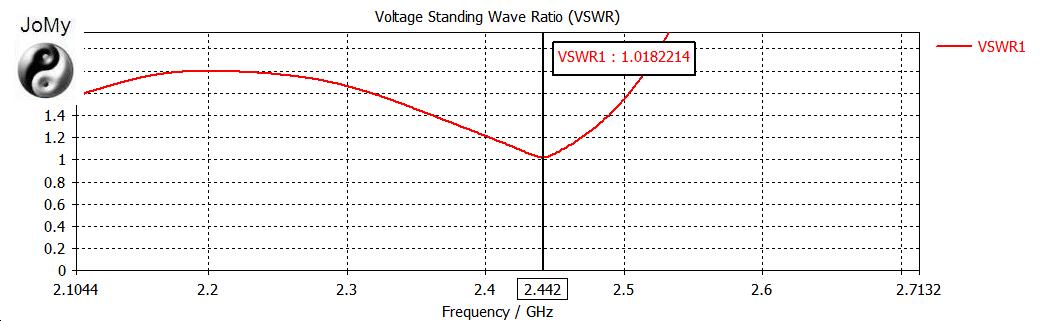

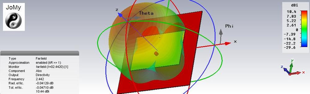

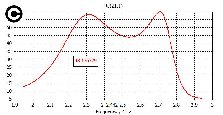

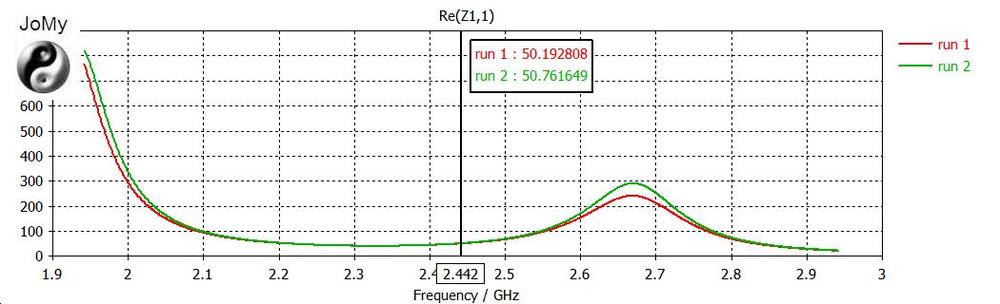

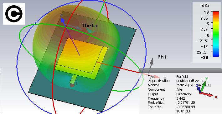

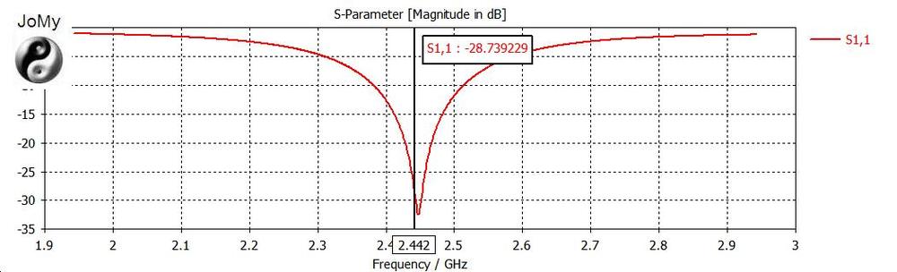

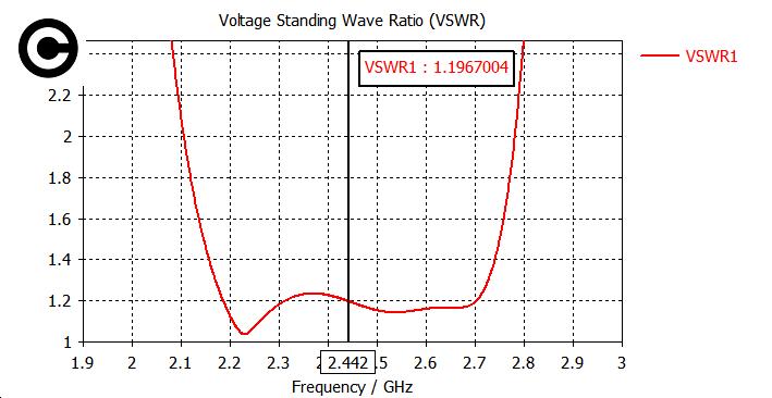

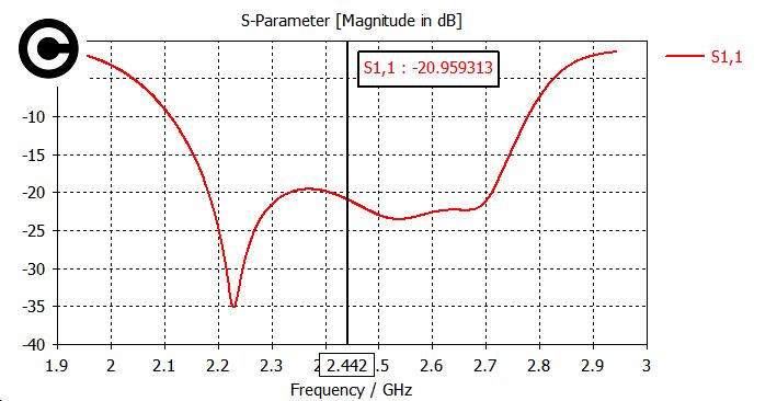

Optimization to increase frequency band...

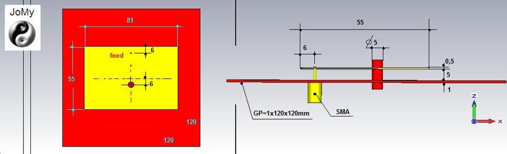

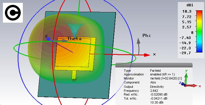

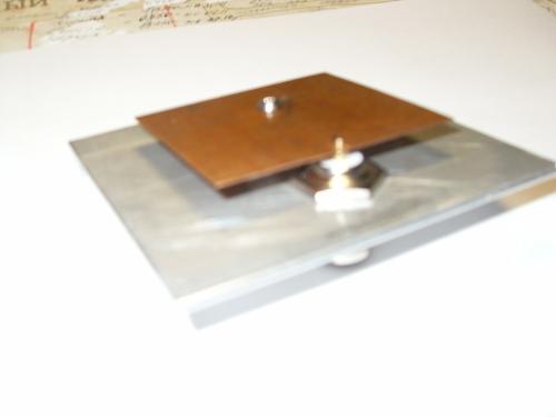

another simple patch antenna for offset dish;\\\\
,,,and another dimension of that simple patch...

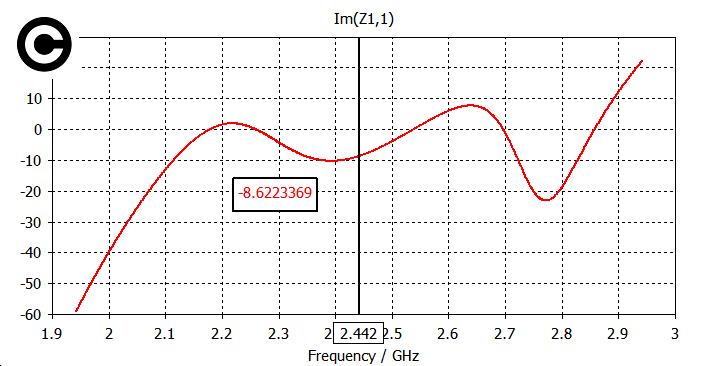

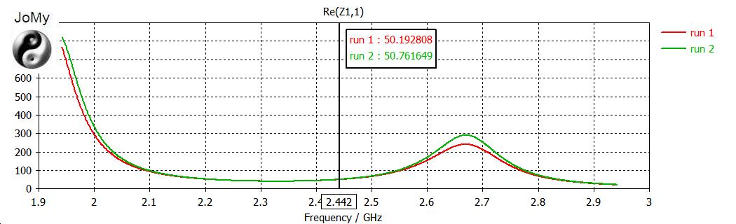

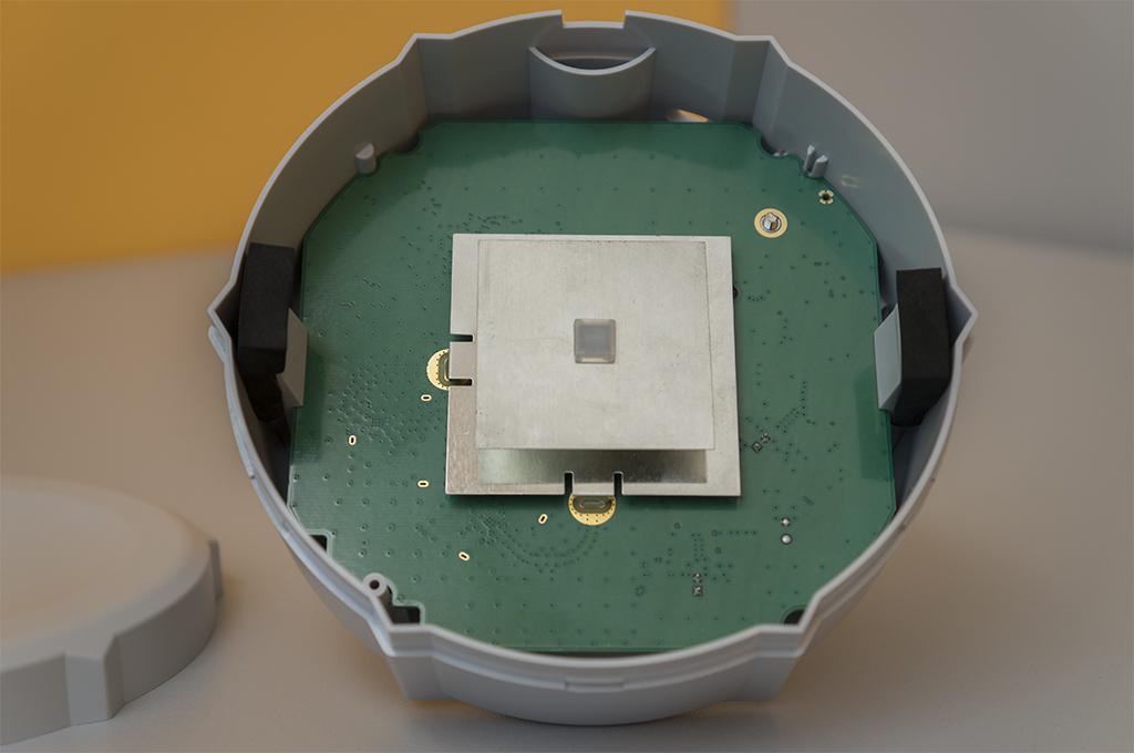

what can i use for sxt 2?
,,,as I understand that you want the MiMo antenna...??
yes brother..
may be modified to a mimo antenna, just like a sxt2 antenna
ok, I will try, but tell me the diameter at sxt2,,,??
that's what I'm looking for ...
how many P x L patch antenna sxt 2 ?

yes brother, i used your antena for siso
but i am looking for mimo model :)
Buddy, if you wait a little, I'll fix this too...!!!
But why do not you put two such antennas at 90 degrees,,,====>>>>MiMo Antenna
I also usually like that, but mimo sxt2 antenna looks more simple and efficient
