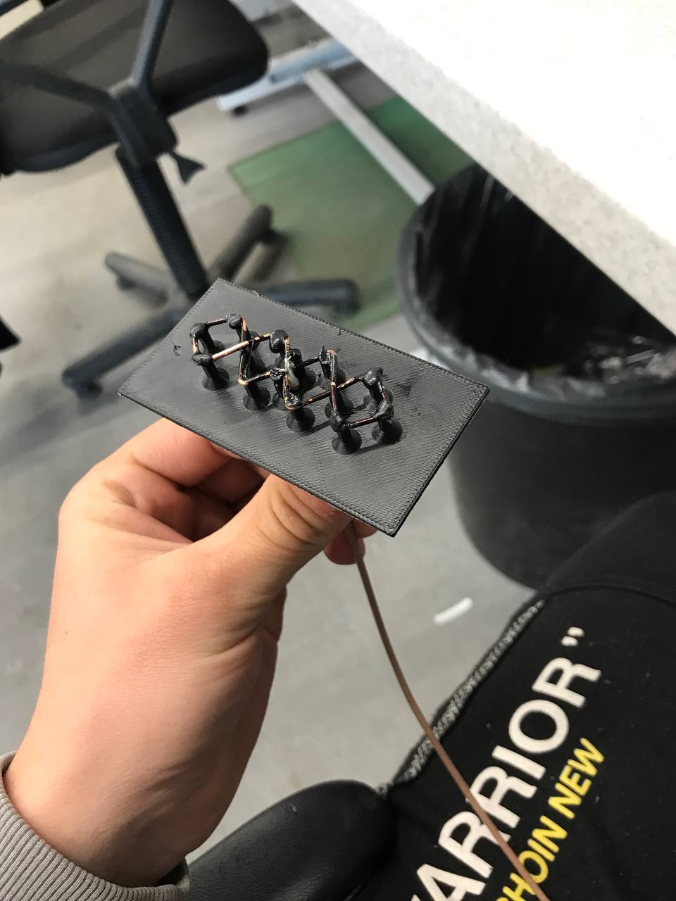

I made this anthenna and want to make it in PCB.
Forget about PCB, it's not good...!!!
Why? Because it is difficult to make it from a printed circuit board?
,,,no,PCB has poor results...!!!

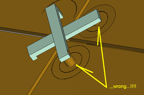

It's not good, what do you want to do..?

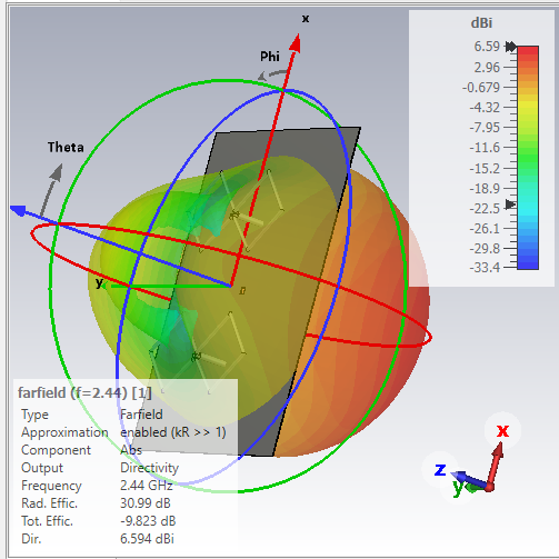

Two ports for a TP-Link MR-100 router outdoor antenna, it has 2 sma antennas, and I want to replace them for better signal gain, as the router cannot fitted outside, because need protection from rain.
I made a biquad in antenna-magus, exported to CST, and then doubled the elements making also a larger reflector.
Edited by papagayor
6 hours ago, papagayor said:
Dual Port Biquad, correct and suggestions please
Biquad.cst

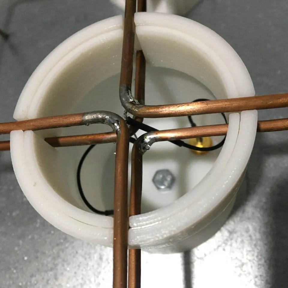

it is better to make 2 separated biquad antennas with individual reflector each
they gonna work better
and with 2 separate you can experiment with -45 +45 polarization etc
I think this construction is better..!!!
For this construction and calculating dimensions for 2.44Ghz biquad, should the 2 sma's be isolated mount on reflector?

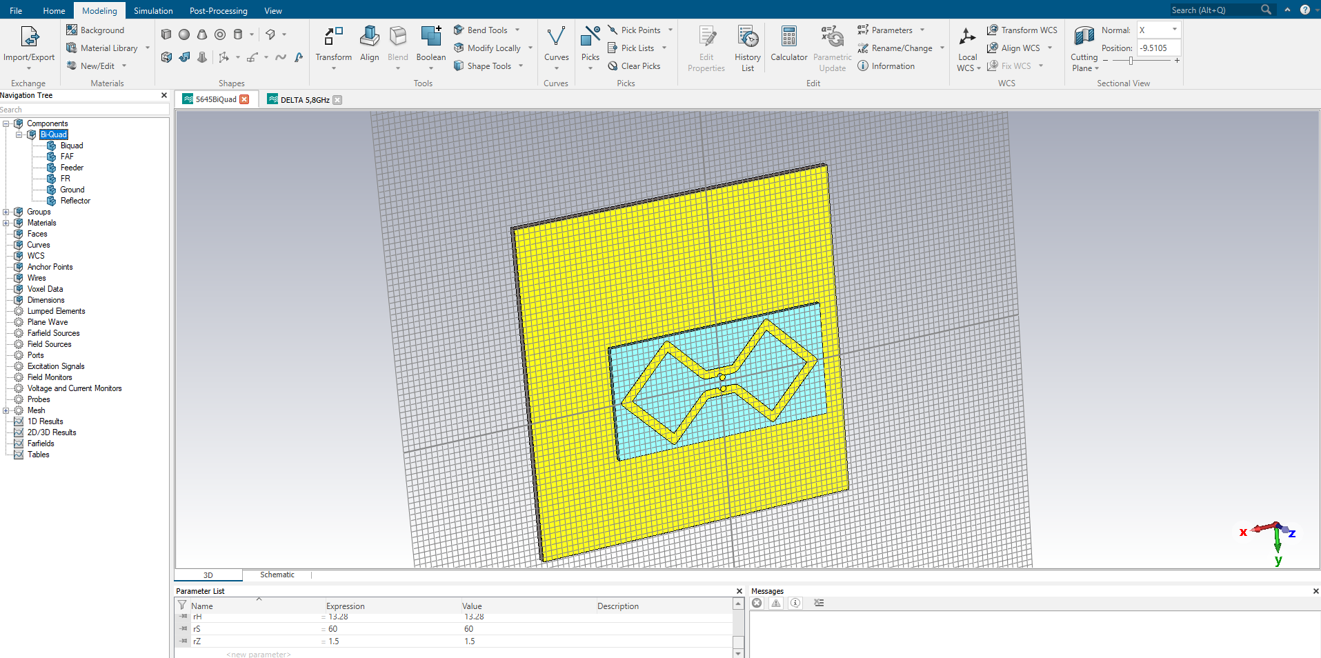

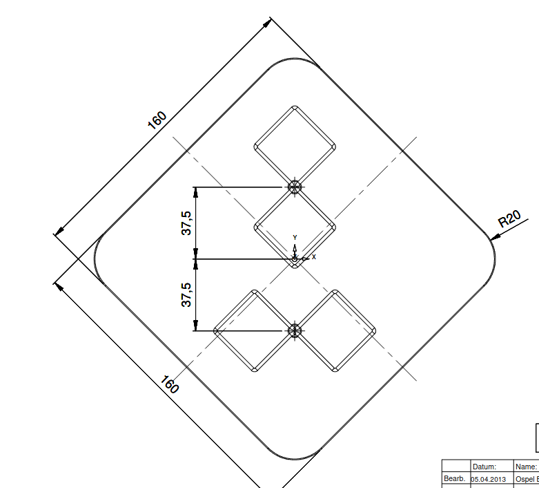

Also, I'm trying to simulate a Kathrein antenna element for 3.5Ghz, but results on CST look very bad, I like this Kathrein design and if anybody wants to try making some corrections on this it would be a good antenna to use as dish feeder
4-Planar.cst
@Admin Could you help me with the simulation of this antenna, please?
