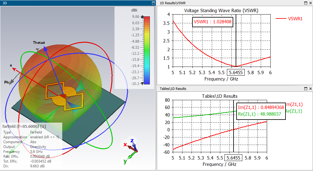

KSM...from where did you get it...???
Made by myself
Just now, KSM said:
Made by myself
,,,show the file...
can`t open the file.

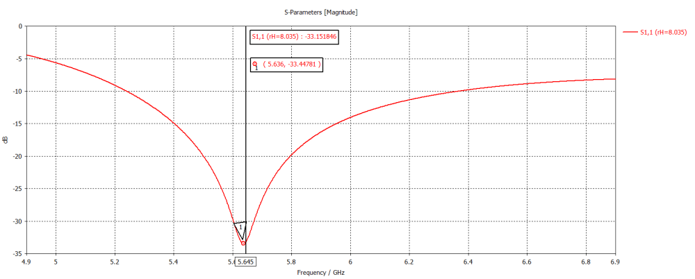

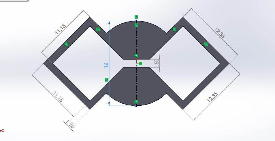

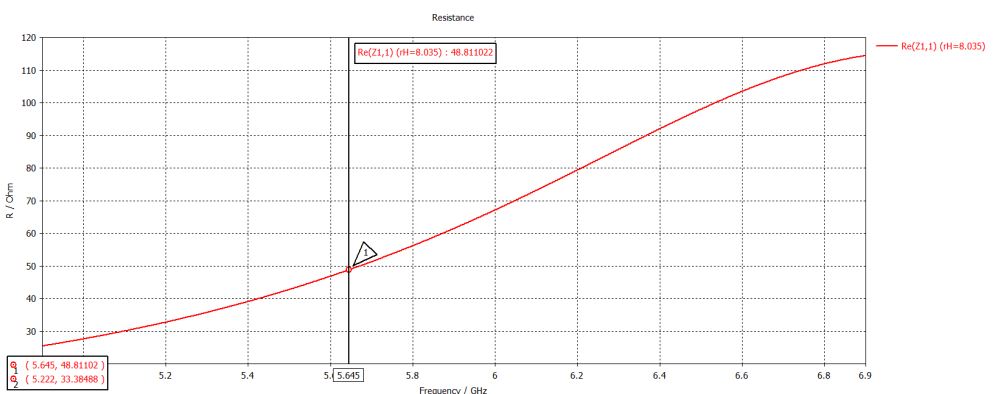

I have 2024 CST  Studio
Edited by KSM

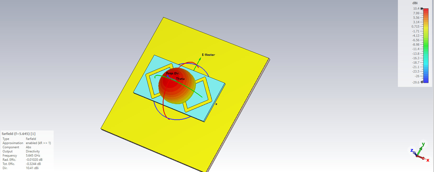

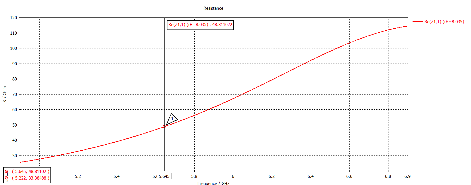

16 hours ago, clanon said:
What DIELECTRIC...?
FAF-4D
1 hour ago, KSM said:
FAF-4D

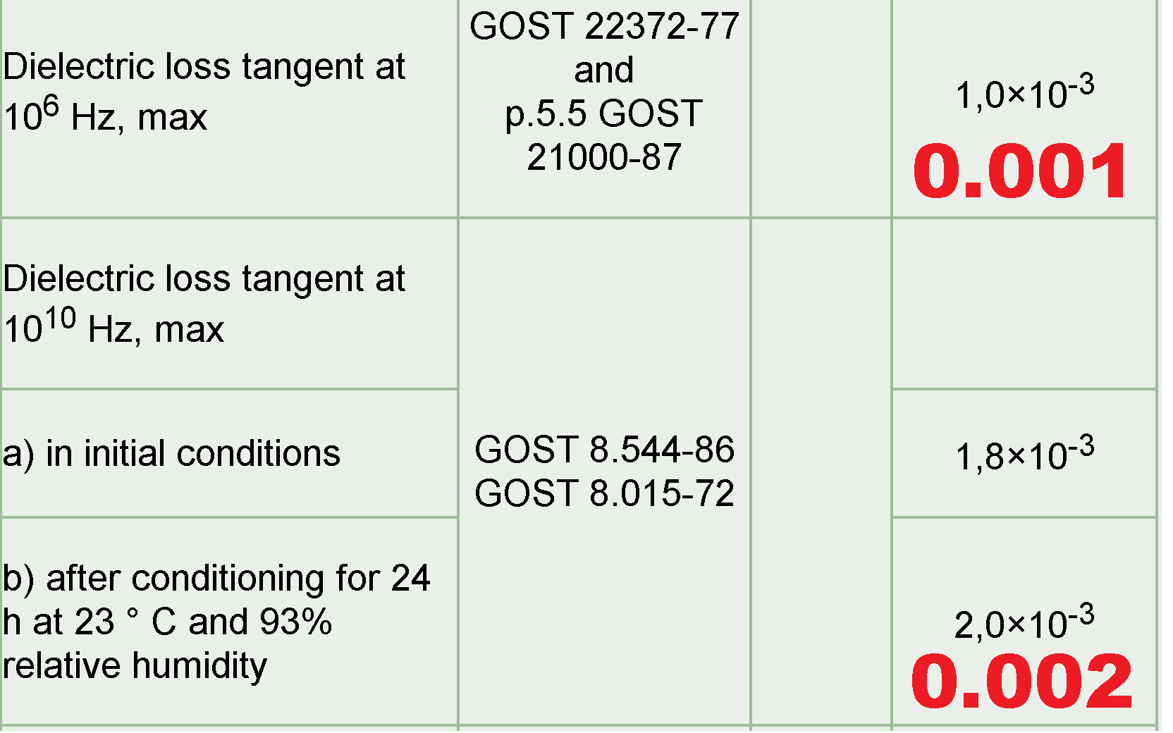

What efficiency...? better or worse than FR4 ...did you input the Tangent loss...
Much better.

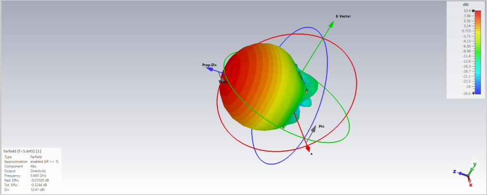

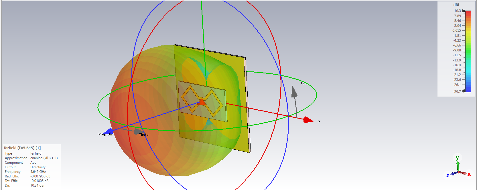

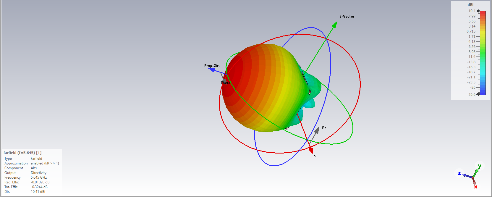

,,,,hi buddy...!!!!
It's pretty good, if you have it, try it....!!!
