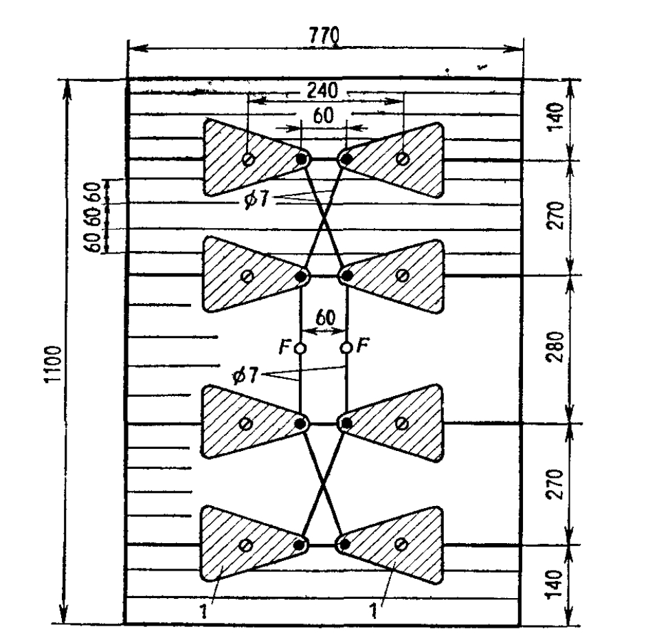

No, the drawing is very good...!!!!
I'm going to make a simulation on this antenna.
And yet, this antenna is not really good ...

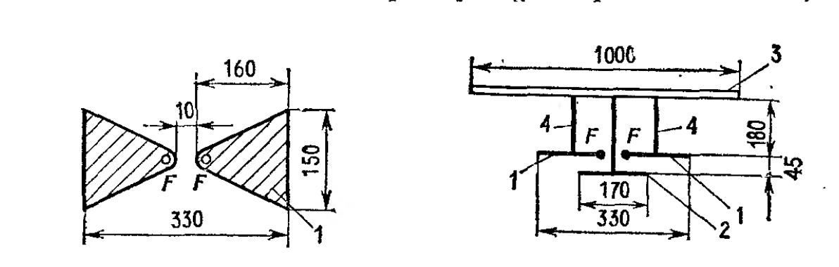

,,,the antenna according to E. Spindler....470 - 790 MHz
will try it for next TV antenna project...many thanks Admin

Dear Admin.....may i know
1. what is the impedance between F F ??
2. can use standard 3C coaxial 75ohm directly beetween F F ??
no ???
hmm as far as i know OPEN DIPOLE antenna have impedance from 50 to 75 ohm
and  CLOSED DIPOLE have 240 - 300
this one is OPEN DIPOLE
The impedance is highly dependent on the construction details. In general, you can expect 100-400 ohms of impedance. The nominal impedance is generally considered to be 400 ohms.

1) 240---300 Ohm
2) ,,,no...!!!

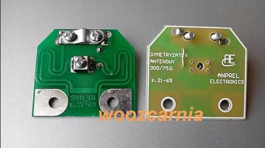

so a macthing 4:1 balun must be used ???
10 hours ago, Admin said:
1) 240---300 Ohm
2) ,,,no...!!!

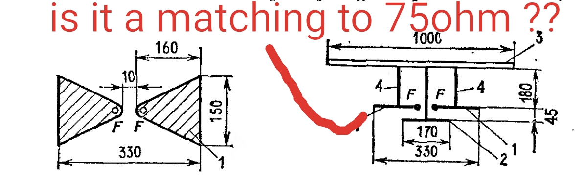

Dear admin..
i have question of the picture shown below.
is it a matching impedance 75 Ohm ??

 I wrote to you above that the antenna has a 240-300 ohm impedance, so you need to adapt for a 75 ohm cable.
,,,something like that...
dear admin,
but i still dont understand your drawing ....on what is  1000mm ??  is it a reflector
also what is it 170mm  ...is it a director
Dear admin...i prefer ""gamma match"" if posible to match the antenna..

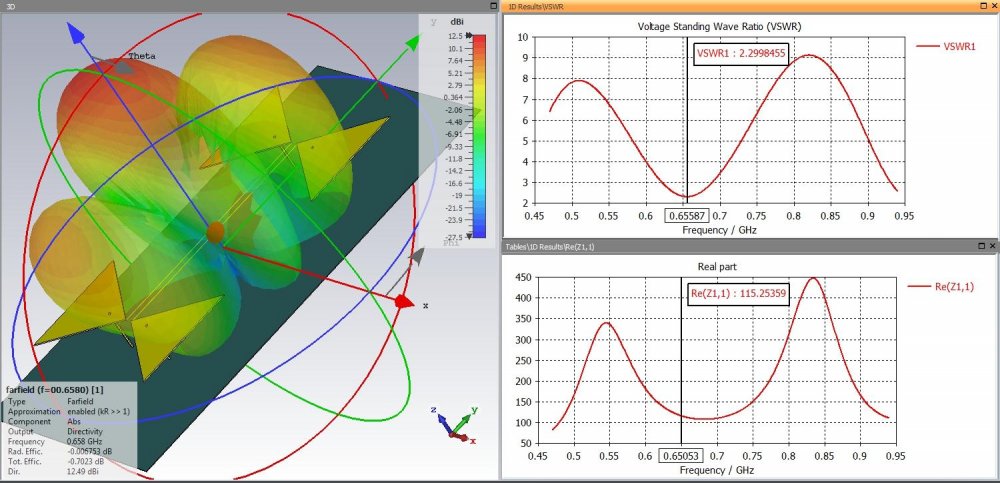

After my parents complained that my previous DIY antenna (the common design of a pair of double fractal-elements matched  to 75ohms from 300ohms via a TV balun) could not pick up any overseas channels at their house, I made the Biquad antenna based on the first Biquad (581.68mhz in simulation) that was provided in this thread.
I resized all the original dimensions (x 0.83) for my intended frequency of 682mhz  so that it could receive overseas HDTV channels at my parents house.
A check with my VNA revealed that my resized antenna was tuned to the center frequency of 572mhz. It is usable for a range from 400mhz (1.5 SWR) to 750mhz (1.5 SWR). At my desired 682mhz, SWR is close to 1.3.
 Thank you admin, the design is great. Now, my parents are able to watch foreign channels.
