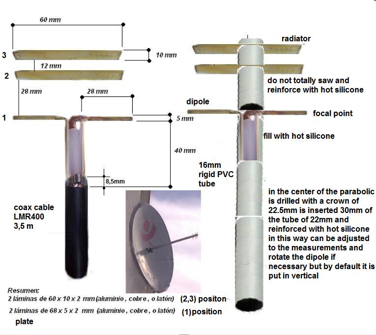

what used material?? can you tell me about this detail, its look like easy to made. thanks

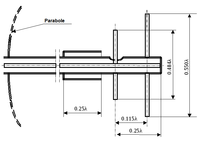

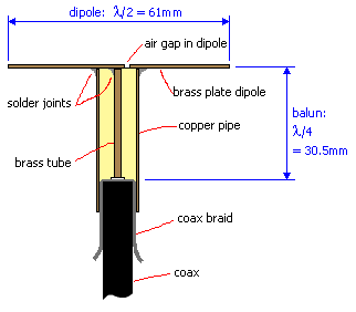

,,,good, this is a general scheme...!!!

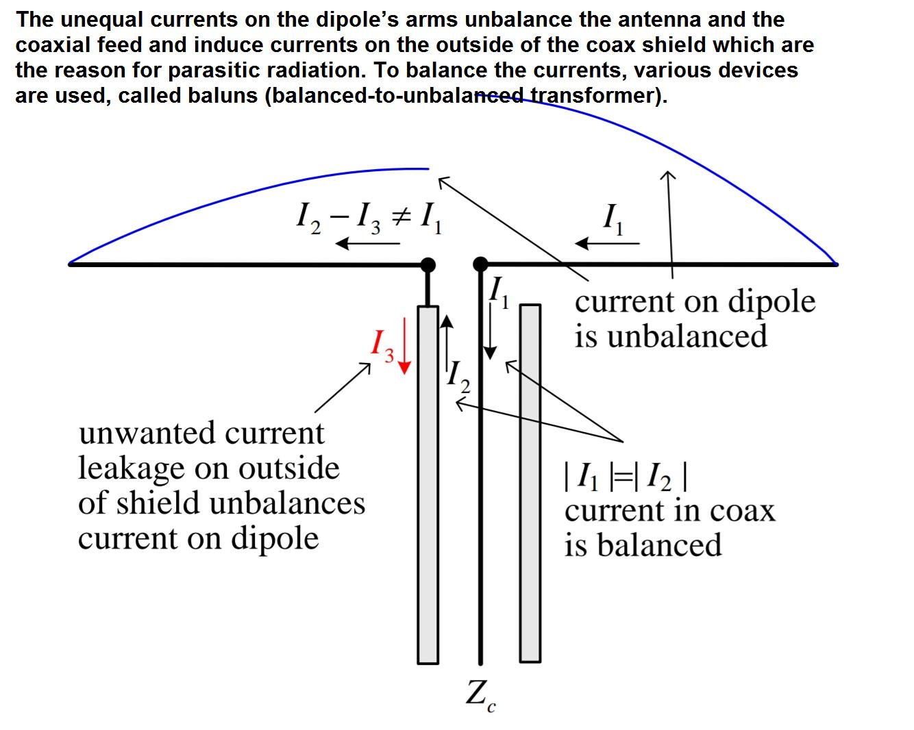

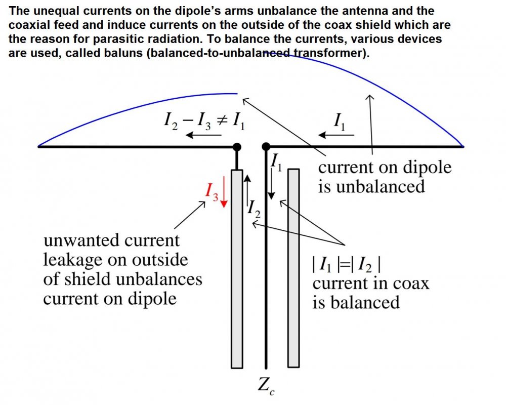

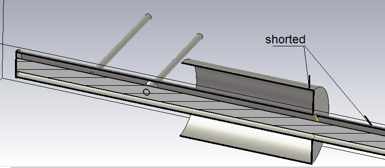

,,,baluns device (a device that provides coupling the symmetrical antenna and asymmetric feeder) made in a quarter-wavelength glass the base of which is connected with the outer conductor of the hard coaxial cable...

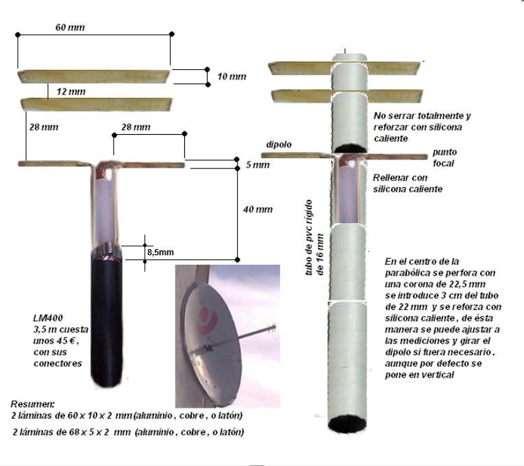

,,,copper wire, copper pipe and coaxial cable...

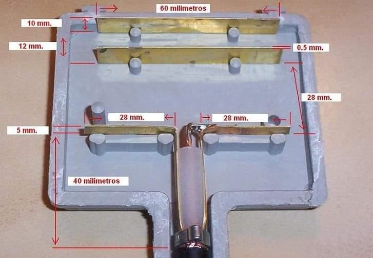

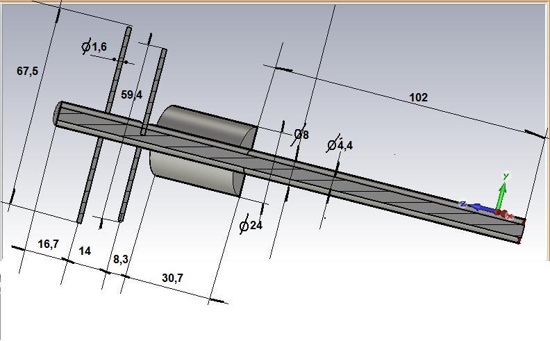

At the request of the Bajonet user, I present some constructive details below...
My friend, please explain how to properly power this design. I don't understand at all. :)
The question is. The sleeve balun is connected to the dipole ?

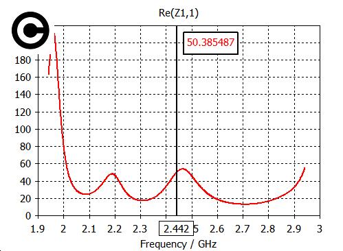

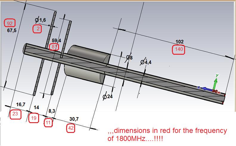

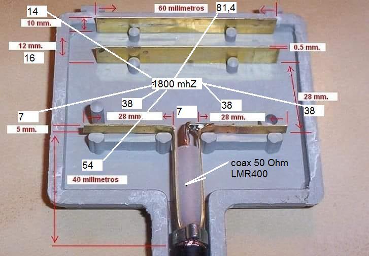

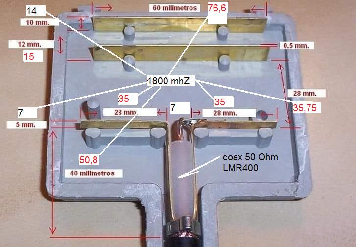

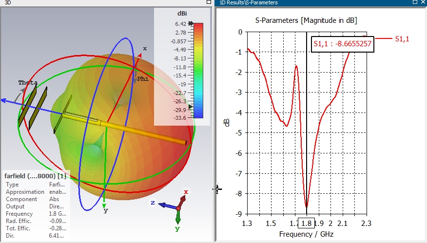

Possible frequency measurements for 4G 1800 mhz
Edited by miloudsatdz

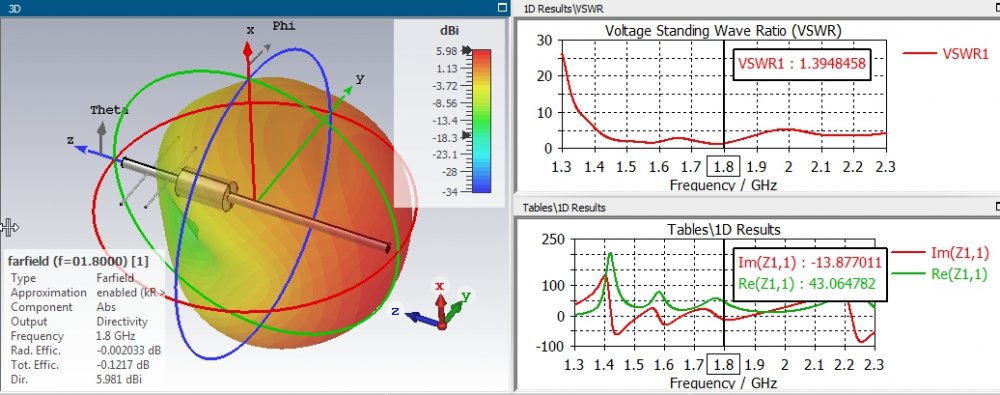

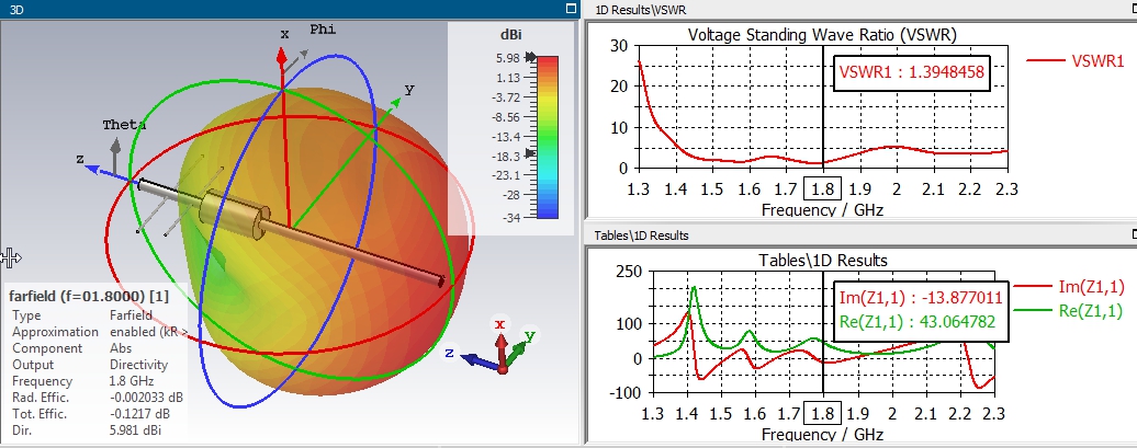

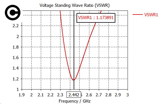

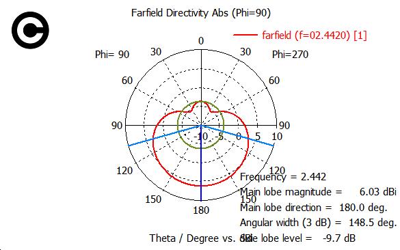

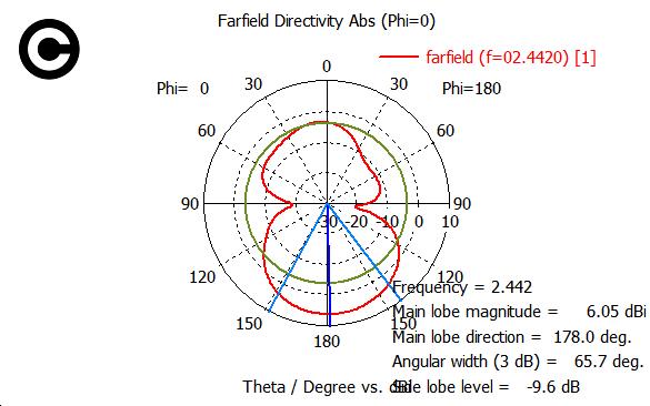

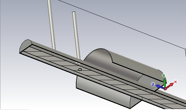

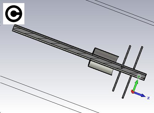

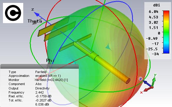

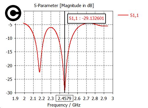

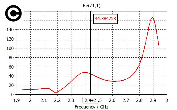

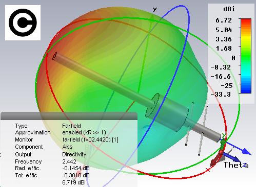

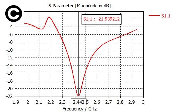

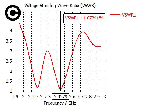

,,, but I have to do a simulation...!!!
,,, here are the results ...
,,,with the best dimensions below ...
