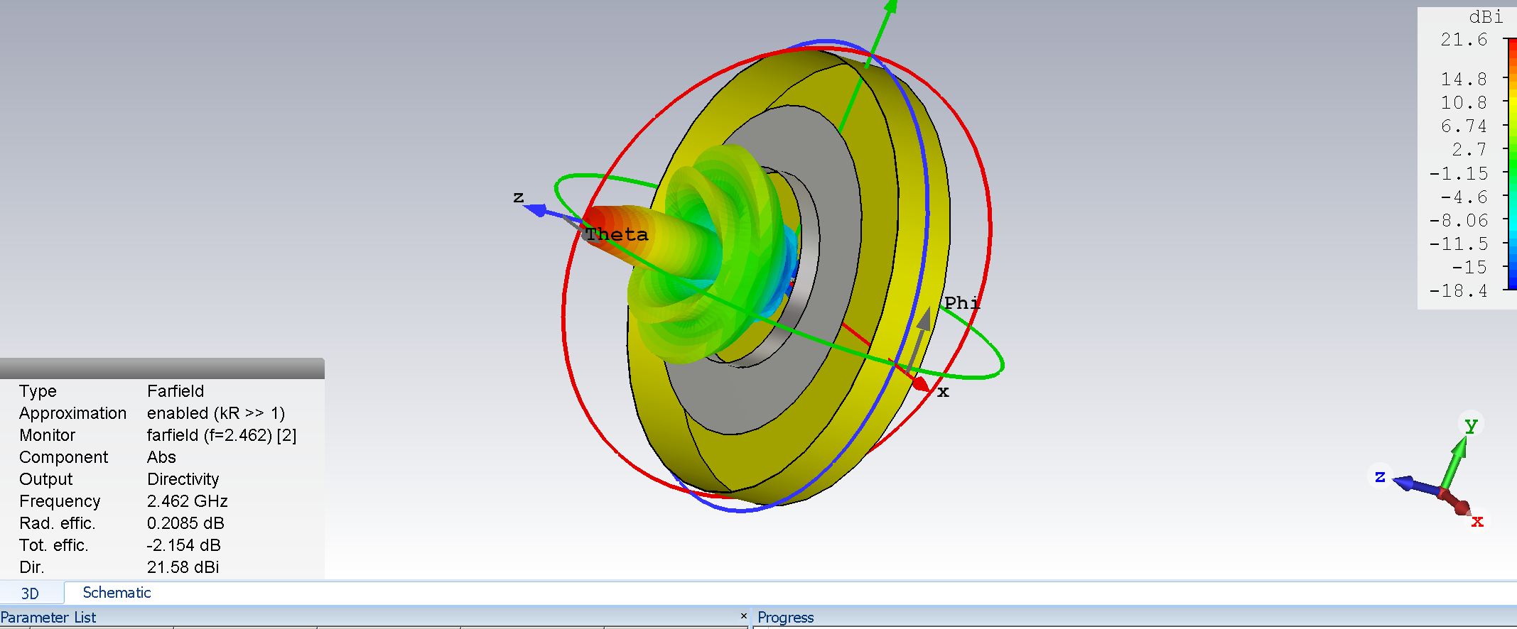

@eco32 you NEED to try CST...is very intuitive and fast...and better results...
backfiring CIRCULAR PATCH should have better shape...LOBE
1 person likes this -

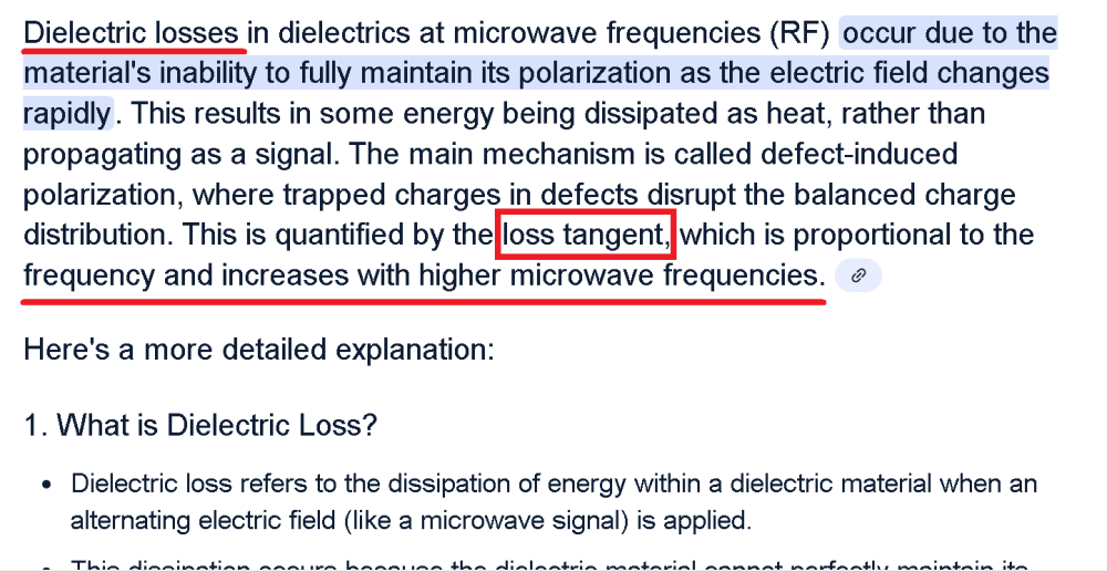

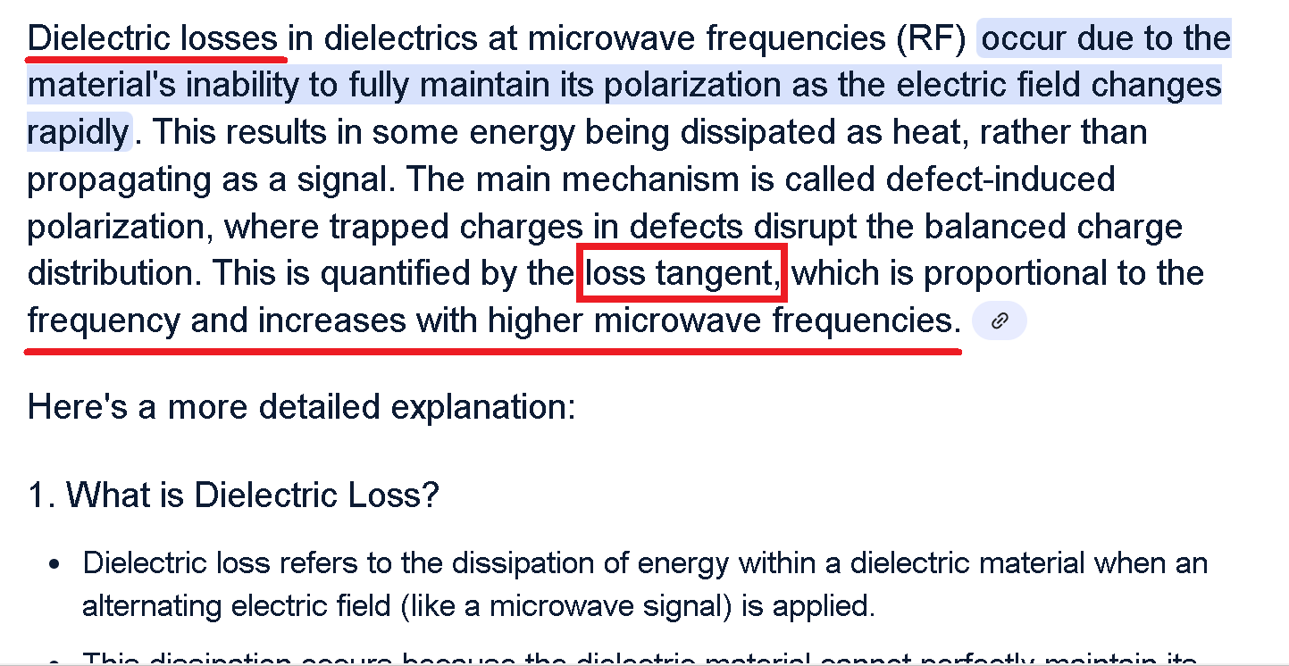

Brass might be better not so easy to oxidize...or protected from moisture PURE COPPER...(aluminum, zinc,etc)
You'll have bigger losses on DIELECTRICS than metal every time
