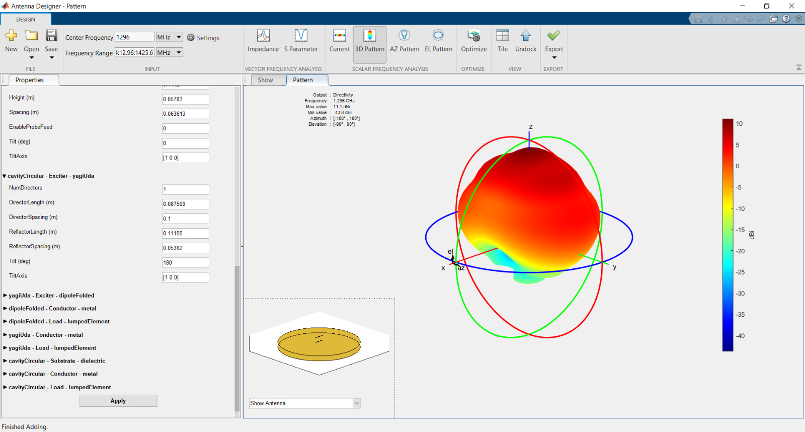

I can only use dipole with reflector with out  circle and without ring in Matlab, i got 15,4dBi on this moment and optymalisation is in progress,
Radius 47cm
Heightt 21cm
Spacing ~50cm
freq 1296MHz

@eco32 you NEED to try CST...is very intuitive and fast...and better results...
backfiring CIRCULAR PATCH should have better shape...LOBE

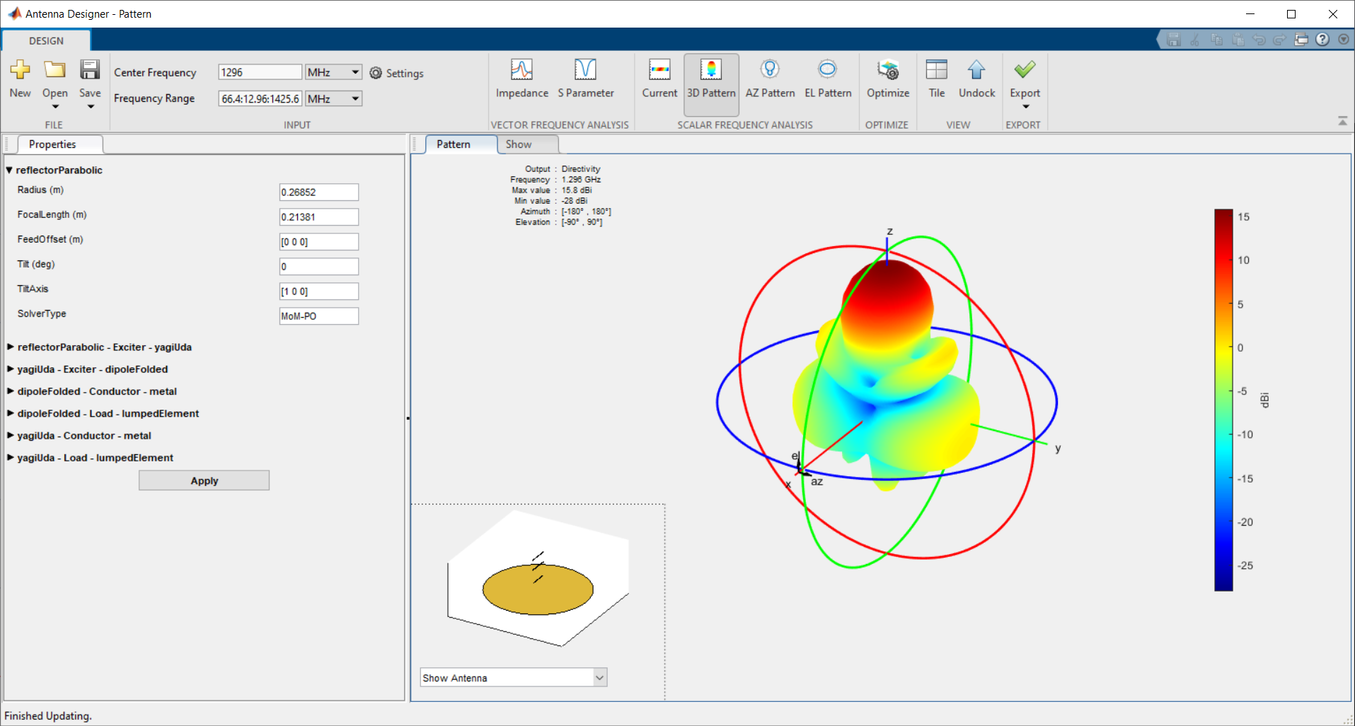

bacfire VS dish
1296MHz similar diameters,  after long optimalisation  in Matlab (end usage of thos tool soooooon)
I wonder why you make a radiator with a diameter of 537 mm, when you better use a parable from the trade....???!!!
,,, a lot of work for nothing....!!!
To know what to do ot not to do, It is not always possible to buy what you want.
RND and learning
