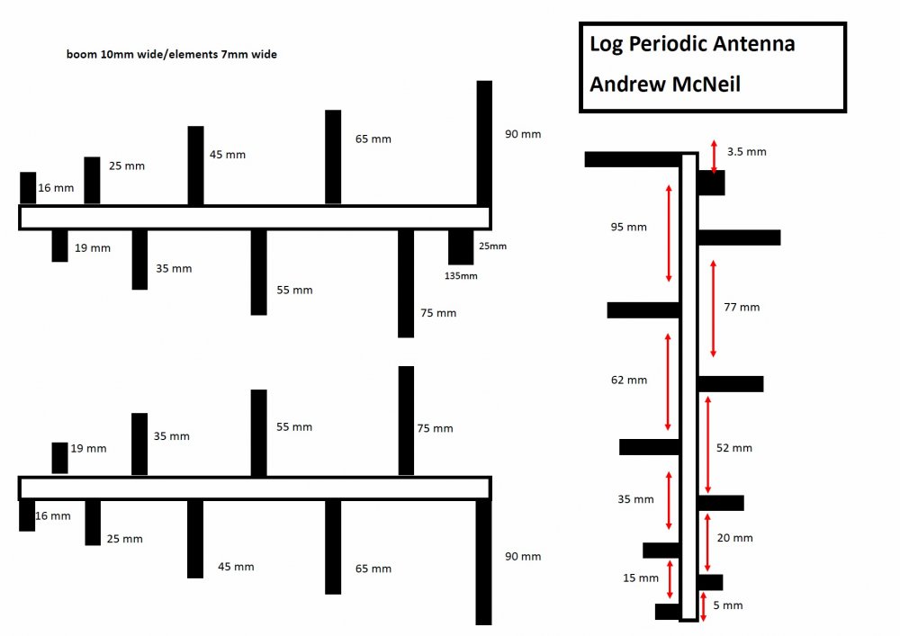

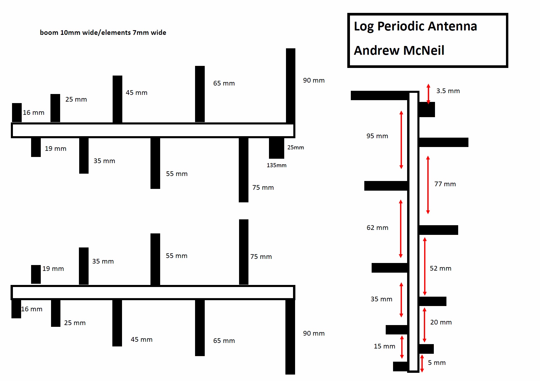

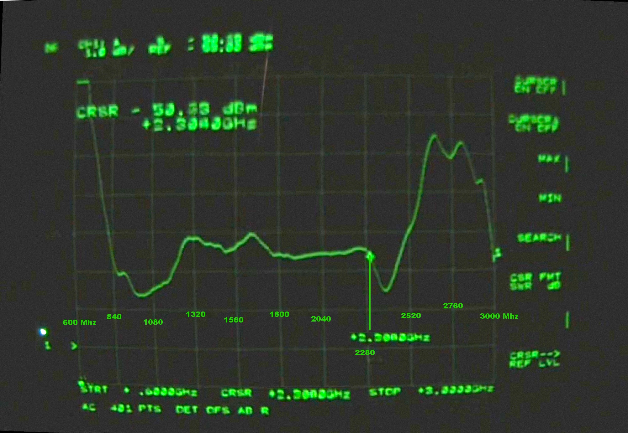

This antenna may work but with other dimensions...
This short LPDA  700 to 2700 mhz  claimed !
i'll give it a go...this week...
Thank you Clanon  it works bad at 1800 to 2200 MHz?

Hamza, another bad antenna of mcneil...

Jomy , what material i should use for the COVER...PVC...? (for that logper)...

Never over 8 to 9 dbi... (its NOT good) maybe used to feed a dish...

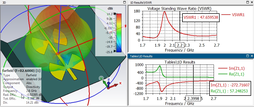

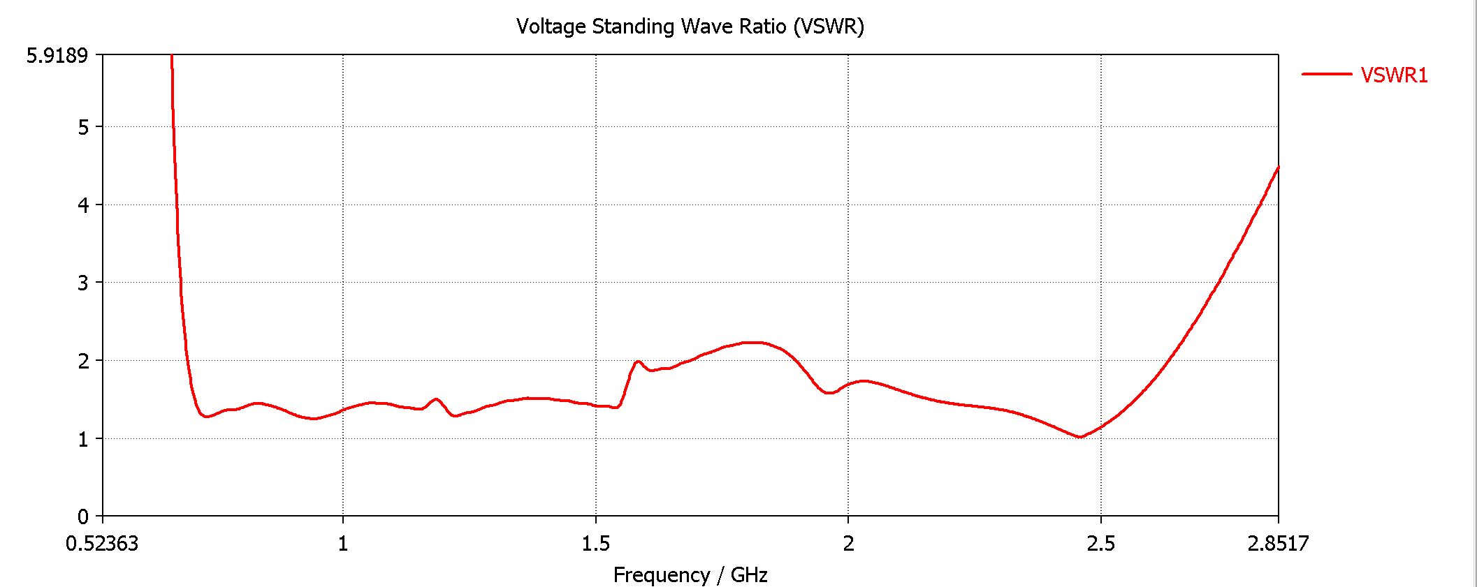

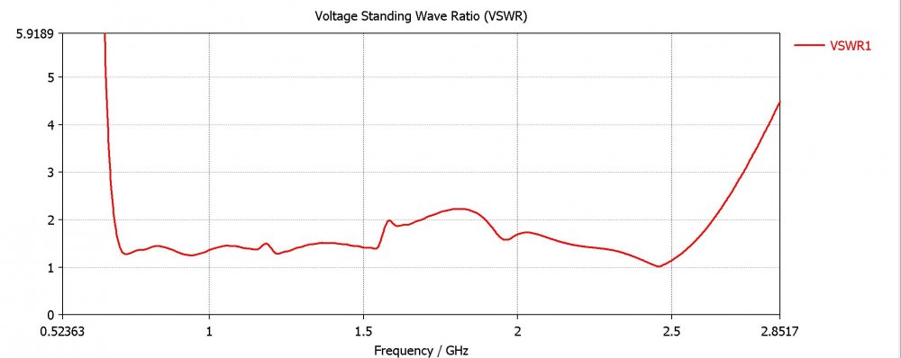

 Jomy  in the network analyzer it gives very good response at 3 to 3.7 ( 5 generation) and  at 1700 to 2200 GHz  .please try to make simulation on this frequency bands
Hamza, I deleted the * cst file, it's not worth trying again, the antenna is a fake...!!
,,, but anyway, I will try to resume this simulation...!!!
