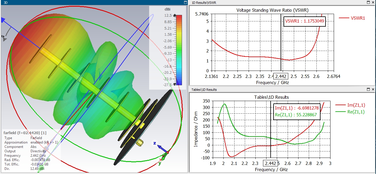

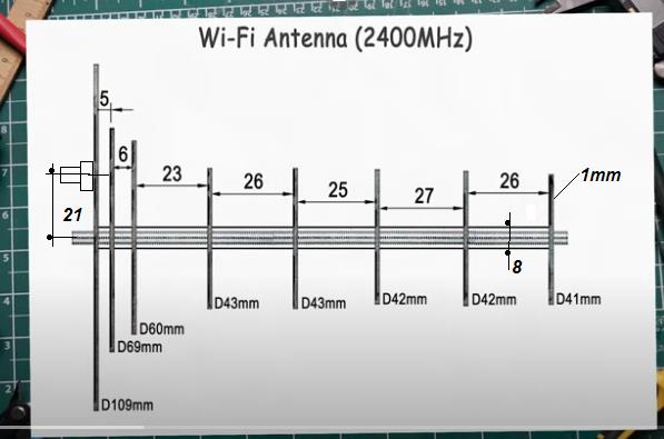

"It seems that this antenna is quite good...
Nice work.   Only.  The connection  of cable of the reflector is very bad idea

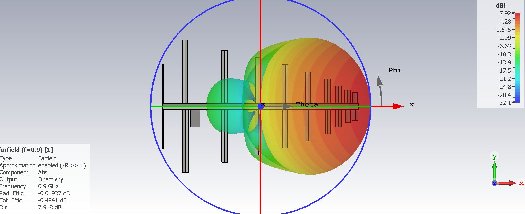

Hi jomy.  Have a good day.   I asking. If this idea of repeater   could improve the mobile signal.  And. Whats is the possible design for 4g 1800

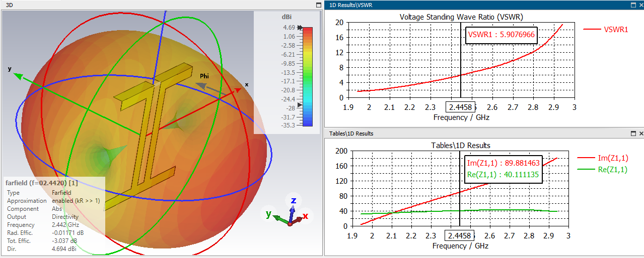

,,,hi buddy...to know that I tried(by simulation) this repeater solution but it didn't work...!!
the  aluminum  cannot be soldered  by  this method  !!!  big  mistake

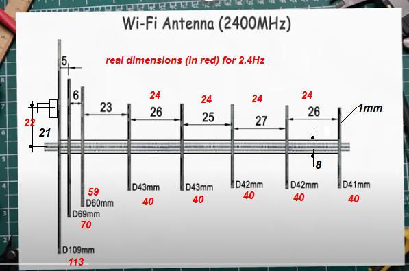

fine-tune to run on 1800 and 2100
,,,and again I'm curious how right andrew mcneil is...????

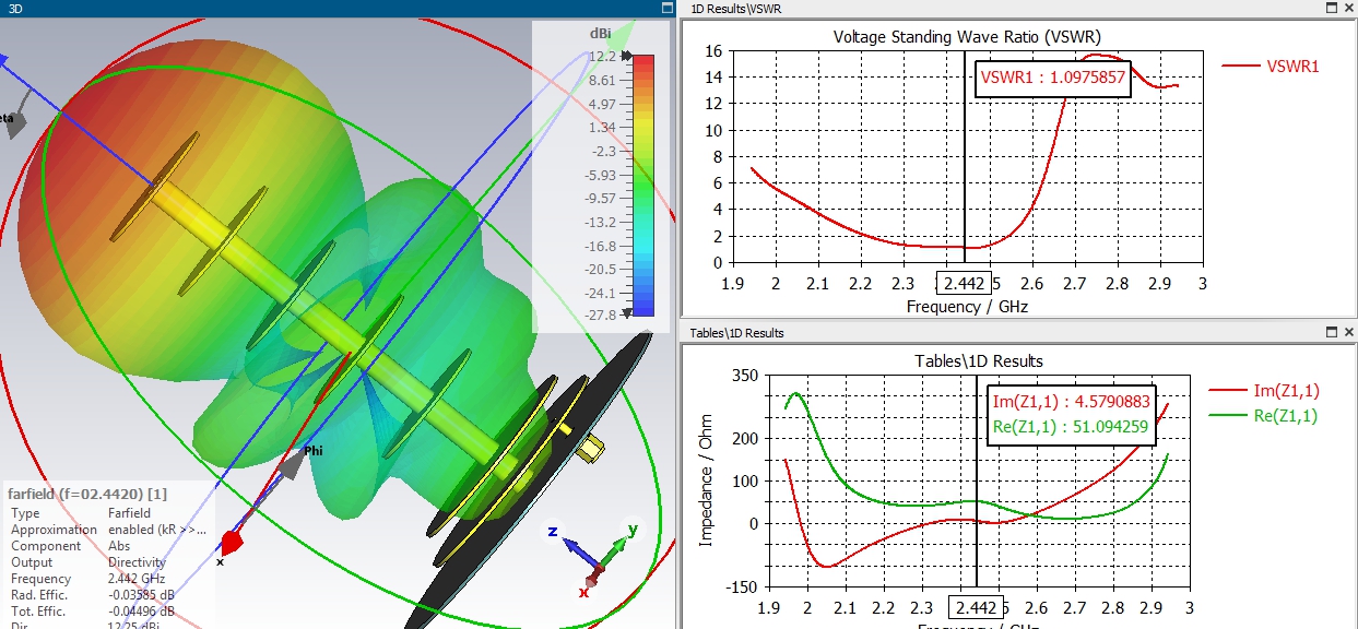

I will try to do a simulation with this antenna
"I think this is a lie."
