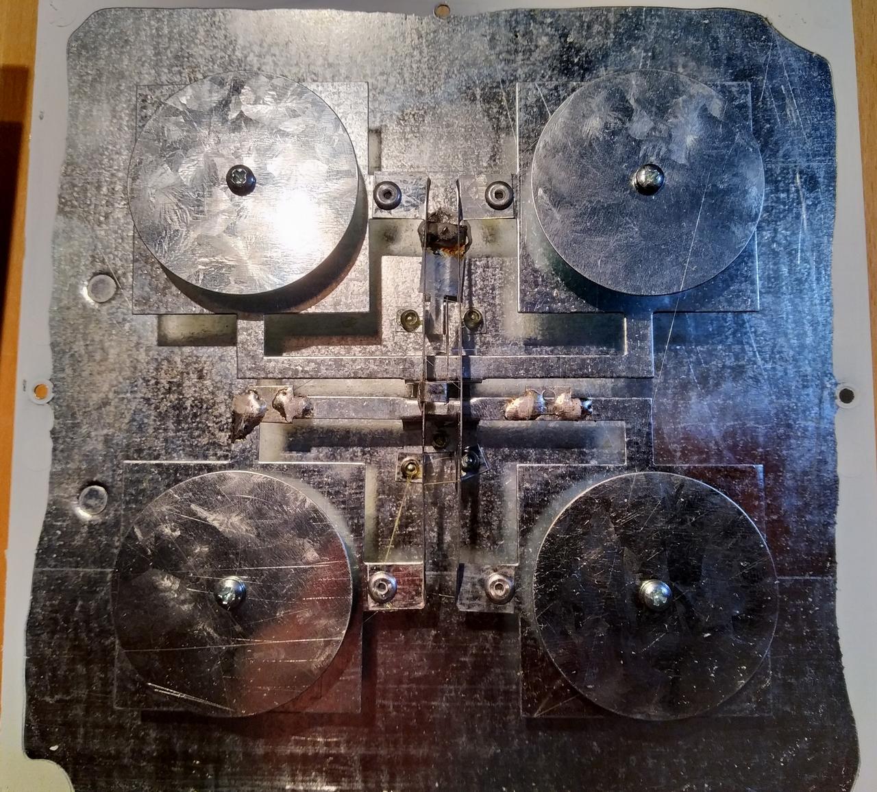

PETRA BB UniBox MIMO 2x2 antenna with thermoboxes for 3G/4G modem.

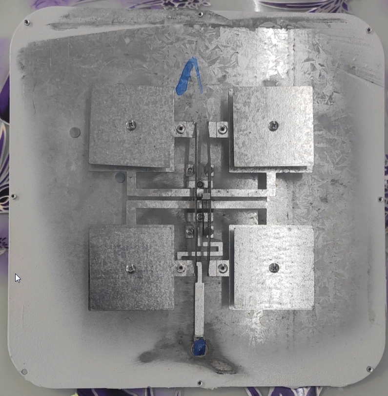

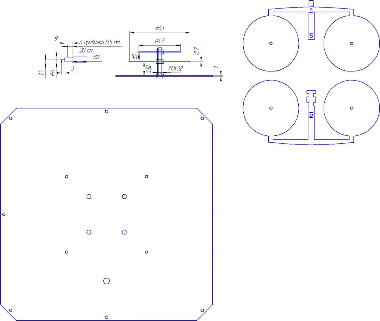

,,,okay, but it's too big for the parabolic offset aperture...!!!

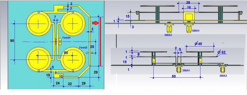

I'm not talking about the irradiator. I mean, like this antenna..panel....240 mm
,,,okay, sorry, I did not understand that, I thought you wanted to use it on an offset parabola..!!!

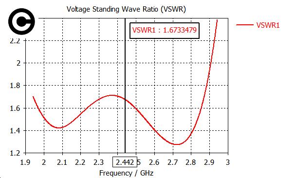

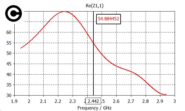

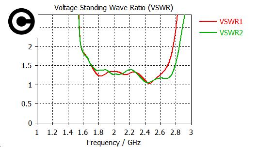

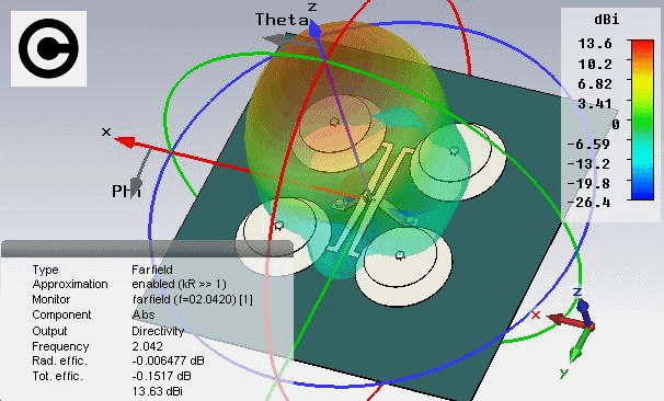

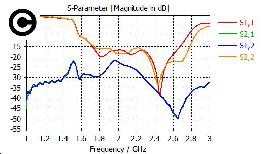

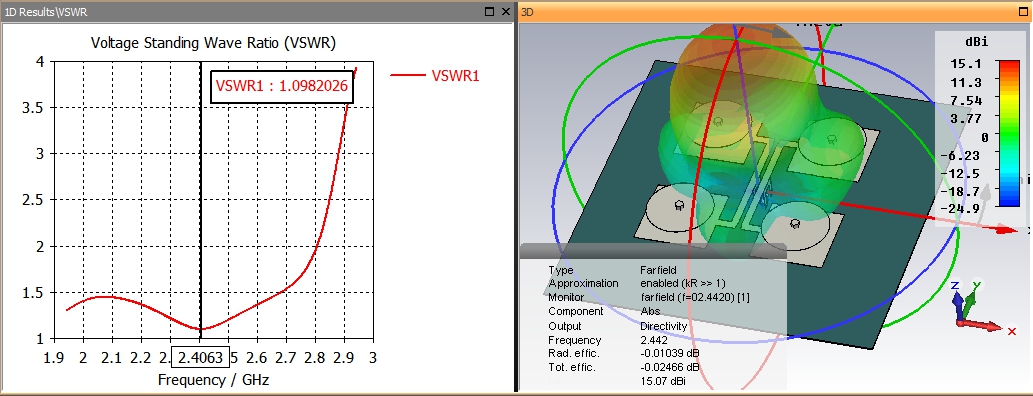

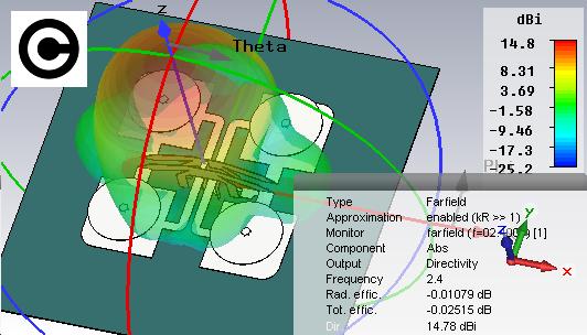

I will try to do this simulation....!!!
That's about that antenna...
Да ... Да ... Да ... Отлично! Jomy, у тебя отличная антенна! Я собираюсь приготовить эту антенну. Спасибо, Jomy! У меня хороший лазерный разрез.
,,, Yes ... Yes ... Yes ... Great! Jomy, you have a great antenna! I'm going to make this antenna. Thank jomy I have a good laser cut.
But in all that, the corners must be rounded...
,,,okay, but  this can be done only with the laser cut machine ...!!!

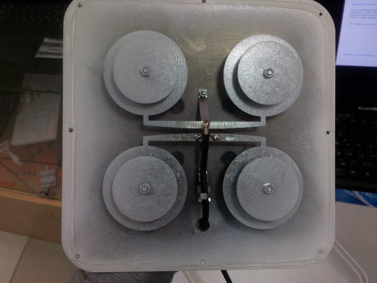

I guess it is useful to replay REMO versions of this antenna to which the connection is made by coaxial cable...

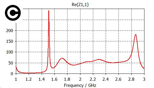

,,this solution does not have a uniform impedance across the frequency bandwidth...!!!

If possible, upload your printable image. I want to print it and cut my antenna. Thanks
Edited by Balouchi
With * jpg file you will  be not able to trace a real image to be able to drag that picture to be actually cut..!!!
Thanks. How much is the length of the specified line?
Well, but that's very simple if you do the calculations...!!!

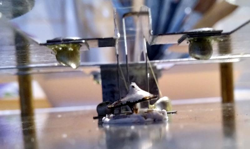

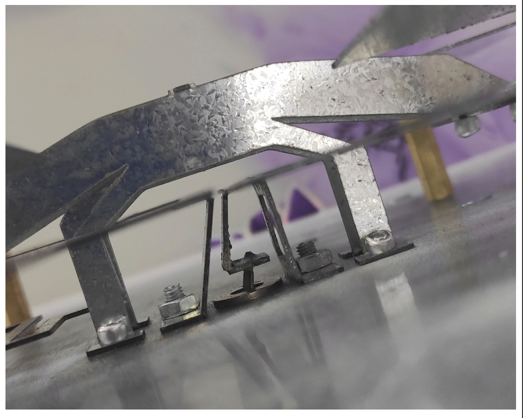

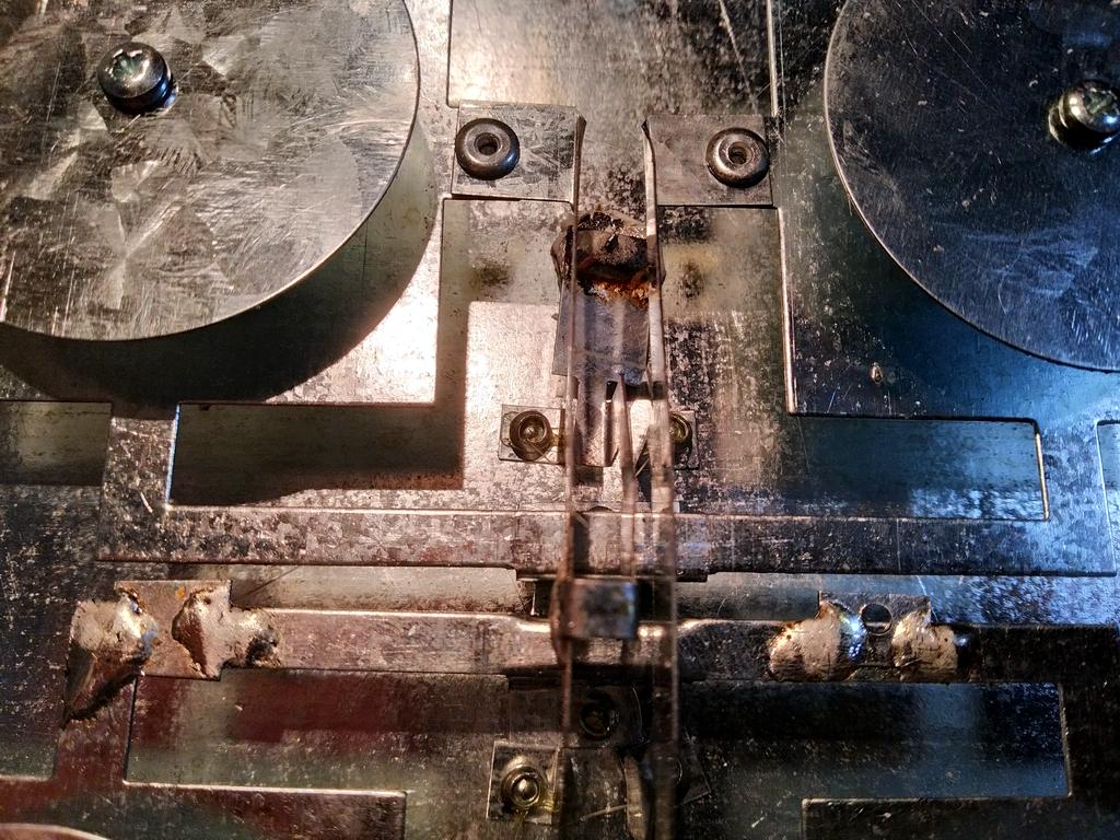

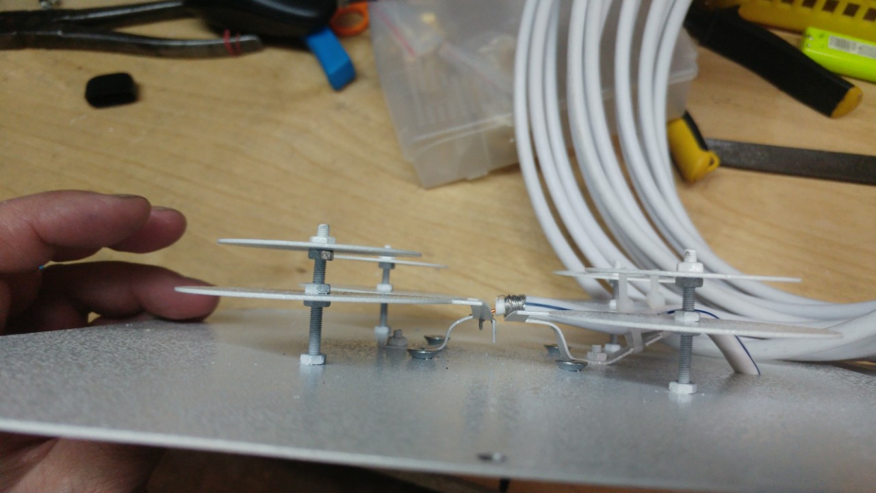

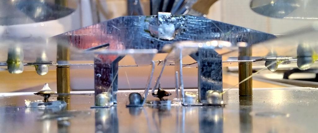

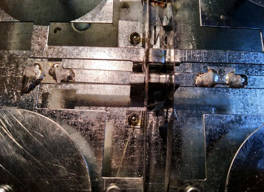

NEW PICTURES WITH DETAILS OF THE ANTENNA from Yurik82 user...

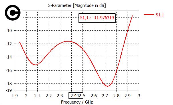

Test comparison of antennas for the Internet from 'Anteks' & 'Gellan'....

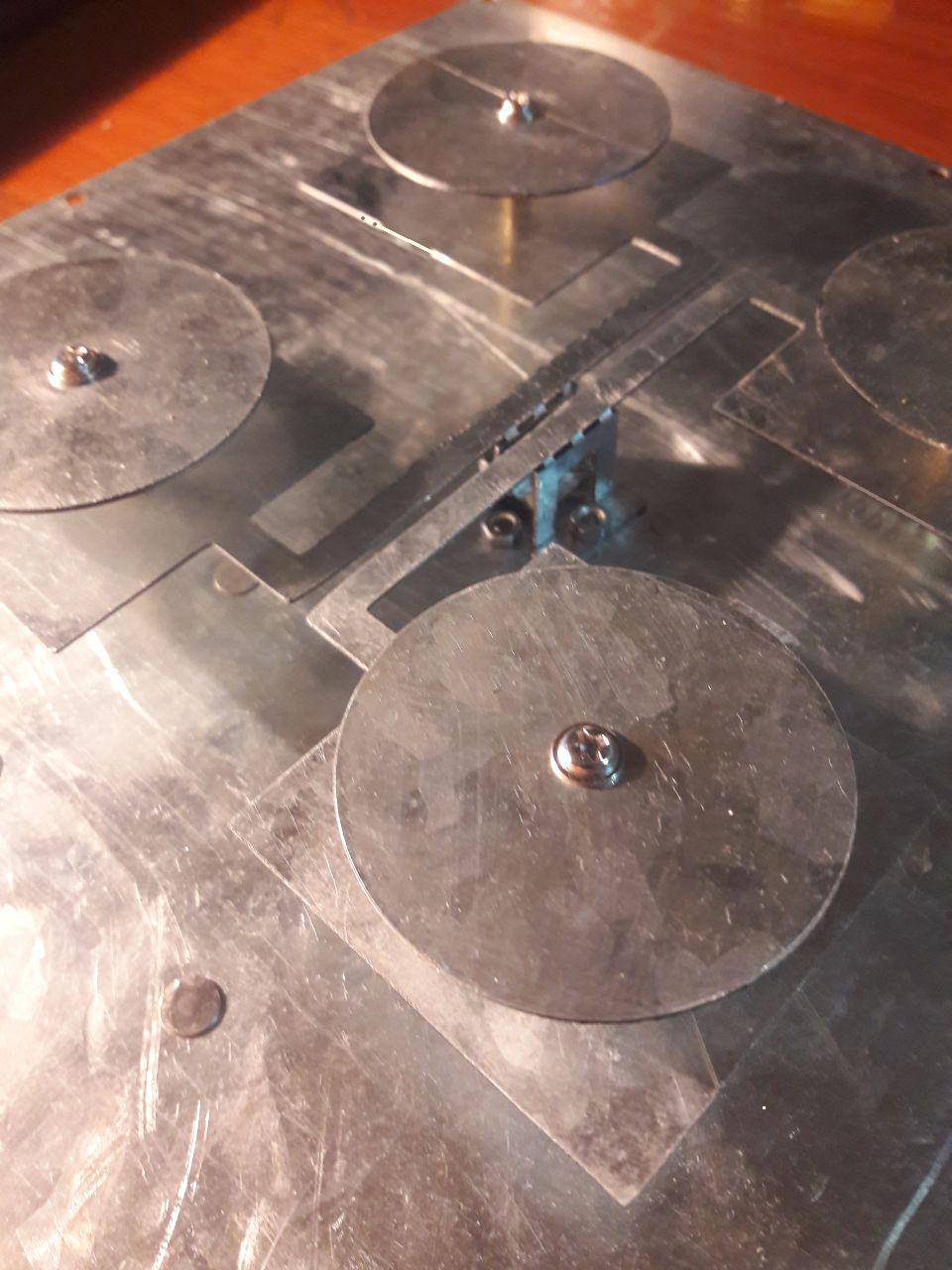

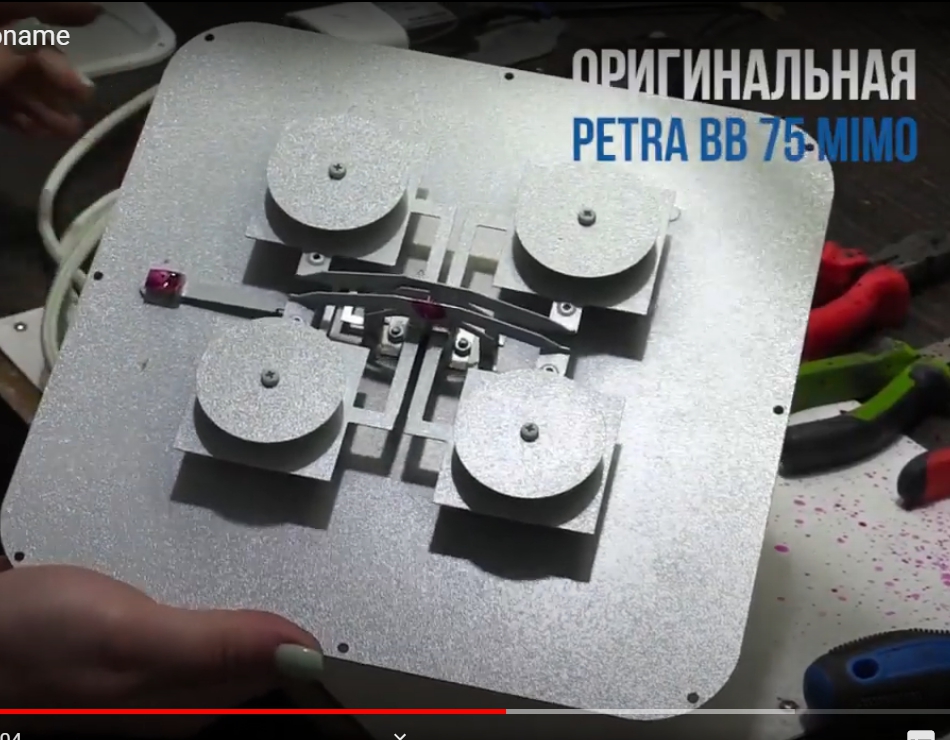

,,, changing the power lines of the Petra BB 75 Ohm antenna...
,,, another Petra BB antenna variant...
