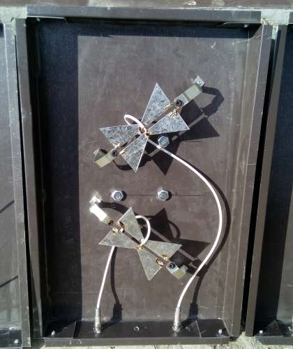

,,,Bejo, look what they did....!!!
how about polarization of this antenna?
Edited by bejonet

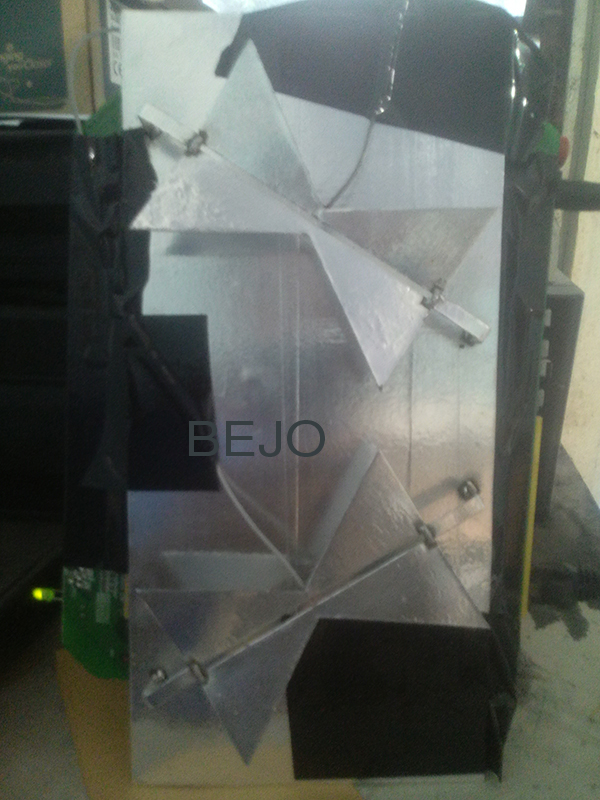

The test passes through 6 walls, can still be connected, -80dBm, to open the router GUI very smoothly
haven't had the chance to be connected to the internet, so don't know yet how much speed can be generated
,,, in X-polarization, they are lost, approx. 3 ... 5 db

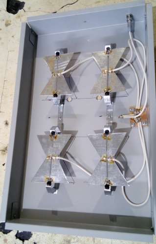

,,, but you could try this option too.. !!!???
Also known as BOW TIE antenna...
yesterday i saw an array of high gain...i'll try to post it....(but it was for FR and 19ghz...:()

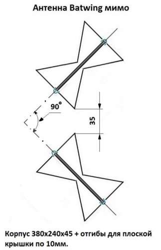

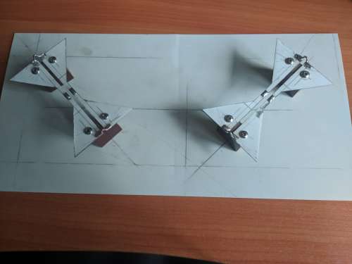

Strange, why, he didn't do it with X polarization?
,,, because not all BS (Base Station) have X or Cross polarization..!!!
,,,much like an omni-batwing antenna would behave...
,,,,but be aware that the sizes are different...!!!!
