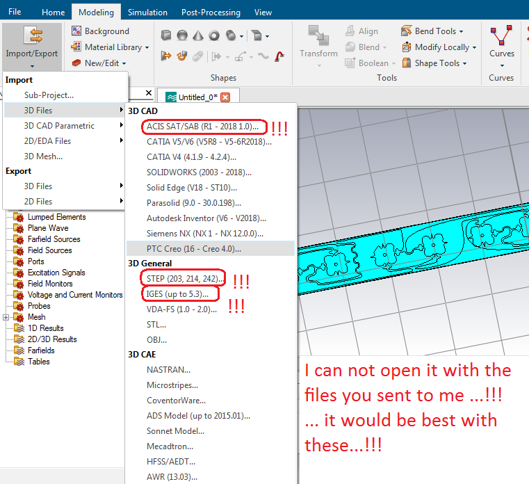

....see if autocad 2016 can open * igs.file ... !!!
13 minutes ago, Admin said:
,,,hi buddy...!!!
yes i tried with autocad 2016 but this is the result in previous image

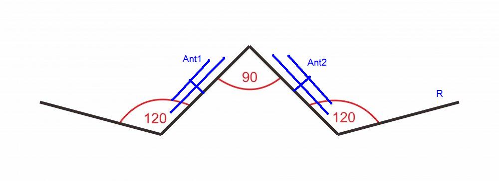

,,,for which antenna ... ???
,,,can it be solved with this type of reflector ... ??
Thank you for advice. But the dimension wil be no compact right? Hehe
Do you have simple antenna mimo model 120d dude from airmax model or any dude ? Thankyou before
I do not really understand what you want...???
,,,what is 120d...???
That's too complicated for a DIY execution...!!!
