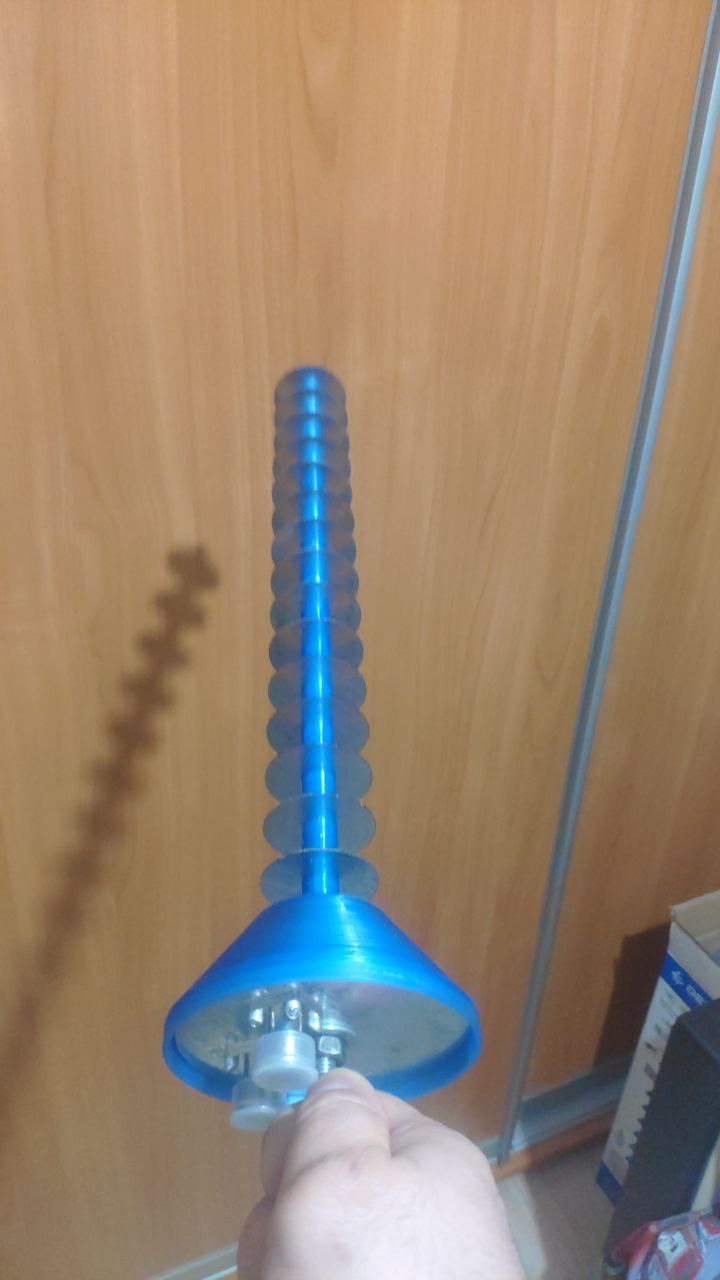

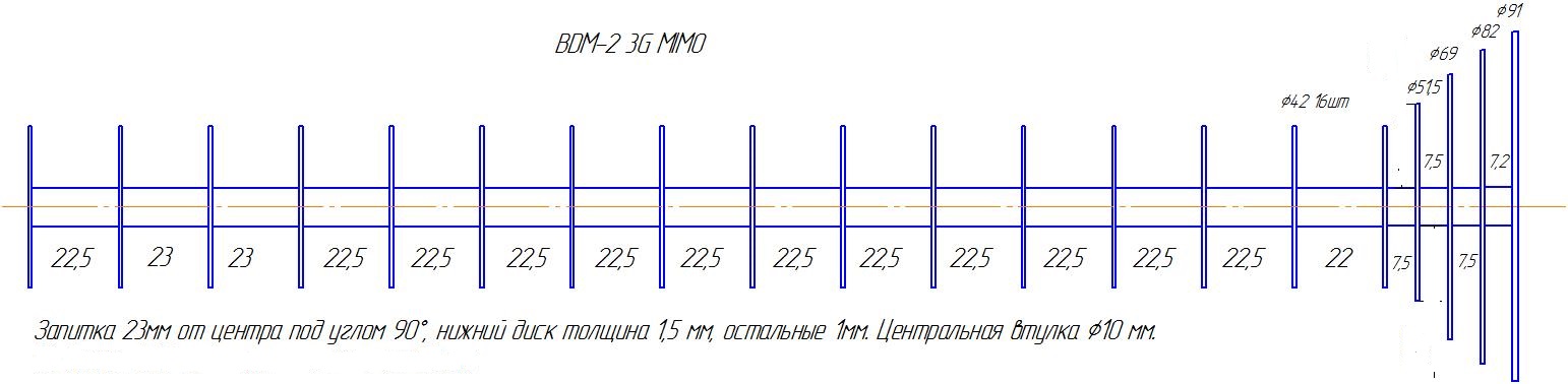

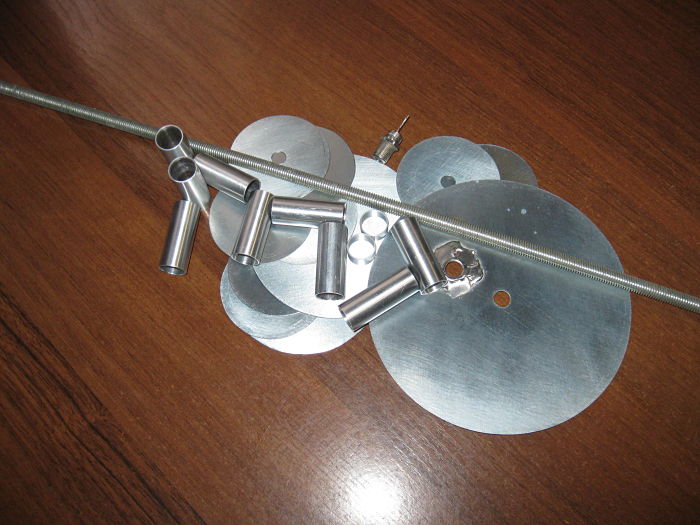

This antenna is BDM-2 3g,4g mimo 2100MHz.  Central feed from the center 23mm at an angle of 90 ° tube diameter 10mm

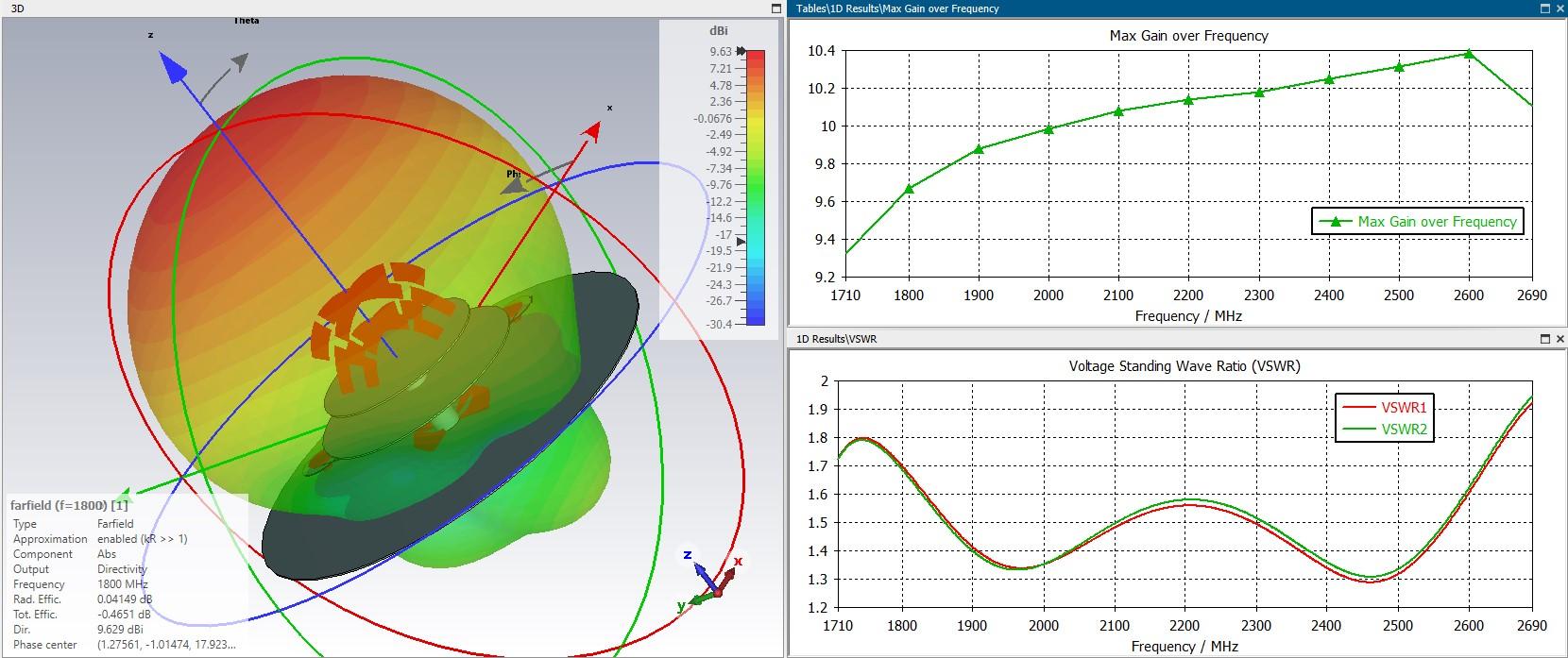

I did mine a little wrong, instead of tubes I used plastic bushings, it was impossible to do that.  I ask the Admin to check the performance of this antenna HFSS.

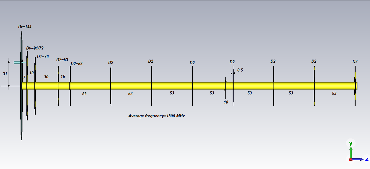

Hello. Who has the correct drawing with dimensions for bdm 1800-2100 mimo and 50 ohm cable?
bester did not produce such an antenna

,,,and with ARINST Measuring equipment, something completely different comes out...!!!
without knowing the size and method of feeding, it is not necessary to talk about it.

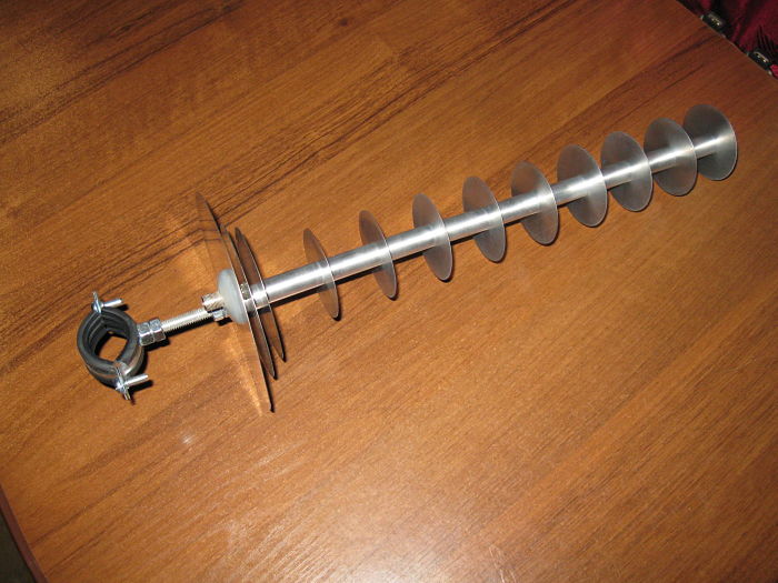

On 2/23/2020 at 7:40 PM, sa3500 said:

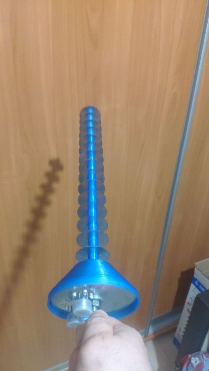

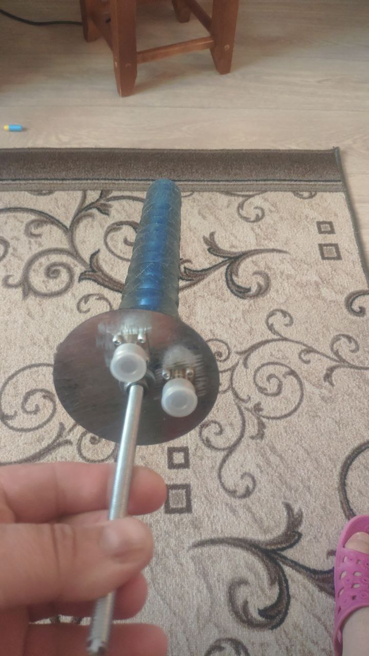

Construction in metal. Works good.
Hi, any isolation applied somewhere?
,,, without insulation between the elements of the antenna...!!!

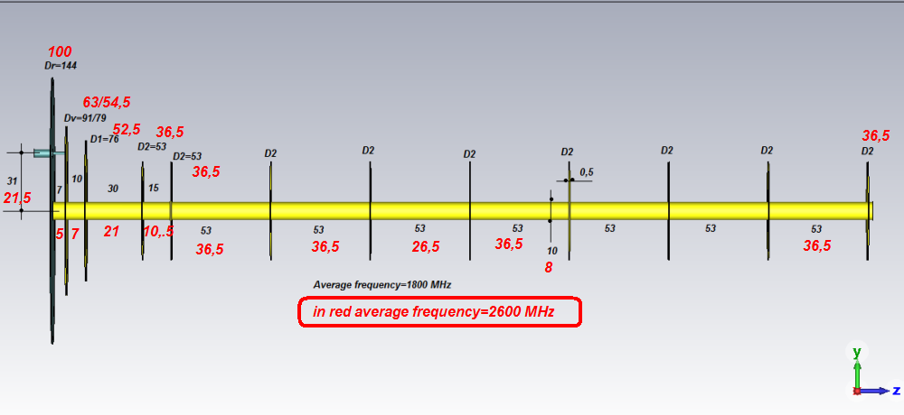

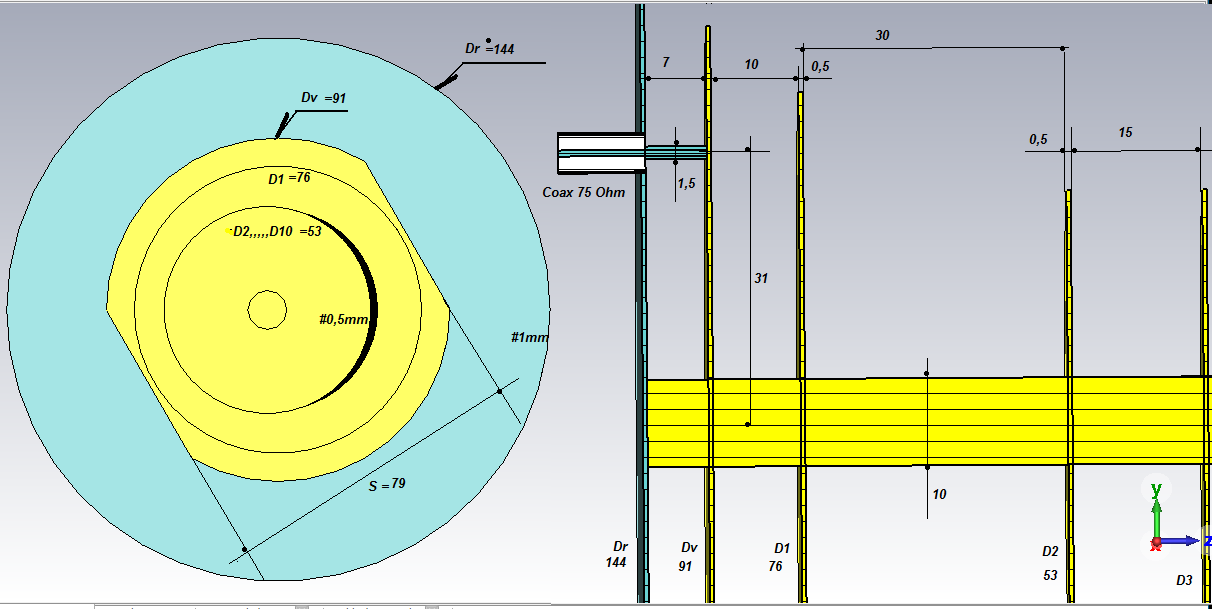

Hello. Who has the correct drawing with dimensions for bdm 1800-2100 mimo and 75 ohm cable?

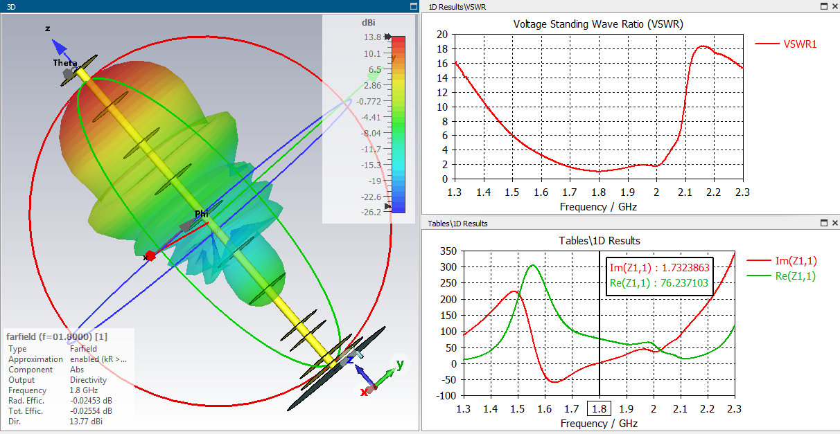

I will try to make a simulation for a 75 Ohm cable..!!
,,, this would be the antenna for 75 ohm input impedance....!!!
 Who has the correct drawing with dimensions for bdm 2600 mimo and 75 ohm cable?
,,,do you want something like that...???
Yes
DavidER
,,, something like these would be...
