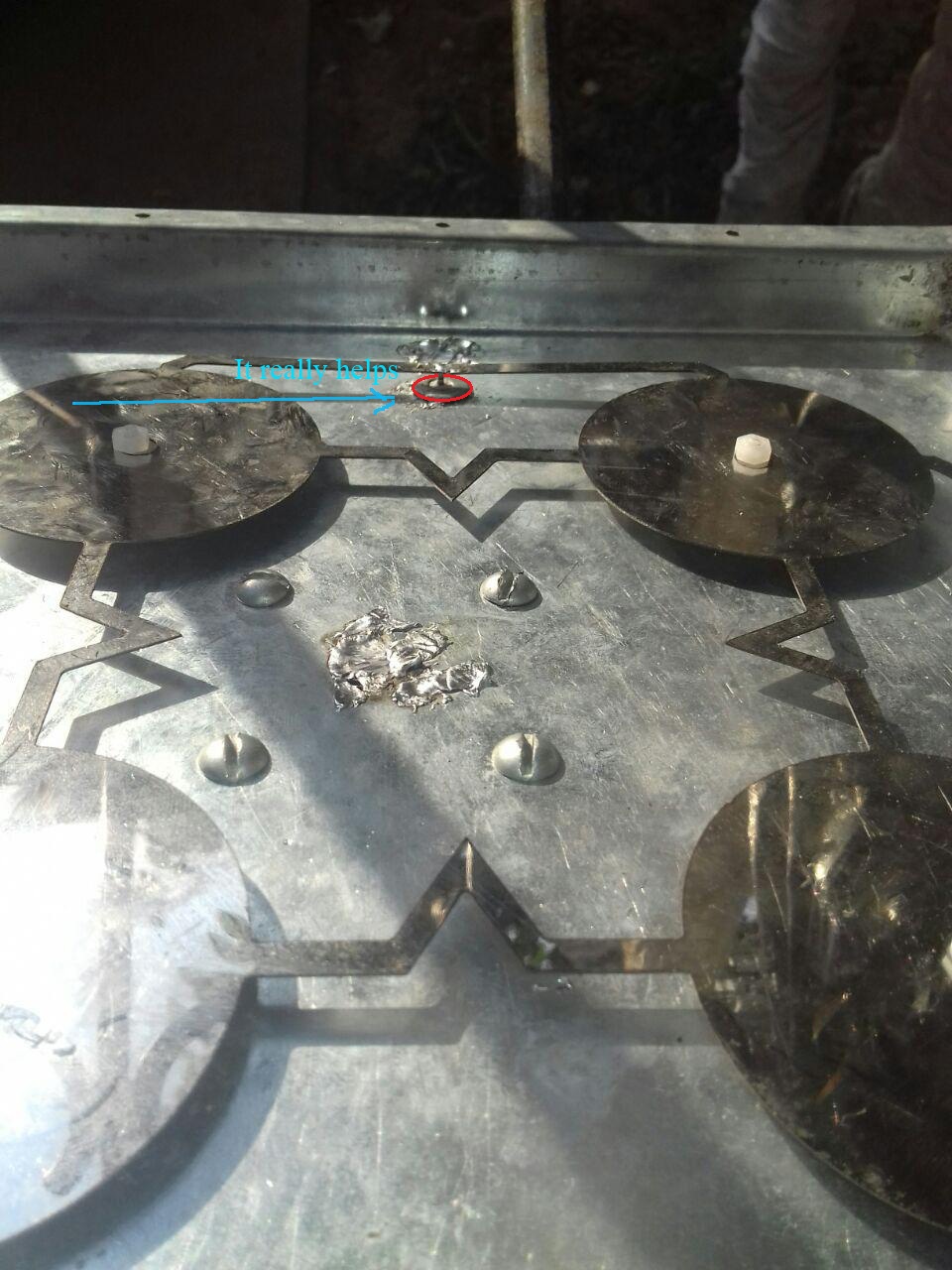

Thanks admin I am making an antenna. Can I put a piece of birch instead of a bolt between the reflector and the director? Are the bolts closed metals, should plastic?
Gentlemen, please, read this...!!!
,,,yes,you can..., bolts for screws with plastic spacers..!!!

My only available material in sheet is Galvanized Steel and Aluminum of unknown alloy but i think its 3000 series stuff.
Can i use .5 or 1mm thickness galvanized steel. Ive practiced and know how to apply the flux and core on the solder now.
Also those adaptation lines are hard for me to understand. How do i size the loop? Im also going to do the first antenna you originally made. It looks easier with less wire.
If there is that available DXF file for the CNC cut version of the first one and it works correctly can I have that?
My buddy works at Tri Cities Metal and they have access to a laser cutter he will let me use on their lunch break. Its a monster.

,,, this form of antenna does not have a good isolation between ports .... !!!
