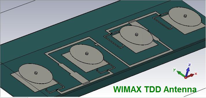

Admin, am I right? - TDD= 1 antenna connector. ..FDD = 2 connectors

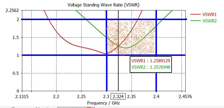

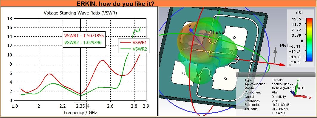

Boss, generally a great antenna, excellent data, excellent performance

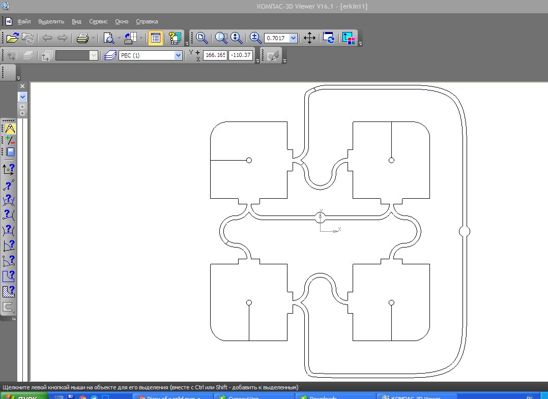

Do I send the dxf file?
Yes Yes Yes....!!!!

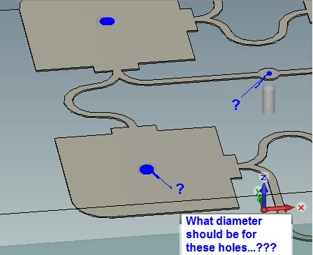

The holes at the center of how to be?
But those from sma?
sma-sma ... this company wants only sm ... I already ordered 200 pieces of sma
5 minutes ago, chilanzar2 said:
3.8mm
and for sma pin..?,,,,,
Ohh ... I again drank a lot of beer, I apologize. SMA pin-1mm, patch-screw 2.8mm

,,,I put only 4x 3.8mm on the patches

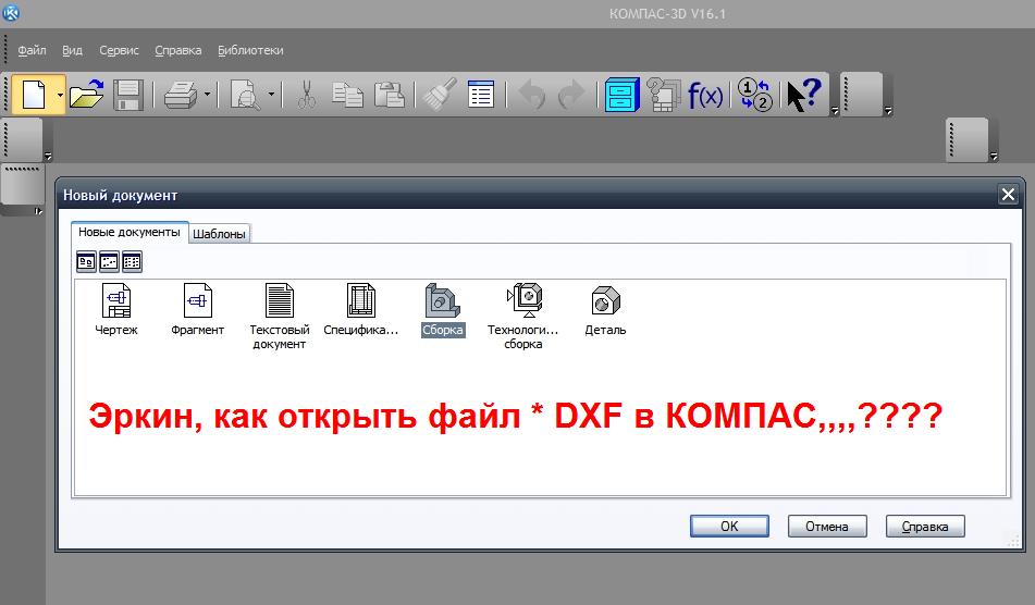

See if dxf.file works in KOMPAS
I did not think - in Europe there is beer - 2.5 liters. I'm surprised. I think Europeans drink beer 0.5L. I'll buy 10L beer tomorrow. I'll show you. Do you have 10L beer?
You can show me how my antenna looks in KOMPAS..??

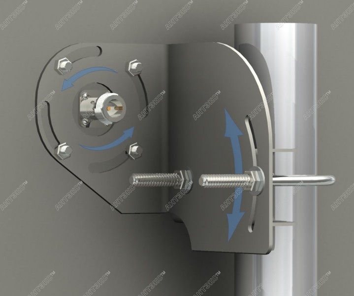

Erkin, here's a simpler support ...
Boss, thanks for the new bracket option. At the moment I work very hard, there are a lot of orders for air conditioners - the heat has come to us very strong. So he began to write a little. + 40C we have a temperature - unbearable.
