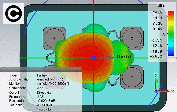

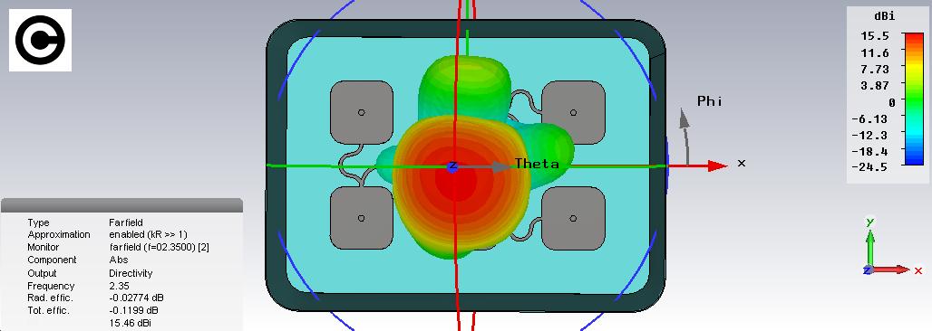

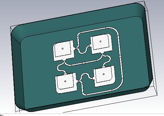

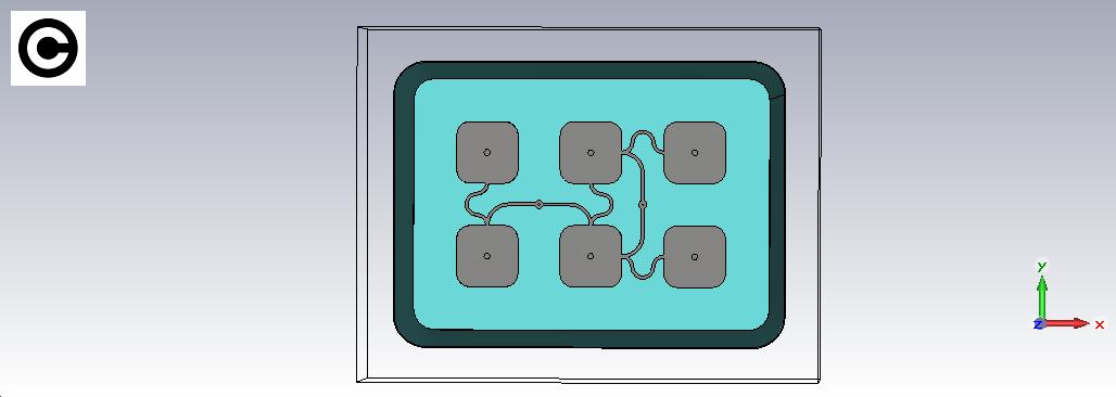

Is the same, only the height(50mm) differs ... !!
The angle is 20.55 grd
That's what it looks like,,,!!!

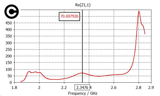

The distance between the reflector and patches must be increased,,,for good impedance

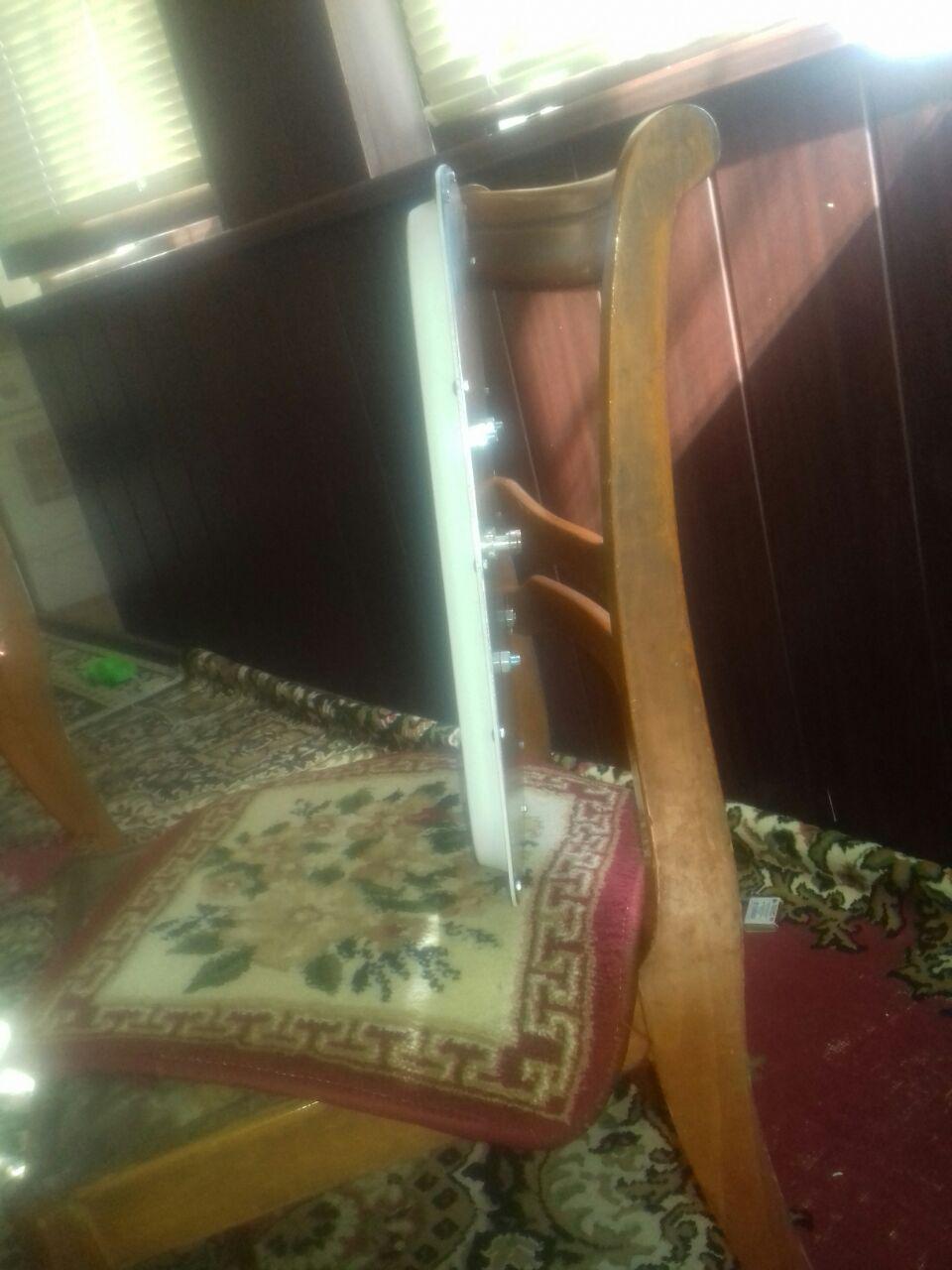

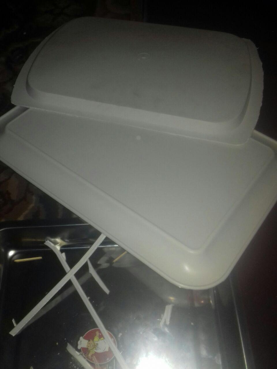

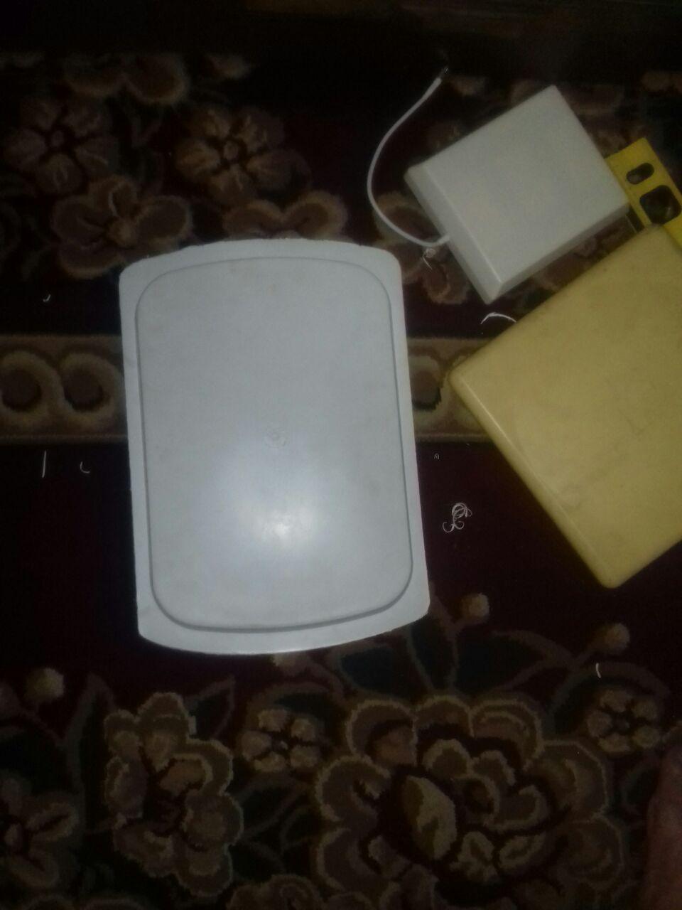

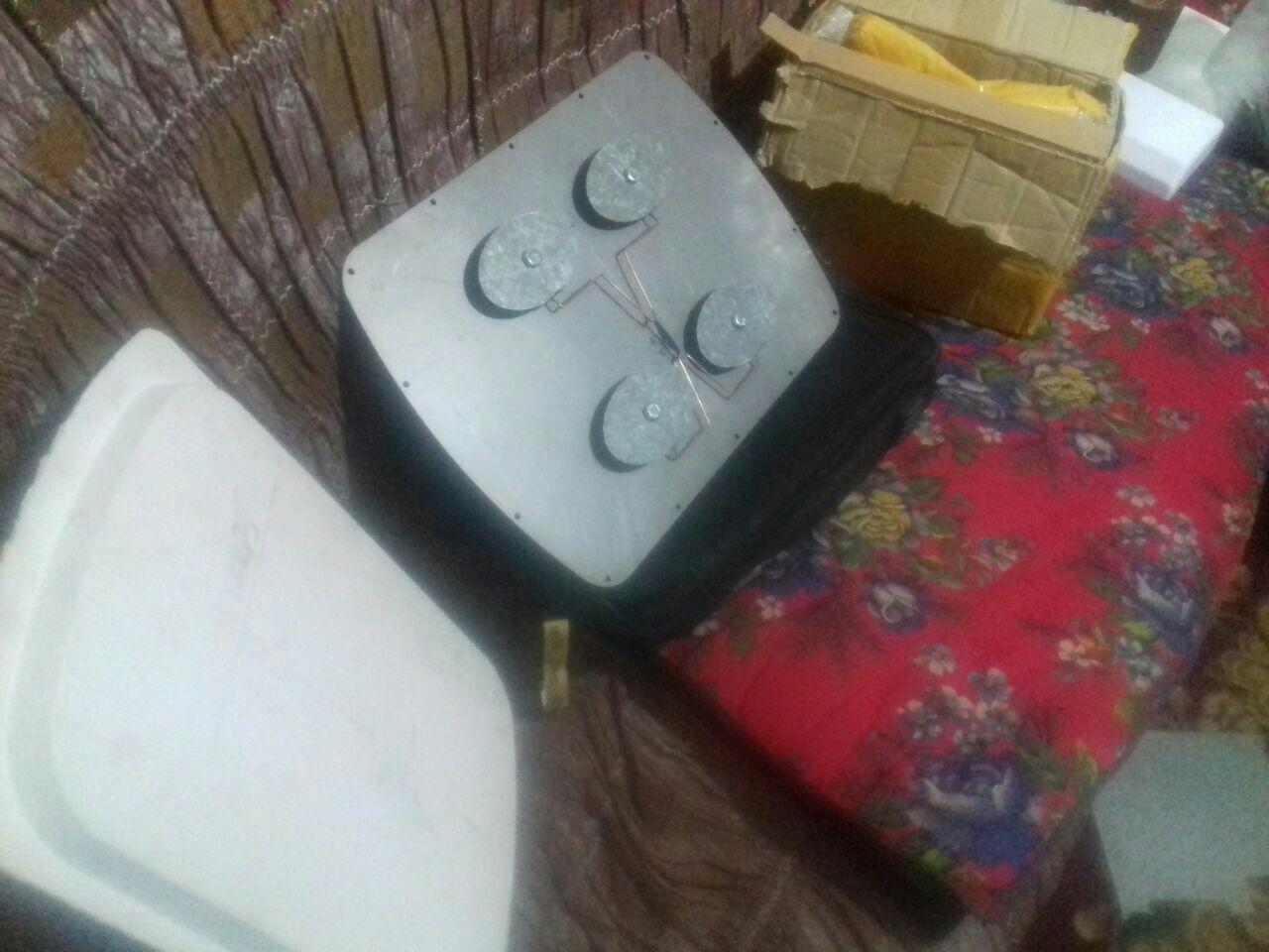

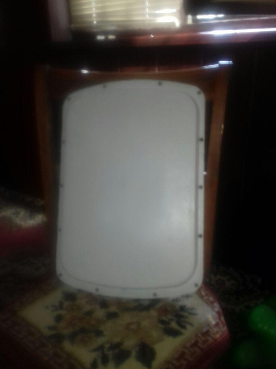

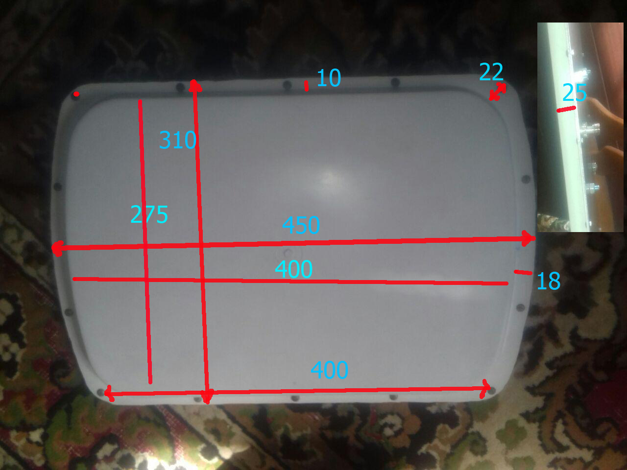

I found it ready yesterday ... in a plastic factory. Of course, the size is large, but this plastic patency is very similar to the antenna casing

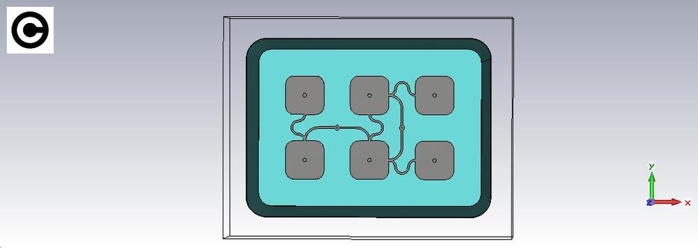

Jomy, from now on I will make all the antennas under this size. Of course, the size is a little big, but, as a factory execution.

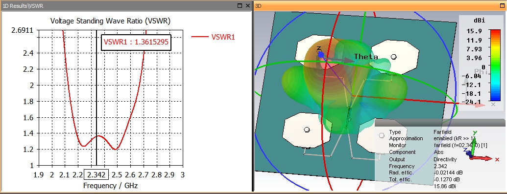

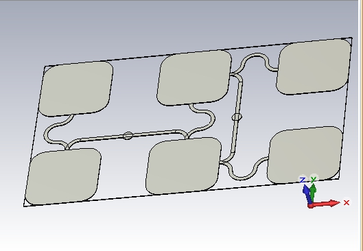

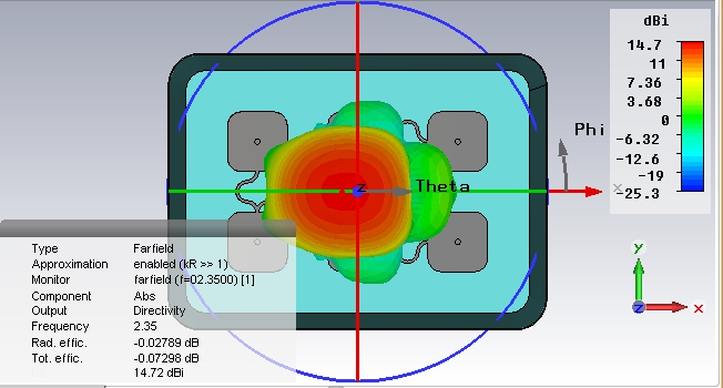

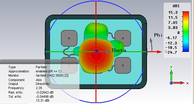

Is there a possibility in this 6-patch version, an additional, to combine wi-fi 2400?

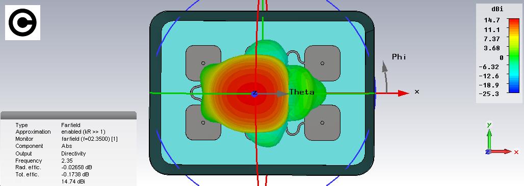

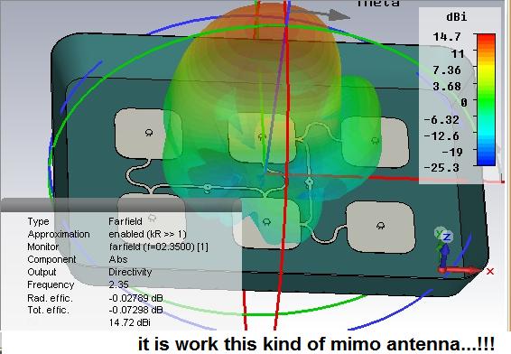

An animation with the antenna to which a director has been added

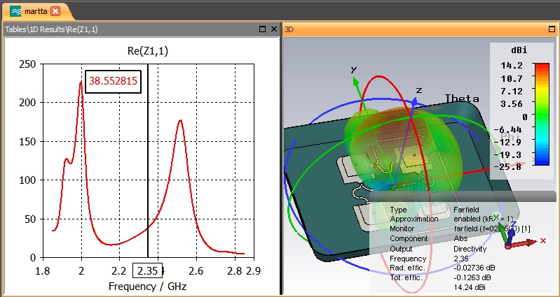

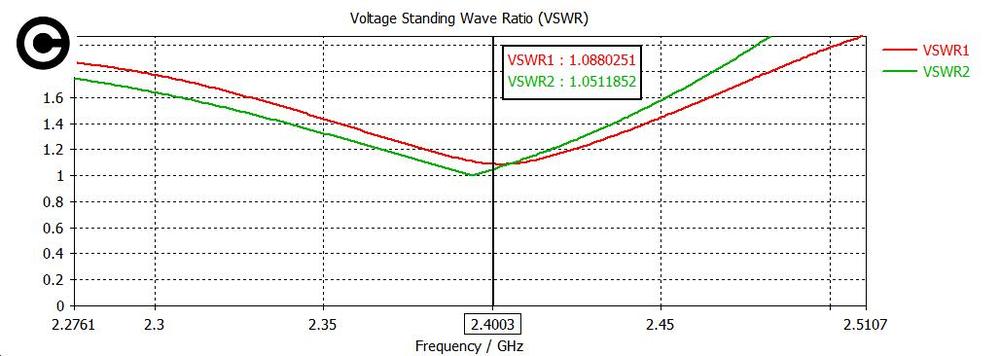

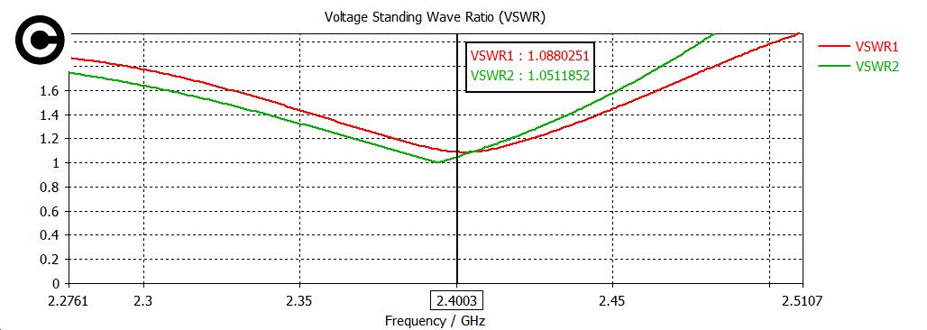

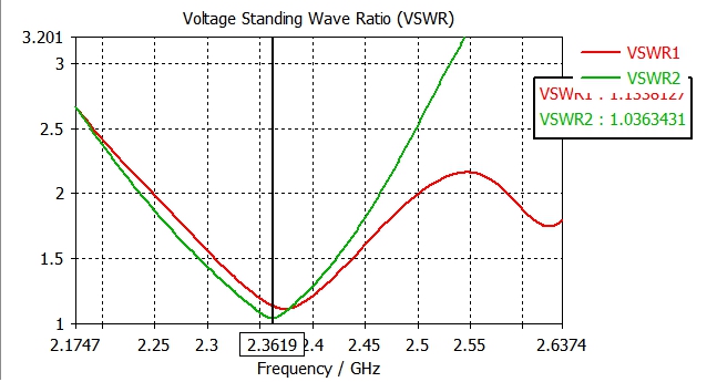

Impedance
Look what I found - now, our antenna looks like factory - Antex, Bester, Kroks, Gellan. The finest I have found, you will not believe-it costs 60 cents

Well, then why did you make such an antenna with elliptical patches?
3d antenna was needed - I made this antenna. There were no other options. I was very worn out with manual work.
