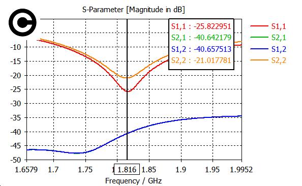

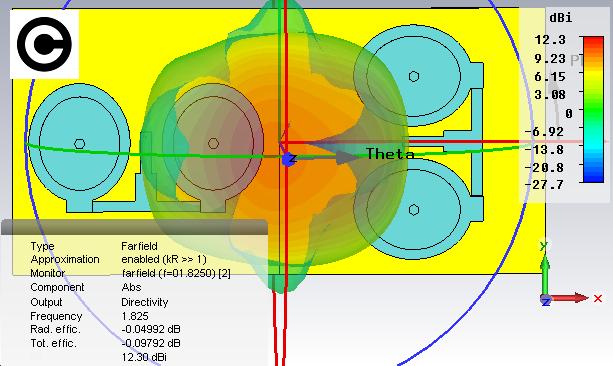

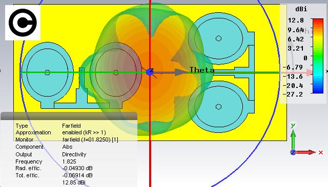

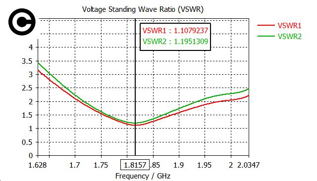

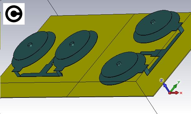

Yes, this is the best option for connection with pin connector. But,  gain- 10.5 dB.
And the first picture of the gain  12.

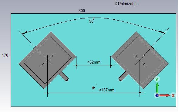

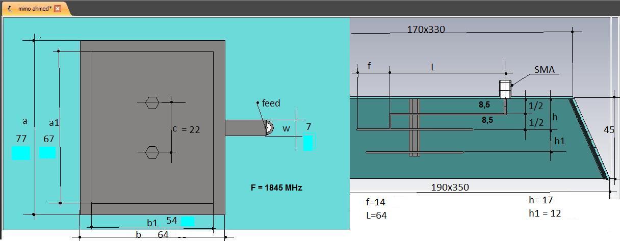

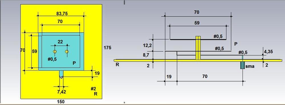

Jomy, if I reduce the size by 0.5 mm , then the dimensions of the patches are tuned to 1870 MHz
what dimensions do you mean?
", if you want to turn the antenna to another higher frequency, multiply all dimensions with a factor k=1825/1870=0,9759

  1. кроссполяризация 27.7 дБи , это же мало, или не мало ?
«Где ты это понял?»
с правой стороны написано цифры, внизу, указано 27.2 . Это не так?
,, the numbers are written on the right side, 27.2 is indicated below. This is not true?
08.09.2017 в 8:15 администратор сказал:

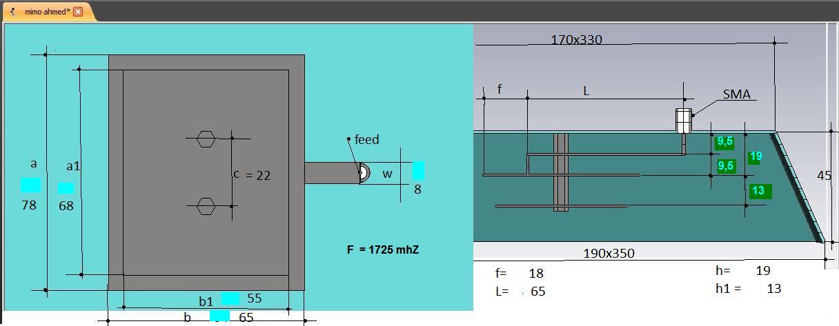

Эркин, размер антенны ,,,
Эркин, это два типа антенн для двух частот с их соответствующими размерами ,,,

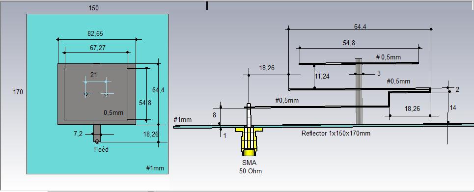

Dimensions are correct 1845 MHz f=14 L=64,1725 MHz f18 L=65 ?
, not only the dimensions of the patches, but also the distance between the reflector and them...!!!
1845 MHz f=14 L=64,1725 MHz f18 L=65 vice versa 1845 MHz f=18 L=65 1725 MHz f=14 L=64 ?
5 hours ago, Admin said:
Я не понимаю, что вы имеете в виду ... !!!

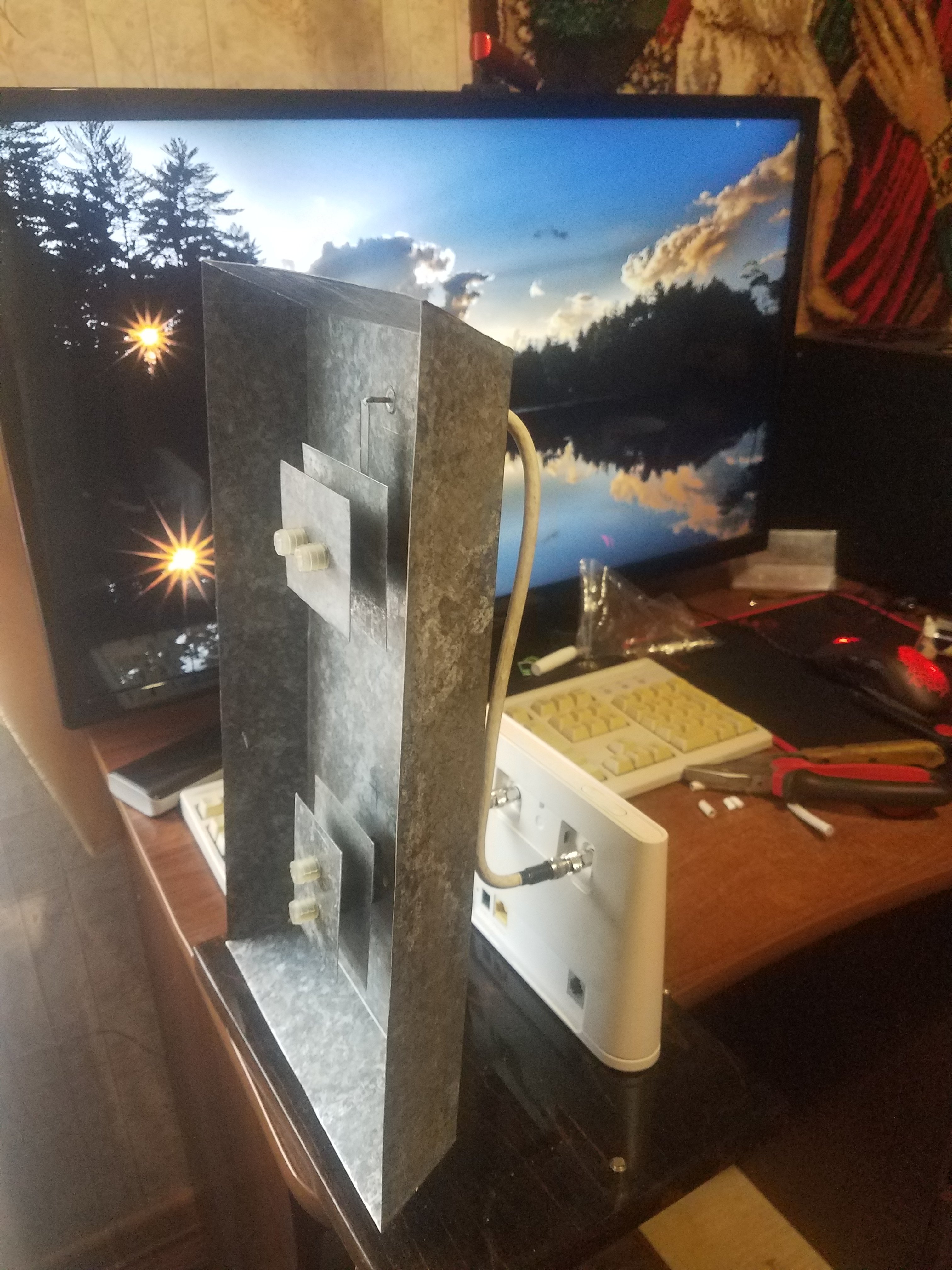

Sorry, I just confuse the sizes and frequencies, I'm doing textolite tubes now, when I do everything and insert the pictures.

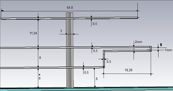

,,, a variant with more exact dimensions ... !!!
", and if you want a cross-polarization  you can use this solution...
Many thanks to the admin for help :) when there is time I will make it easier on the first page!

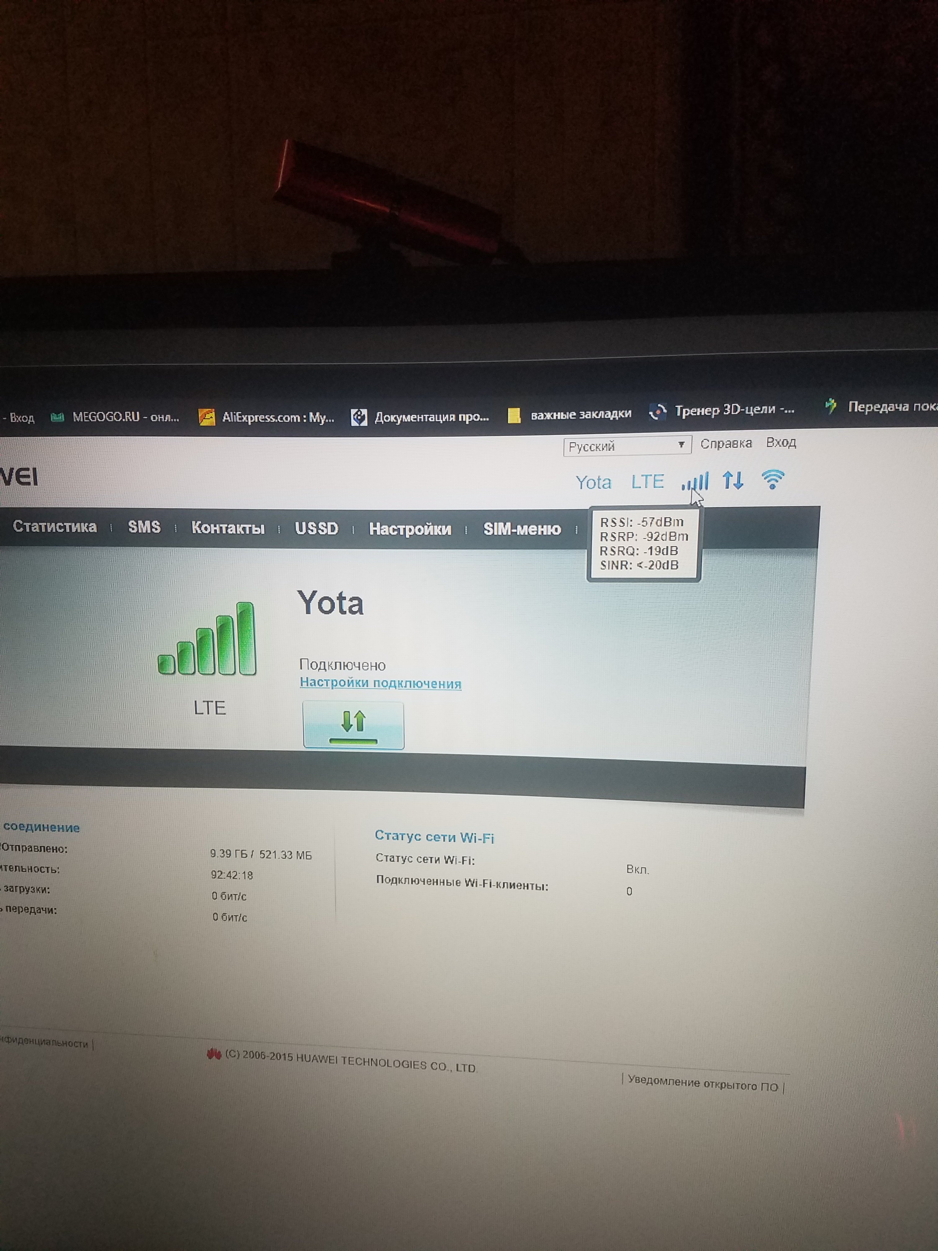

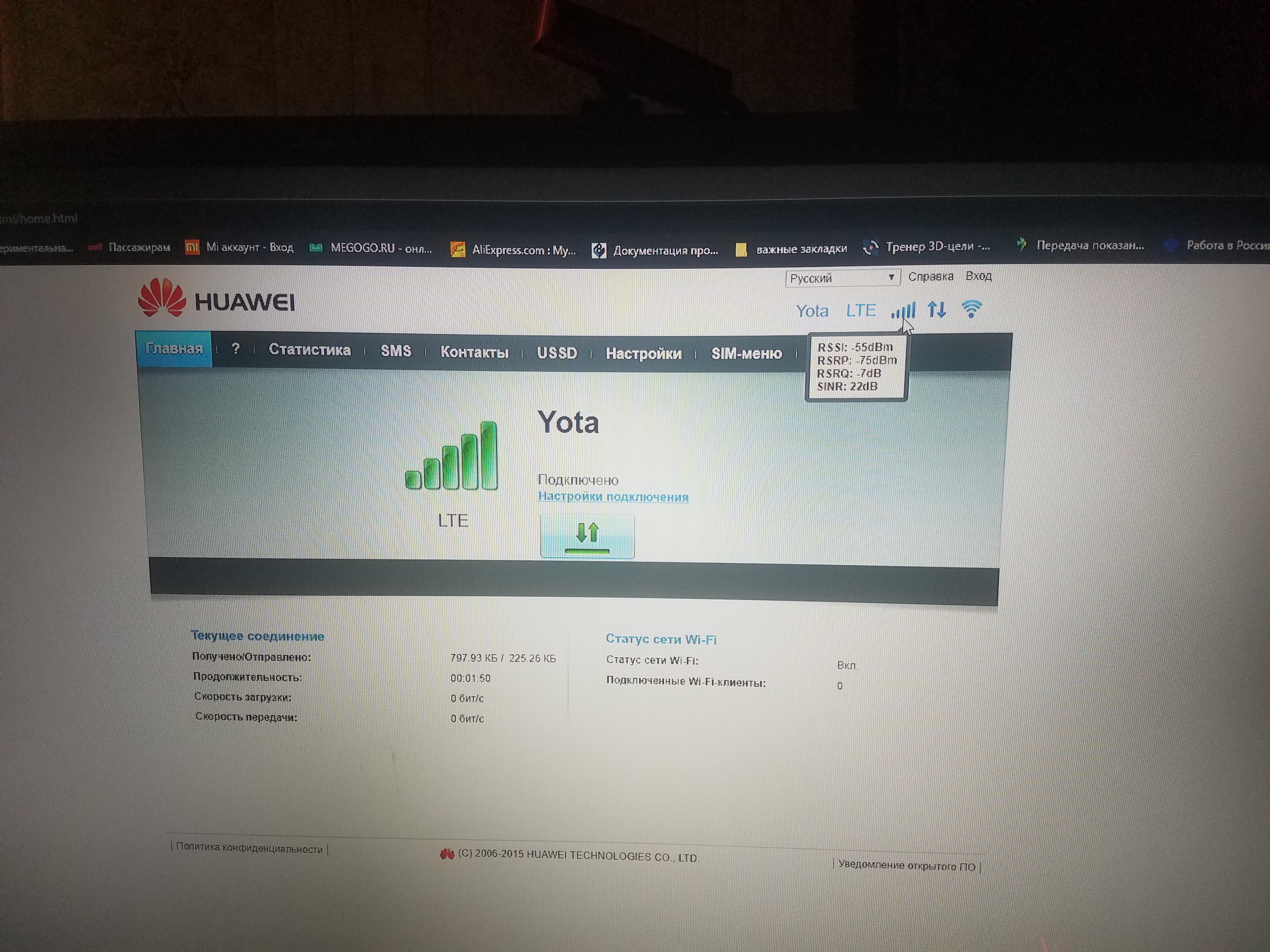

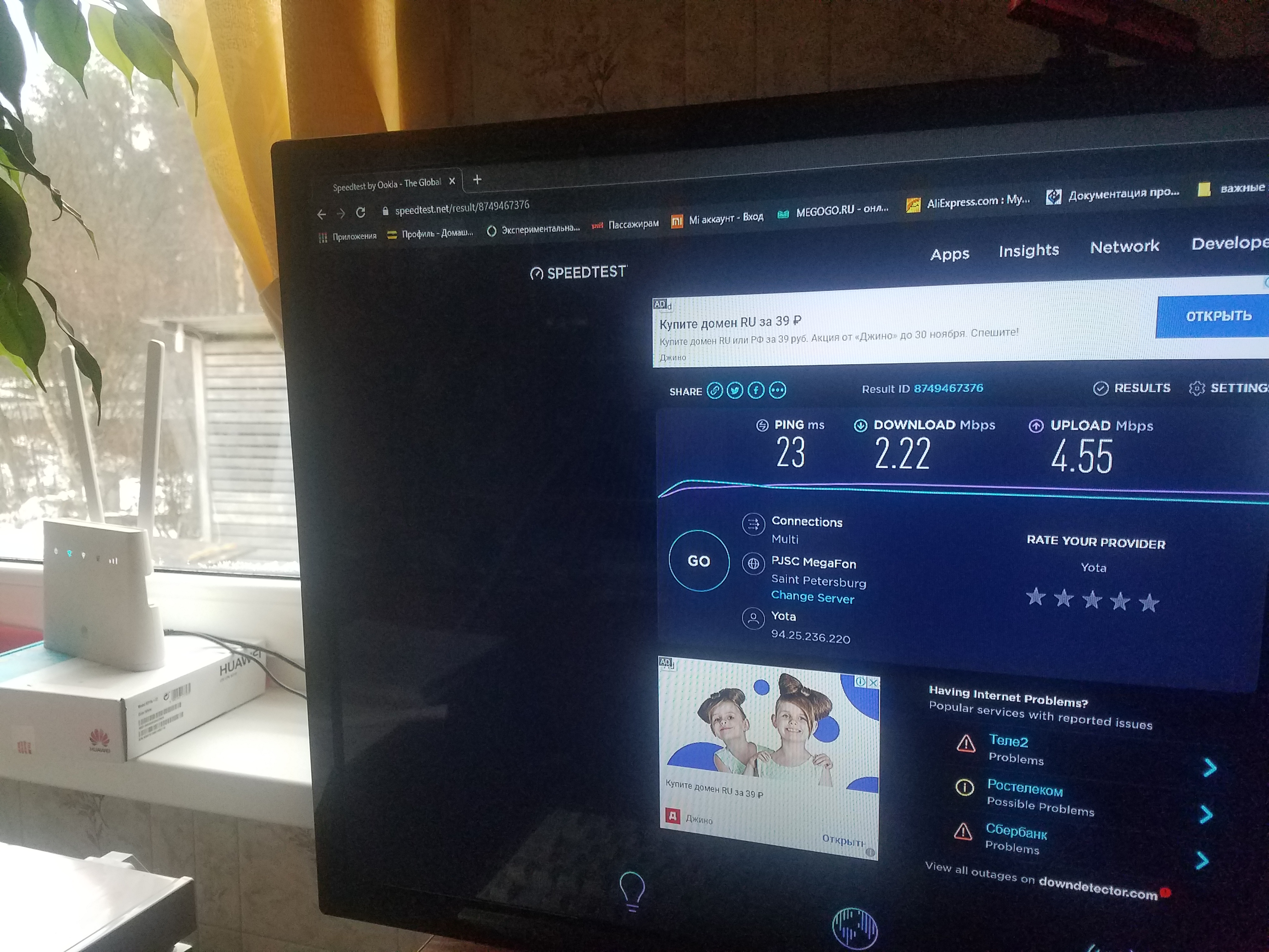

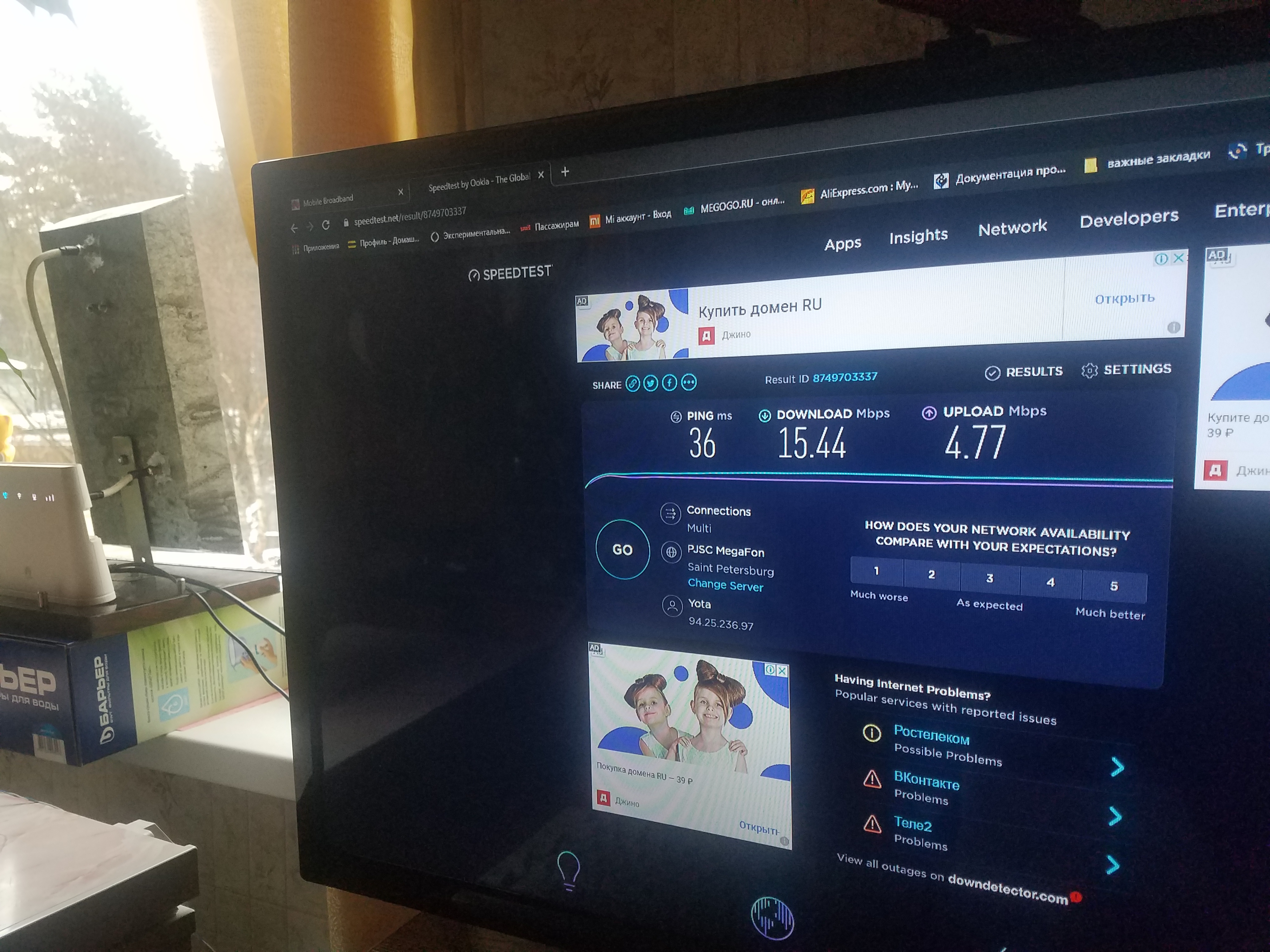

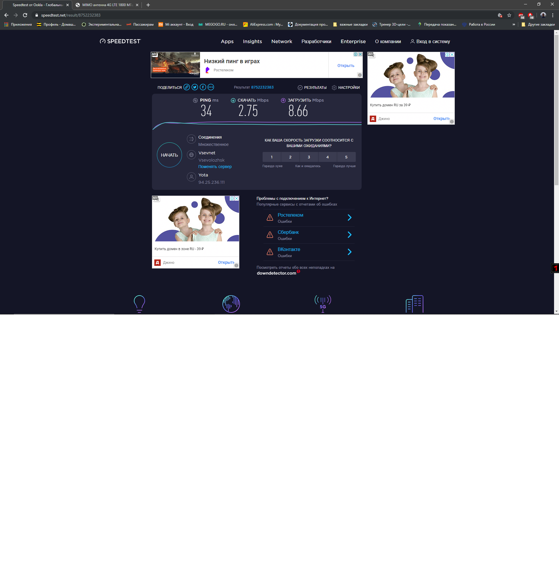

,,,download(DL) it"s verry good but why upload(UL) it"s poor...???!!!
GSM/LTE 1800MHz
    UL=1710-1785MHz
    DL=1805-1880MHz
    Fm=1795MHz
