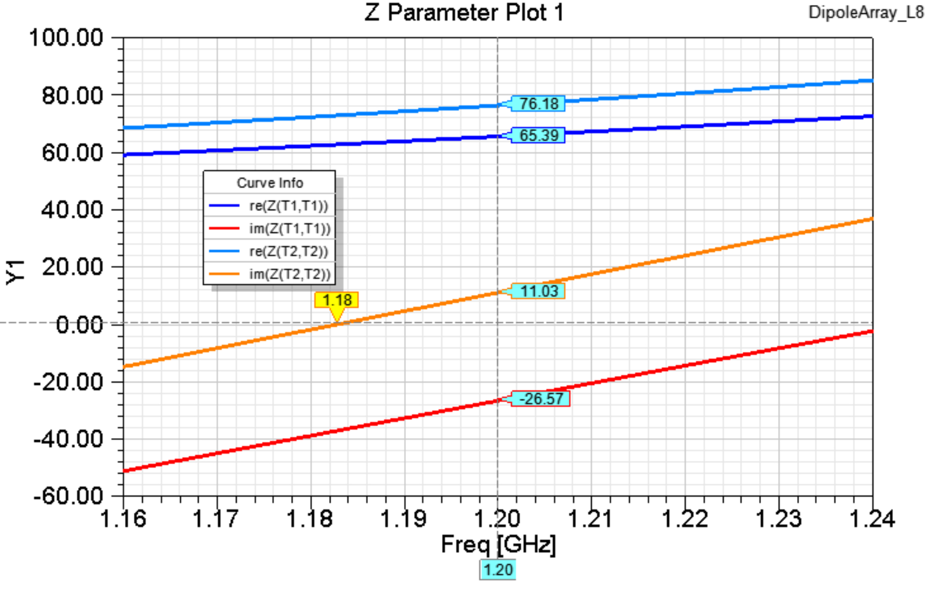

Admin, is there an ability to create multiple plots in CST 2019? Some ones like in HFSS:

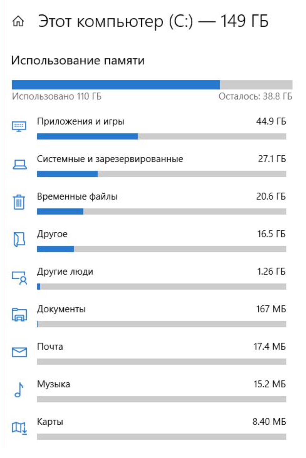

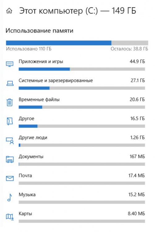

No, I have not yet. I need free up space on disc C. I have only 38 Gb available, 2019 require 30.... We use to say: better is the enemy of the good. I’m still in doubts :(
,,,, but what is the size of your HD, maybe you need to make a repartition...!!!

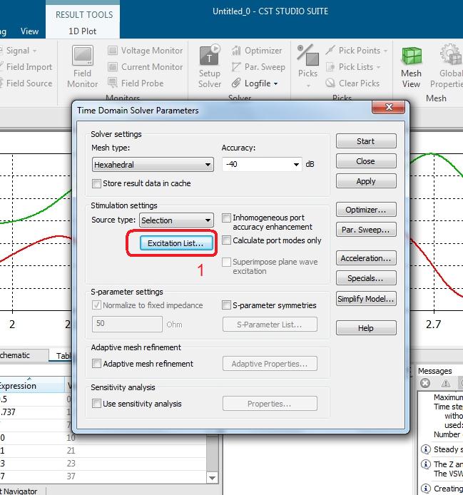

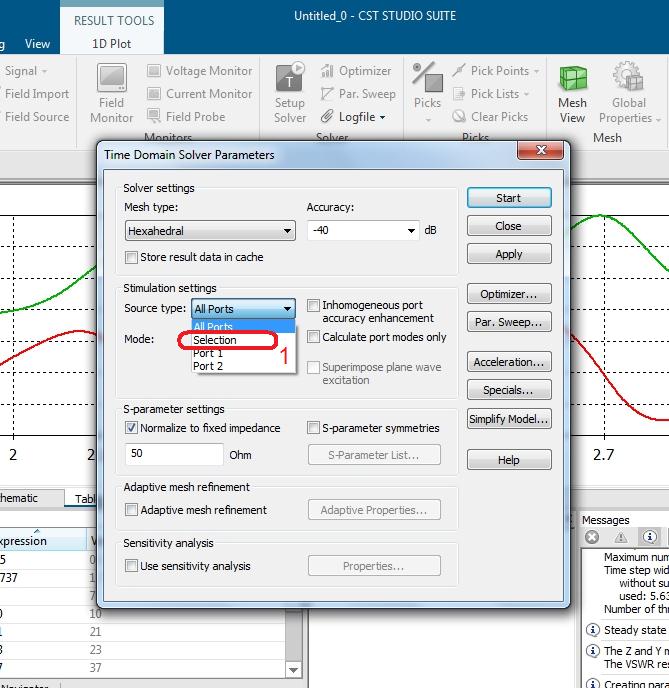

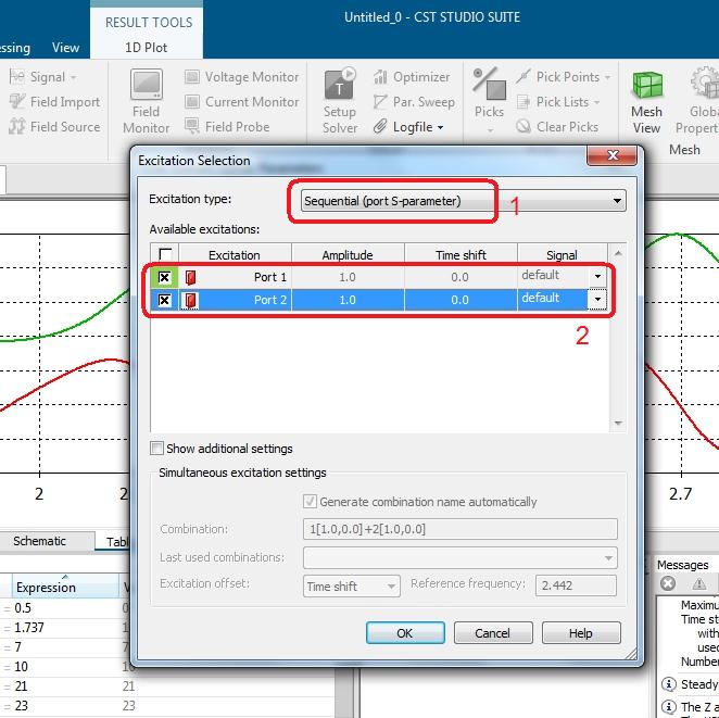

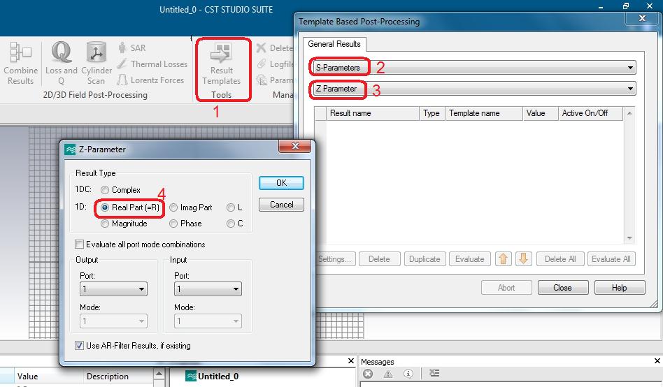

Vman, for the creation of multiple ports, I hope to help you, these...

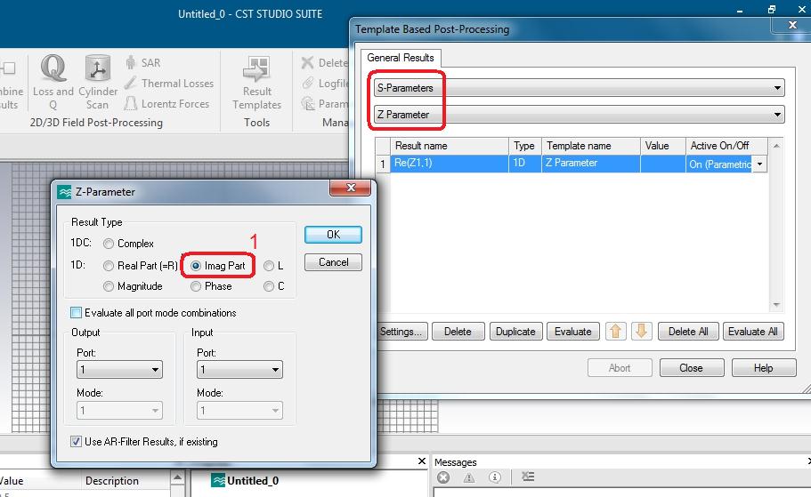

Jomy, it is not clear how to make one plot for Re&Im. But S parameter goes automatically in multiple mode, when there are 2 and more ports. May be I missed something?

No. I’am dreaming of new comp. And I ask, if it is possible to make one multiple plot for Im & Re in CST2014?
Of course,,,see google search...!!!
