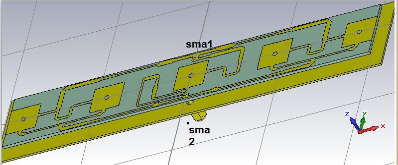

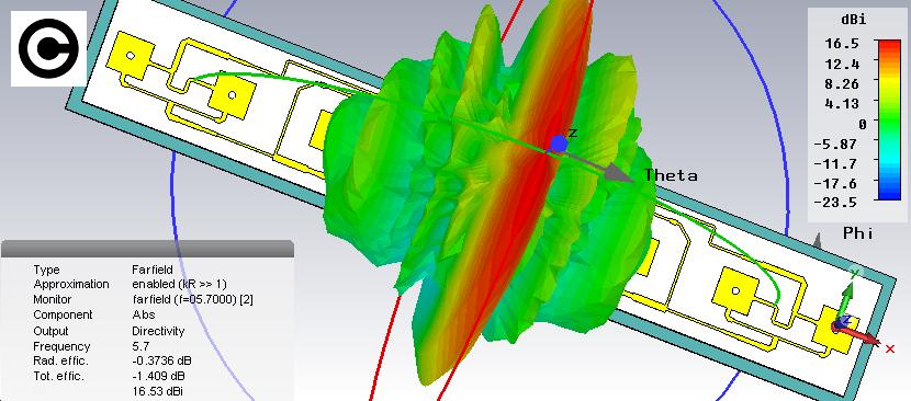

Yes, I think it is good antenna, but for 5,7ghz
  and without directors
yes dude i use 5.7. saving me from intervensi

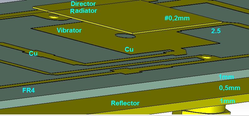

,,, DC13th, send to me and the *igs file with the 8 directors...!!!
DC13th,tell me, the vibrators are 16x16mm and the directors have the same size at the 2.5mm height in the air...???
yes same size, space 1,5 and pcb thick 1mm

buddy, the antenna also has directors ,,, ??
which is the distance from the reflector?
what PCB does it have?
1,5mm from reflektor
2,5 from director
director is same size
11 minutes ago, DC13th said:
Copper PCB
PCB FR4 #1mm...??
