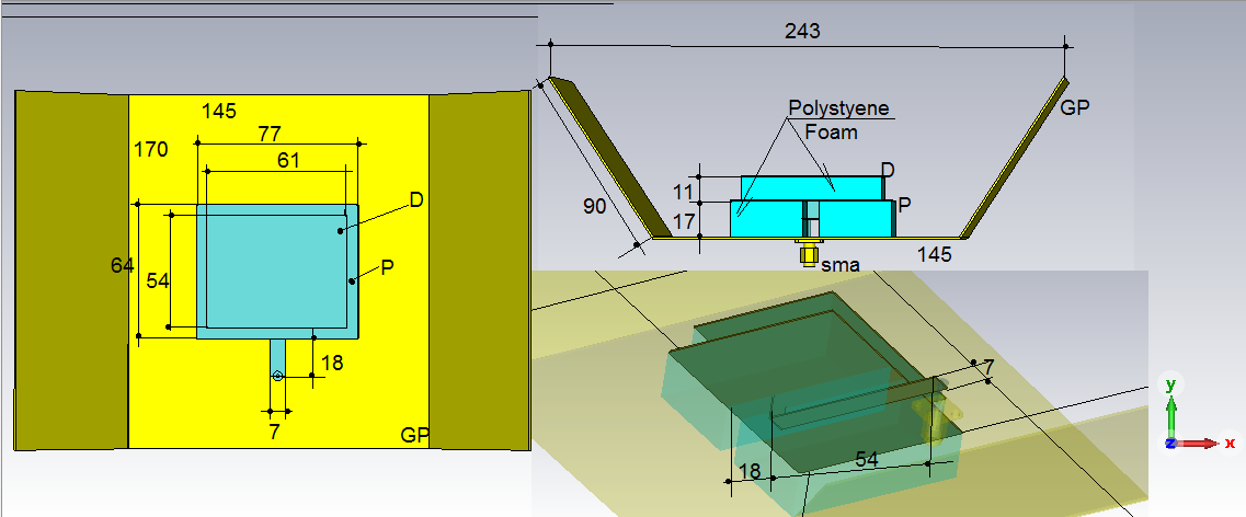

,,, for offset dish, I think this is better...
like that design, looks not too hard to make, is that an active element plus a parasitic ?
forgot to mention, the dish measures 60x66cm, the widest size is on the vertical axis, just a regular satellite tv dish

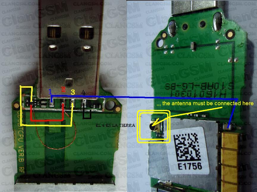

its a huawei E1756 , it has a single U.FL (or at least it looks like it) port for a external antenna. and im worrying a bit about how im going to connect my antenna to the dongle. thinking about desoldering the U.FL port and soldering some small diameter coax straight to the board.

,, try to open your huawei E1756 modem to see where the inside antenna is...!!!
already did, its between the usb port and the rest of the dongle. right next to it is a U.FL female connector. i got to say, cant find the copper trail that connects to the internal antenna.
I would feel more comfortable soldering the antenna wire there where the U.FL connector goes. i would need to desolder that connector first and then solder some thin coax wire straight to the board.

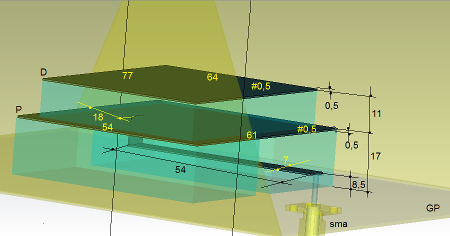

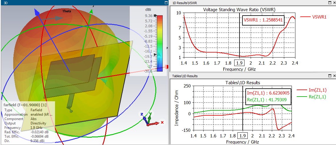

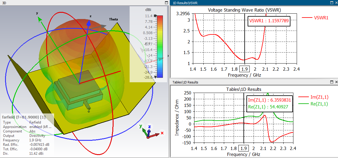

,,, these are the promised dimensions ... !!!
Thanks a lot, the dimensions are in Milimeters? also, thats a 45 degree bend on each side of reflector ?
,,, yes, the foam is dielectric and the dimensions are in millimeters...!!!
