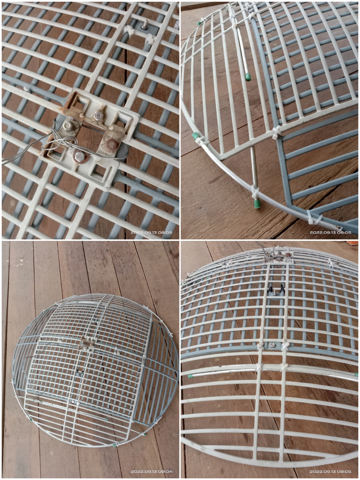

Joining of 2 grid reflector parabola to be 1 reflector parabola to reach maximum receiving signal .
Diameter is 1.2 metres

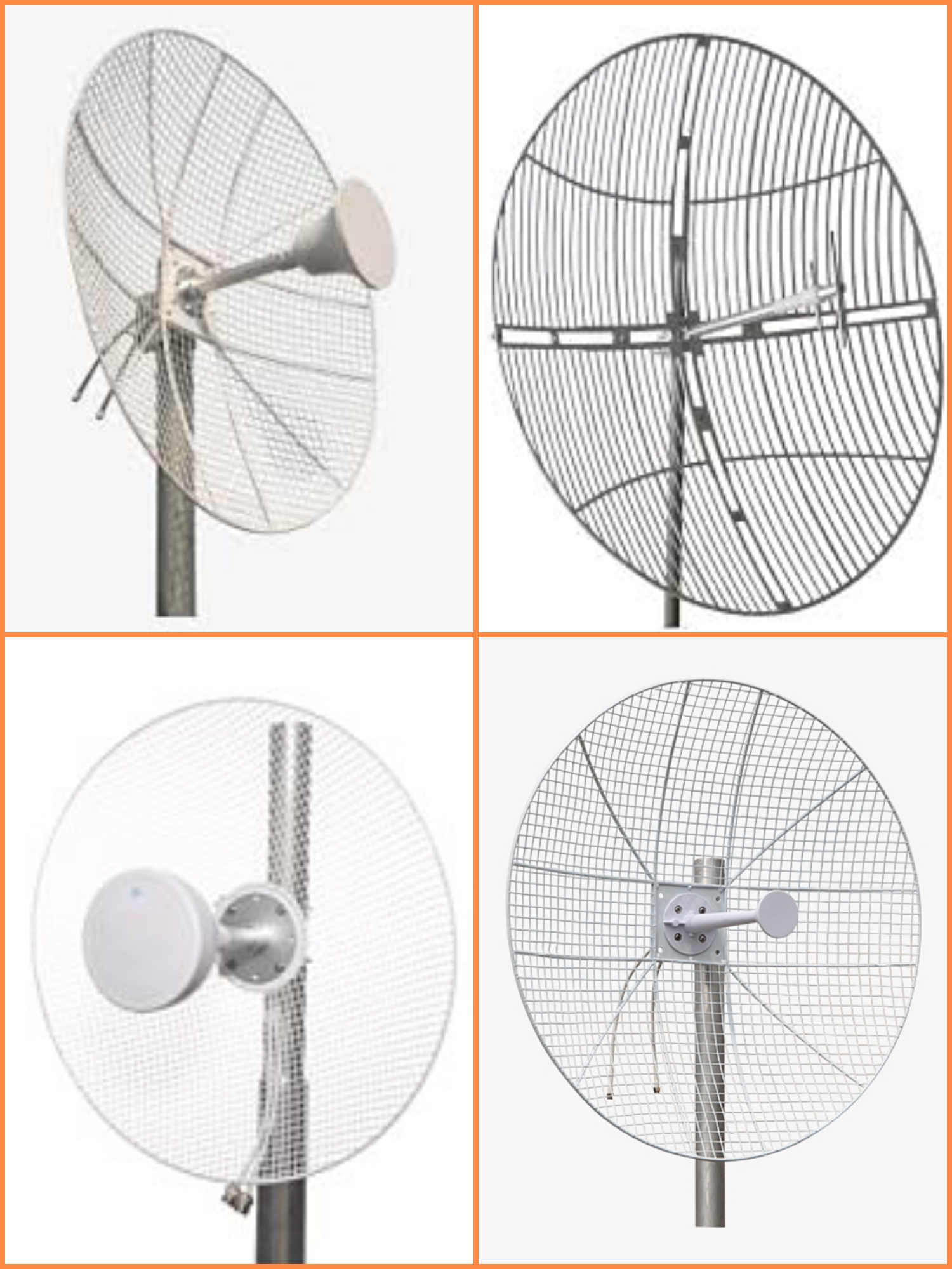

Wire mesh like these?
thats the andrew mcneil style:

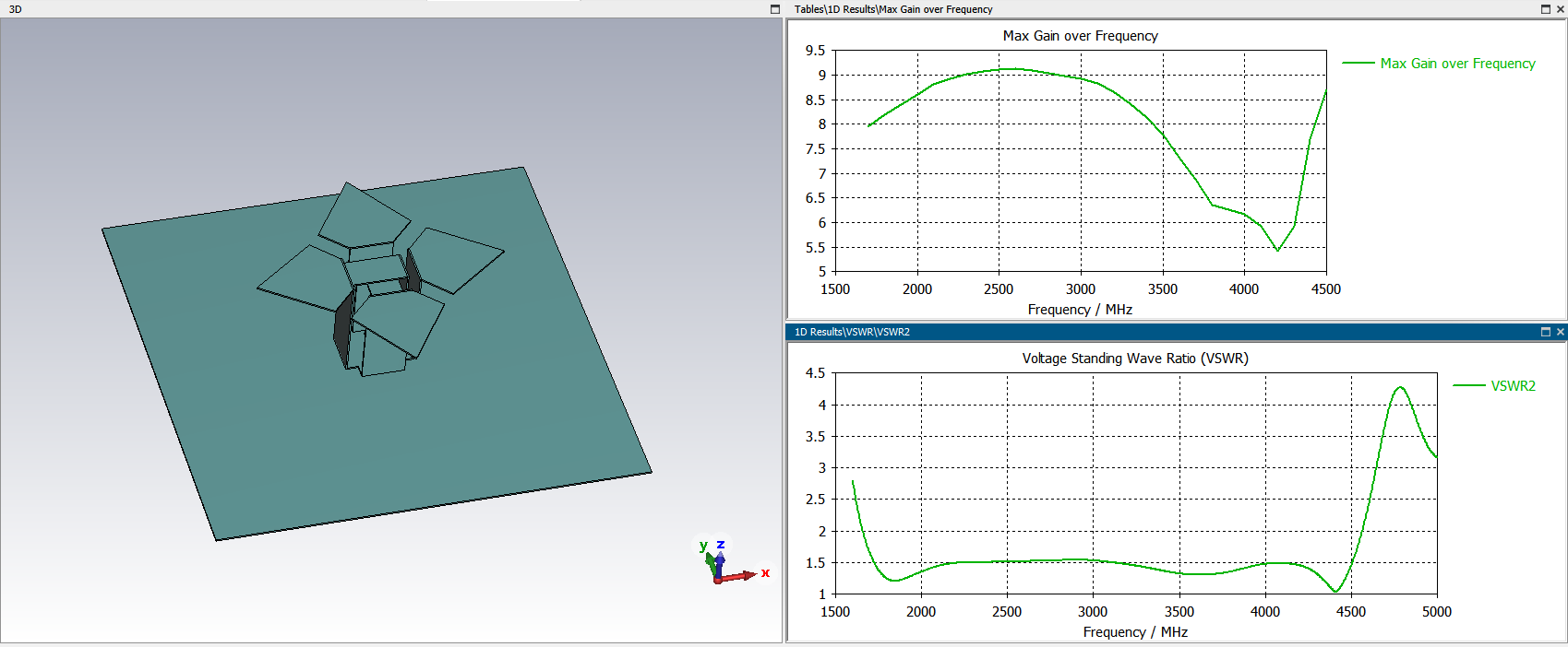

Is there CST file?

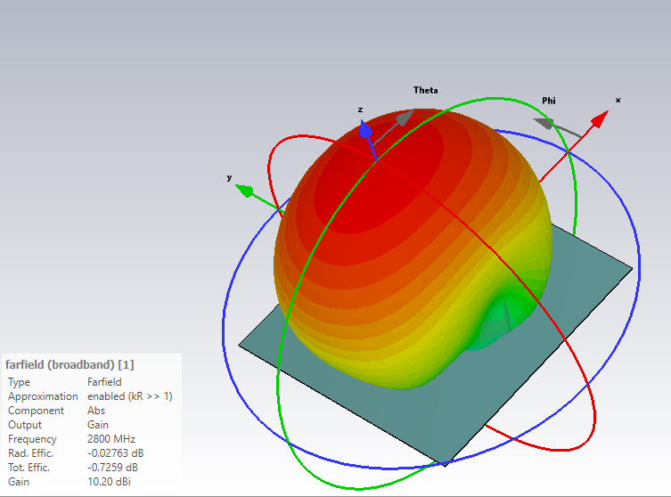

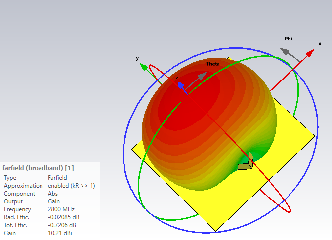

This ring works as a director or as a fresnel ring (assuming that this cross dipole is normally located in the cavity chamber)?
