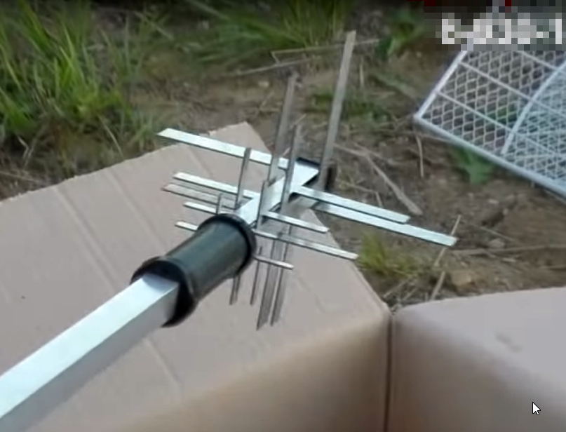

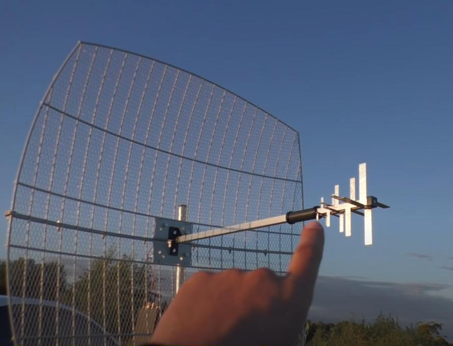

I watched the video on YouTube, test different antennas. The guys showed a new parabolic antenna feed. A very interesting design! And easily repeatable at home.
I understand it is based on Log-periodic antennas?

I like it...
the fine mesh wire makes it work as a sheet metal reflector...but WIND LOADs are bigger...
we need to get the dimensions for the LogPeriodic feed...

I meant the antenna feed itself
3 minutes ago, jnkwqlqn said:
LPDA feed, laser cut.
Of course....!!
But you have to watch the impedance! Is there anyway to calculate impedance for LPDA boom distance in CST, etc?
Yes...need LOGPERIODIC and reflector data...

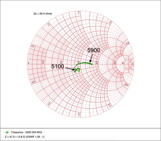

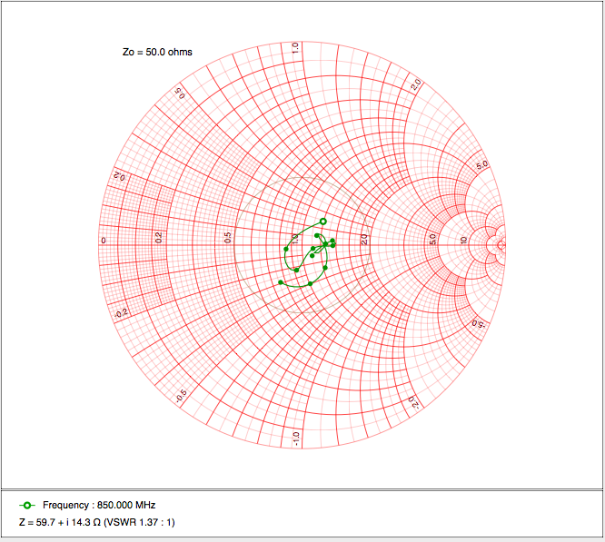

To continue on the LPDAs, there are a number of interesting PCB antennas by Kent Britain WASVJB: https://www.wa5vjb.com/products1.html

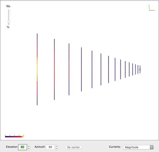

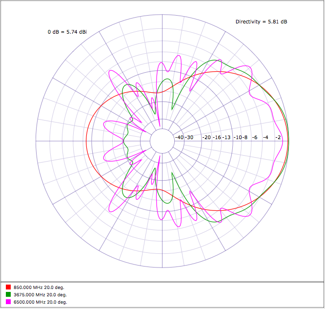

I tried to simulate that one at 850-6500 MHz band range with CocoaNEC (no Windows here, sorry) using the method described at https://hamwaves.com/lpda/en/index.html, and eventually reached similar parameters, but my antenna is definitely larger. For 850 MHz the λ/2=17.64 cm, so I'm surprised how WASVJB was able to fit it into the 13.4 cm PCB.
For the simulation I've set tau = 0.85, sigma = 0.12. Element to element transmission line impedance is 75 Ohm. All elements are of constant width 0.16 mm.
Exact location of the elements is as follows (all dimensions in meters):
Spoiler
 WIRE      OFFSET     LENGTH
    1      0.0000     0.0882  <- quarter wave of 850 MHz, must have two of those

Simulation data:
Spoiler
EkzbPy8WAAMv7Yc?format=pngEkzbDn2WAAc330v?format=pngEkzcw2kXUAAdGGT?format=pngEkzc6y_XUAExxv_?format=png

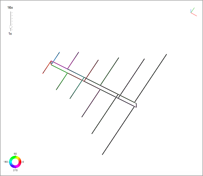

To design something more or less practical, I've put a model for dual-band LPDA for 2.4GHz and 5GHz WiFi into the cocoaNEC. The antenna was designed to be buildable from a copper wire S = 2.5 sq.mm, d = 1.7 mm. All other dimensions including distance between feeding rods (the boom) were optimized for VSWR using stochastic gradient descent. The antenna is matched to 50 Ohms symmetrical input.
Both the NEC cards deck and the cocoaNEC SGD code are available. Please note though, to build this particular antenna I've added 2.6-4.9 GHz band-stop "virtual filter" to prevent SGD from optimizing for the non-interested bands. As a bottom line, it was calculated for 2.2-2.6GHz and 4.9-6 GHz. Considering the WiFi bands only, max VSWR is below 1.4 at 5875 MHz and 2485 MHz.
Simulation data:
Spoiler
EmXzgoiXMAAKXzB?format=pngEmX0VpaXUAUkL4Z?format=pngEmX0ZrPW4AEFBuP?format=png
Azimuth (horizontal + vertical polarization):
Em5tFL7XYAEPP29?format=png
Elevation (horizontal + vertical polarization):
Em5tJJdXYAE5uzP?format=png
