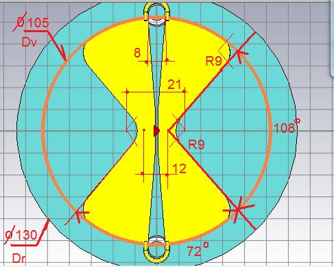

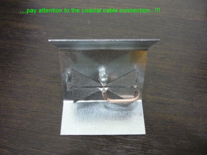

On 5/29/2020 at 0:08 AM, Admin said:
... wouldn't one be better than this ... ???
,,,a good antenna for parabolic(offset) dish....!!!
That would be the geometry of the antenna....

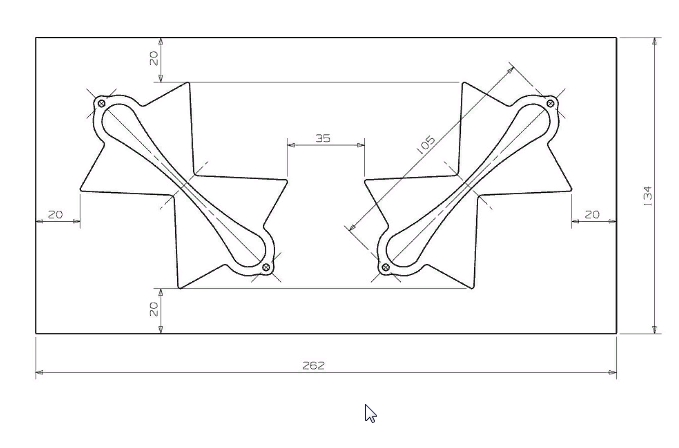

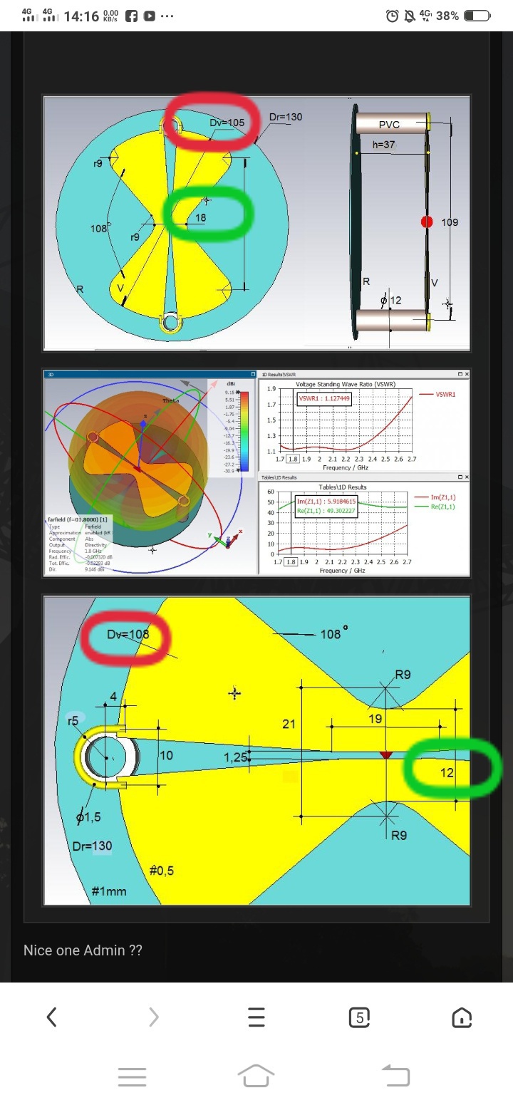

Is it possible to be a MIMO?
,,, maybe only so, for circular polarization...
,,,but with other dimensions...!!!!

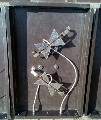

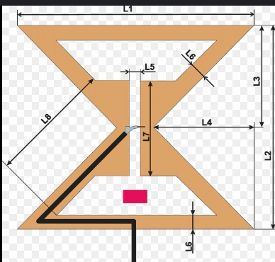

On 5/25/2020 at 7:46 PM, Admin said:
,,, okay, something like that you can build ... ???
,,,, after the simulation I will send you the execution dimensions...!!!
Admin May i have this also.. ?
8 hours ago, Admin said:
,,,later...!!!
Ok.  Thanks in advance..

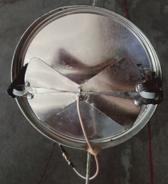

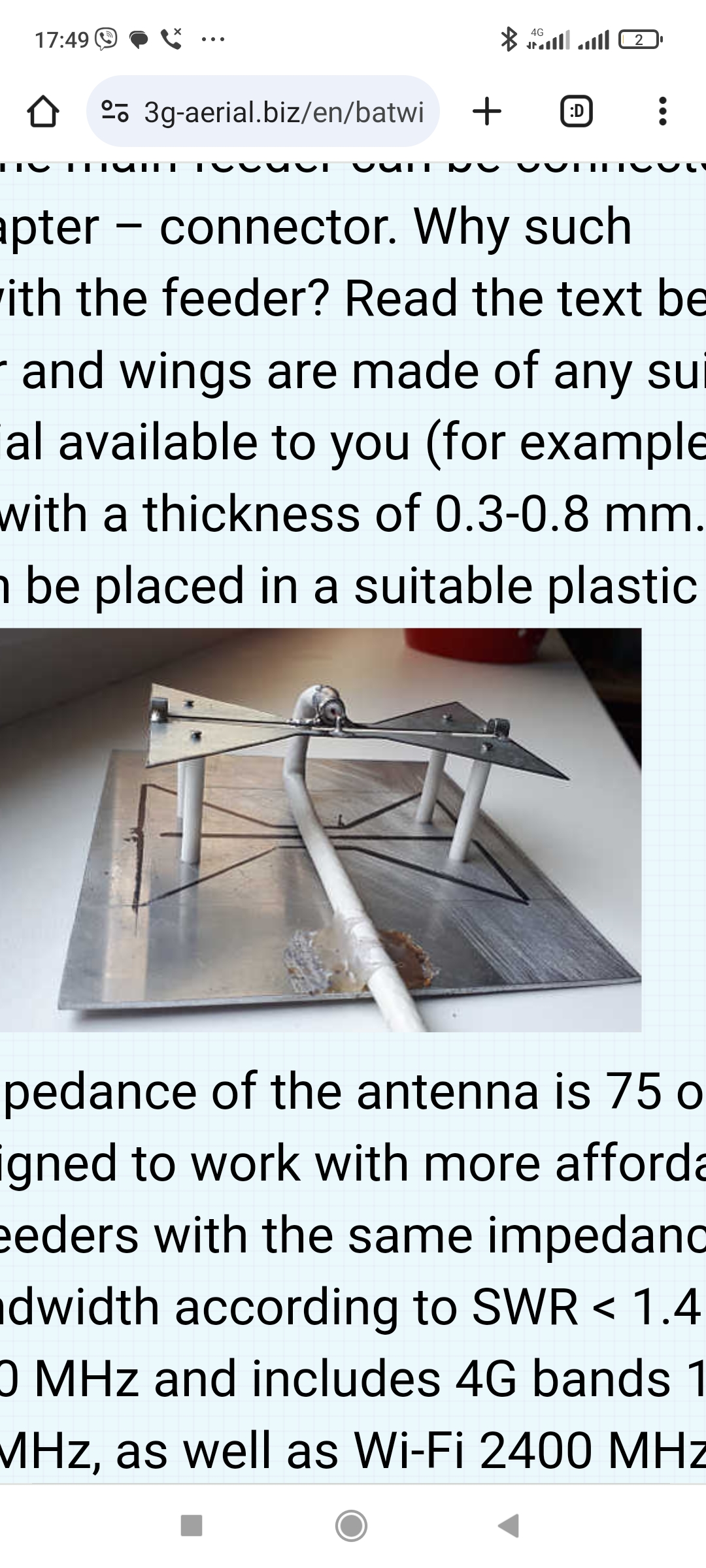

hi admin, please simulate this antenna, because at my place the signal reception is pretty good.
,,, here is not the place for such a thing...!!!
