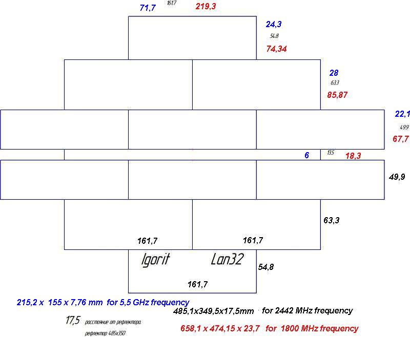

yeah , it's easy with the model....pretty sure you are gonna end close to 1 meter by 60 cm or more GRILL...
,,,the Curtain panel antenna for the frequency of 1800 MHz is excessively large (658x474x24mm)
Conclusion: panel antennas Curtain is good for 5 GHz frequency, take parabolic antennas with an irradiator for 1800 MHx frequency.

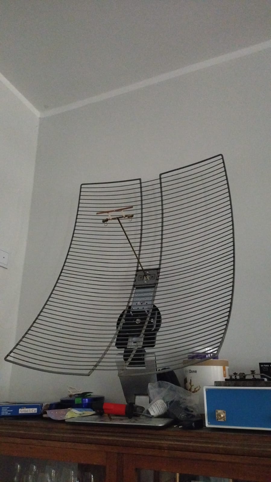

It's a shame, it's very simple...and yes, they are right...but what can I do?  I live in a region with a lot of air and there is no signal below 5 meters. I cannot raise such a large dish to more than 10 meters without having to invest a lot in a good mast. What options would there be?
"""" I live in a region with a lot of air and there is no signal below 5 meters."""",,,,,,this is a shame...!!!!
I think I will continue trying with the Yagi....??
920cm pacyfic grid atenna with dipole feed (with coaxial splited balun and one reflector) will give You 19-22dBi, adequat Yagi will be 2m long and and should be carried out with great precision (+/- 0.1mm)

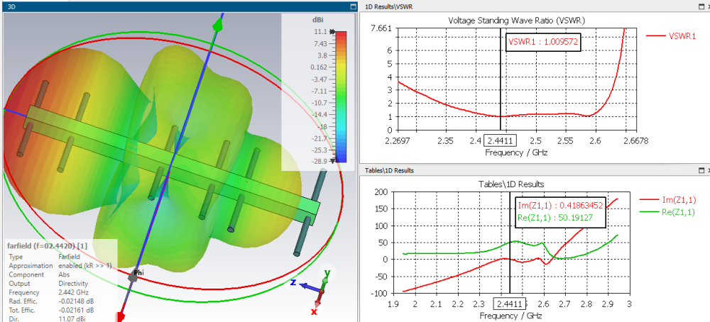

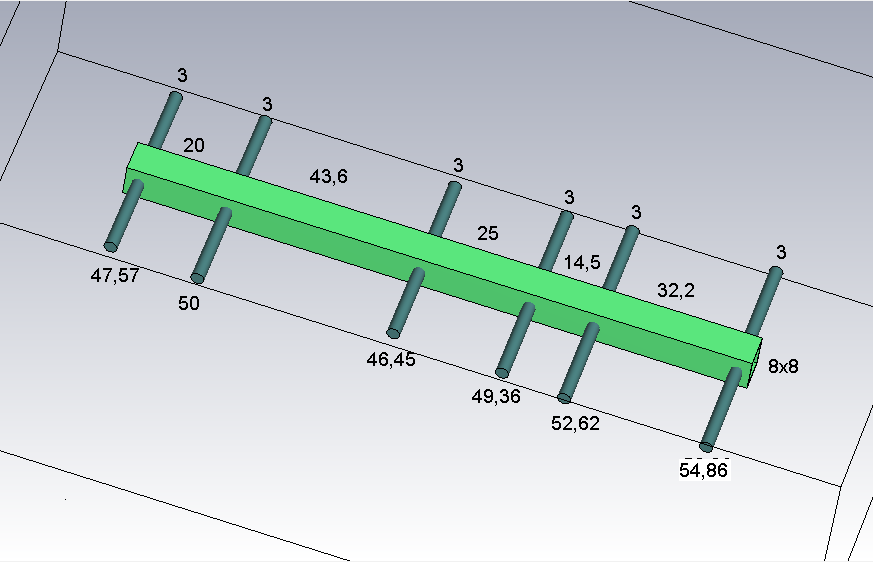

",,,such a yagi antenna can also be attached to the focus of a parabola....
The 8x8 boom is made of insulating material....

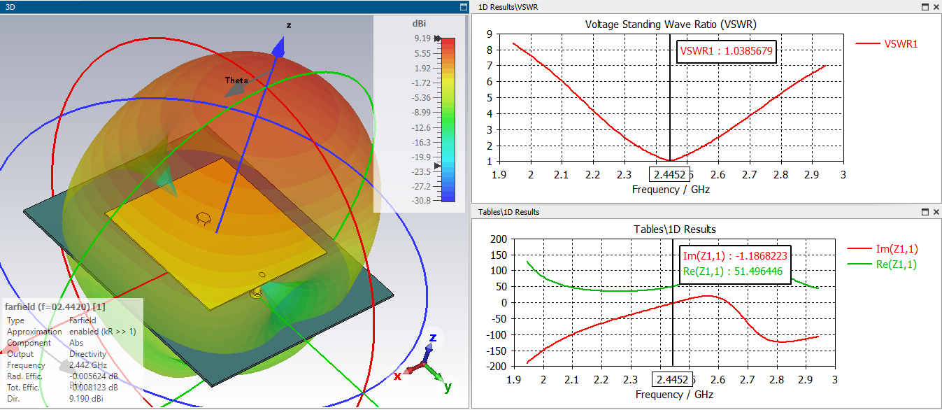

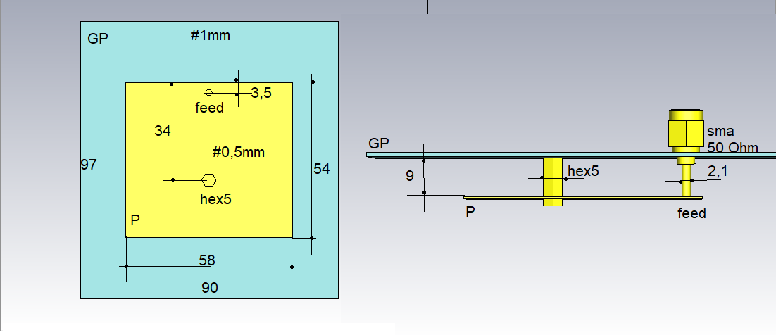

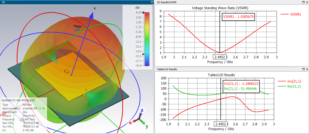

Patch antenna ( Patch ANT v.3 ) 50-ohm
