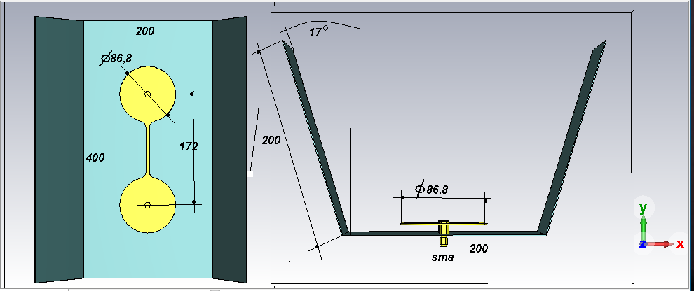

I mean. The dimension Will be the same?
Yes

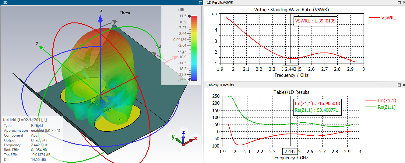

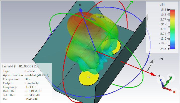

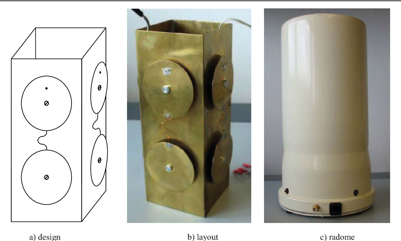

Could it be tested for 1800mhz? I need those 15db
Thank you very much, does the height of the patch to the reflector remain the same? If I wanted a 75 ohm impedance, what would I change?

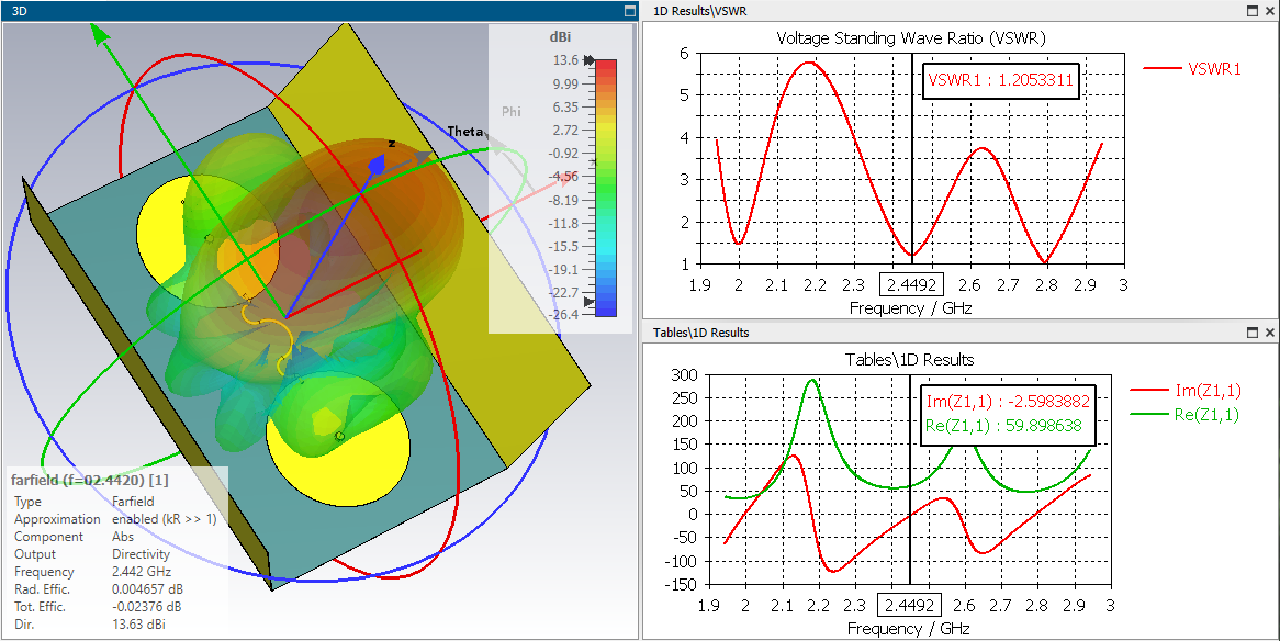

,,,a pretty good version with round patches...
,,,,by increasing the reflector we increase the antenna gain....

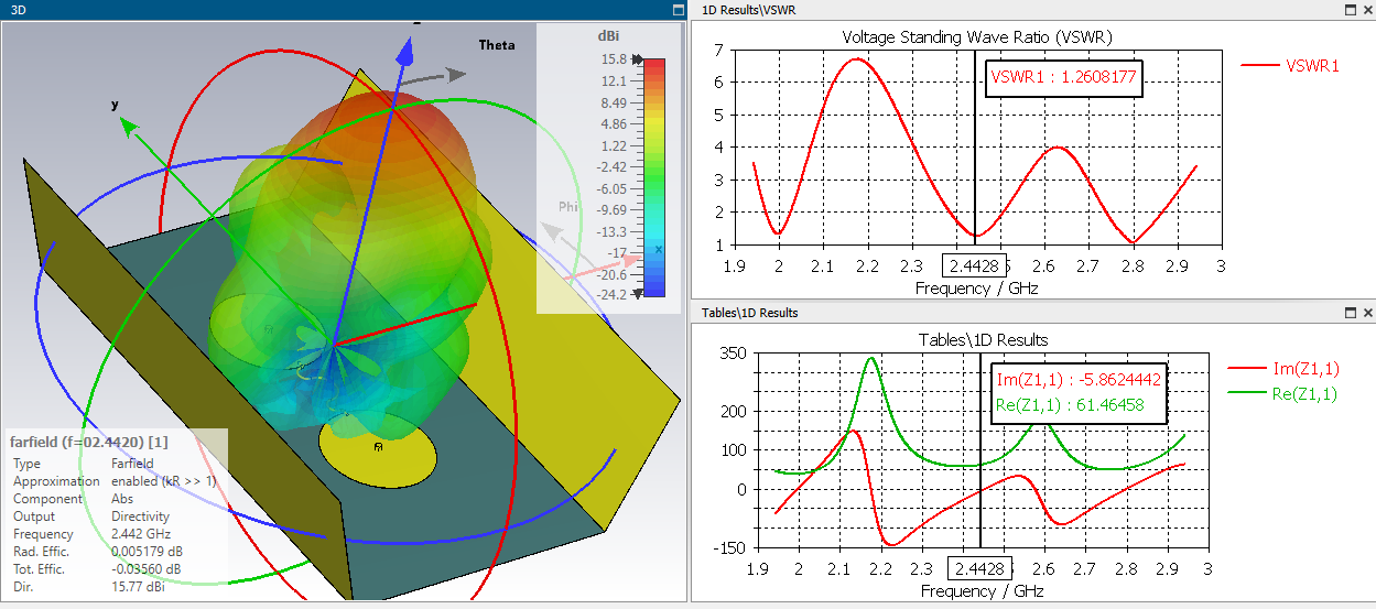

,,,and an improved version with elliptical patches...

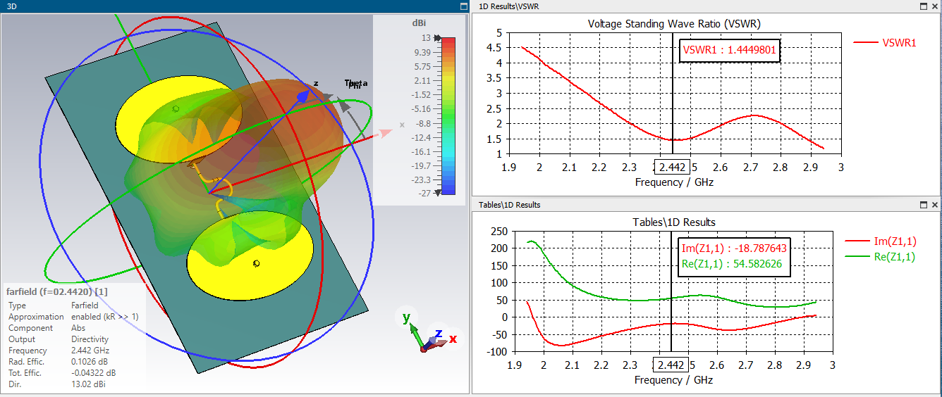

,,,with wings...
