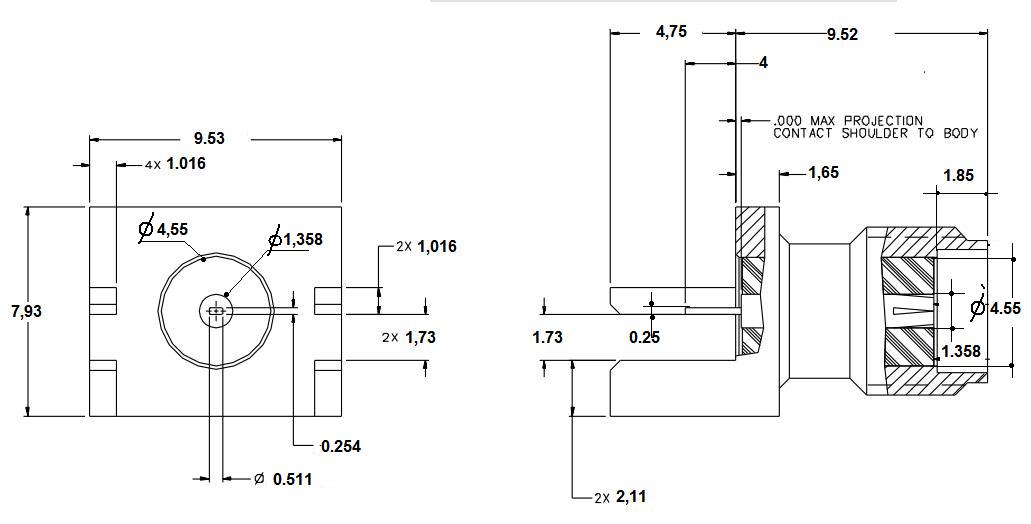

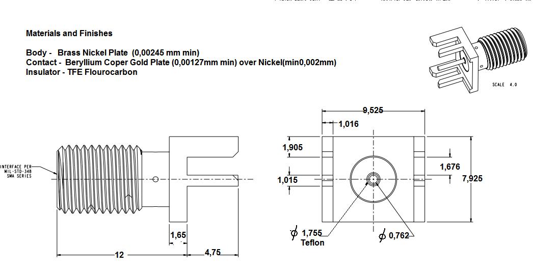

something it  is not ok here...

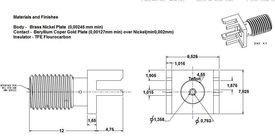

dimensions are not good, they must be in mm

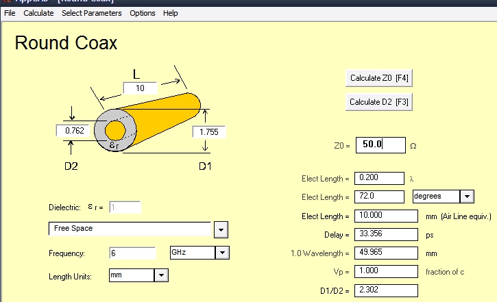

It must be about the size coaxial port,,,,in the air

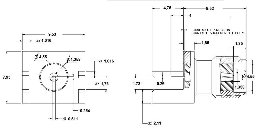

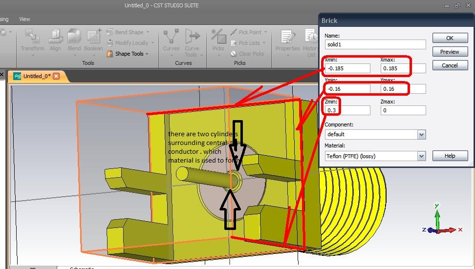

Thank you...please attach the file so that i can design in hfss. in the attached pdf file the dimensions were mentioned in inches. we have to convert them into mm.

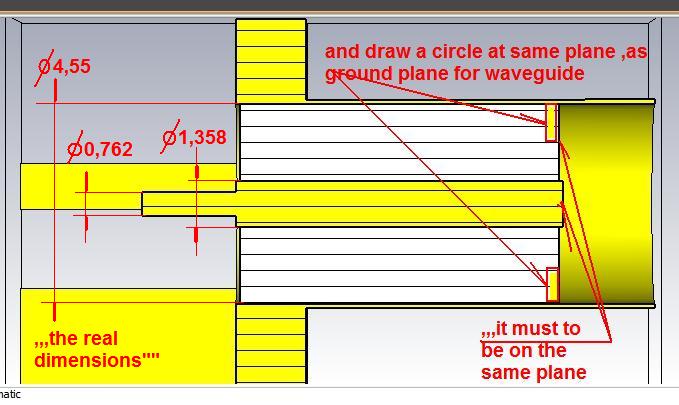

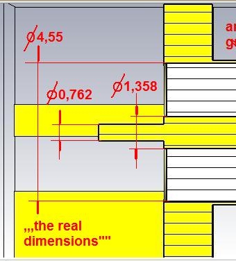

These are the real dimensions,,,,
Hi i belive your central cnductor is made of beryllium copper. first you coated the beryllium copper with gold plate, after that you again coated with nikel am i right or wrong ?

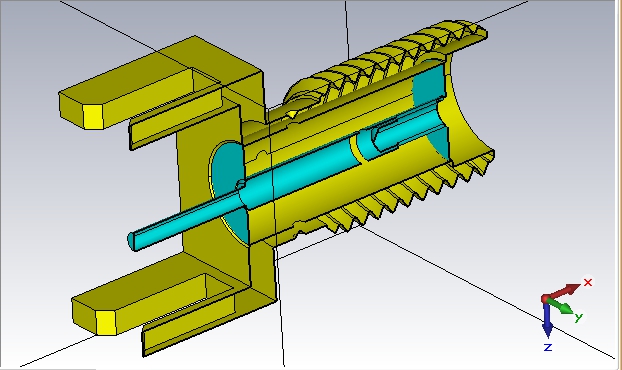

is it really necessary to  draw those zig zag pattern on the body ?
I think it copper silvered at surface...
increases surfaces of  boundaries...!!!!

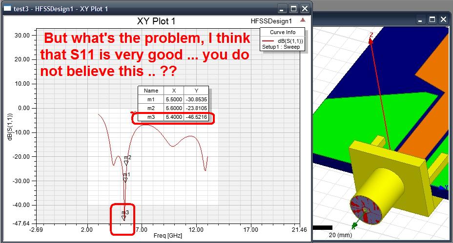

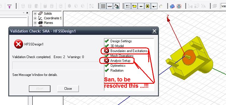

Helle sir. Good evening. , I designed three antennas from IEEE transactions and excited them with SMA connector I designed earlier. But unfortunately, the S11 results I am getting are very poor. please give me necessary suggestions to get the results.
Thank you.

ok, I'll try to see what can be done, but tell me please, why so much interested in this type of antennas ..??
I am learning the antenna design step by step.  I am trying to create a template for any antenna design. for example, here I created an SMA connector with this SMA connector I should recreate the results presented in any reference paper that is my aim. I have the confidence that I can recreate the results using wave port and lumped port excitation. I want the same confidence in SMA connector excitation also. that is the reason why I am modelling antennas in HFSS in past few day, i am learning about SMA connector excitation.  that's it.
Please check the other antennas also..i need exact replica of the results.

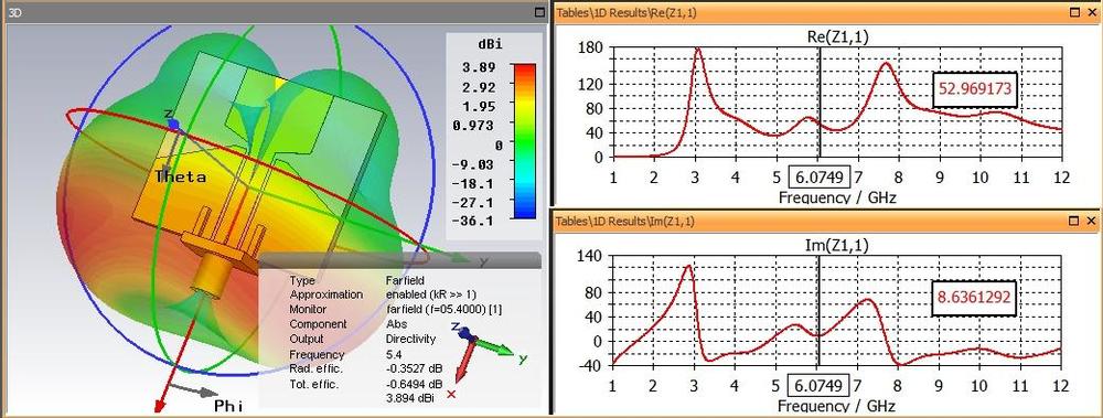

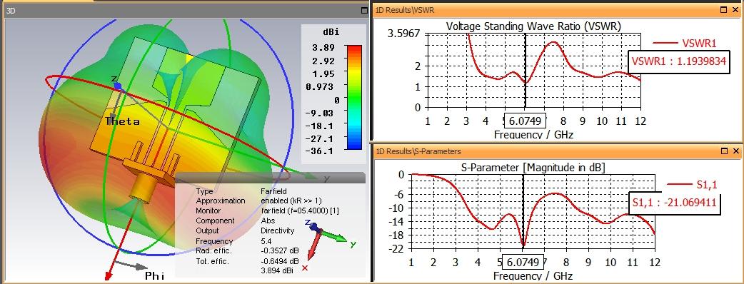

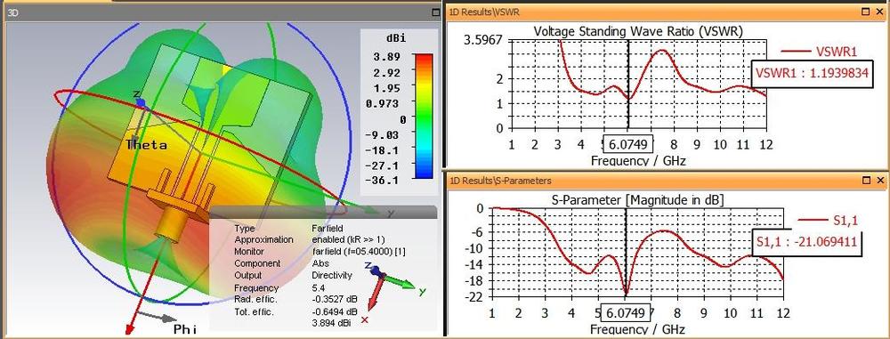

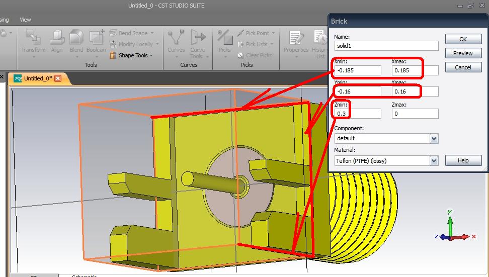

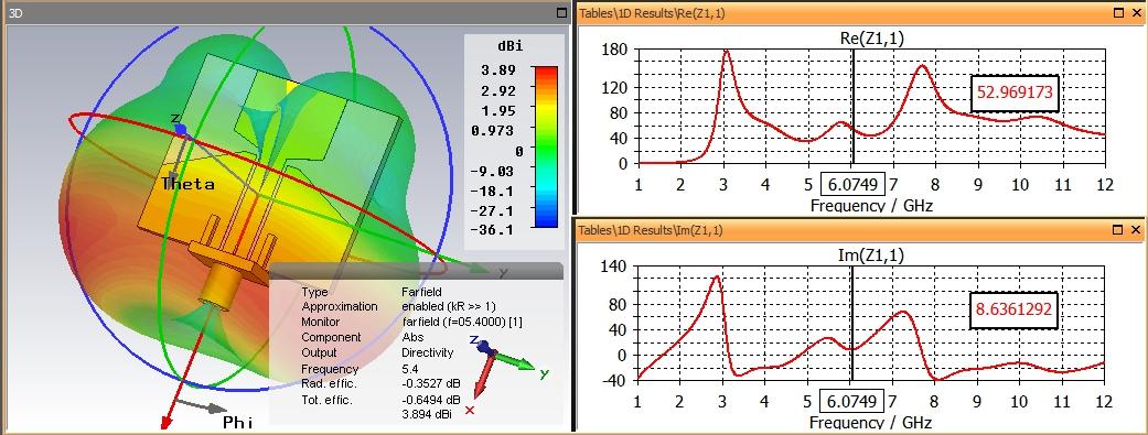

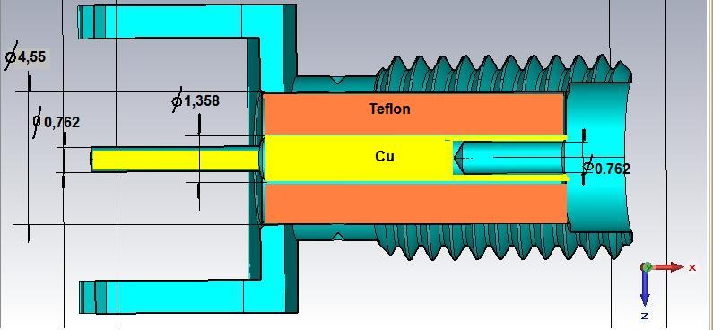

,,,this it"s in CST
