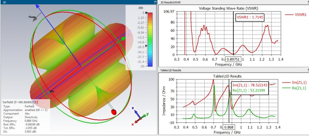

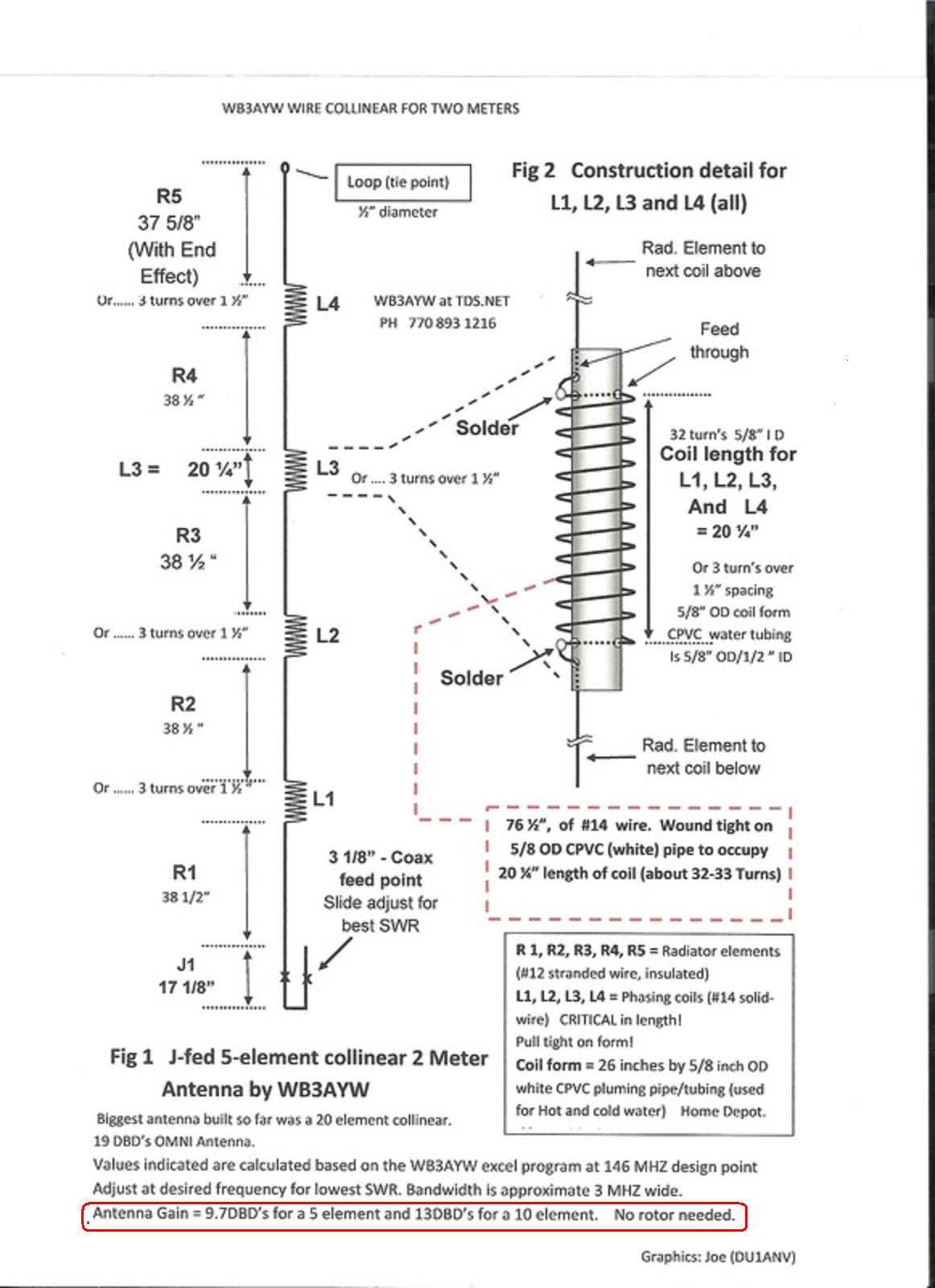

,,, and impedance .... ???
,,, why don't you give the dimensions...???,, and why not .. ???
,,,or so..
,,, put a Batwing antenna in the focus of the parabolic satellite dish ... !!!
,,, maybe it would be interesting to see these...
https://www.lan23.ru/forum/node/340
https://deracahyono.wordpress.com/2011/02/26/isi-omni-built-up-hyperlink-15-dbi-review/
I think the best is the galvanized sheet ... !!!
1 person likes this -
I have only one question,,, for which frequency ... ??
,,, not good, very rudimentary, still studying ,, !!!
,,works very well...!!!
You should see that too...

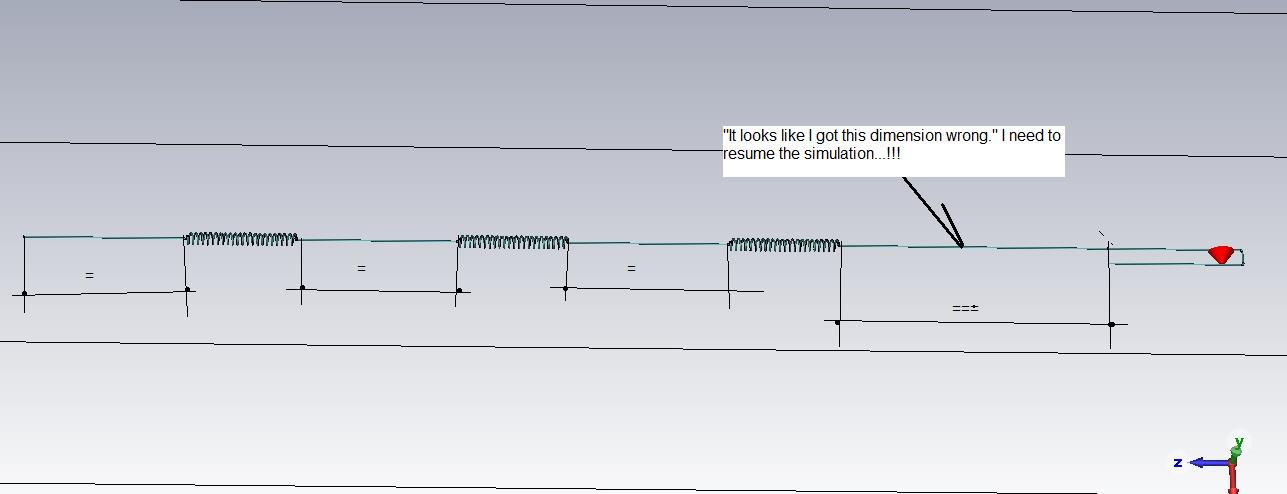

,,,show me where did you get the dimensions from ...?
I think the coil is not good...!!! -
,,, did you manage to make this antenna ... ??
,, it's a design mistake for me ... !!!
