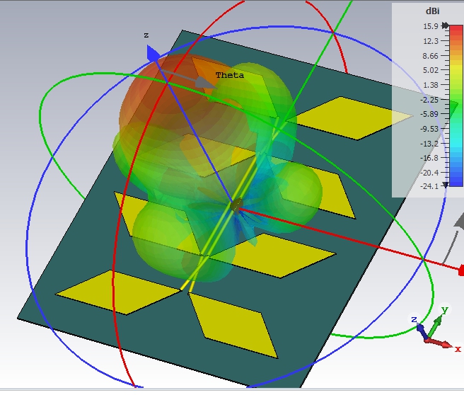

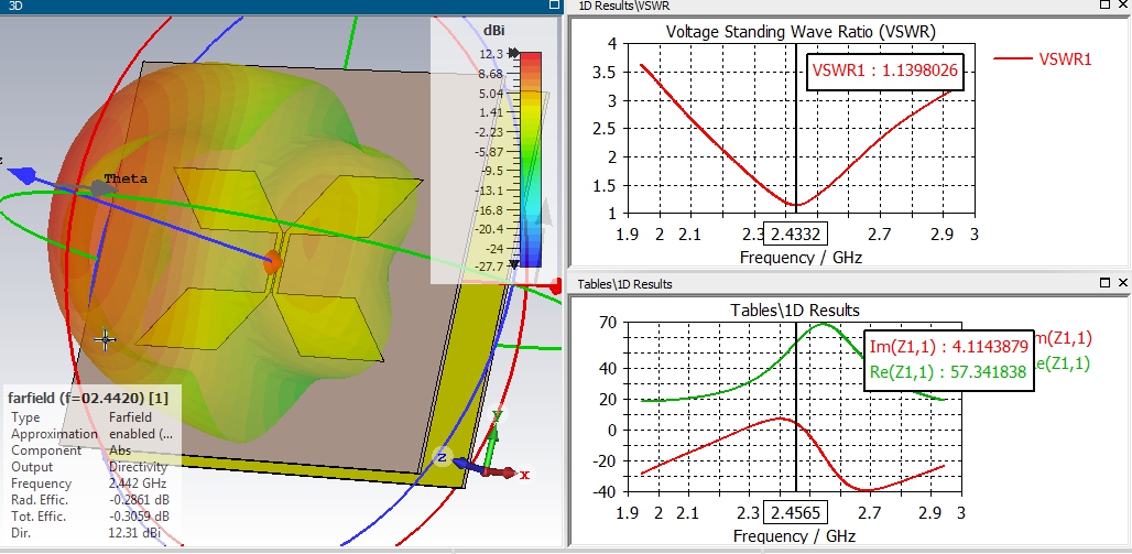

Recently,a new antenna configuration known as  Bow Tie Antenna (BTA) or Butterfly Antenna(BFA) are proposed with broadband and high gain properties . The Butterfly Antenna is shaped from four side  quadrilateral sheet feed in the vertex. This kind of antenna is defined by quadrilateral the  flare angle only.

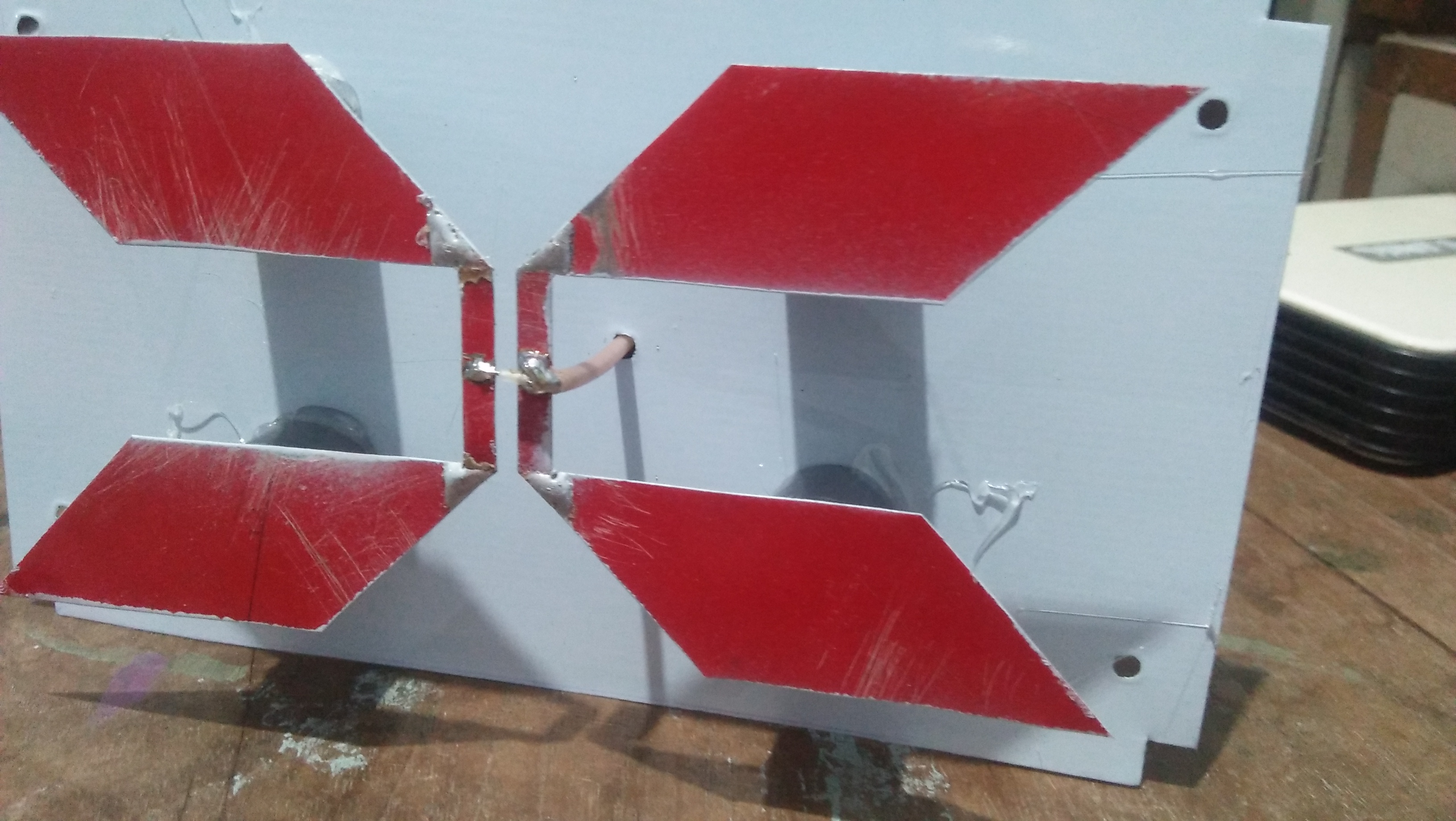

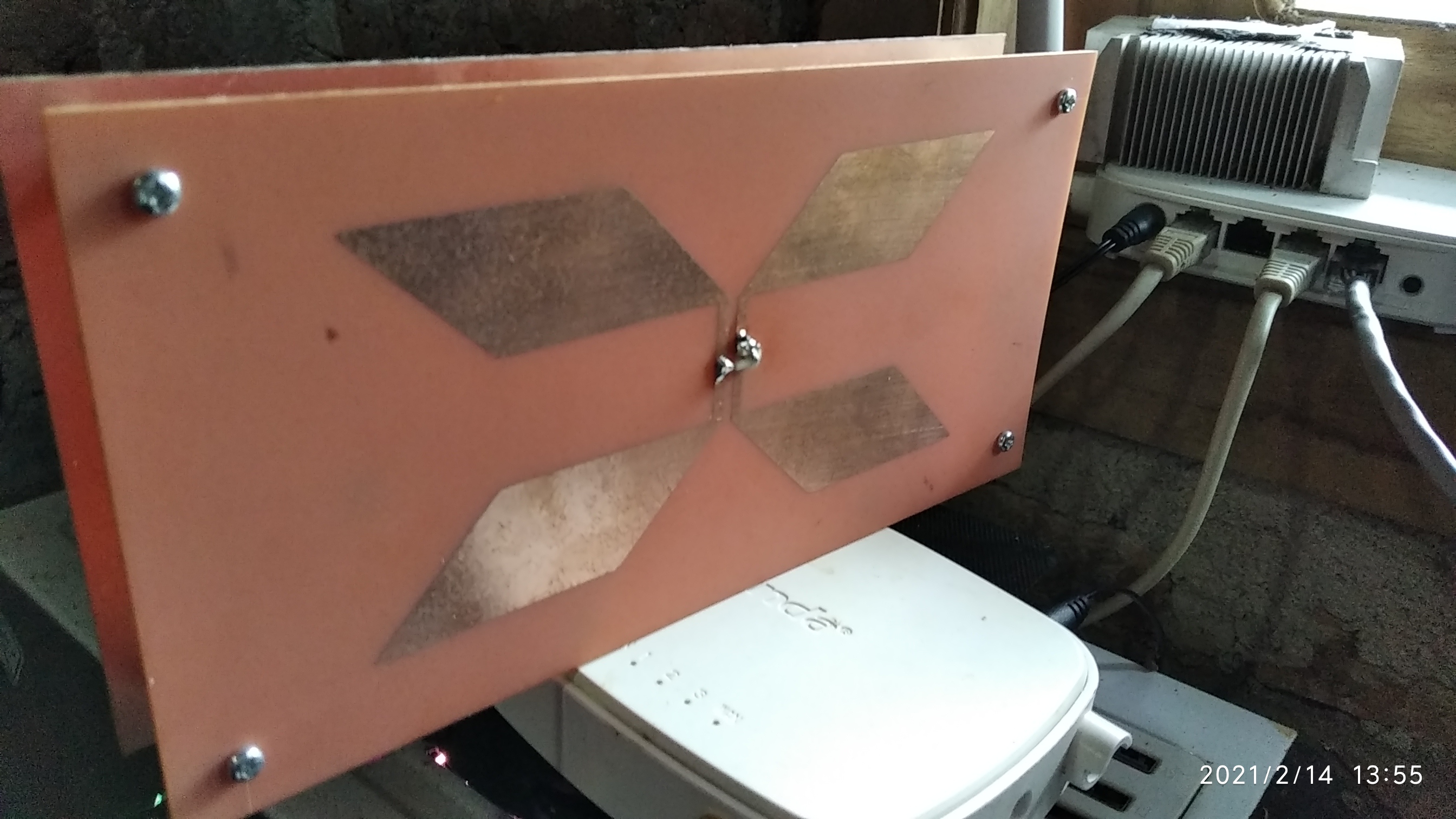

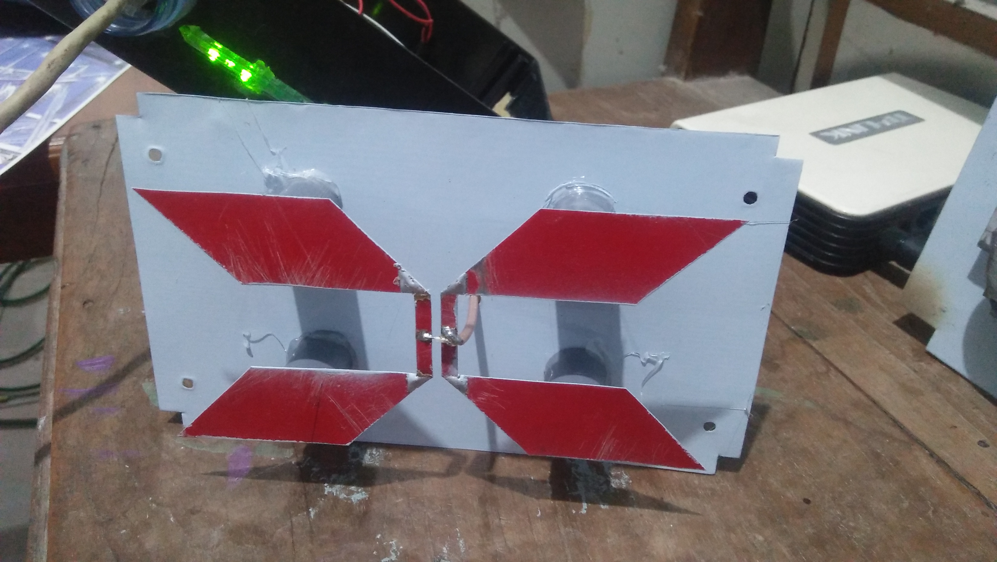

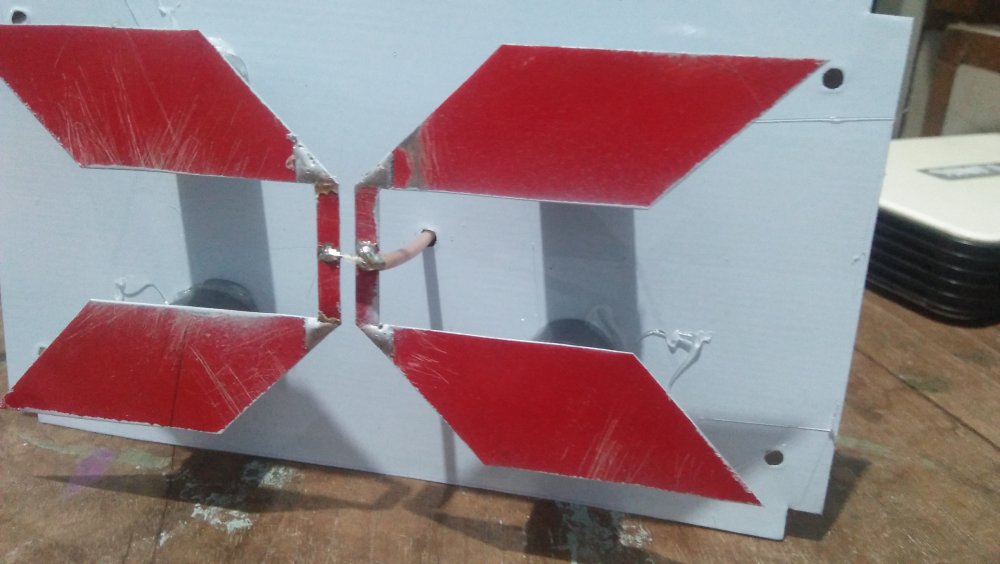

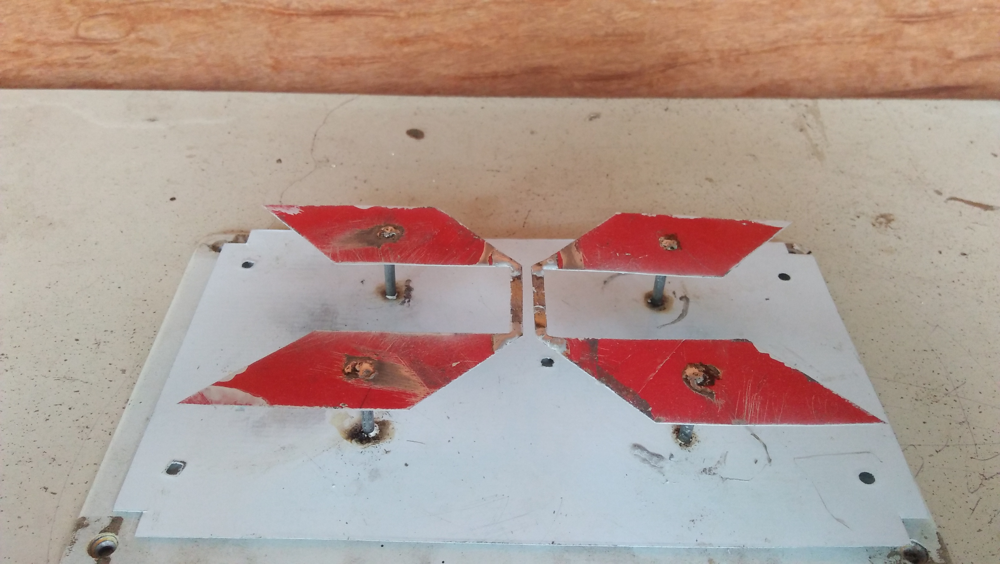

Is there something wrong with my design, I use PVC that is given glue between the patch and the reflector? but this works well, a little better than the "simple antenna" that I have made
,,,yes, it is good that you put insulators, I will see how it goes with the galvanic link between the patch and the reflector...!!1

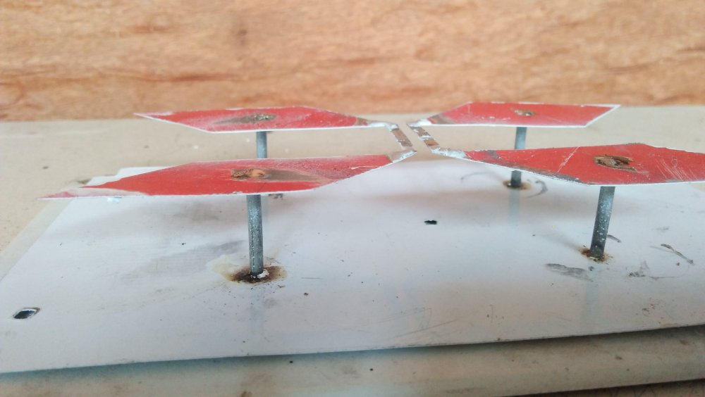

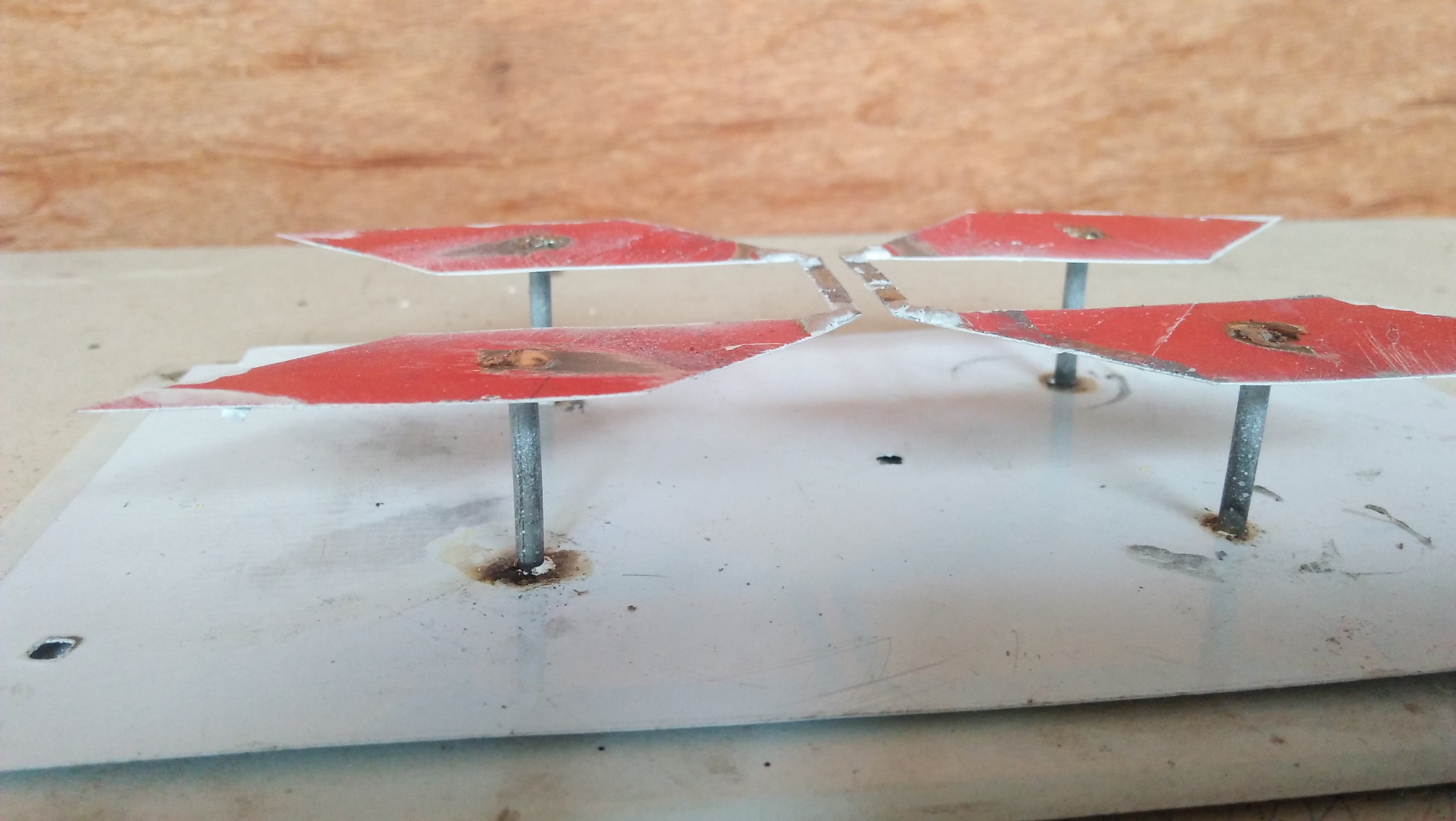

 ,,,patch suspension by 3mm conductor ...

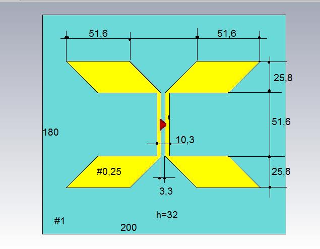

I changed the design, is it correct??

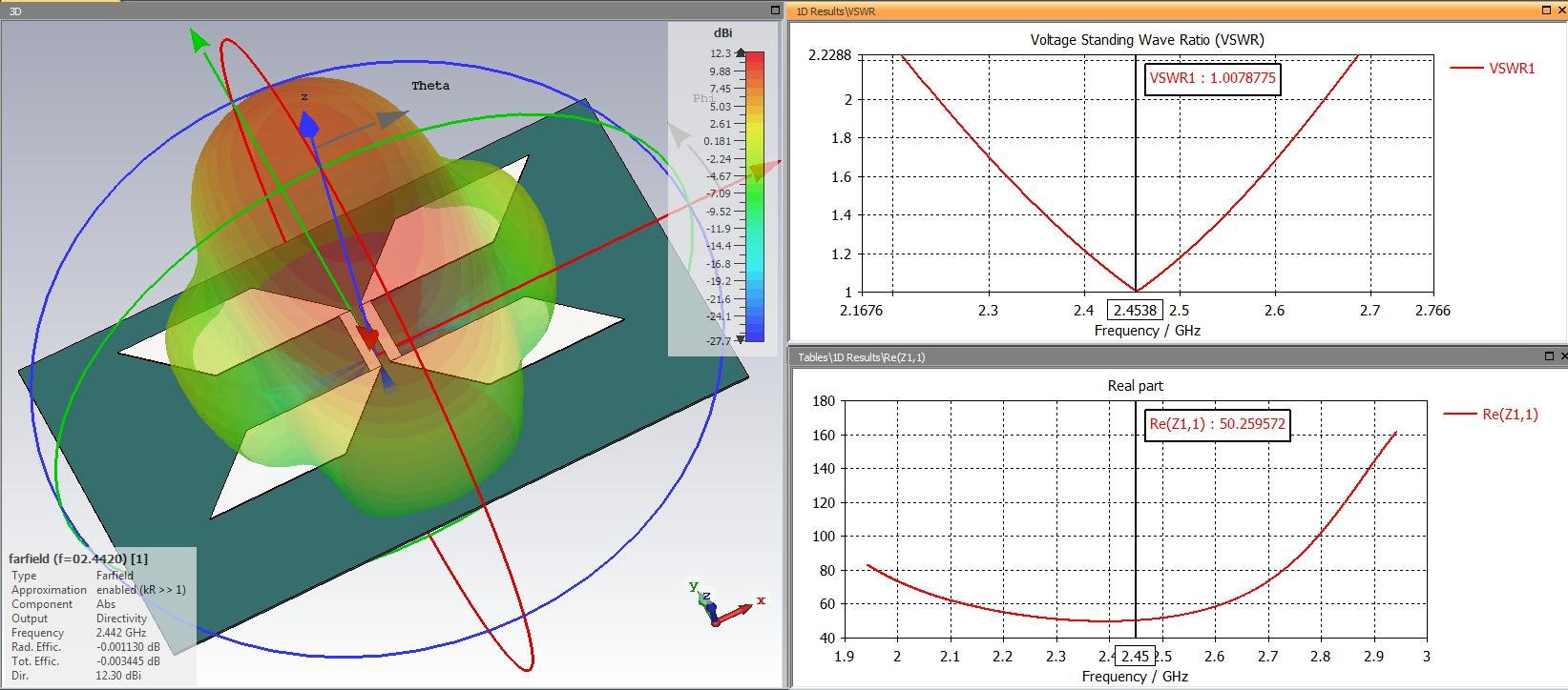

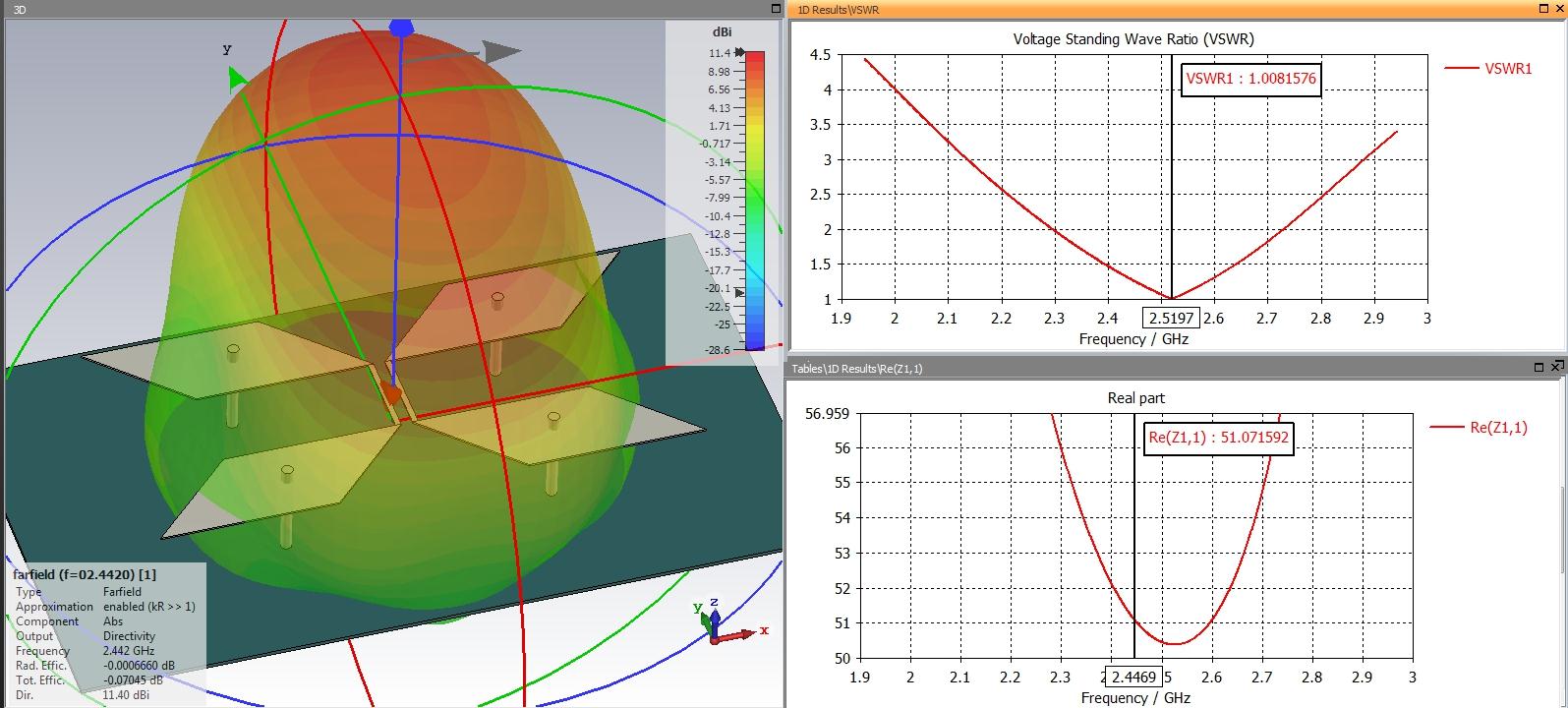

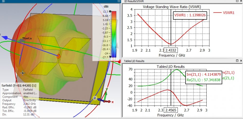

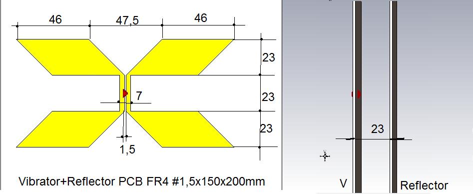

but why yours VSWR working on frequency 2,519 ghz

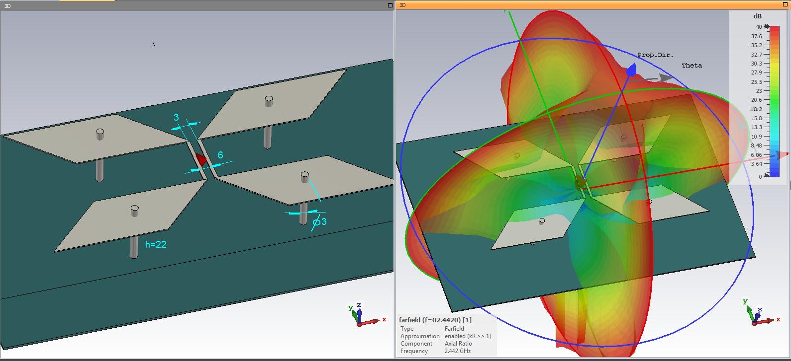

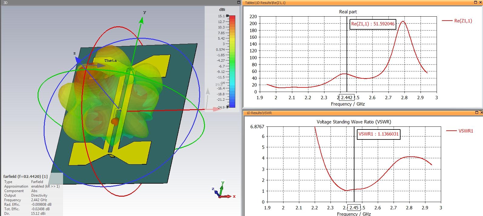

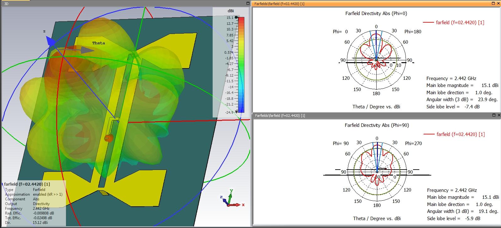

,,,for the galvanic antenna, I tried to keep the initial dimensions of the patch ... ???
and further, has a frequency range of 2.4, ---- 2.65 GHz
so,, that means this antenna can still work at a frequency of 2.4ghz ??

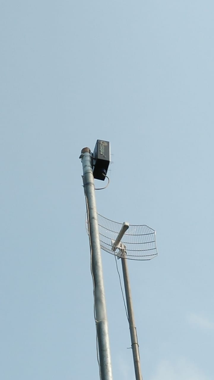

and finally,,, this antenna pair with my outdoor modified TP-Link MR3220 ubnt bullet m2 firmware installed
,,,hi buddy....!!!
,,,and how  it works  this installation .. ??

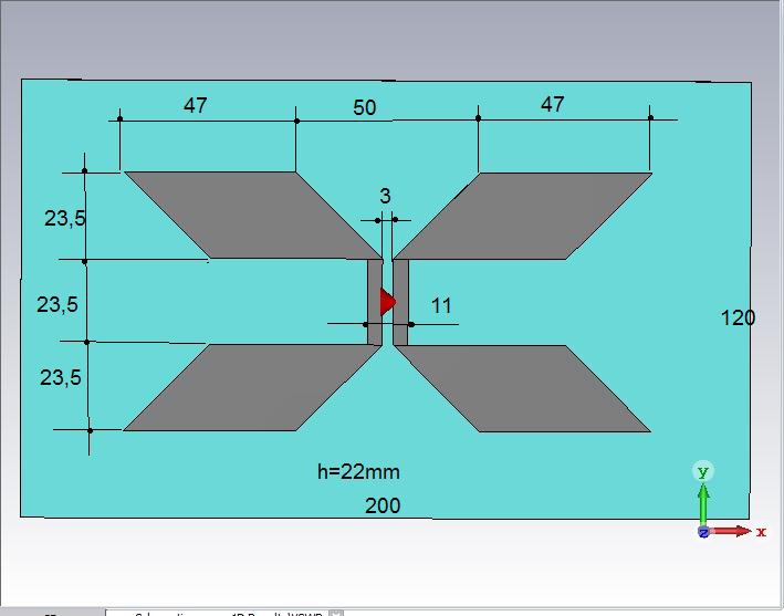

,,,, no, not with these dimensions ... !!!
,,, here is an example ...
Since I didn't have 150x200mm fr4, I made this with 100x200mm fr4, and it still working good
