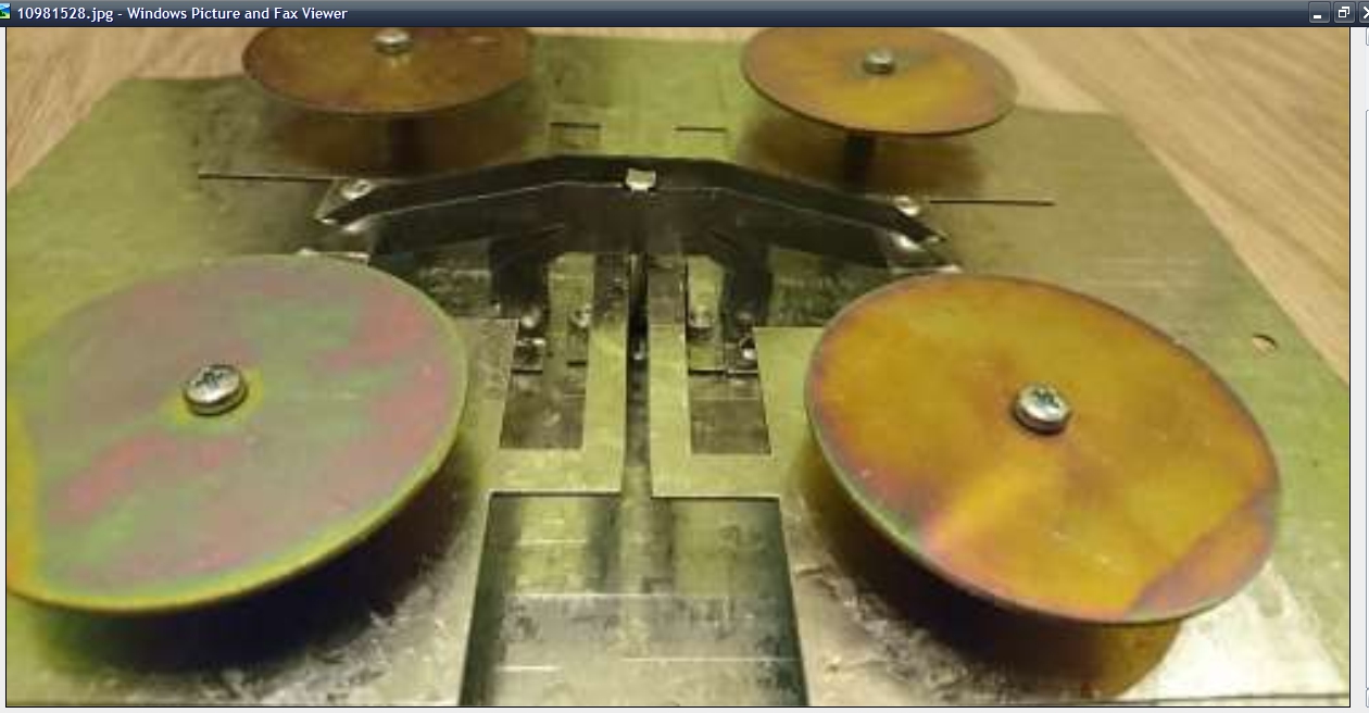

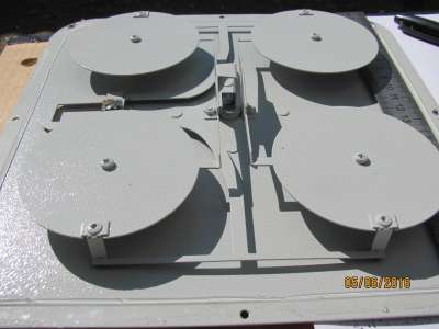

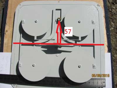

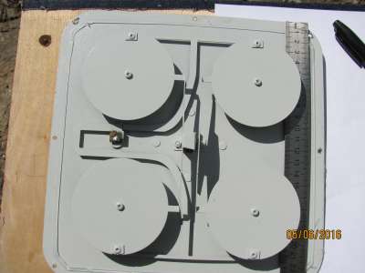

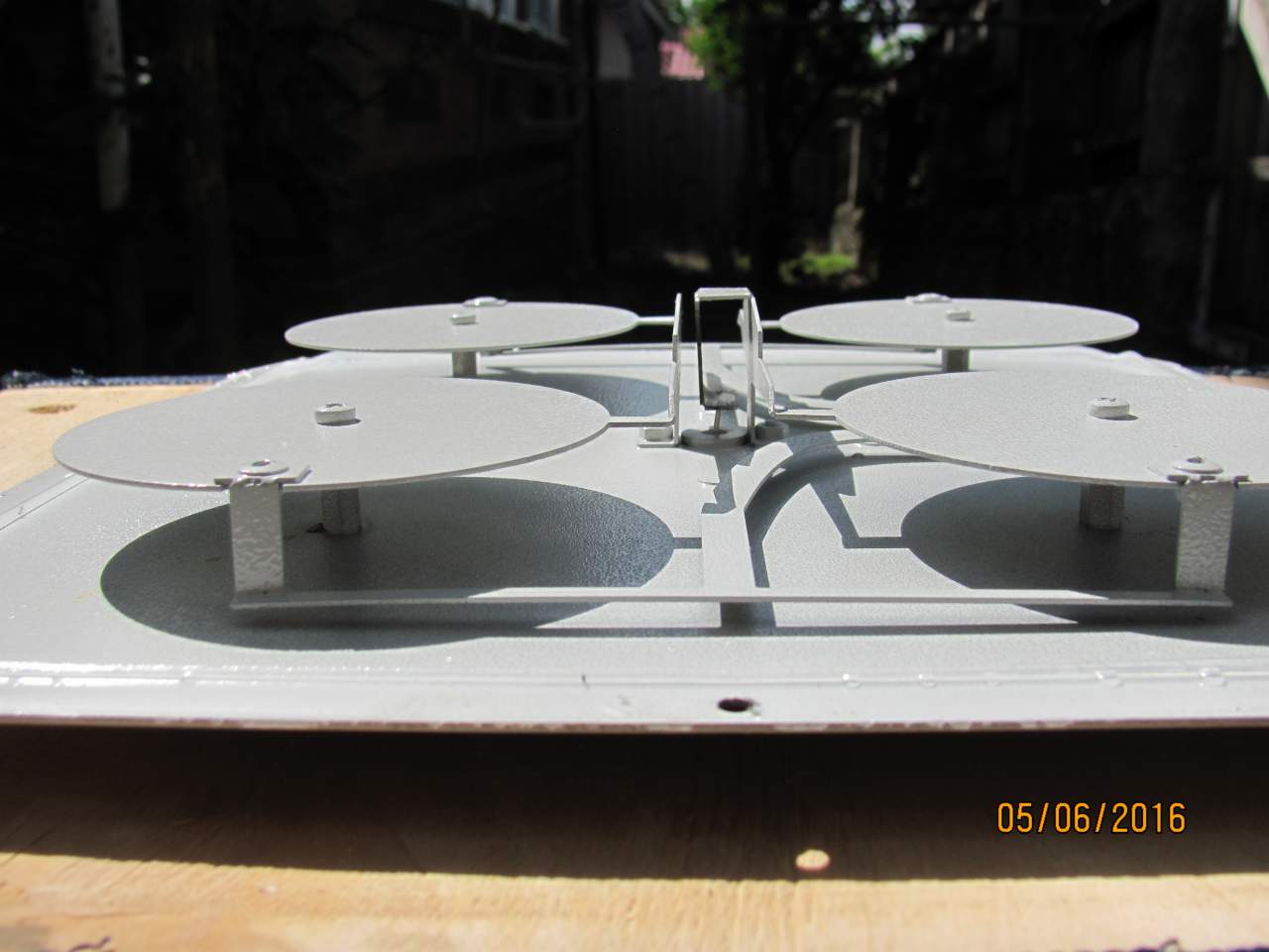

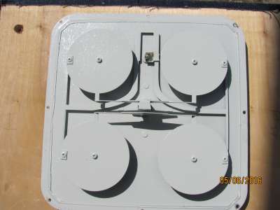

This antenna is the simplest MIMO 1800 ? Jomy, you are a specialist what kind of antenna can offer?
Erkin, this antenna is quite complicated in terms of impedance adjustment lines.
Regarding the recommendation, I think the patch antenna with adaptive lines from the wire is easier to execute
16 minutes ago, chilanzar2 said:
You have options in autocad file of this antenna ? MIMO1800
no, I do not have this ... but for you I do anything .. !!!
